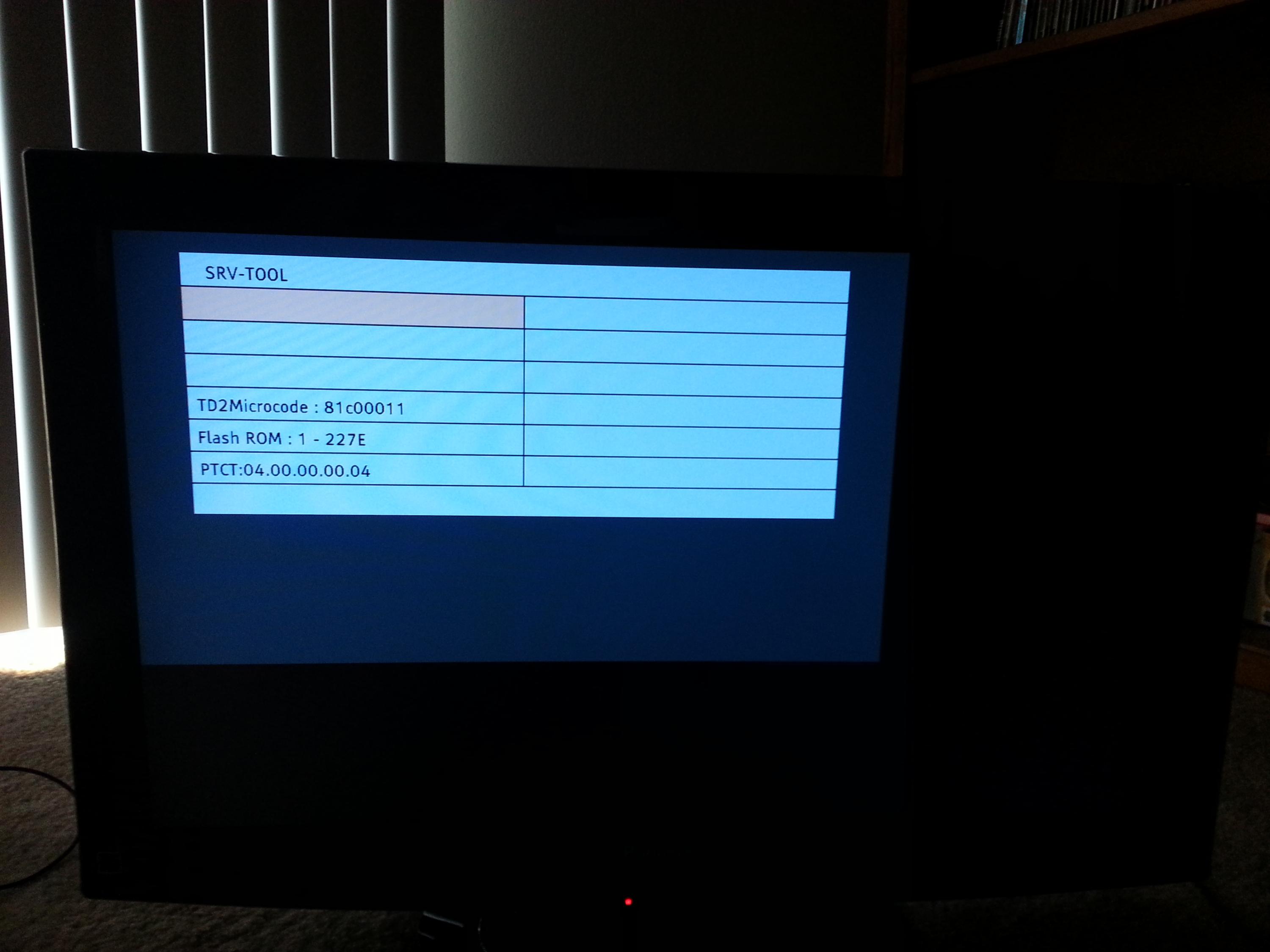

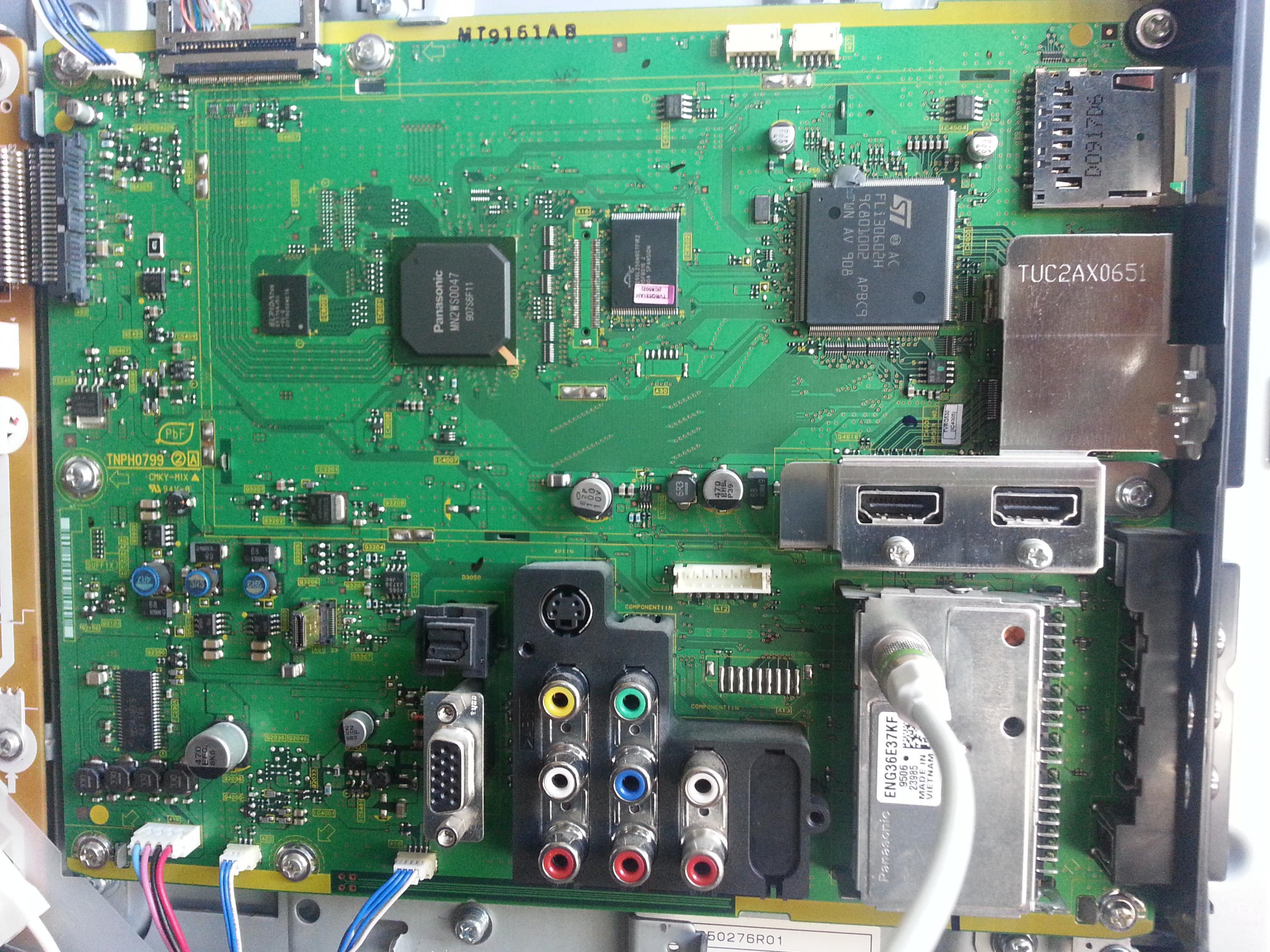

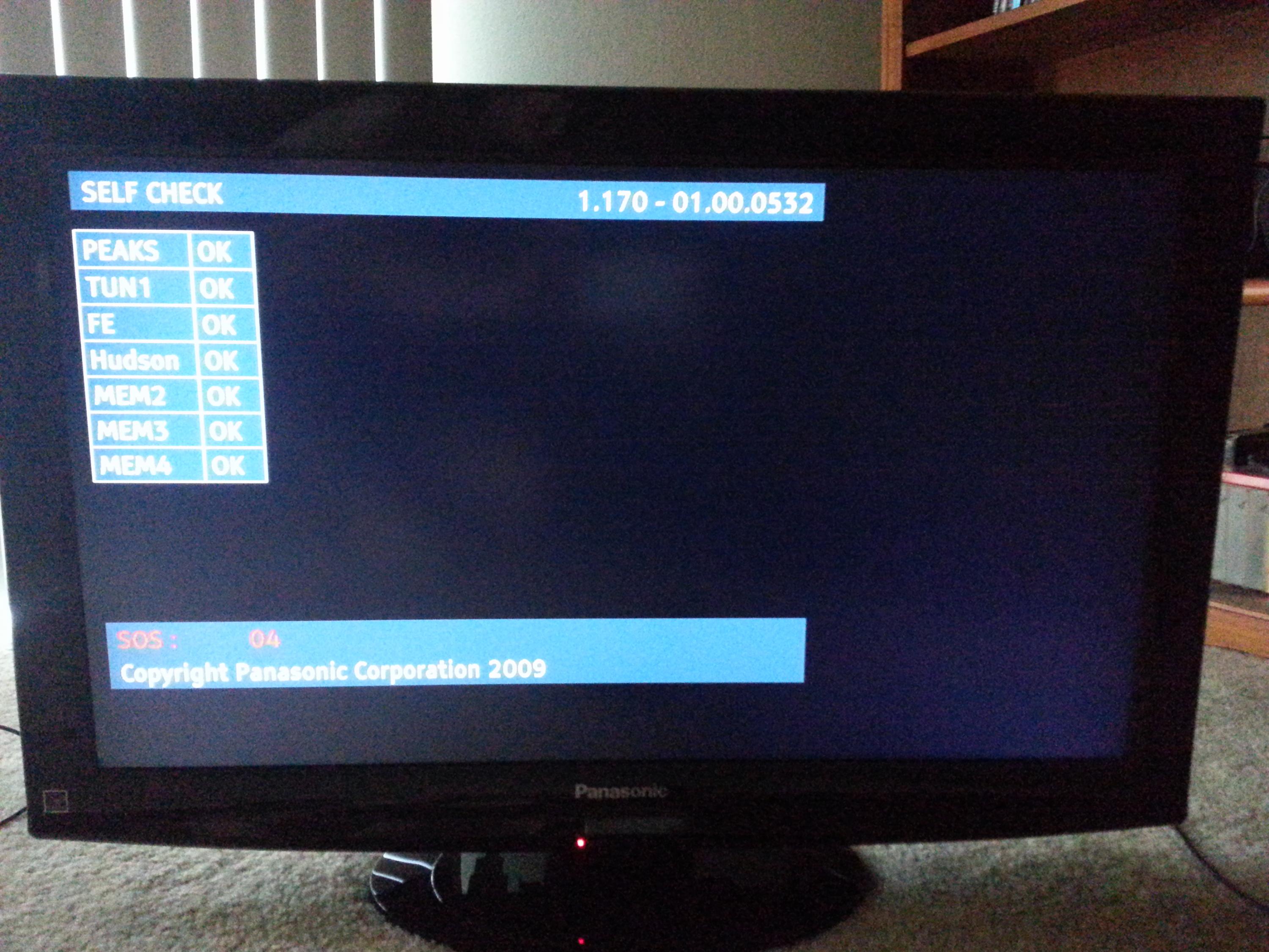

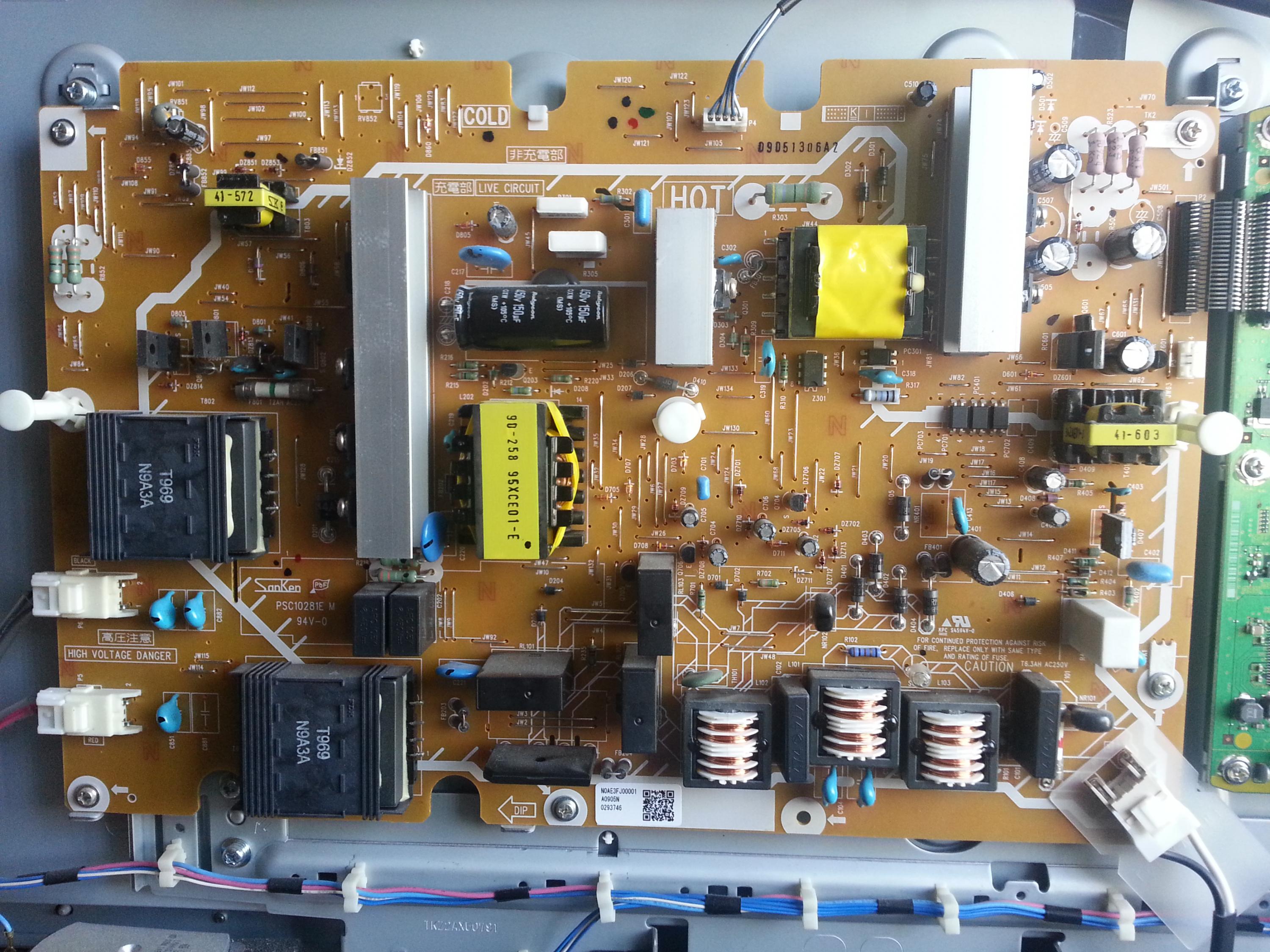

Panasonic TC-L32X1
  • arunningpir8
    • Jun 2013
    • 32
    Panasonic TC-L32X1
    Hey guys I have one here that should be simple, just looking for a quick answer on what you guys think.
    I got this TV the other day, and it would power on, but randomly turn itself off, and then click the relay a few times and turn itself back on, usually with a message "an error has been detected and recovered."
    Now there were also a few times where the TV would just "freeze" with a screen of a lot of vertical bands of color before doing the power cycle as mentioned earlier.
    Today I try to start measuring stuff and low and behold now it won't turn on at all. Now all I get is the relay clicking on and off repeatedly. The one thing I have noticed is that if I hold the power button in after about 5 seconds the relay will turn on without turning off again until I let go of the POWER button. When I do this, the main cap will go from 400v to about 170v. Also, when I don't touch anything the main cap is usually going from 400-350v synchronous to the relay clicking.
    Now I'm pretty sure the problem lies within the power board, however the fact that the screen froze with the weird vertical lines of color when it was working still puts me a little on edge on if it could be an A board problem.
    Pics of both below.
    Any suggestions?
    Re: Panasonic TC-L32X1
    I would be looking more at an A board issue.
    When the TV fails to power on, does the light ever turn red and blink an error code?
    • arunningpir8
      • Jun 2013
      • 32
      Re: Panasonic TC-L32X1
      Unfortunately the red standby light never turns on. When the set was working, the light only came on when the TV was powered on. Just for my piece of mind, if I was to lean towards an A board issue, why would the main cap be dipping between 400 and 350v? And also any idea as to why holding the power button in will cause it to dip to 170v?
      I'm trying to get better at understanding the power circuits on these TV's and I enjoy reading your posts tom as they are always insightful and explanatory.
        Re: Panasonic TC-L32X1
        170V is normal for standby, it should be around 400V in operation.
        • arunningpir8
          • Jun 2013
          • 32
          Re: Panasonic TC-L32X1
          Also, here is a pic that somewhat shows about what I would see the couple times it froze before shutting off:
          http://www.avforums.com/forums/attac...2011161229.jpg
          I'm thinking of ordering the A board, I just wish I had a little more confidence in what the problem might be.
            Re: Panasonic TC-L32X1
            Definitely thinking main board, though could be t-con (less likely though.)
            • arunningpir8
              • Jun 2013
              • 32
              Re: Panasonic TC-L32X1
              Alright, A board was my first guess as well way back when I first got the set. My last question is would the relay be kicking on and off because of a short or because of a power drop or because of the micro not responding accordingly? I just haven't worked on a TV with relays before so I'm curious as to their operation in this situation.
                Re: Panasonic TC-L32X1
                Would possibly be the MCU not working properly.
                • arunningpir8
                  • Jun 2013
                  • 32
                  Re: Panasonic TC-L32X1
                  Awesome thanks again for your help I'll try looking for an A board.
                  • arunningpir8
                    • Jun 2013
                    • 32
                    Re: Panasonic TC-L32X1
                    Ok, so the TV just started working again and has been working for long periods of time now. I was able to pull SOS codes via the service menu, and the SOS codes point to an SOS 4, which according to this TV's service manual is a "DTV 12v" error and says it's an issue with the P Board. I was *just* about to order the A board and then I saw this and am now doubting it again.
                    Now, I never got the SOS code from a blinking power light, ONLY from the service menu did I get this information. See the pictures below.
                    Anybody have experience with a similar Panasonic TV or SOS code? Now I'm looking at the P Board and measuring component after component trying to find something wrong but alas nothing.
                    Thoughts?
                    • arunningpir8
                      • Jun 2013
                      • 32
                      Re: Panasonic TC-L32X1
                      Also had a question, when looking at the service manuals, a good portion of the power lines are highlighted orange. Does this mean simply that they are power lines, or does it mean that they are hot? I saw some power lines that were not highlighted orange that is why I was wondering. Didn't find anything about the coloring in the manual.
                        Re: Panasonic TC-L32X1
                        SOS4 is usually over-voltage on one of the lines, so it can be P board. However, an A board fault can lead to mis-detection of fault codes.
                        • arunningpir8
                          • Jun 2013
                          • 32
                          Re: Panasonic TC-L32X1
                          Alright so I already ordered the A board but just now while the TV was on it turned on and off a couple times and then started blinking 13 times. This shows up in the manual as an SOS which points to the A board being the problem. Now all it does when you plug it in is make the initial click and then the red led goes solid, just like if it were on, however nothing actually powers up.
                          I'm just wondering if it would be safe to plug the new A board in when it comes or if you think there might be a power supply issue that blew this A board?
                          Thanks again for all your help!
                            Re: Panasonic TC-L32X1
                            Panasonic usually have lots of protection mechanisms, they'll shut down before an over-voltage occurs -- but it would be a good idea to check the outputs from the PSU are good.
                            • arunningpir8
                              • Jun 2013
                              • 32
                              Re: Panasonic TC-L32X1
                              Welp just got the board in yesterday. I have been running it for hours without issue so knock on wood but it seems that the A board WAS the issue. Thanks again Tom66 for your countless efforts on these forums
                              • Rensiee
                                Panasonic TH-50PX8EA Black screen, only relay clicks
                                by Rensiee
                                I have been reading a few threads on here regarding Panasonic plasma tv's. I've found one thread which explains the same problem as mine, unfortunately the thread has not been completed.
                                I got a free tv (TH-50PX8EA) from a friend which shows no screen. When plugged in only one red light shows up and when pushing the ON button, the red LED turns of and will only turn on again when pressing the ON button again.
                                When plugging in the TV i hear two relays click fast and after a few seconds the third relay clicks.
                                I have measured the voltage in the VSUS line, which...
                                06-18-2024, 12:58 PM
                              • beetle1303
                                Carver CM-1090 - Power relay clicking on & off, then fuse blown after 20-30 seconds of power cycling.
                                by beetle1303
                                I gotten a Carver CM-1090 amplifier from a friend who has kept it in storage for decades. Opened it up, thick layer of dust cumulated everywhere. Vacuumed it semi-cleaned, and blown off as much as possible the remaining dust. This is a 220V version.
                                On initial powered up with nothing connected - it works with all the lights and button indicator lit up as pressed, etc. I then powered off, connected a CD player into the CD RCA input and powered it on. It seemed to work for a short while and when I turned the volume up and down to see the the VUs works, the power started to clicked off...
                                01-13-2025, 08:49 PM
                              • DodgyTech
                                60" LG 60PB690V relay clicking issue
                                by DodgyTech
                                Hi everyone,
                                I require some help with my TV. The TV standby light blicks on and off with a clicking sound (relay?) from the back. After I opened up the TV, I set about troubleshooting by unplugging the boards to try and isolate the problem. My troubleshooting suggests that the logic board is causing the issue, but it could entirely be the YSUS board which is only activated once the logic board is connected.
                                I have recorded a video which I thought would be an easier way to explain the problem and show the boards at the same time.
                                I would like to try and identify...
                                07-07-2023, 10:30 AM
                              • GraphicMan
                                Pioneer amplifier A-205 Relay not clicking after a mistake i made
                                by GraphicMan
                                Hello guys
                                Because the unit is old (but only occasionally used) the loudness button causes some noise due to bad contact,
                                sprays did not work, so i decided to solder the pins that it connects on the pcb at the on (loudness on) position
                                i did that and it worked fine, i know from the bottom of my heart that the switch connects 2 pins and also d/c other 2 pins
                                on every position it have (6 pin switch), so i was curious what would happen if i clicked the switch off while the pins are soldered at on (so basiclly on and off at the same time), when i did so the sound is gone, nothing...
                                05-05-2024, 06:20 AM
                                HP EliteBook 840 G5 + Color LaserJet Pro MFP M477fdw + 3 year NBD HW Support Notebook 800 Specification for Upgrade or Repair
                                This specification for the HP EliteBook 840 G5 + Color LaserJet Pro MFP M477fdw + 3 year NBD HW Support Notebook can be useful for upgrading or repairing a laptop that is not working. As a community we are working through our specifications to add valuable data like the 840 G5 + Color LaserJet Pro MFP M477fdw + 3 year NBD HW Support boardview and 840 G5 + Color LaserJet Pro MFP M477fdw + 3 year NBD HW Support schematic. Our users have donated over 1 million documents which are being added to the site. This page will be updated soon with additional information. Alternatively you can request additional...
                                09-06-2024, 08:23 AM
