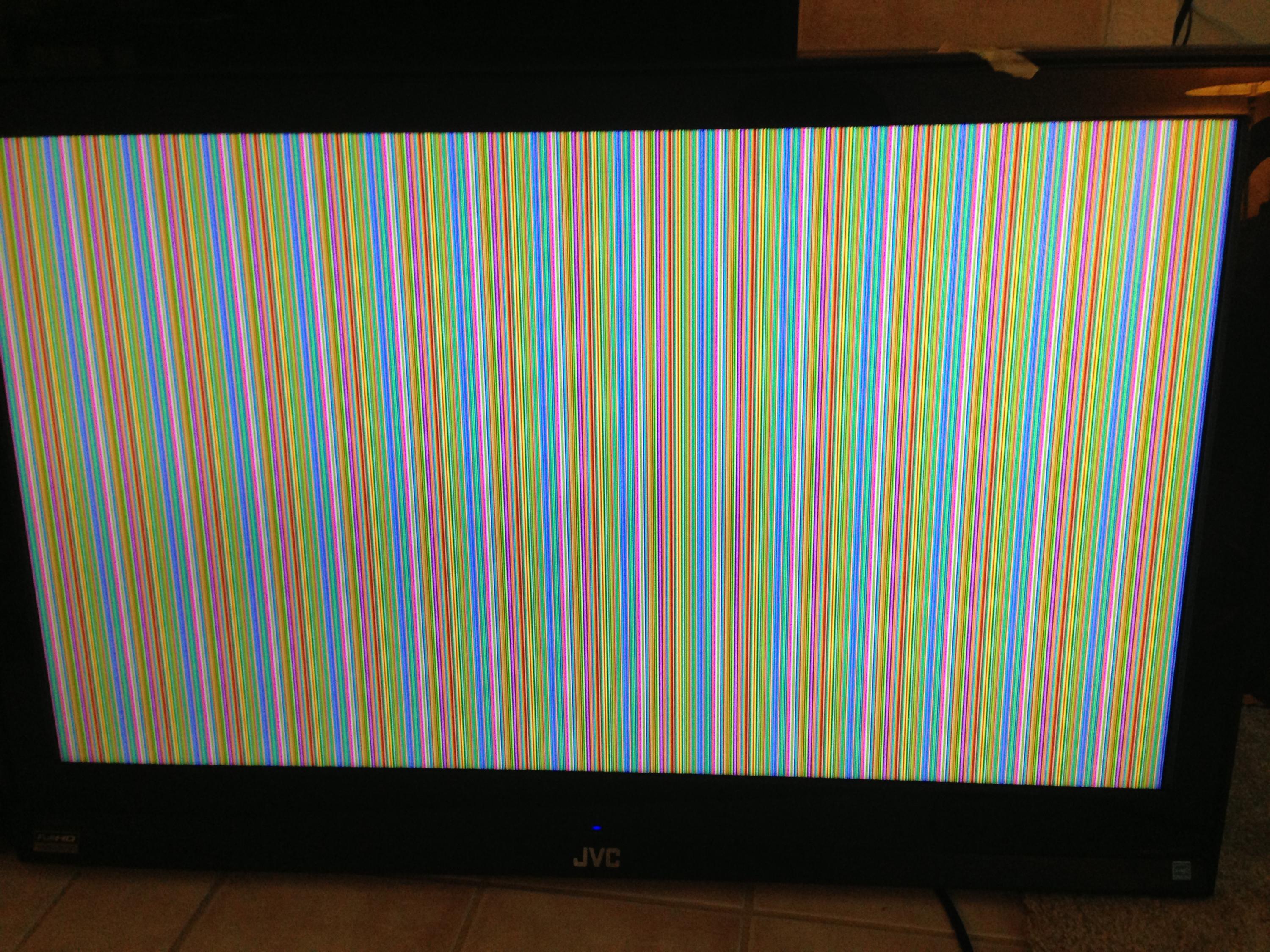

    So, I get this JVC LT-37X688 for free on CL. The guy gives it to me and says the TV turns on, backlight comes on, but no picture. I get the TV home and when I turn it on, sure enough, that's what happens.
    I open the TV up to see any problems. This is one of those JVC with the pointless bobby-trap photosensor, so I covered it up with electrical tape. No bulged caps, nothing visibly burned. But then I look closer and the LVDS cable was unplugged. I'm thinking "Sweet! Easy fix!" so I plug the cable in and fire the TV on. The picture came on, but had these crazy vertical lines across the screen every time I turned the TV on. (See first picture.) The first thing that comes to mind is that it must be a panel tab problem, which erased all my happiness.

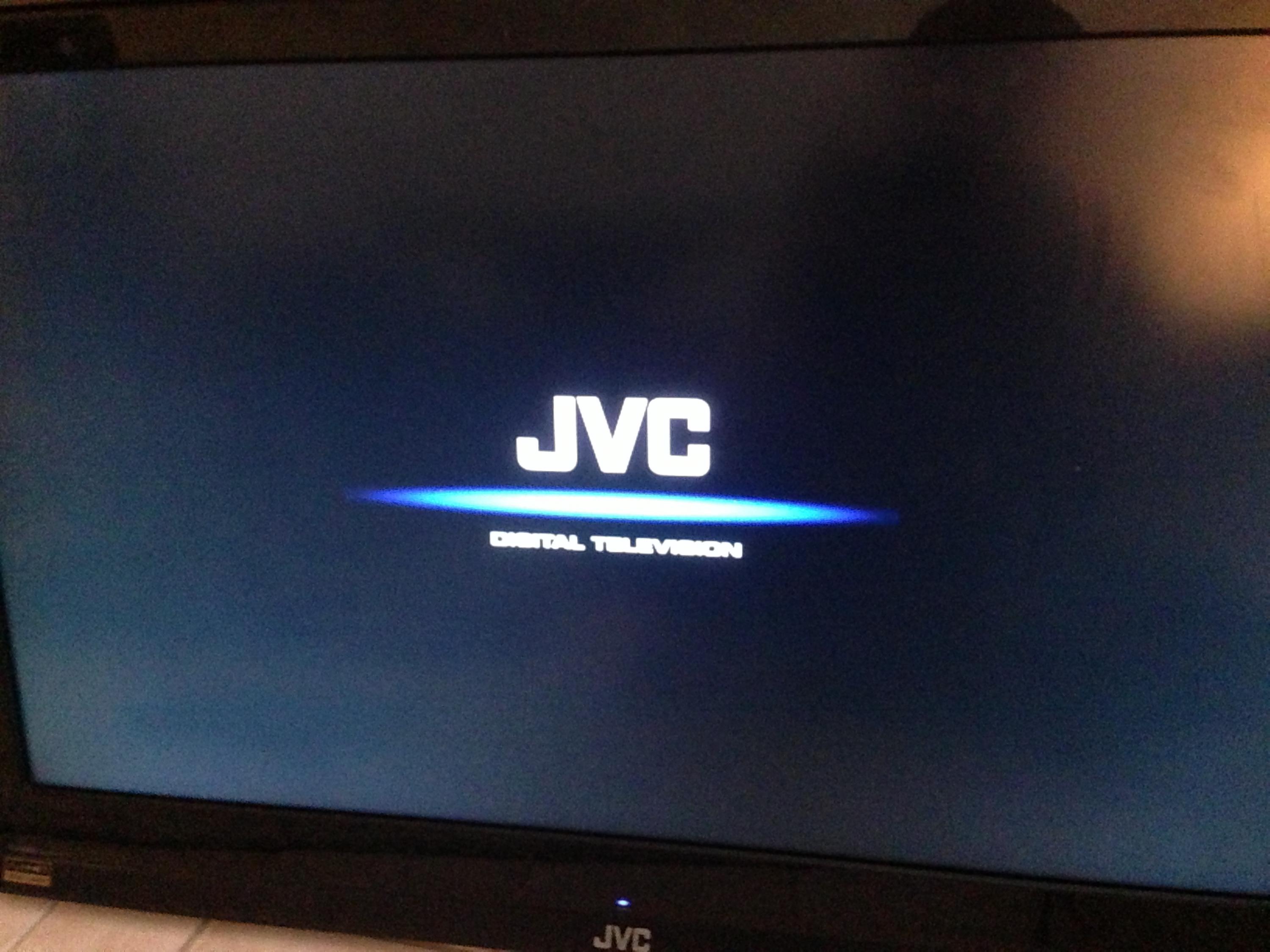

    I turned it on and the JVC splash screen pops up (See Picture 2), followed by the TV channel. It works! It never did that when I got lines. I have no idea how that happened, so the suspicious person that I am, I decide to put a little of the TV back together, and let it cool down. After it cooled for a while, I turned it back on and sure enough, the lines came back. Ugh. But then, I turned it off, then right back on, and the splash screen came back and the TV worked. lol I don't get it!

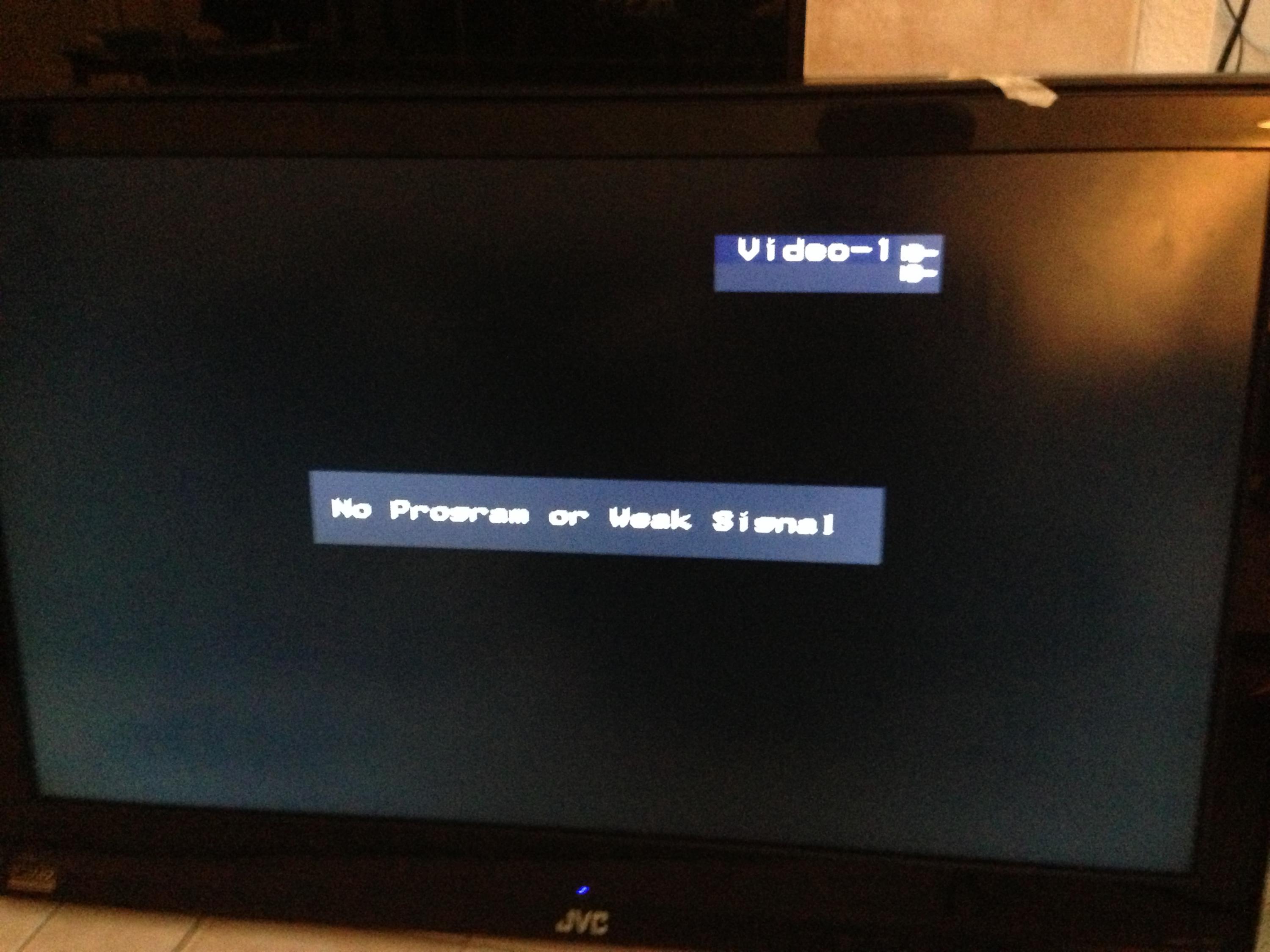

    But that's not all! One other weirdness that I discovered has to do with the HDMI inputs. With this TV, there's two "main" boards: analog and digital. The analog has the composite, s-video, component ports. Digital has HDMI, coax cable and toslink optical ports. Analog plugs into digital, digital plugs into T-con. When I'm on the TV channel input (cold start), I get lines. When I switch to HDMI inputs, I get NO lines but rather a no signal message (See Picture 3). When I then switch to other analog inputs, I get lines again. When I get the splash screen on start up, all the inputs show up normal. Confused yet?
    More notes: I tried to use the HDMI ports, but I can't get a signal to go through, which makes me think someone opened the TV up before and the photosensor screwed up the HDMI. I don't have the remote control to fix it, so it'll have to wait. The person I'm giving the TV to won't use the HDMI ports anyway, so it's a low priority.

    I would doubt it is a tab bond issue; even if you had not said anything about the analog/digital boards, the symptoms do not fit.
    There is probably a processor on the analog board which converts all the analog inputs to a single digital input, and this may be going bad.
    How about pictures of each of the major boards?
