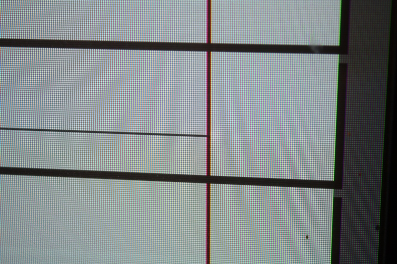

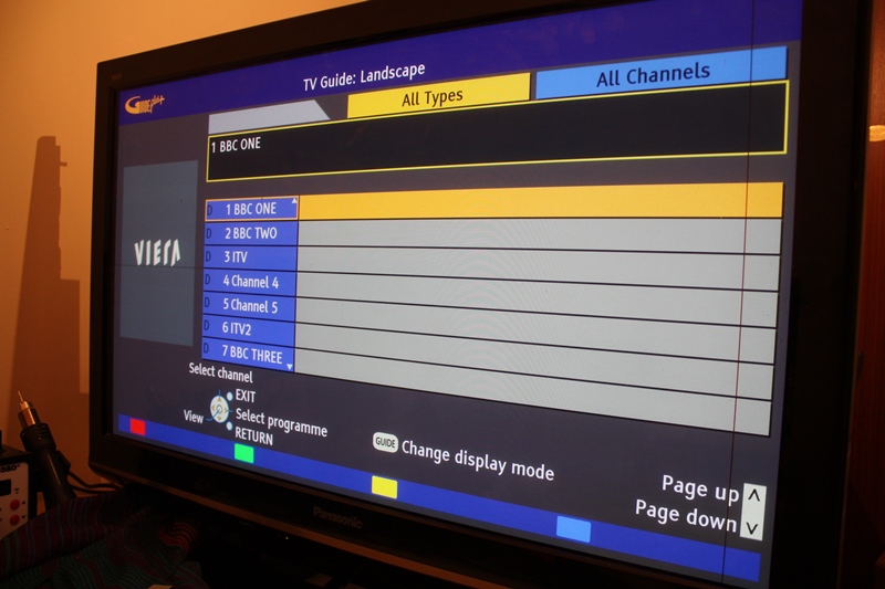

                                Hi all, I replaced the SD board and managed to get a picture up but I know seem to have a panel fault? There is a black horizontal stripe 1 pixel wide which stops just short of the right hand side of the screen and there appears to be an actual mark on the panel at that point when the panel is turned off, it looks like a tiny black fleck. There is also a red horizontal line that intersects the horizontal line where the mark is.
                                Pictures attached

                                  Well that's a lot further than I expected you'd get. I wonder if it's possible the panel is damaged from impact but all the gas did not escape?
                                  never seen a line stop like that horizontally, normally I'd be thinking a reseat of the buffer connector.
                                  At least you know which boards work now.

                                    Yeah its very strange that the line just stops, and you can actually see a physical mark with the panel turned off. The data connector on the C1 board I think it is on the far right where the vertical line is also gets very hot, I think if I understand correctly these have a chip on flex? and the large metal bracket is a heatsink?
                                    I've also re-seated the buffer connector a few times but it doesn't help.

                                      That is quite likely a panel problem due to misaligned electrode (factory defect)
                                      Page 53.
                                        Re: Panasonic TX-P42S11B - 7 Blink Code
                                        Page 53.
                                        Thank you for the link Tom, is this a problem you've come across before?
