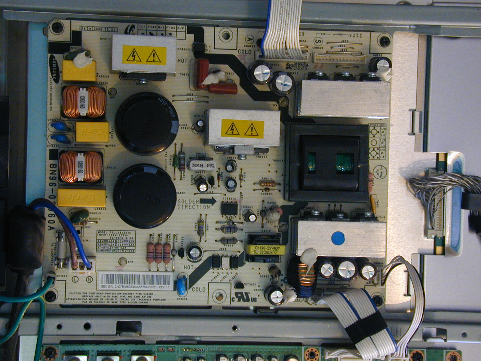

          Re: Samsung LN-S2651D Schematics needed
          Hi Tom66:
          I've looked all over the power supply board and the only number I see is
          BN96-03060A.
          See attached picture.
          Thanks for your reply.
            OK, what is the TV not doing? No indicator light at all? Voltage readings on the connector of the power supply board?
            • n1iwv
              • Jun 2013
              • 20
              When the TV is plugged into AC, the red power light blinks 4 times and the light will extinguish.
              After 30 - 40 seconds that cycle will repeat ...endlessly.
              Pressing the power button does nothing. No video, sound or back light.
              It appears that the TV never enters into standby mode.
              I have the service manual, but it provides no schematics.
              Initially I thought it might be the main board, but I measure the voltage on pin 1 on CNM801. It should be 12 volts, but I measured 13.8 volts.
              Now I suspect the power supply board may be the problem.
                Just a quick follow up on this repair.
                It ended up being the main board.
                Replaced it and the set is working fine now.
