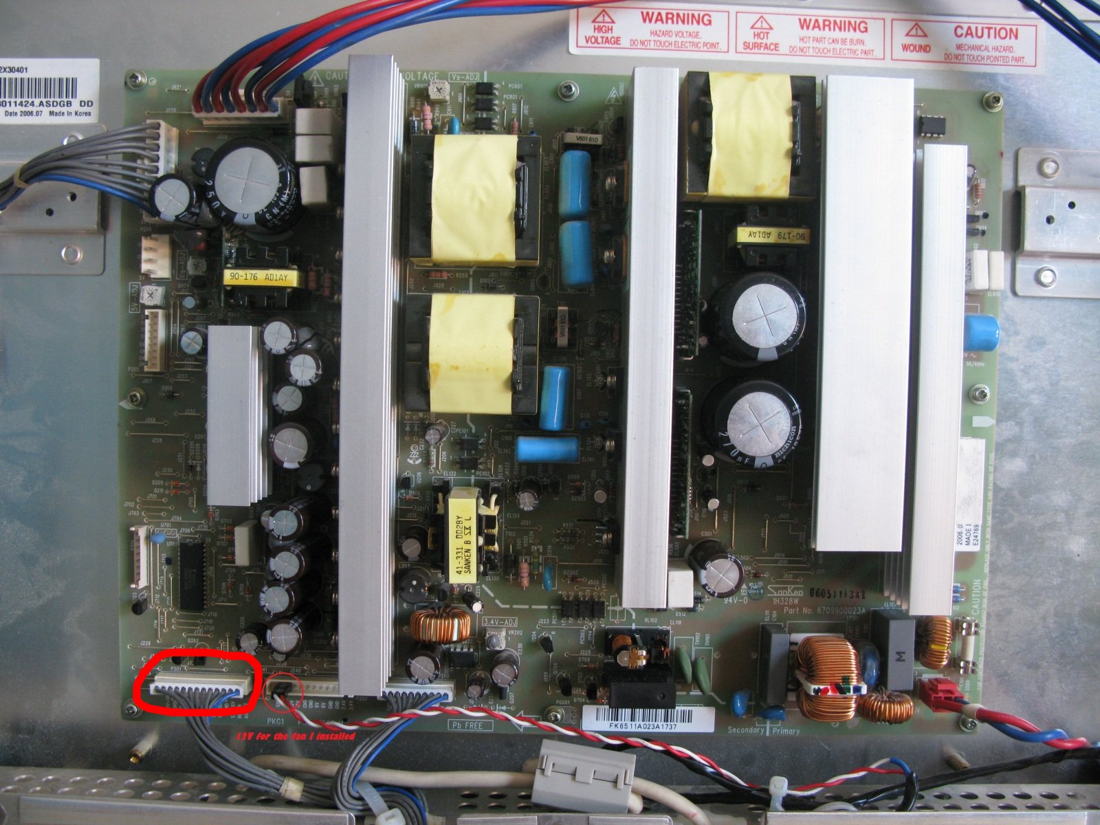

        Here are the pictures of the TV boards.

        The power stabilizer I changed on the power board:

          Your Z board is actually a Y-sus and the Y board (with your added fan) is a Z-sus
          OK, here's a connector on the board.
          There's a pin marked AC-DET. While the set is operating, measure the voltage on this pin. To do this, set your meter to 20V DC range, put the black probe on a part of the metal frame, and the red probe should touch the metal sheaf around the pin. Connector must be installed and the TV should be working.
          If at any point it drops out, this may be your problem.
          You may find it convenient to put a long wire in the connector and set the meter up outside the TV and monitor it while watching the screen.
          And please also check it while it won't turn on at all.

            I have measured the requested data. There are 13 pins.
            Results:
            Declared in order:
            3.3v | G | 6 | G | G | 5 | 5 | 5 | VS | G | 5 | RL ON| AC Det|
            Measured:
            4.7v | G | 5.66| G | G | 4.7 | 4.8 | 5.1 | 4.8 | G | 4.7 | 4.8| 4.5|
            From this data, I have noticed only a strange reading from 3.3V pin to 4.7V.
            Is that maybe the problem?
            The AC-DET pin, the last pin, is pretty steady at 4.55V, sometimes it goes to 4.54V or 4.56V but only for a moment.
            The problem usually manifests after turning the the ON - OFF. After you shut it down it wound turn on for a while. I have done this now a couple of times, (ON - OFF) and it works now but the AC-DET pin now has 4.4V.

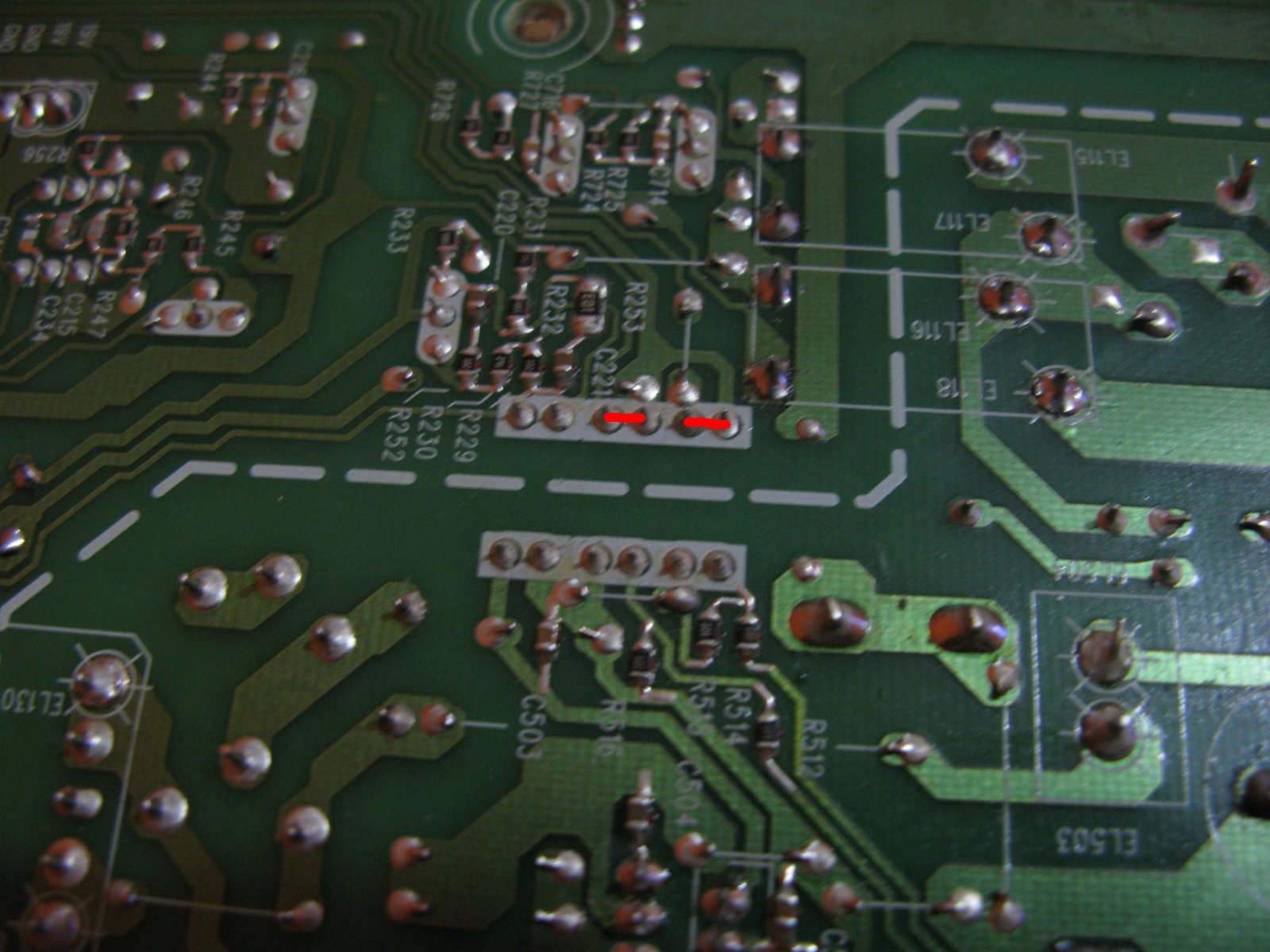

                              You would appear to have an AC detect fault then, good, this is usually easily cured.
                              Can you provide a picture of under these components?

                                  Here it is:
                                  Except for one suspicious soldier point (maybe it needs to be re-soldered) I see nothing strange.
                                    Re: Lg Plasma TV problems
                                    I don't know how fast Serbian internet is, but please stop adding photos directly to posts. Just attach them. My 1Mbit internet spent a minute loading this page.
                                    Place solder joints across the indicated points, which will inhibit the AC detect feature.
                                    Disadvantage with doing this is the speakers can sometimes make a noise when the set power is unplugged while running. However, aside from this, there appears to be no disadvantage from doing the AC detect mod.

                                      You mean to join this pins??? I am a beginner at electronics and I have to ask I always fear for the worst case possible.
                                      Are you sure this exact pins? because the board is upside down.
                                      If I do this, it can`t explode or something ?
                                        I've done this repair before, as have others, but only on different power supply boards in similar LG models. I haven't blown anything up yet, neither have others. However, with any repair comes the risk of failure or damage, and I can't guarantee 100% success.
                                        Yes, you need to bridge the two points I have highlighted with solder. Be VERY careful not to bridge any other two points.
