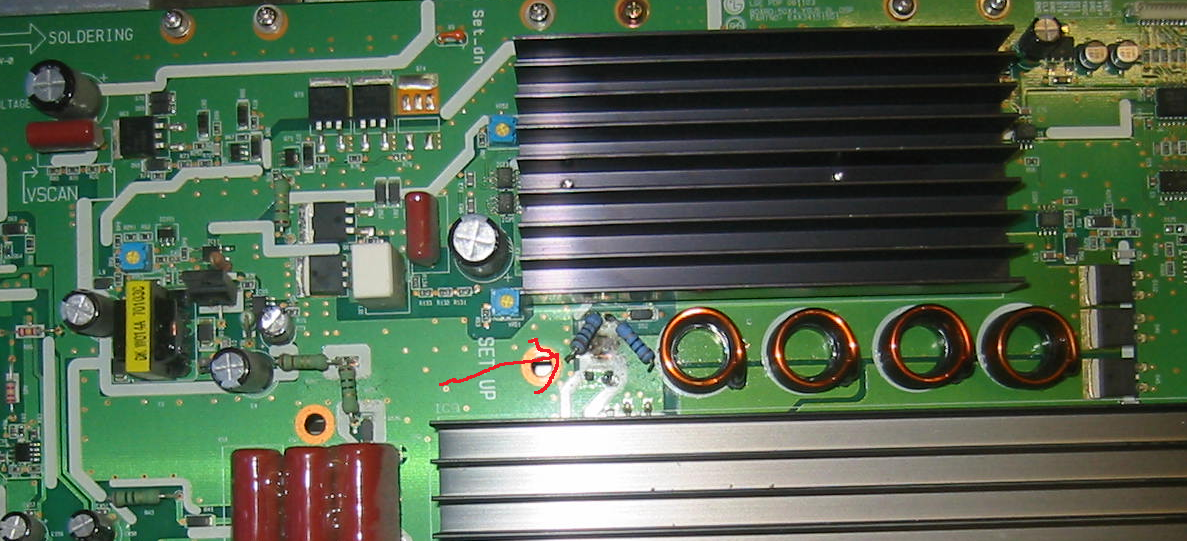

    I am working with Vizeo plasma VP50 hdtv10A .2 resistors fuse on ysus board that show in picture are burn open.
    I think the the IPM with small heatsink is bad.I order the IPM install to the y sus board and then I
    test tv with y sus but without buffers. 2 resistors fuse are ok (buffers are disconneted from y sus)
    . Anybody know how to check the buffers for shorted.please.I do not want spend another IPM (expensive they sold it with heatsink)
    Buffer # 6871QDH115A, 6871QDH116A Thanks

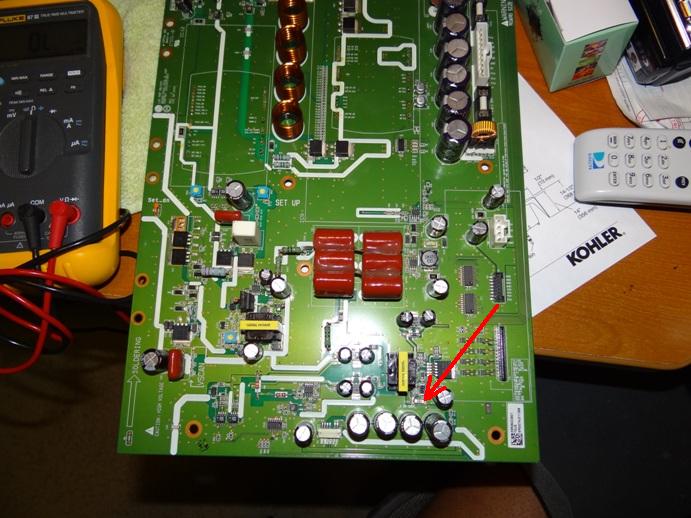

    Re: Vizeo plasma VP50 HDTV10A IPM of Y sus burn
    more pictures

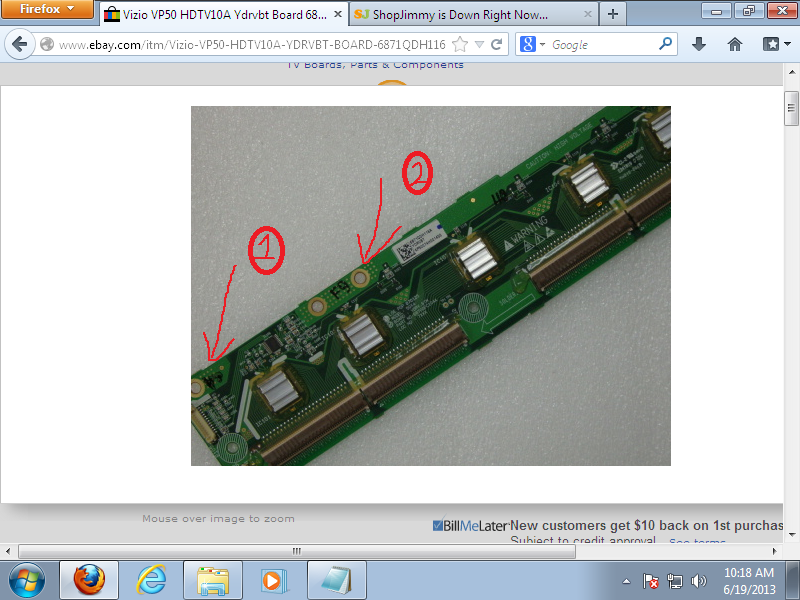

          I believe you can do these tests on the buffers:
          - Place your leads on 1 and 2 in your picture, respectively, then swap them. You should see something like 0.67V in one direction and "OL" in the opposite direction.
          - Place your negative lead on 1 in your picture then run your positive lead along the pins at the ribbon connectors to look for shorted chips.
          The one thing I've found with these buffers is that the chips don't always completely fail. My boards showed horizontal lines on the screen. I replaced the chip on one of the buffers, but I think I may have had another failed component on the buffer. So, you may need to get your Y-Sus back to working order to fully test out the buffers.
          Did you check the mosfets under the heat sinks on the Y-Sus and other nearby components when you removed the IPMs? I'm assuming you replaced the resistors that burned. My Y-Sus was so far gone that I had to replace it with a brand new one - paid about $120 for it.

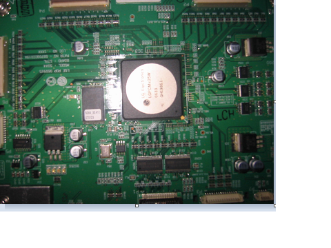

                      Update image of logic board. I do not see any jumper.

                                - The R85 resistor appears to trace back to the second pin from the bottom-left of IC18.
                                - The first pin and third pin from the top-left of IC18 trace back to C153, C156, and so on. If you turn the board over and follow the trace the opposition direction, you'll also see that these items are in circuit with C66, which is near the "SET UP" pot.
                                - T101 traces to D113
                                - YSUS_DN(-VY) of the the left-hand IPM traces to the left-hand lead of R63.
                                  As I understand T101 produce -vy. I do not have voltage at D111 and D113.
                                  I do not have -vy at R63.
