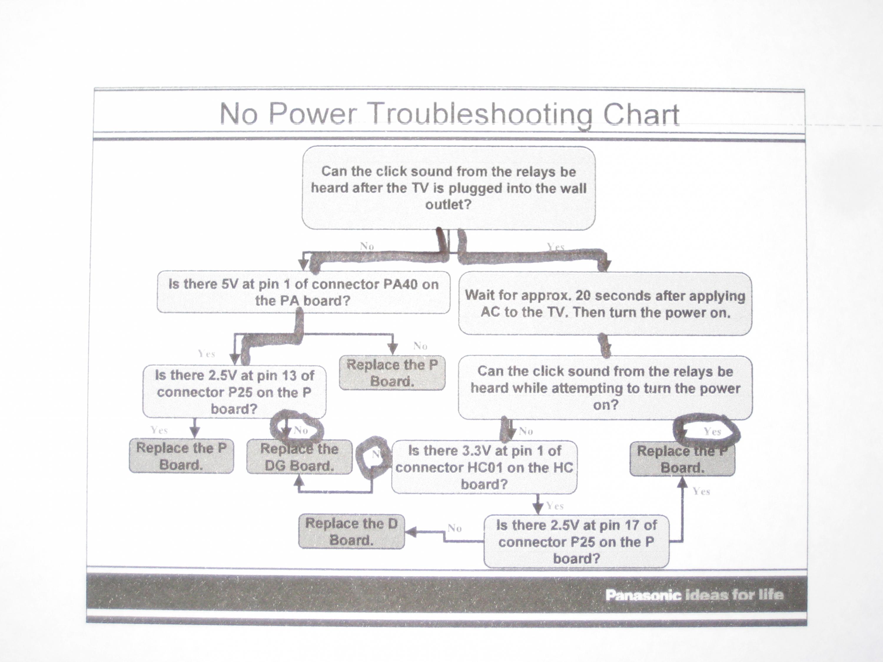

    The TV was not working today so decided to troubleshoot. I followed the "no power troubleshooting chart" in the panasonic training guides found http://www.tgohome.com/ServiceManual...&Search=Submit.
    1) can NOT hear the click of the relays after TV plugged in (BTW, when the set does work I DO hear the click of the relays after plugging in)
    2) 5V at pin 1 of connector PA40 on the PA board was fine
    3) 2.5V at pin 13 of connector P25 on the P board was not there. Meter showed 0V.
    The guide says to replace the DG board. Is it really that simple? Can I trust this guide? I would appreciate some insight from others who have used the guides.

                Basically, per the troubleshooting chart I have seen 3 different paths as shown in the attached image. If I believe this it tells me to replace both the P and DG boards.
                Is there anything specific I should check on either of these boards? The DG board is buried but the P board is easy to check?
