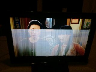

    Toshiba 32in LCD lines on screen
    Hi, anyone encounter this on a 32in Toshiba 32AV502R LCD TV? As you can see from the picture, 75% of the screen has these white lines from the bottom to near the top of the screen. Picture still comes through. Possible bad enverter or T-con?

    Re: Toshiba 32in LCD lines on screen
    So, does anyone have any suggestion?
      I am going to say panel, possibly tab bonding.
        So, is it fixable? I noticed the screen where the white image appreared will go dark and black out also. Is that a sign of a bad panel? Or possible T-con board?
          Maybe, maybe not. Can't tell for sure, but it looks more like panel than t-con to me. Many videos on youtube about tab bond repairs...
            Ok, I check it out, thanks Tom for your help again!
