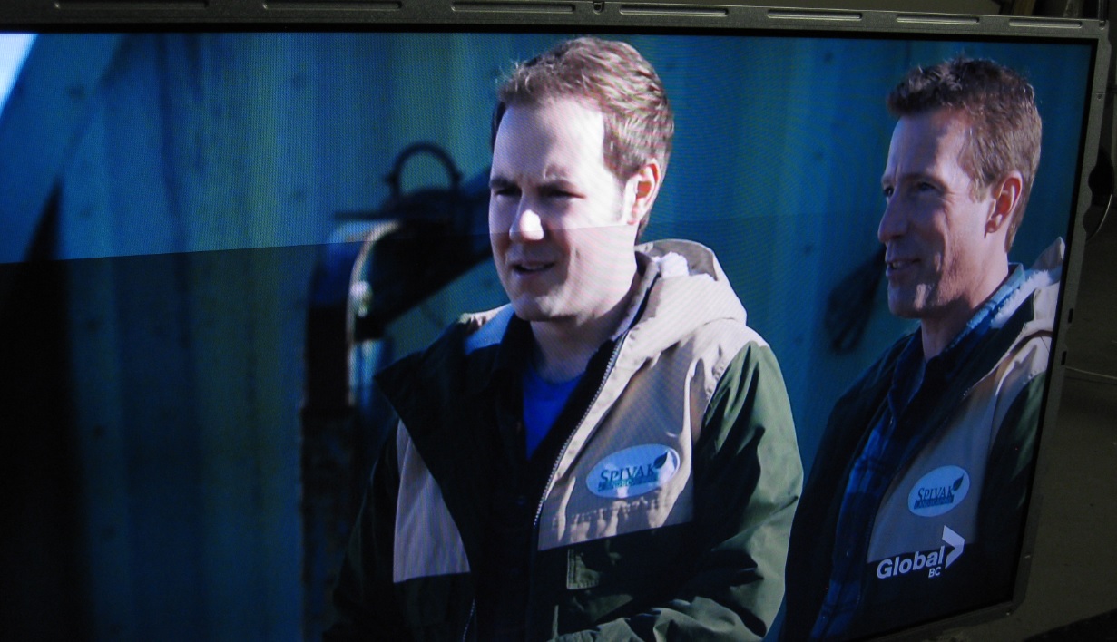

    Sony KDL_52W5100 horizontal bar
    Sony KDL_52W5100 horizontal bar, as picture shows, it's stable, no slow motion, the 3/4 of lower screen is darker then the 1/4 upper. I tried to check and press pressures on the TAB bond cables, no change.
    I disconnected the left side of the t-con cable to the panel (the right side screen shows only, normal), the darker part looks not as serious as two t-con cable connected.
    I disconnected the right side of the t-con cable to the panel, (it should show the left side of the screen), but only left half of that 1/4 upper has picture, others all black, this make me confuse, as right side t-con controls the right screen, the left side controls the left, but this this t-con is different?
    The t-con part number is 52UN_MB3C6LV0.7
    Wondering if bad panel or t-con problem.
    Re: Sony KDL_52W5100 horizontal bar
    I'm going to say tab bonds as I have seen before, even if you have checked them. If not, it's the panel.
