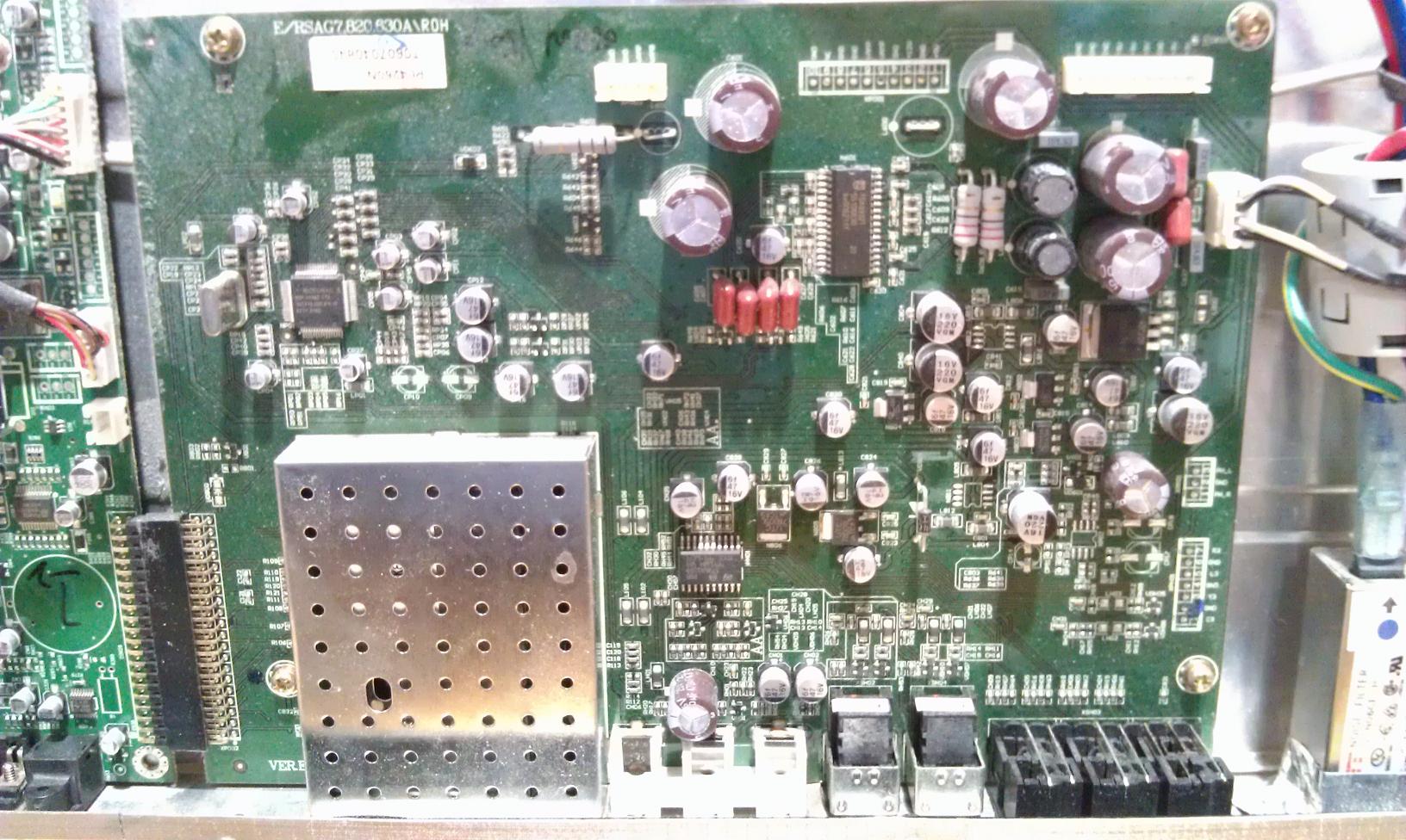

    I would like your recommendation to where I can purchase one or more of the following boards.
    1)The control Board = LGEP 060106; Model 42V8&3; patr 6870QCH006c
    2) The input(main?) = E/RSAG7-820.672A\ROH
    3) TUNER = E/RSAG7-820.630A\ROH
    4) ZSUS = 6871QZH956A; PD42065K033414
    5) YSUS = 6871QYH953A; PD42065K034637
    I did not include power supply since it appears it is functioning as it should.
    I got pictures of the boards if needed.
    Gentlemen and any ladies I will entertain any comments/suggestions/help I can get.

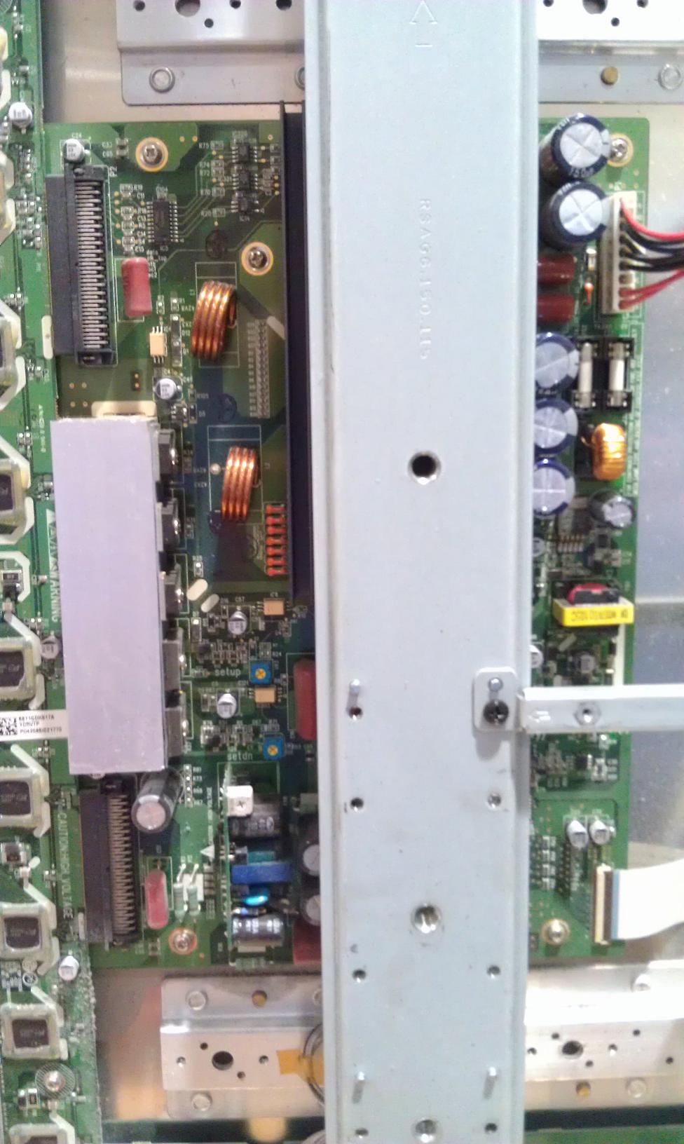

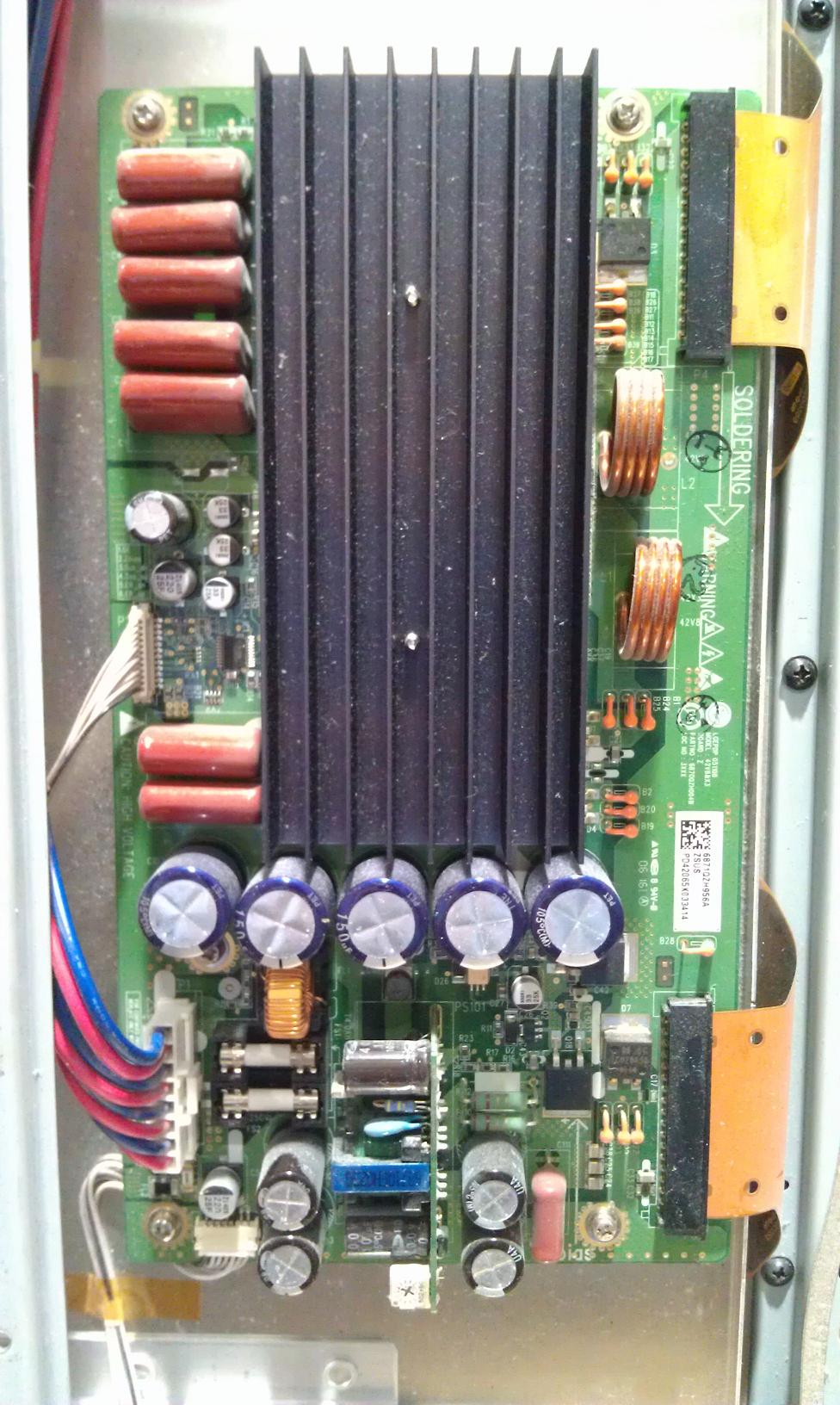

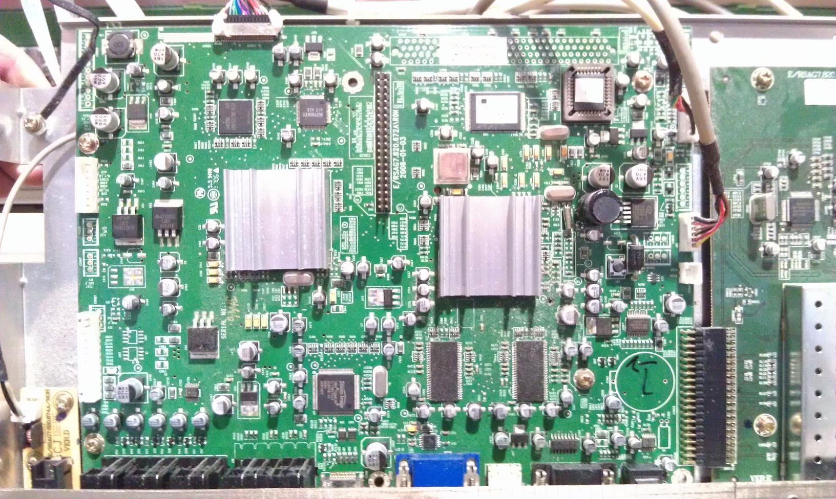

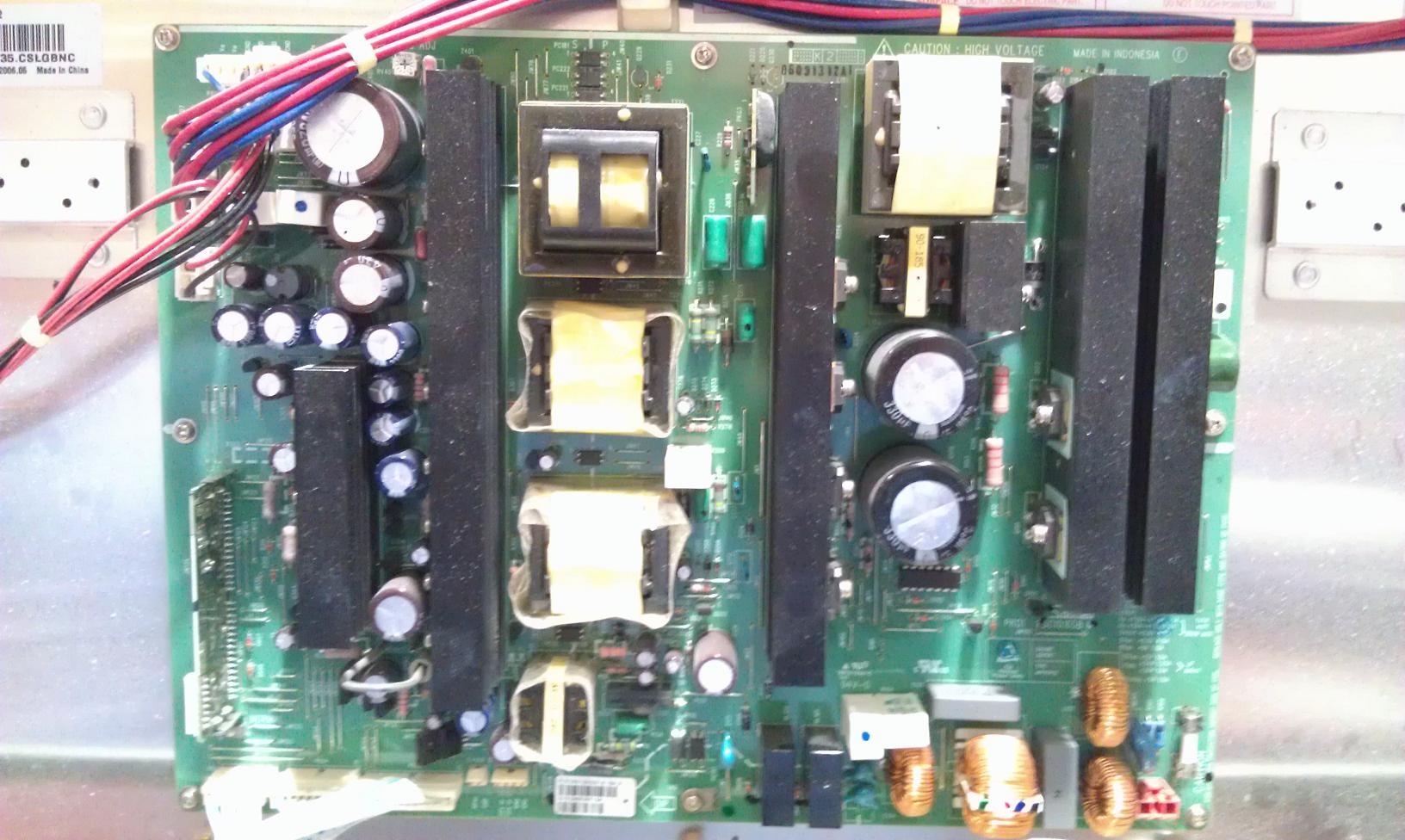

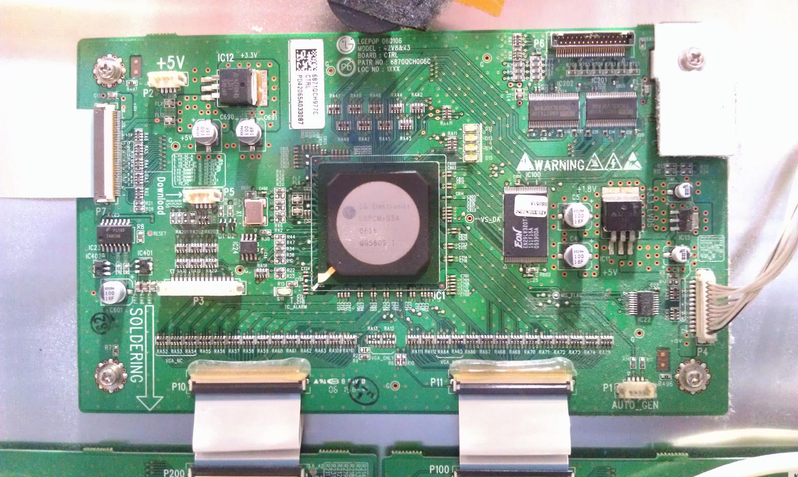

    Here are pictures off the boards. I apologize for the one sustain board covered by the bracket. I'll try to get one without.
    The Ysus looks exactly like this one http://www.shopjimmy.com/lg-6871qyh9...main-board.htm

        In picture 2 on the logic control board at P6, the LVDS cable, was that disconnected just for the photo.
        There's a number of threads about no picture for HP pl4260n, try a search using pl4260n, maybe there's something in there.
        Those IPMs on the sustain boards are a common fail in LG.
          Yes, I had to disconnect them. The board was under the input/tuner boards. I didn't want connector pins to get bent from the weight of those two boards.
