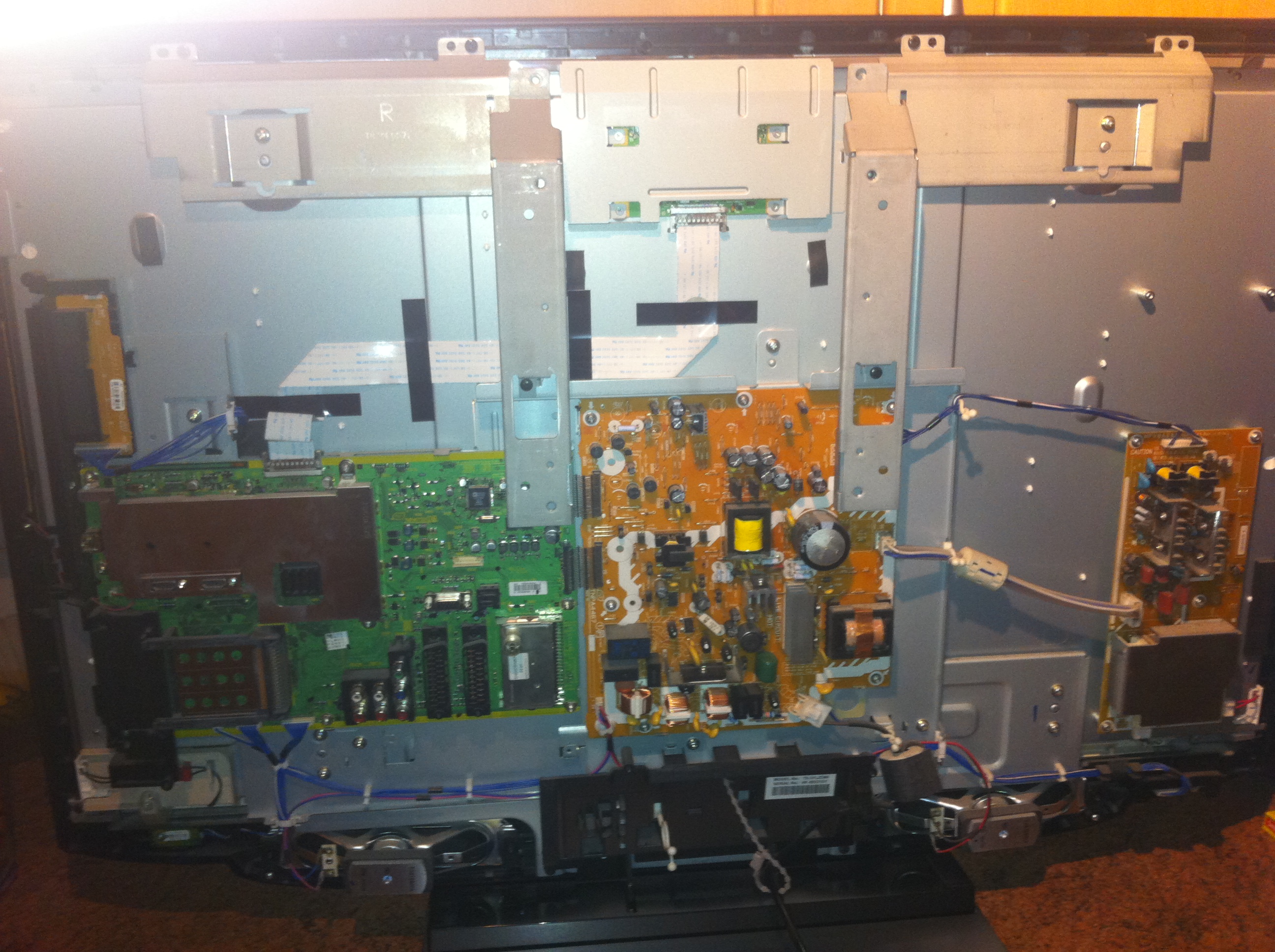

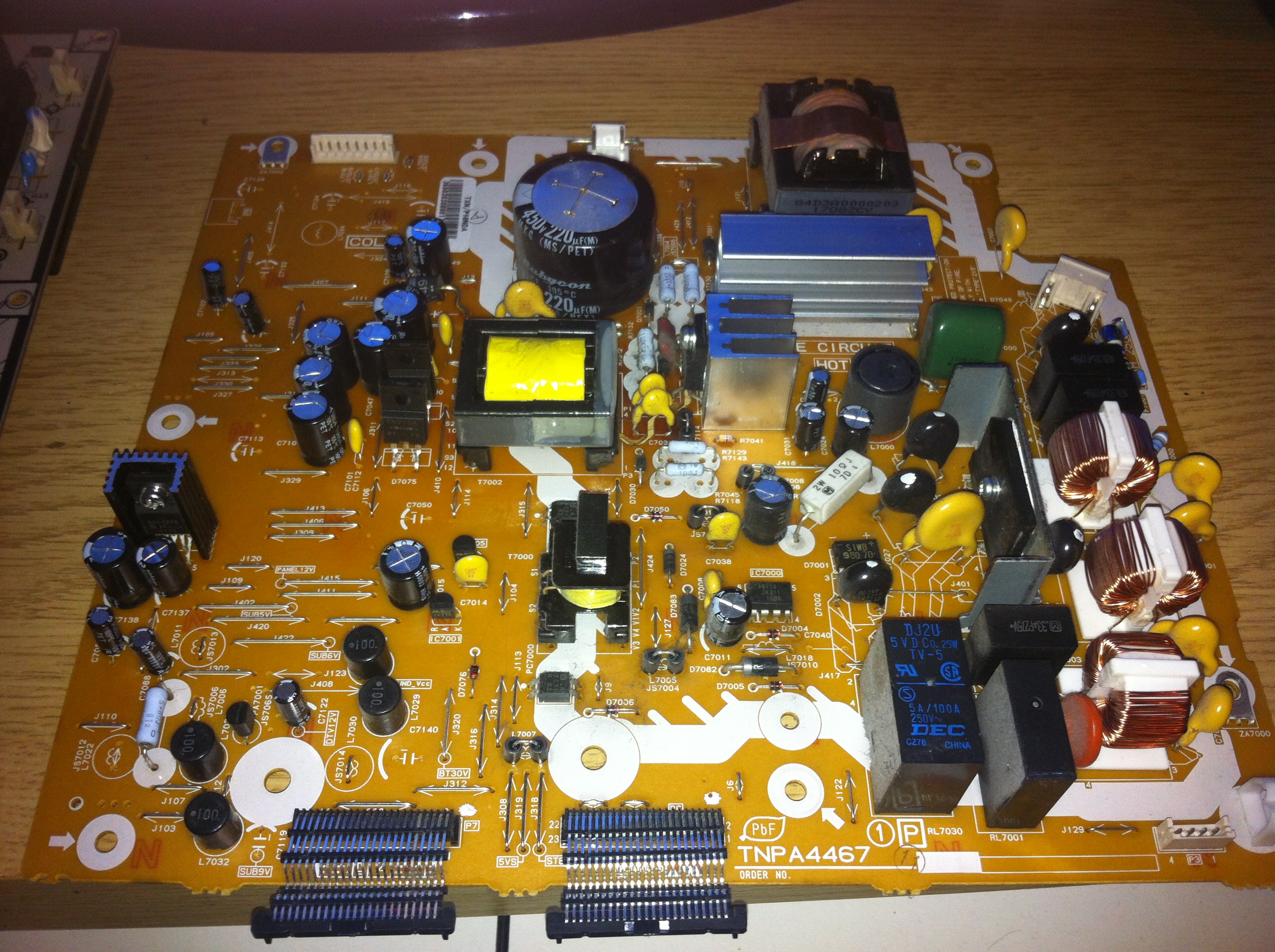

    no power what so ever any ideas ?
    pictures attached
    Re: Panansonic tx-37lzd80
    What have you tested?
    Main primary cap is bulging so I'd consider blown fuse and bad primary cap, possibly bad PFC circuit (Same as Samsung you are working on.)

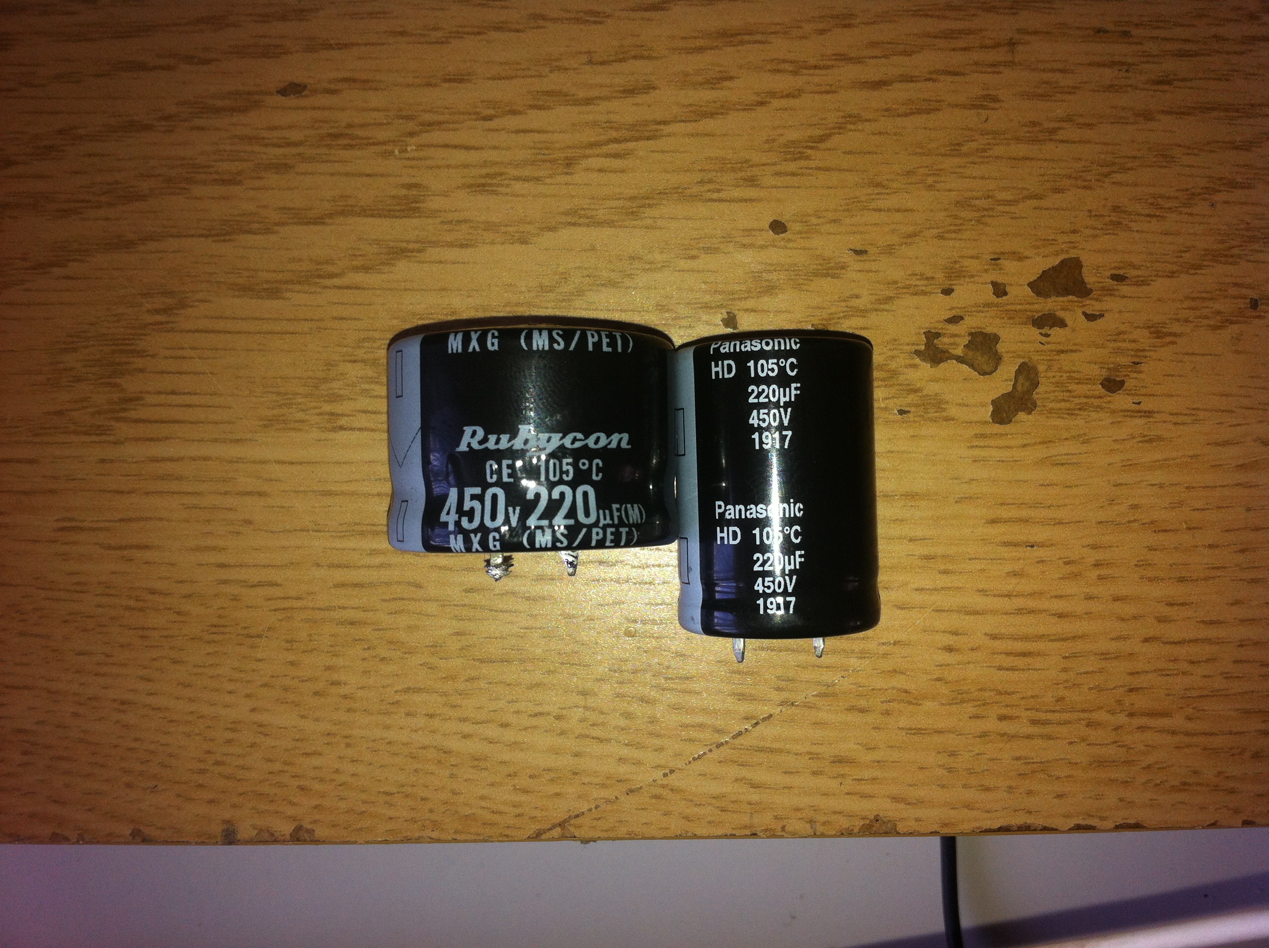

      i already have replacement caps same rating but alot smaller than the original ones would they be ok to use ?

          That cap will be fine. However, you will need to replace the PFC FETs and some other components.

              You can just buy the kit for £40 or work it out by using the same testing method I went through with your on the Samsung.
