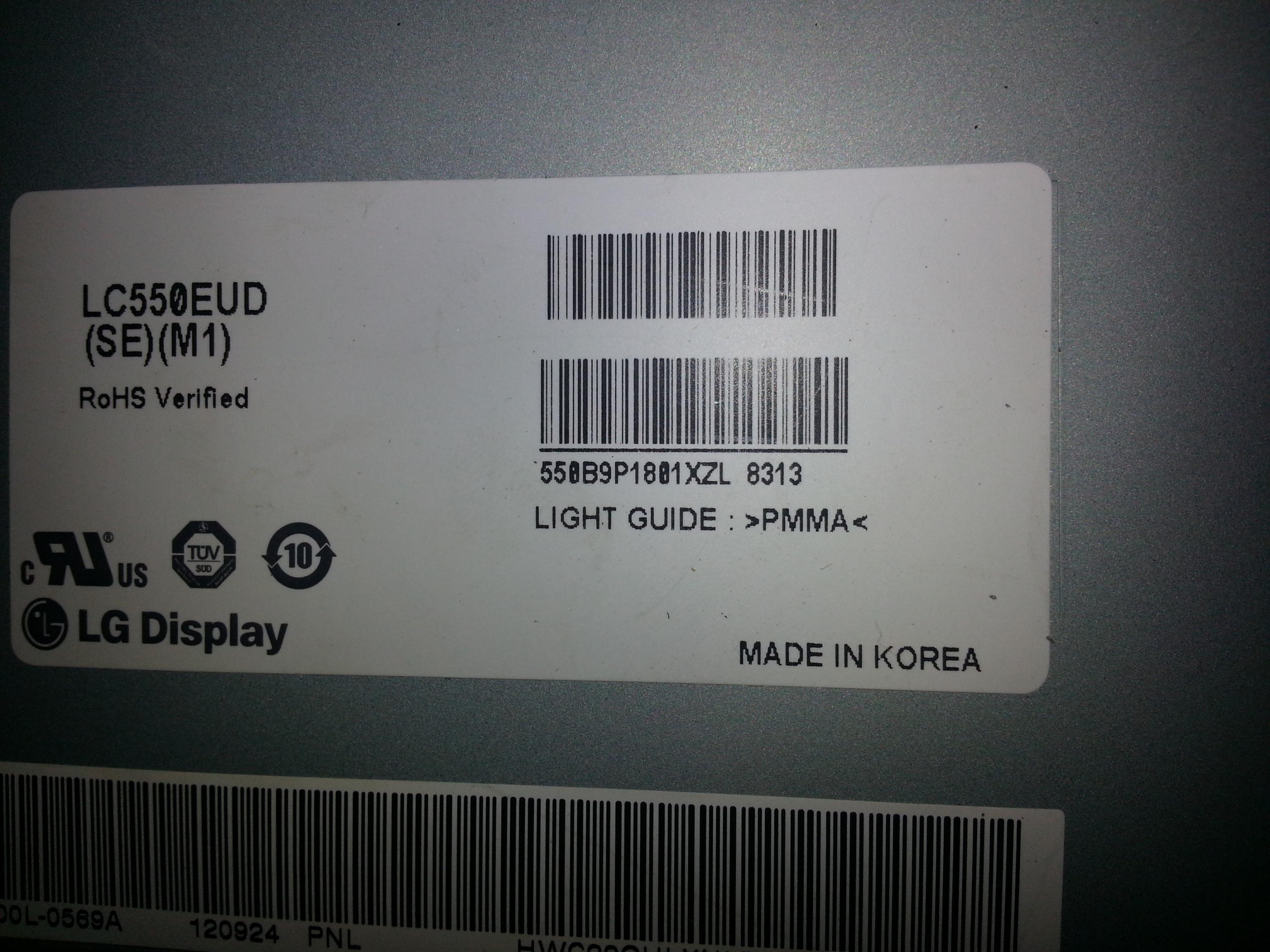

    LG Display model - lc550eud(se)(m1)
    This is a custom 55" modified as a 55" touchscreen computer

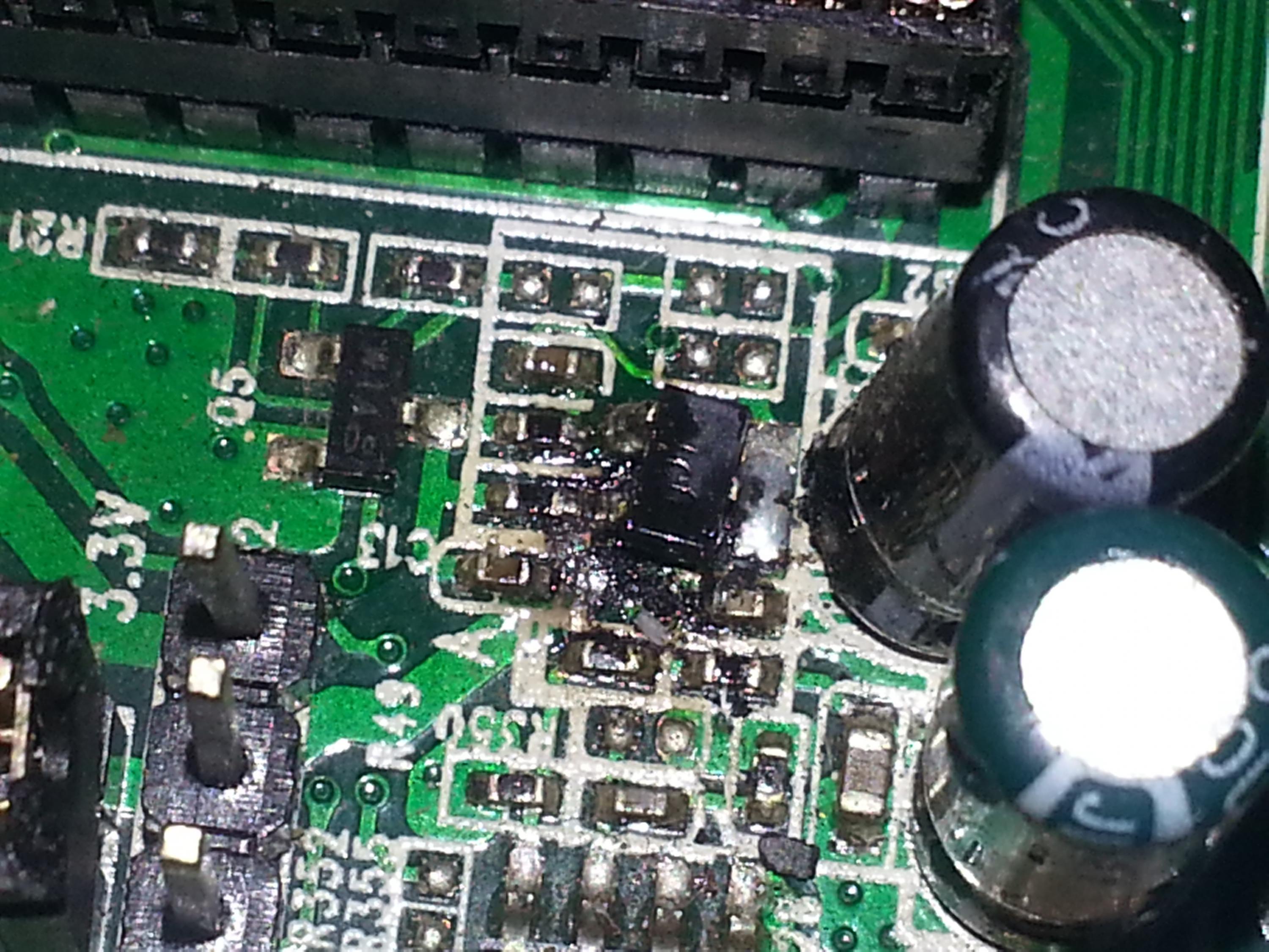

    Here is a pic of what I found on the mainboard
      Re: LG display sporadic screen issues
      That looks to have been reworked. Possibly factory original.
      • thedosmann
        • May 2013
        • 24
        I deemed as bad. What you think?
          It just looks to be coated in flux to me, and the flux has dried up leaving a brownish/blackish residue. While it could be bad, I can't see a component failing violently (and permanently) causing an intermittent issue. I would be considering the LCD panel itself -- possibly a tab bond fault.
            The replacement board looked no where near that nasty at that spot and the cap right beside that bit of ugly shows heat at the bottom but I'm leaving it up for a few days so if it goes south again I'll look next to a tab-bond issue. Thanks. I'll have to study up on what a tab-bond is.

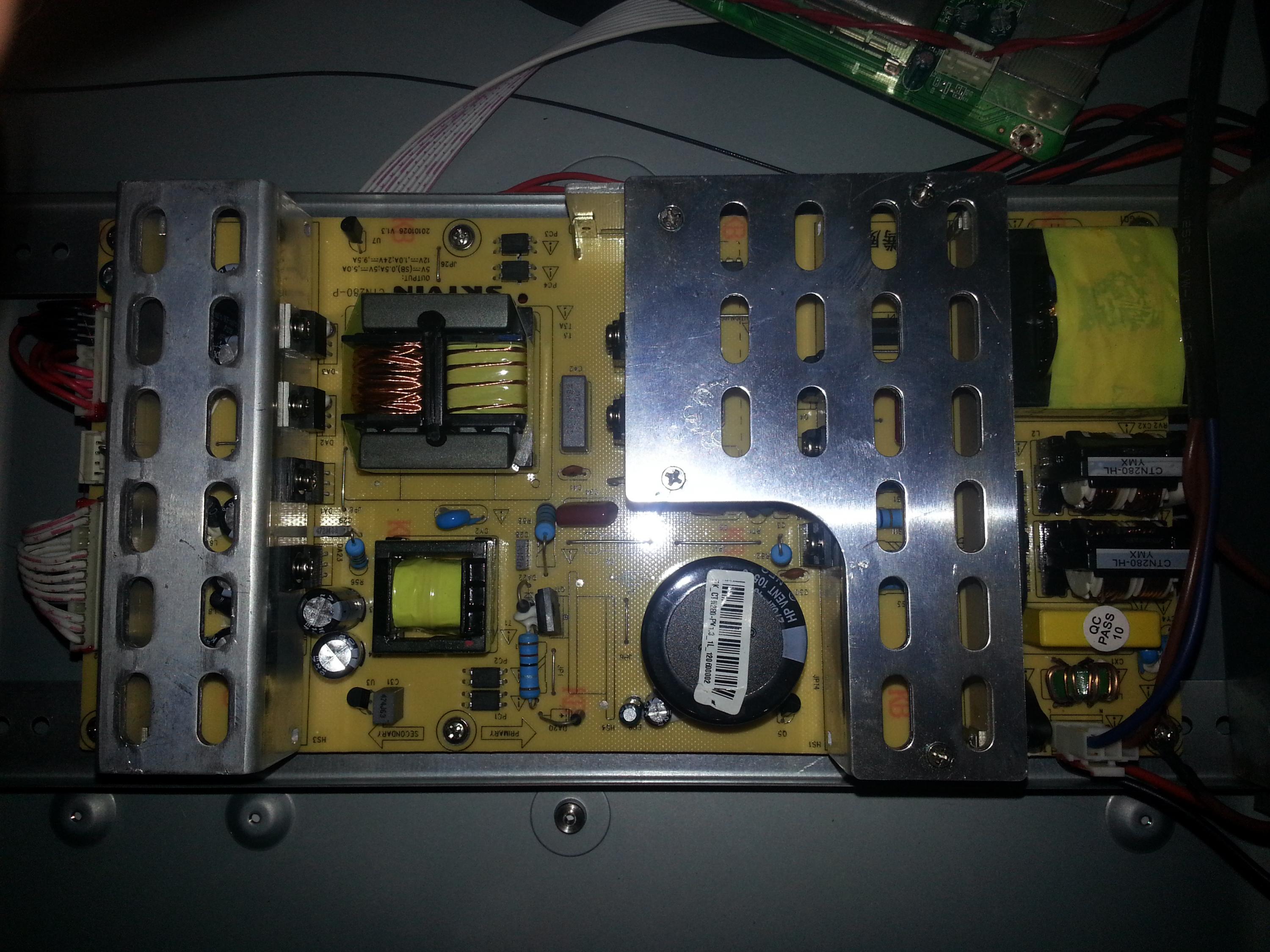

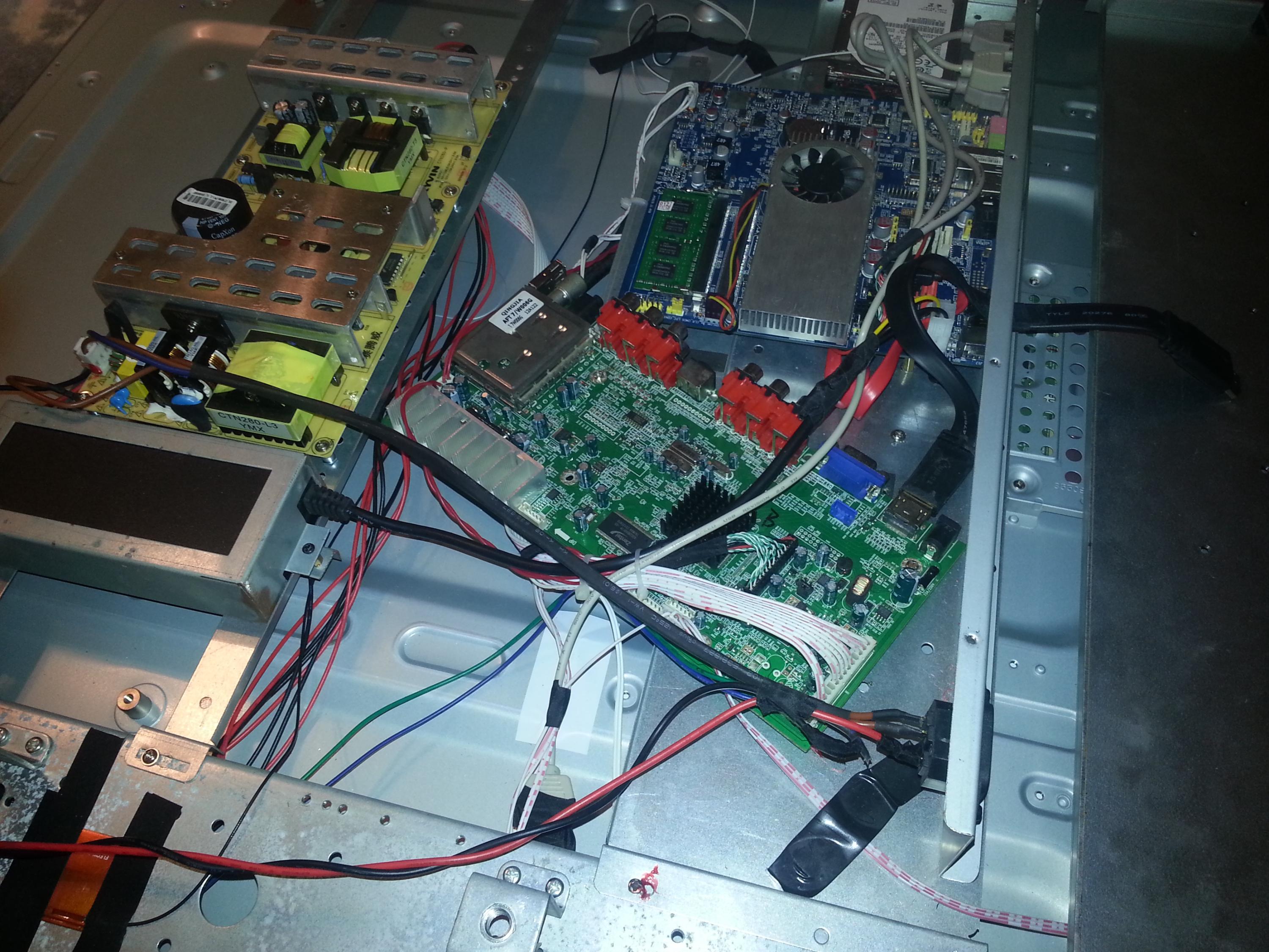

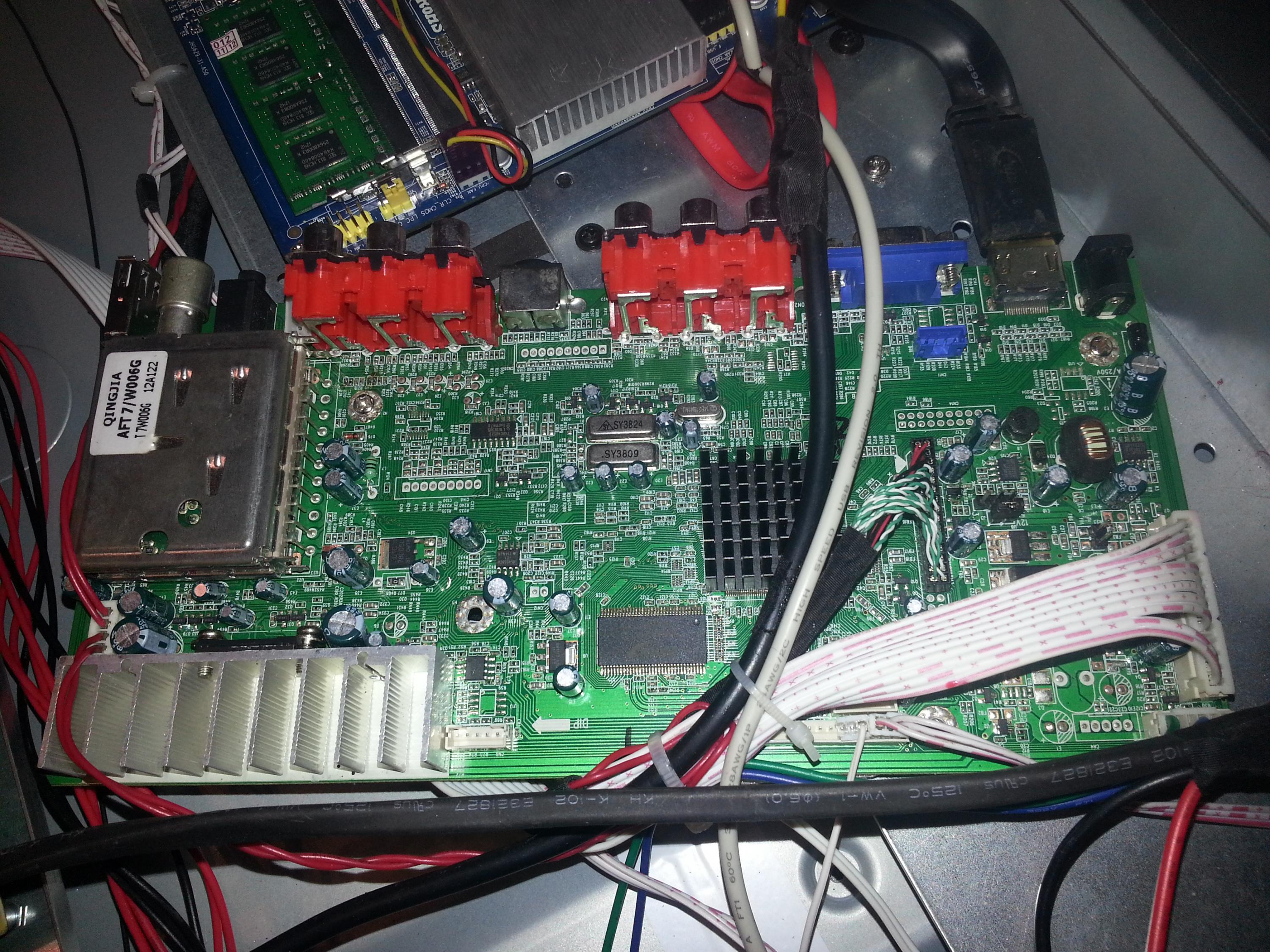

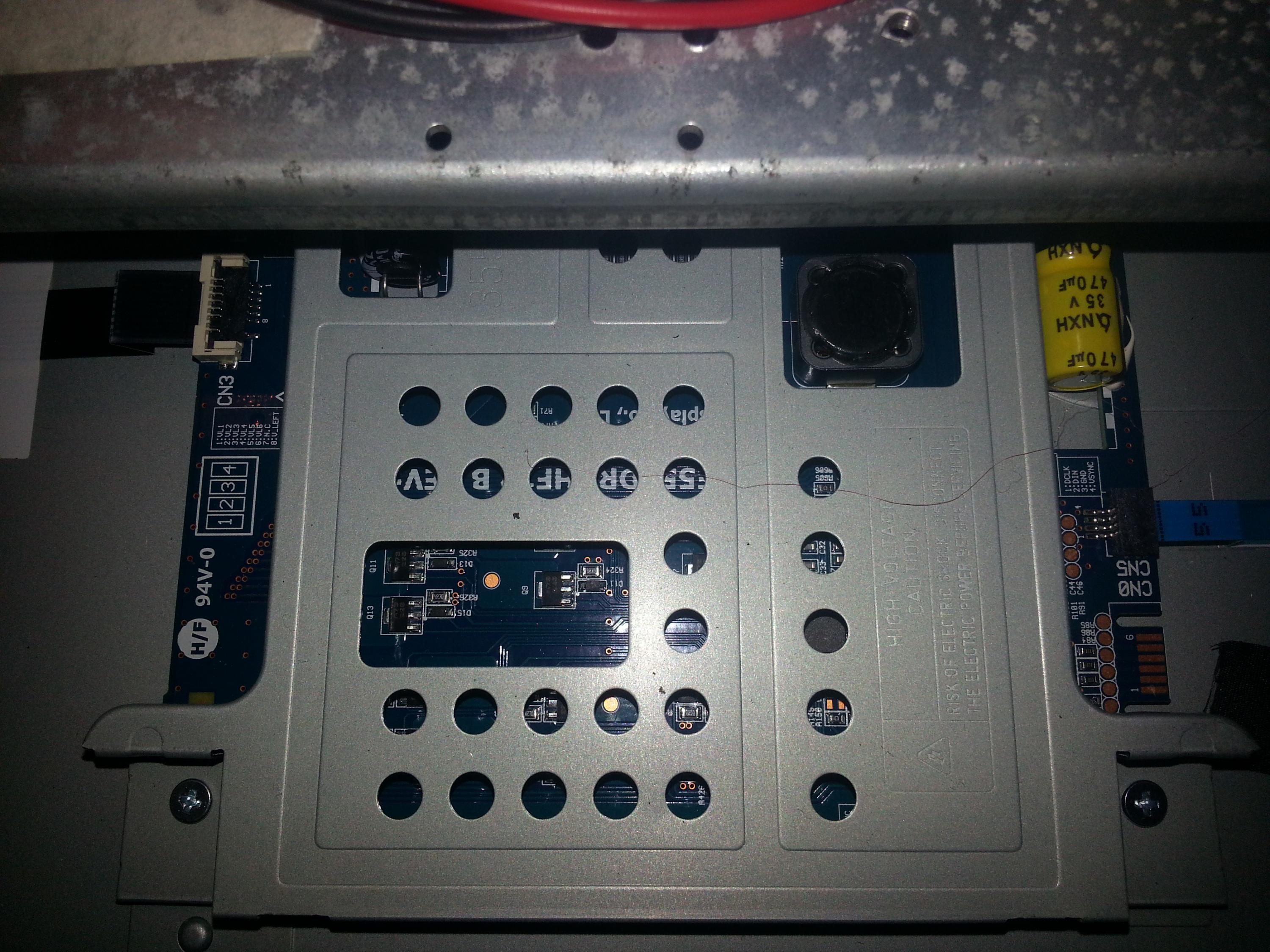

                    Below are some pics of the boards. When I power on it shows a white screen that goes to black in a few seconds. Either the component that was going out went or its another issue. It only stays lit for a few seconds but I can see the power down countdown just faintly before it goes black sometimes.
