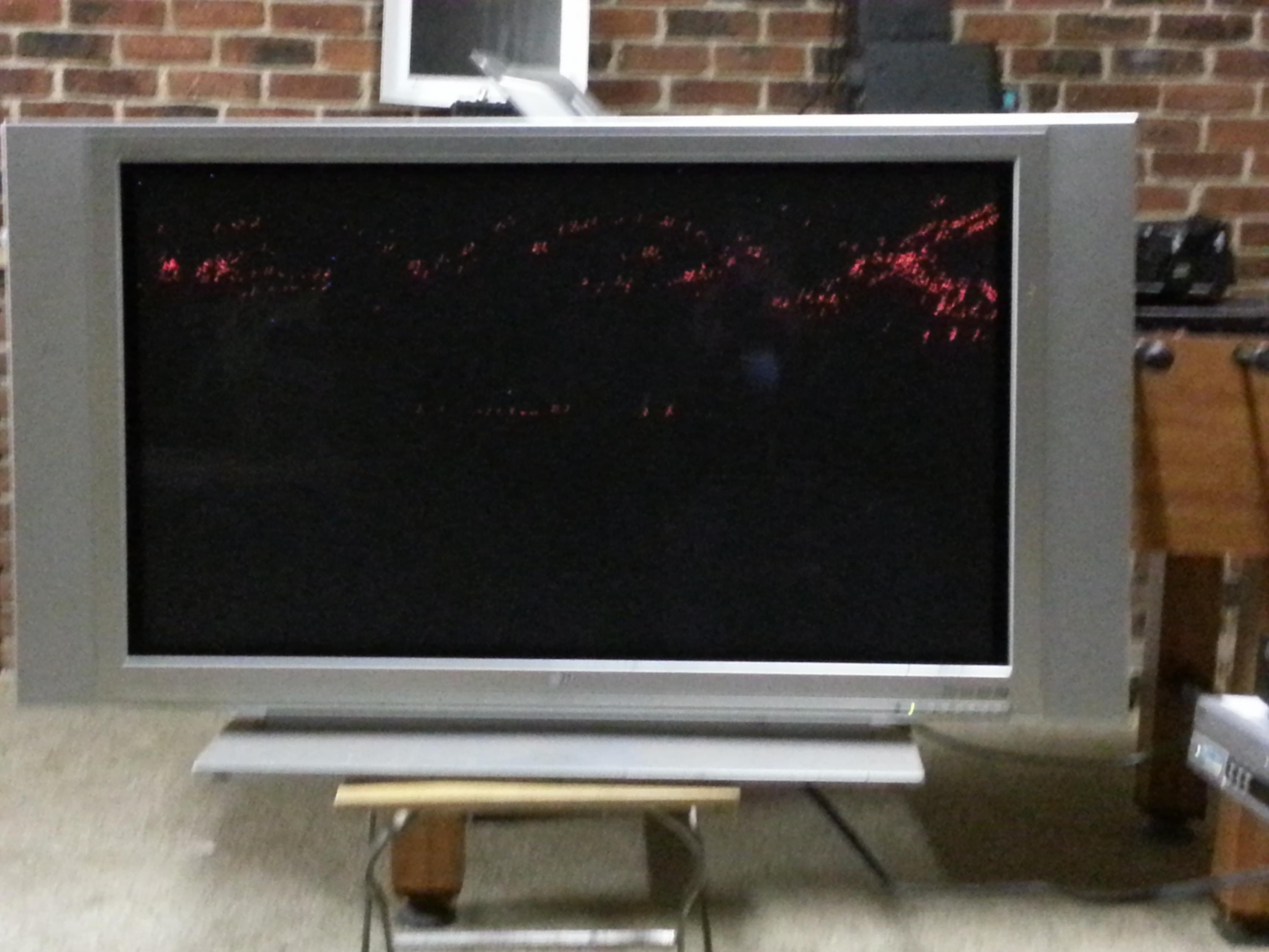

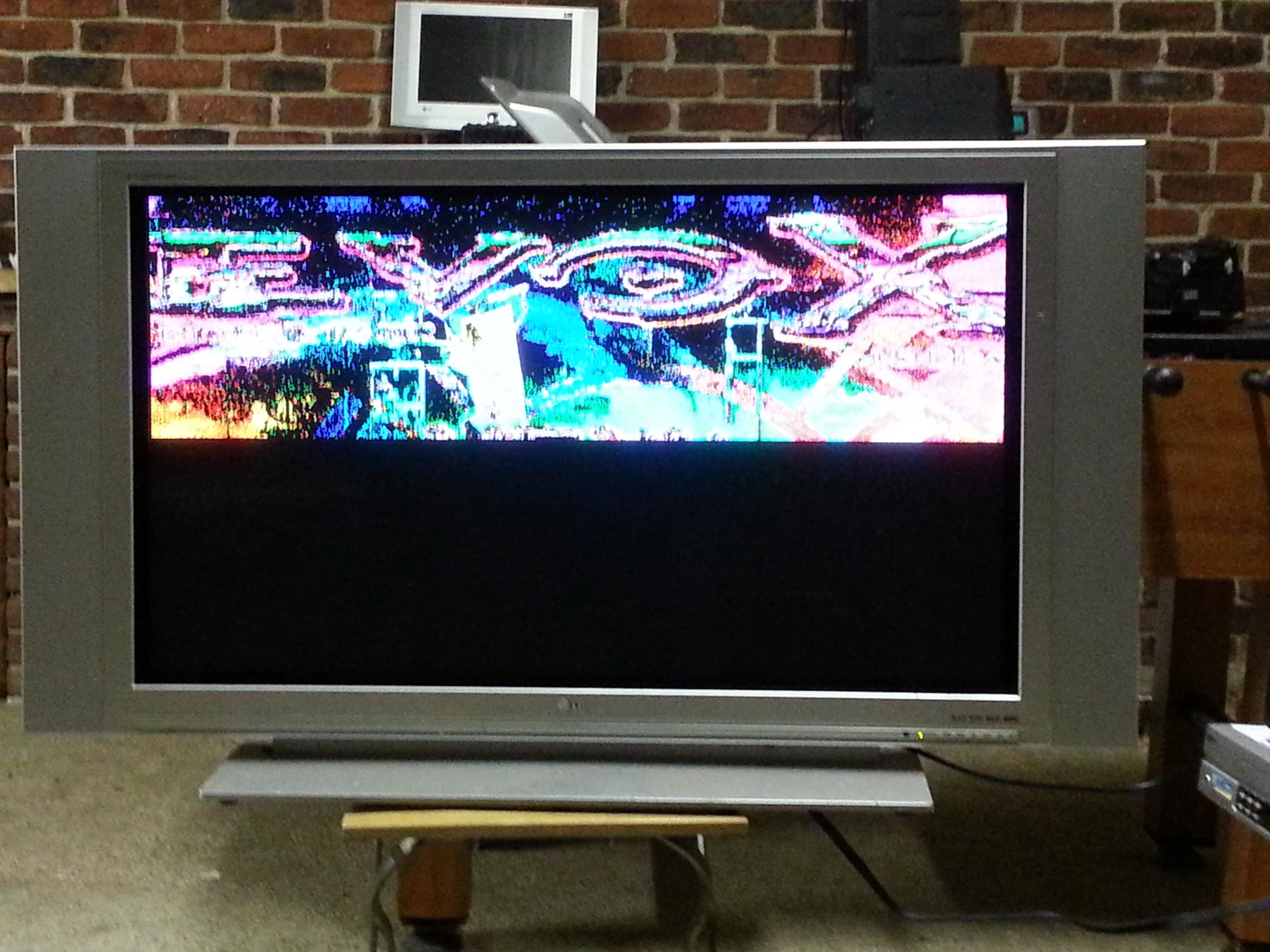

    i dont have model numbers for you but... i have this 42" LG Flatron that works fine, but after about 15 mins (when it gets hot i believe) it starts acting weirdly. the image starts going rainbow coloured (while still retaining the underlying image)(hinting that the Sync is all fine right???) then after that the entire image goes a deep red, then finally the screen goes black (while still doing that fuzzy thing that all plasma's do, with a bit of red). any ideas whats wrong at all? just looking for a general idea...

    I'd post the model, pictures of the problem, pictures of the boards and the board numbers. Someone may recognise the symptoms better that way.

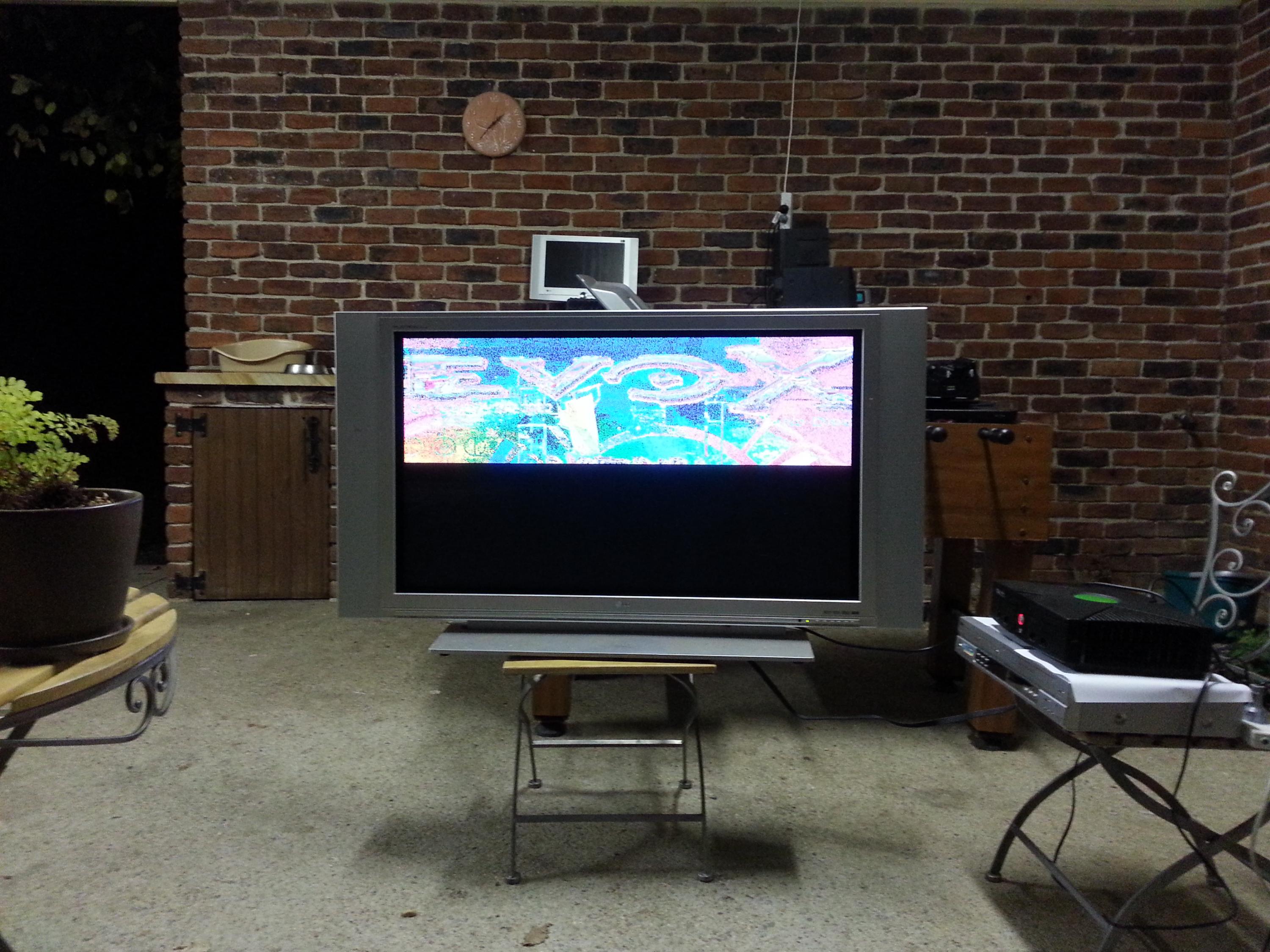

                    ok i measured my Vs and it seems to be 183 volts... despite the panel saying 160v??? and i tried swapping the y-buffers, the lower buffer made it go all rainbow by itself, the upper normal. but the symptoms reappeared with the upper after 10 or so minutes

                            I'd still expect a good image with Vs of 183V, though it may have a prominence of dead pixels. Not your rainbow effect.

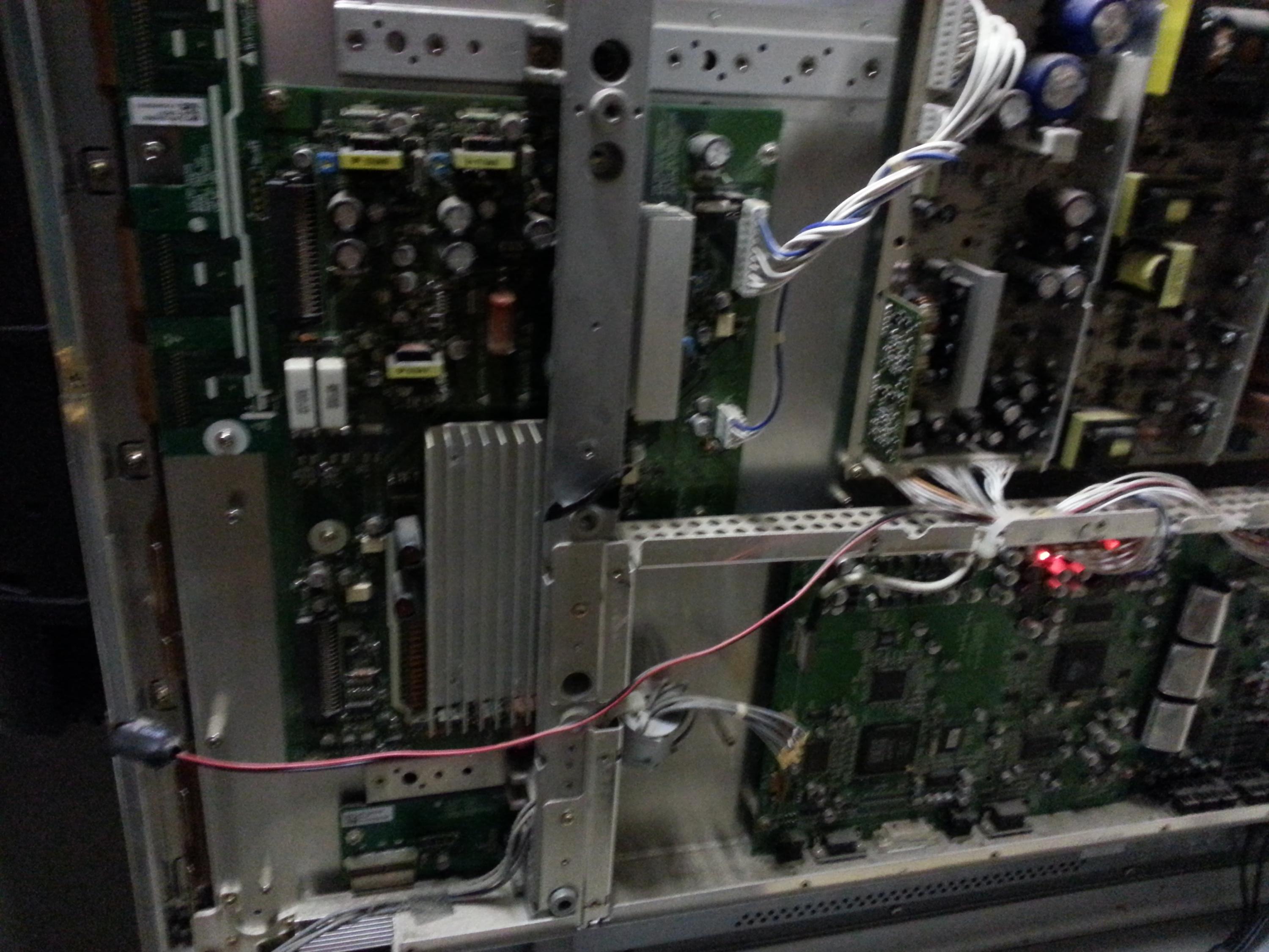

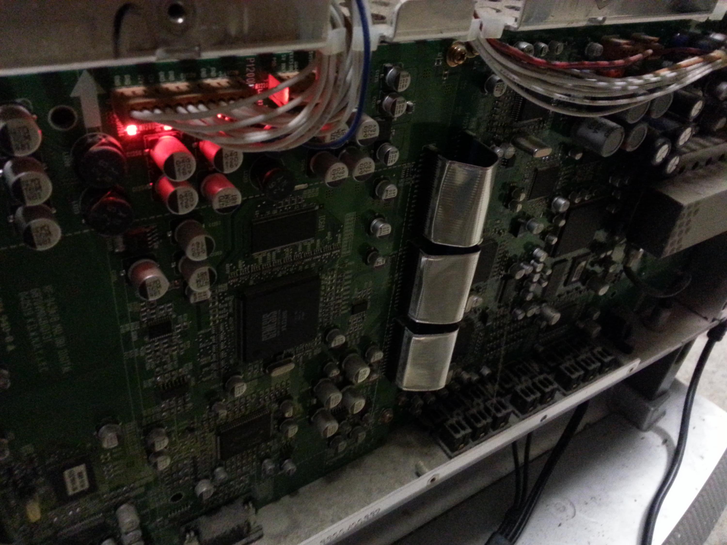

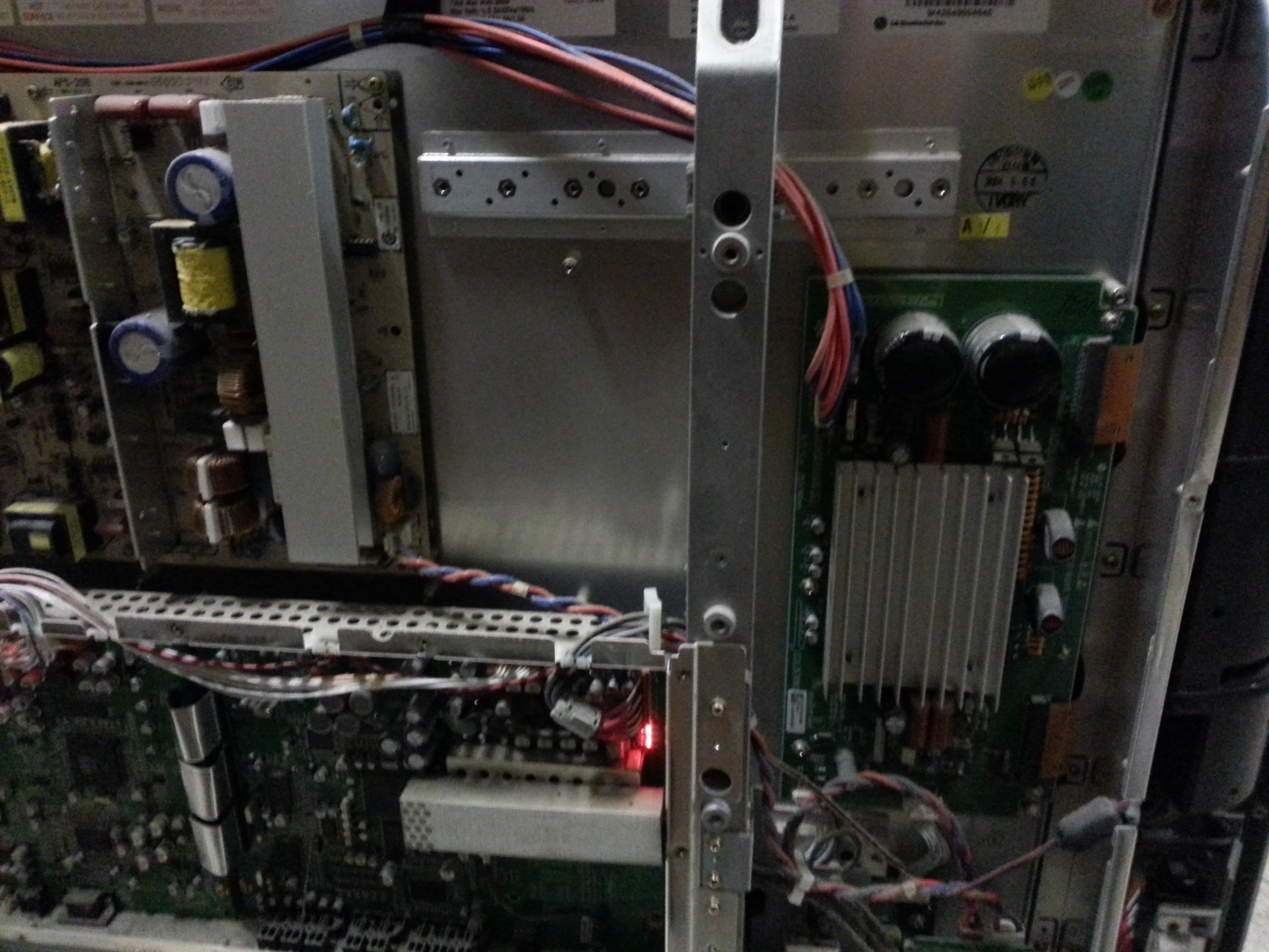

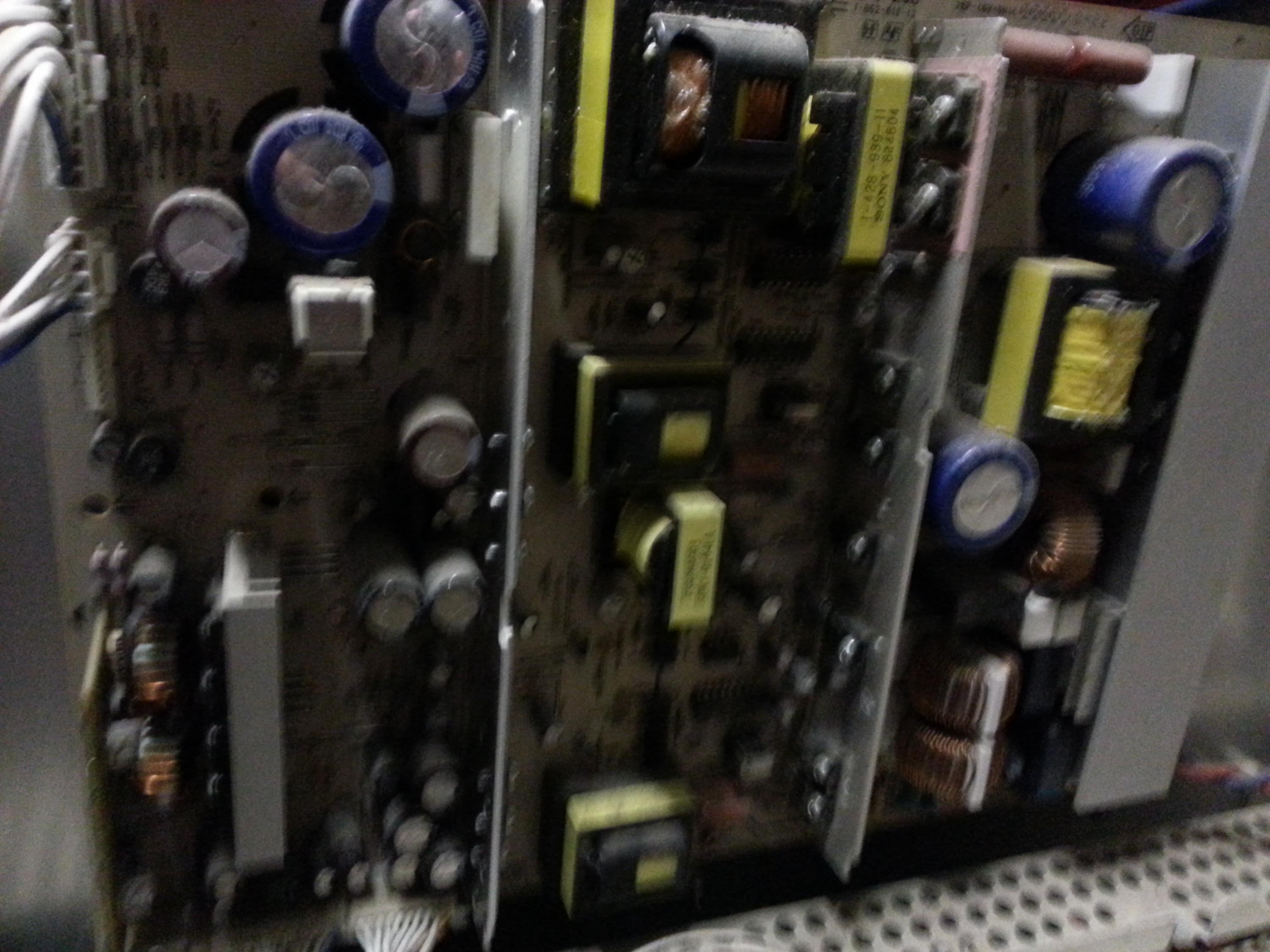

                              so you think its not related to the voltage, any ideas of the problems, all the detatchible fuses test out. Would pictures help?
                                Re: LG Flatron 42" Plasma
                                I am thinking ether -Vy bad, control board fault or main board fault. You can test -Vy on the Y-sus.
                                Picture of fault would help plus one of the chassis.

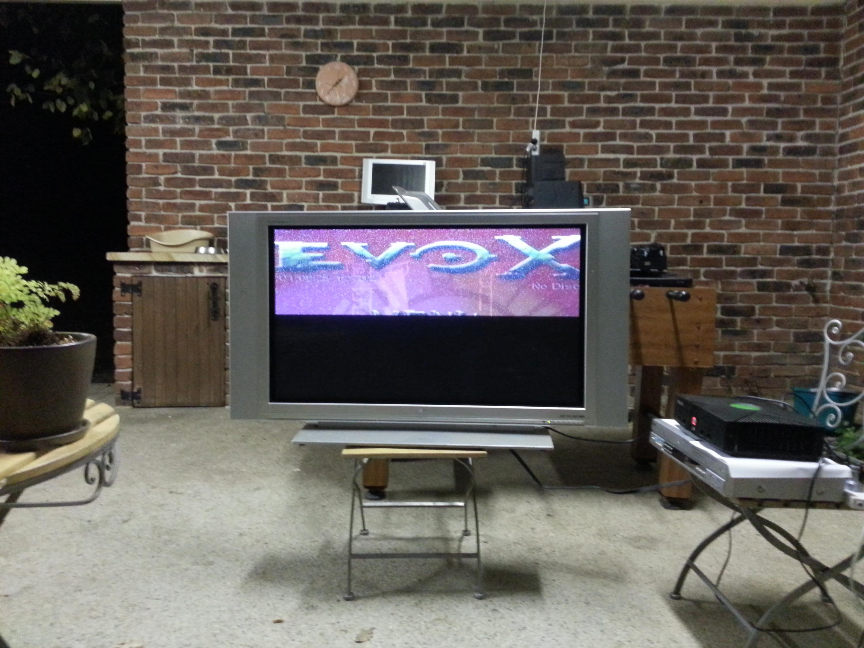

                                  heres some pics, i apologise for the akwardness of them
                                    The bottom is always blank? Or have you removed something?
                                    • luke10050
                                      • Mar 2013
                                      • 209
                                      the bottom y buffer is removed, sitting on my kitchen table
