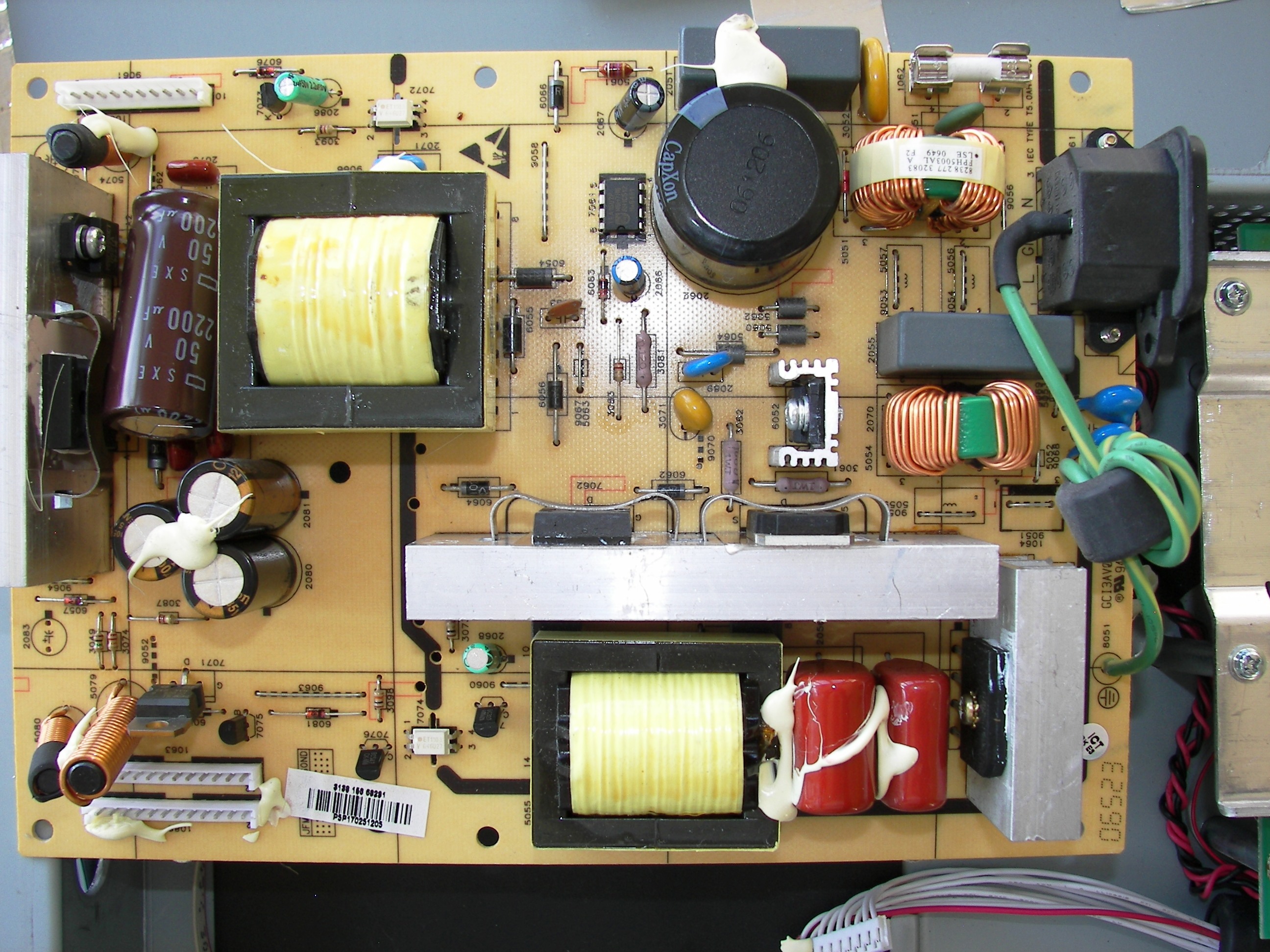

    First -new ton excellent forum and thanks in advance for any help. Free tv and after researching a bit it seems likely a PS problem . Power-on and tv flashes about 1 sec. Replaced 2200uf cap . None are bulging or leaking . Voltages on 12 pin 1-5 are 24v - nothing on pins 6 & 7 should be 2.6 and 6.1. I am going to replace the 2 1000uf and the 1200uf, should I be looking for something else? Concerned that no visible damage.

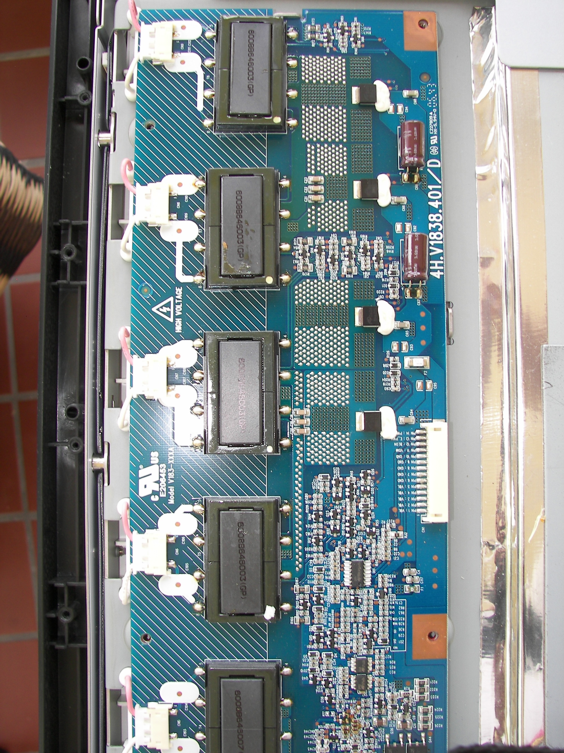

          It sounds like the inverter turns off. Any pictures of the inverter board. BTW, the new cap looks like general purpose cap?

            It is polarized 2200uf 50v, thought I would take a shot at what failed most. The original one was probably ok. Attached are photos. Main board is board with outputs? next to PS. If so , I cannot see any LEDS with board connected, but the room is bright.

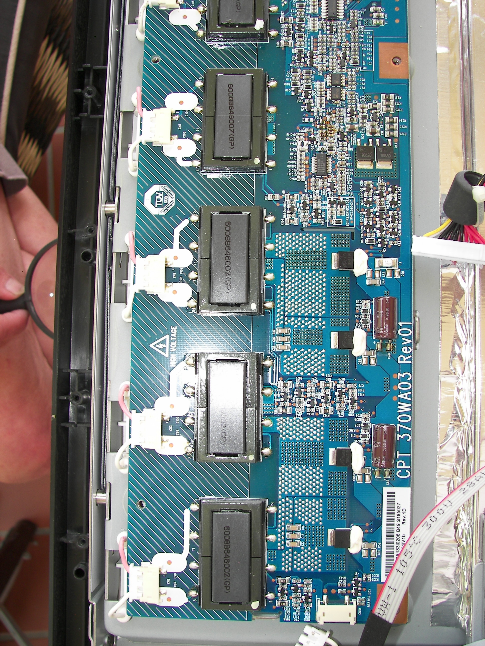

                Darfon inverter... Bad transformer is more than possible. Test the secondary of each transformer (6008xxxxxxx large eight-legged grey/black devices.)

                    Resistance, not voltage. There is no correct reading per se, but all must read within 3% of each other (general rule.)

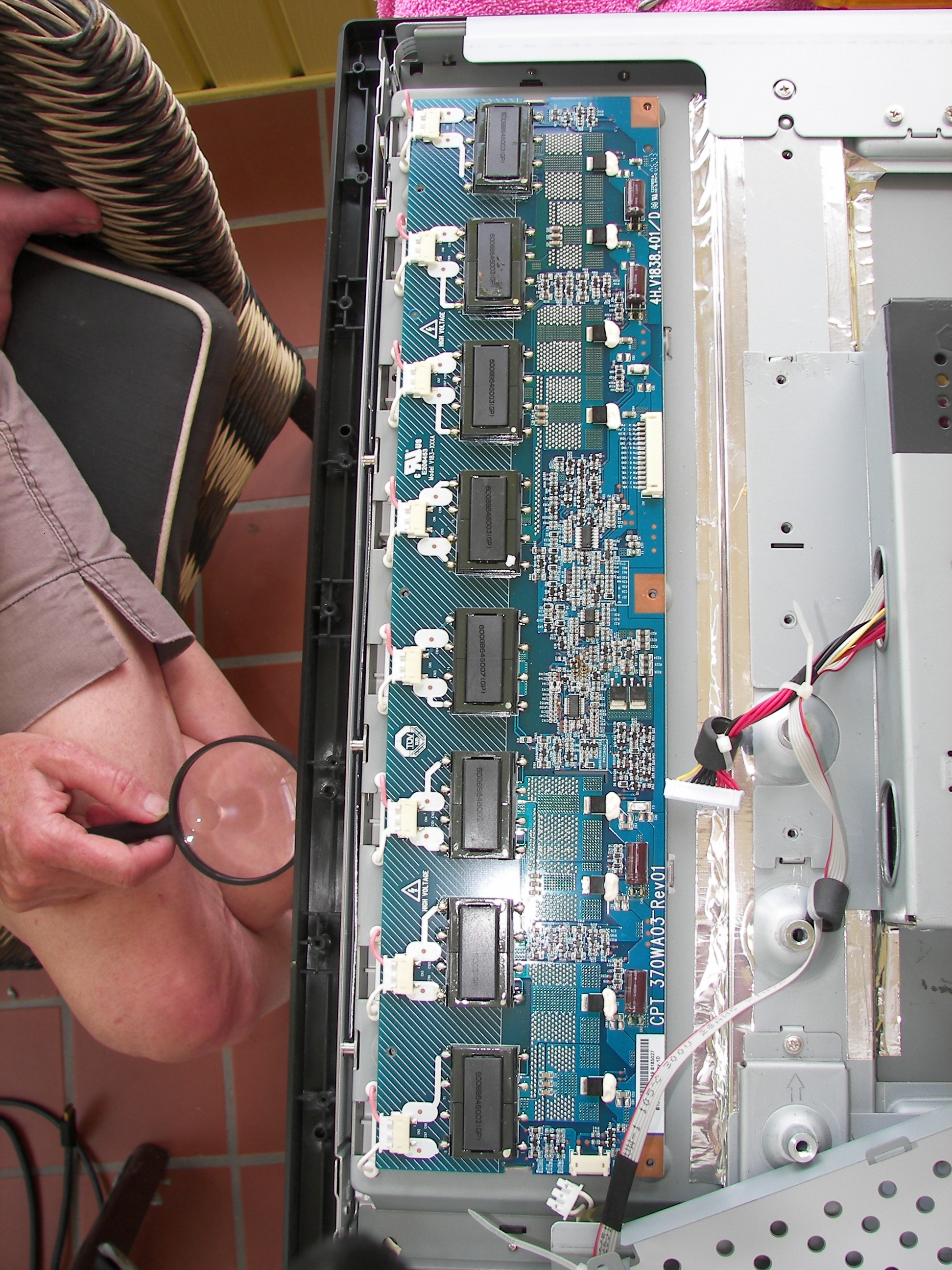

                      Well I measured at the connector to the display on each transformer.
                      1-6 & 8 measure 5.58 kohm, #7 measures 13.65,
                      That's the one with the puke on it. Actually it is something hard.

                          #7 is bad, then. Just to be sure, you measured between the top left and bottom left of each transformer?

                              Yes, they are easily replaced. Just heat up the legs, pull them up slightly, and the transformer will come off.
                              Will need the full 6008xxxxxx number to find a replacement.
