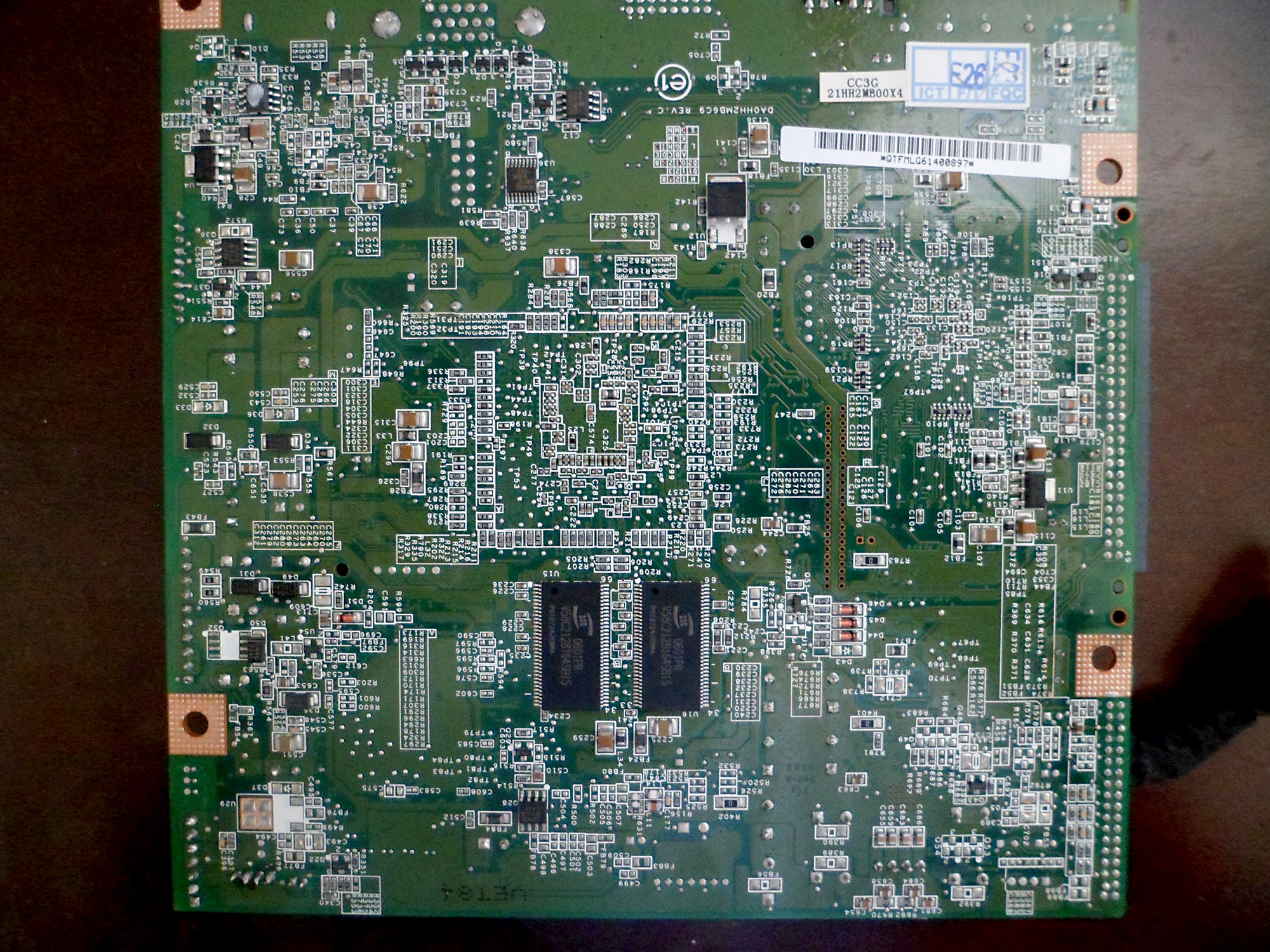

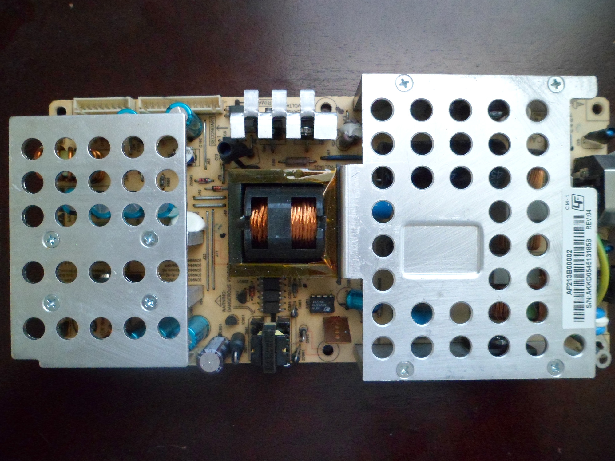

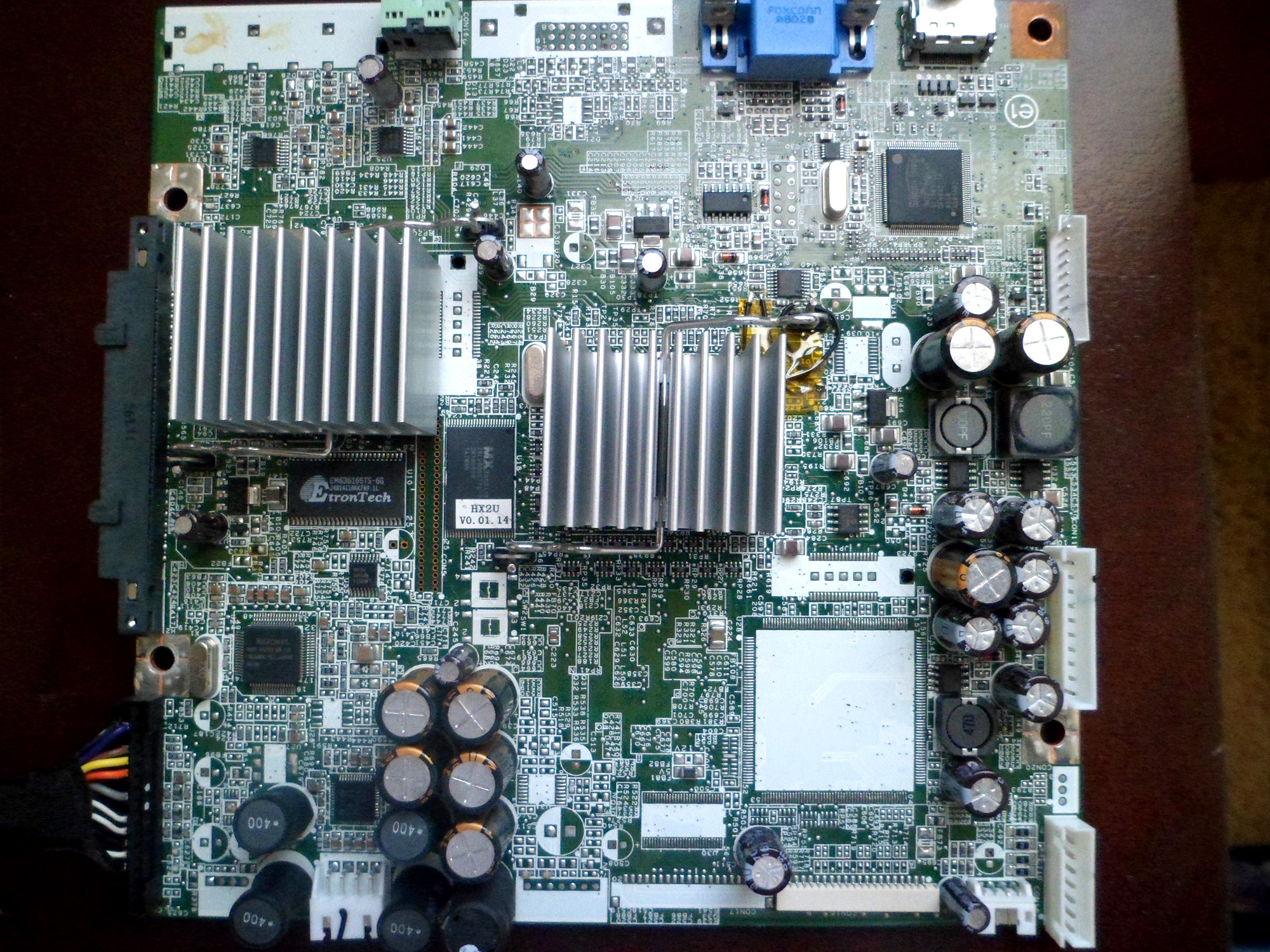

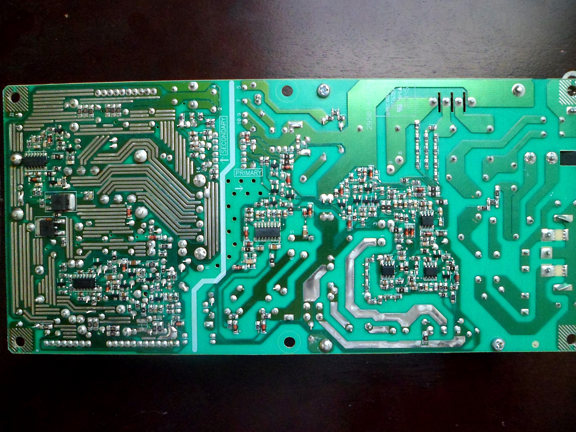

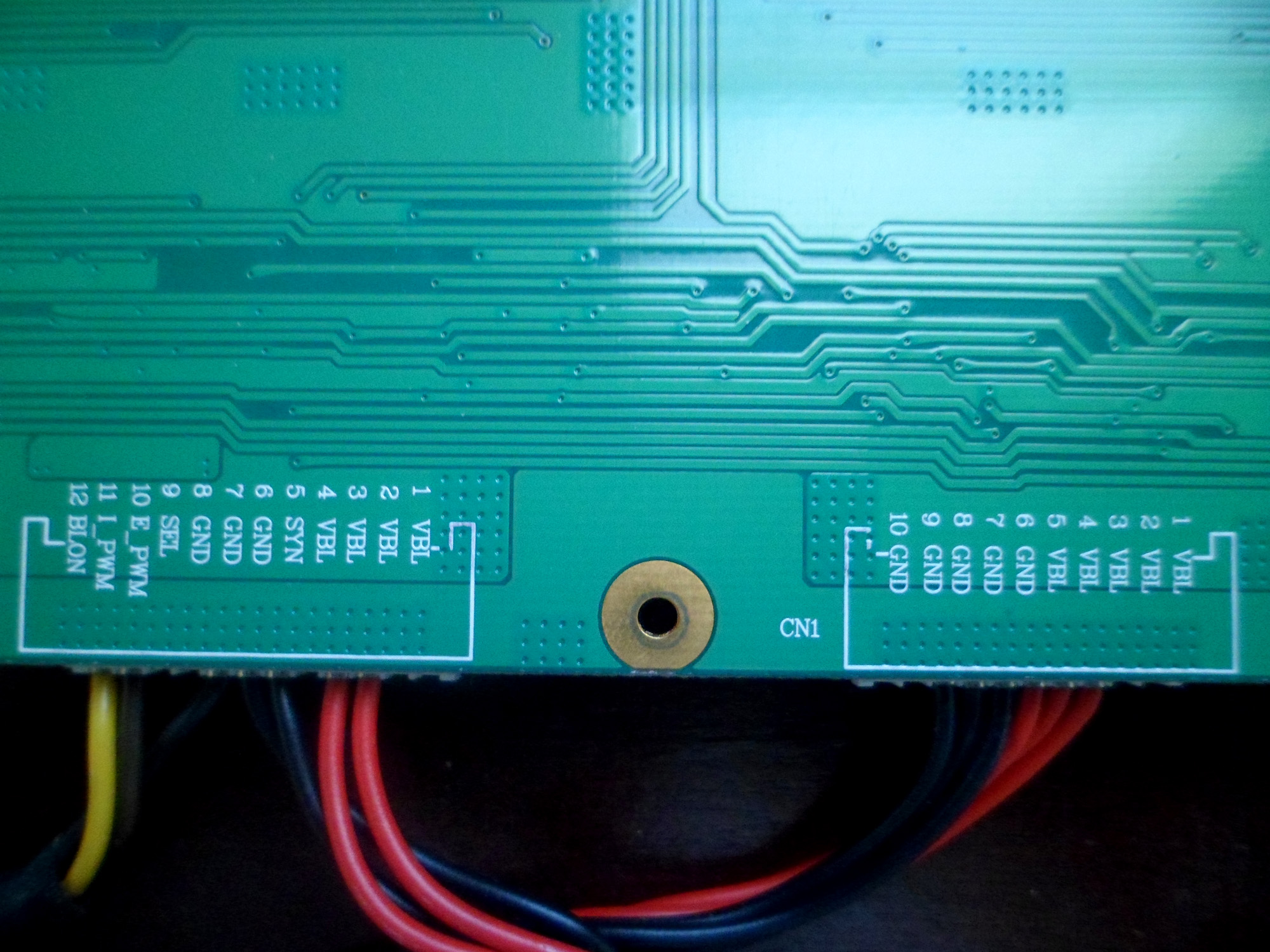

              whew!!! I finally able to get some work done for the tv set.
              I took the whole thing apart to take some photos, it was probably 1 of the very early LCD, there were so many different board and one mounted on top of the others. Anyhow, after I put it back together decided to power it up for some voltages measurement. The red LED turns blue as power button pressed and I can actually see the screen with flashlight. The PS connectors provide the right voltages as the legend printed on board.
              CN902 1-2-3-4-5 = GND
              CN902 6-7-8-9-10 = 24V
              CN903 1-2 = 12V
              CN903 3-4-5-6 = GND
              CN904 1 Power ON/OFF = 4.5V
              CN904 2-3-4 = GND
              CN904 5-6 (5.1V)= 5V
              CN904 7 (5VSB)= 5V
              CN904 8-9-10 = GND
              CN904 11-12 = 12V

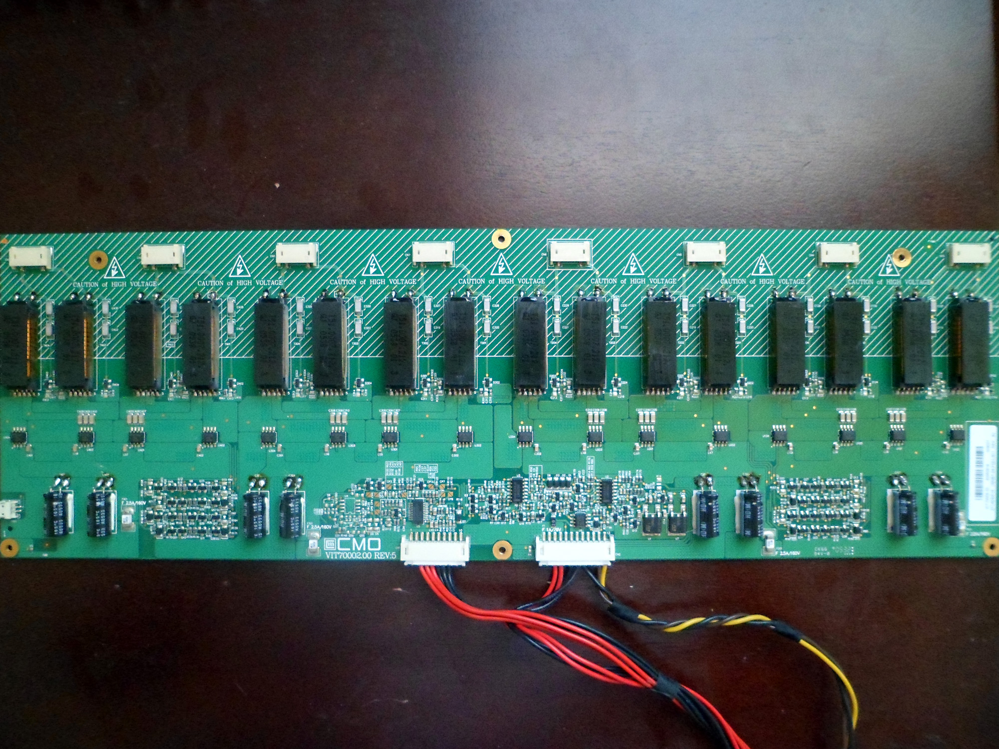

              I've got 24V at either ends of the inverter fuses and also 3.2V at BL_ON on the inverter board.
              does that mean the inverter board is the problem now? I will swap out the caps on the inverter just for the heck of it.
              Any suggestion please! thanks
                Re: Norcent LT-3250 has power but screen is dark
                Do you get 24vdc at both end of the small black fuse with '20' marking on top and F 1A/76V next to it by the connector? That is the common failure on CMO inverter board
                  I wonder why the bottom 8 FETs have appeared to run much hotter than the top 8 FETs. There's a very distinct change in colour between the two sides. Very odd.
                    He may have to replace those filter caps on both sections of the board due to high AC ripple.
                    • woaimi
                      • Sep 2005
                      • 94
                      • US
                      Lol...once again, it's proofed that nothing can be compared with experience. That fuse that you mentioned is probably the problem. I put my meter in 200 range and got a 1 on the display. I guess next task is to find replacement. I supposed digikey should have it available.
                        I use PICOII fuse which has two legs. Higher voltage rating is OK. Make sure to replace those caps at the same time.
                          Bubm, would this fuse work? It's PICO 1A 125V.
                          http://www.digikey.com/product-detai...963314?cur=USD
                          thanks again
                            It's an obsolete part, you won't be able to buy it.
                            This you can actually buy:
                            http://www.digikey.com/product-detai...3CT-ND/3306914
                            • woaimi
                              • Sep 2005
                              • 94
                              • US
                              Woohoo! just placed an order for a dozen. Thanks Tom66
                              • woaimi
                                • Sep 2005
                                • 94
                                • US
                                updating....
                                Thanks everyone for all helps! That fuse does the job nicely. I went ahead and replaced the small caps as suggested.
