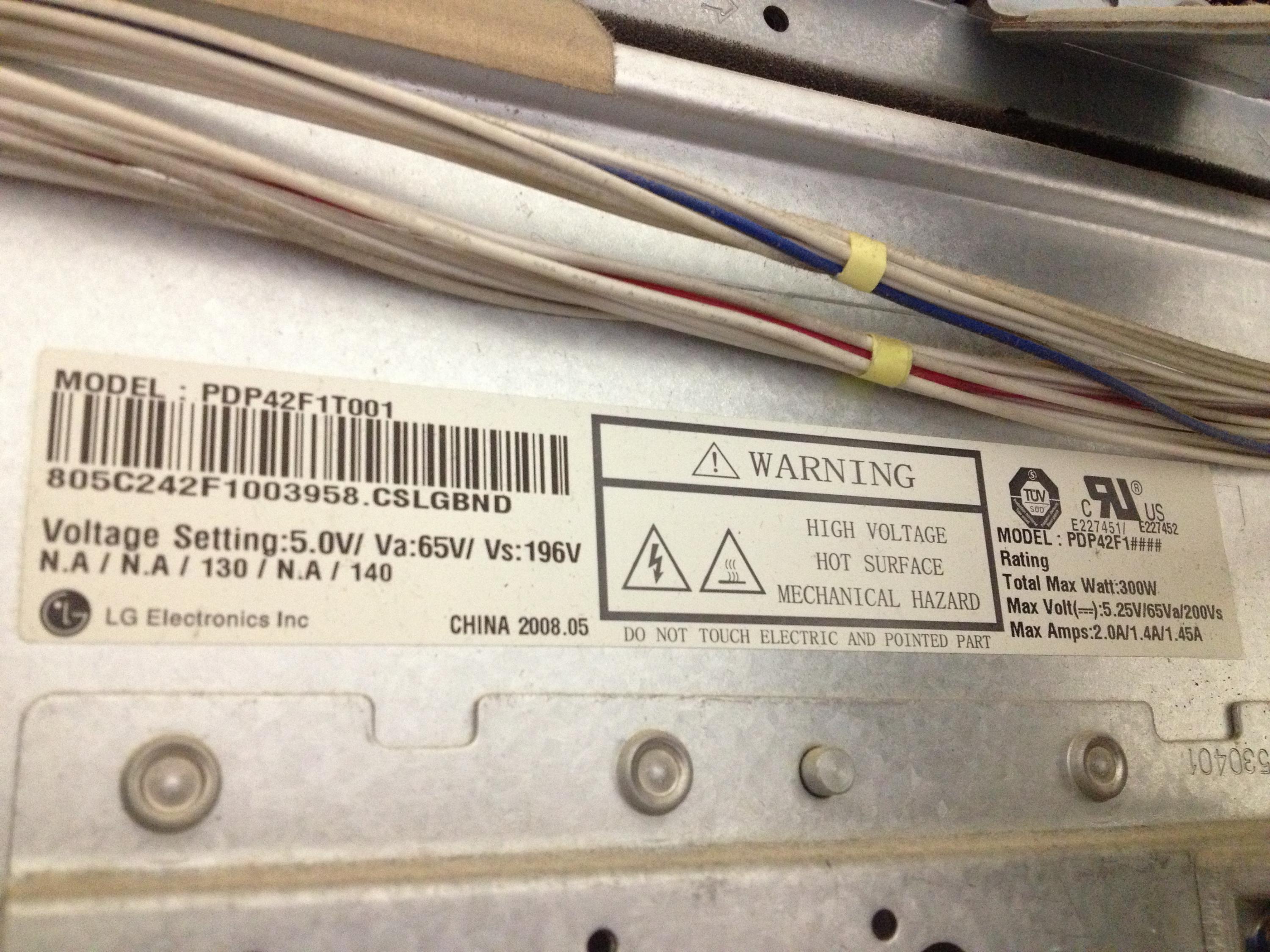

      Re: Hisense Plasma PDP4235EU
      hey tom,
      thanks for responding,
      i've added a picture of the sticker as you asked :-)
      if more pictures are needed,
      i'll be more than happy to attach them too.
        Very rare panel. Appears to be 480p, but modern, I guess for the budget market.
        I don't have a manual for this panel unfortunately.

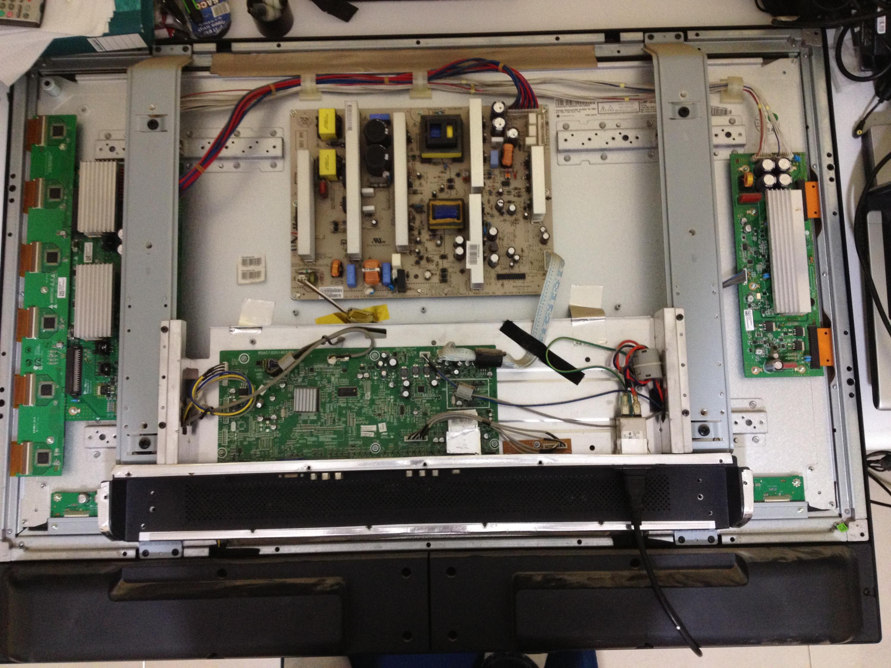

                This photo
                https://www.badcaps.net/forum/attach...9&d=1368727494
                Left hand board with 6 chips on it going to the plasma panel. Runs along the left hand side. Drives the rows of the plasma panel.
                  good that was my guess too!

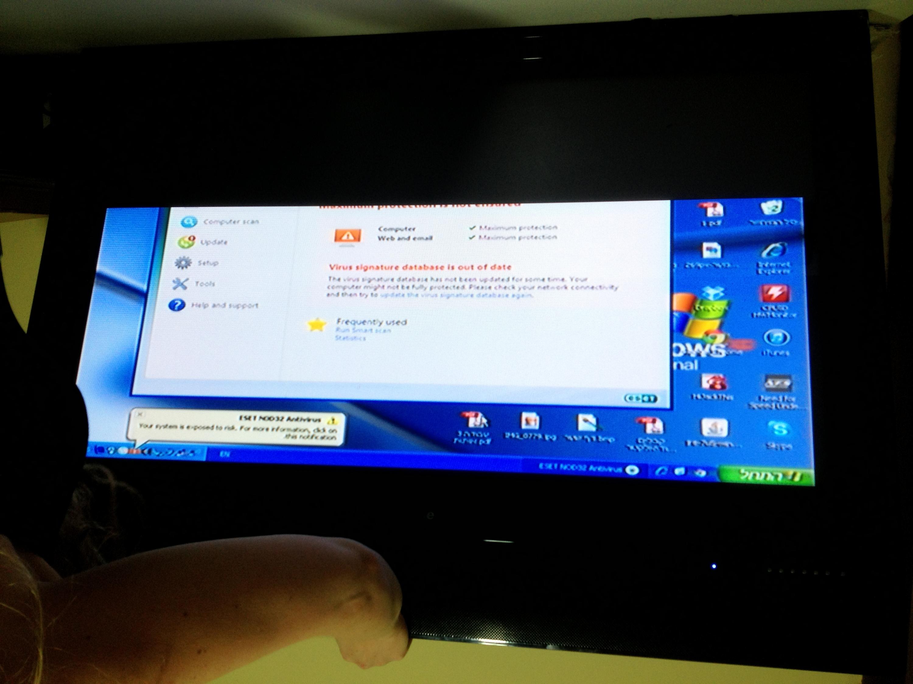

                        what do you think?
                        1/3 of the upper screen is black
                          OK, so in a dark room, is the failed portion glowing slightly? A plasma panel will glow slightly if it is being energised.
                            it lookes just like an lcd with no backlight,
                            you can see the picture but there is no light.

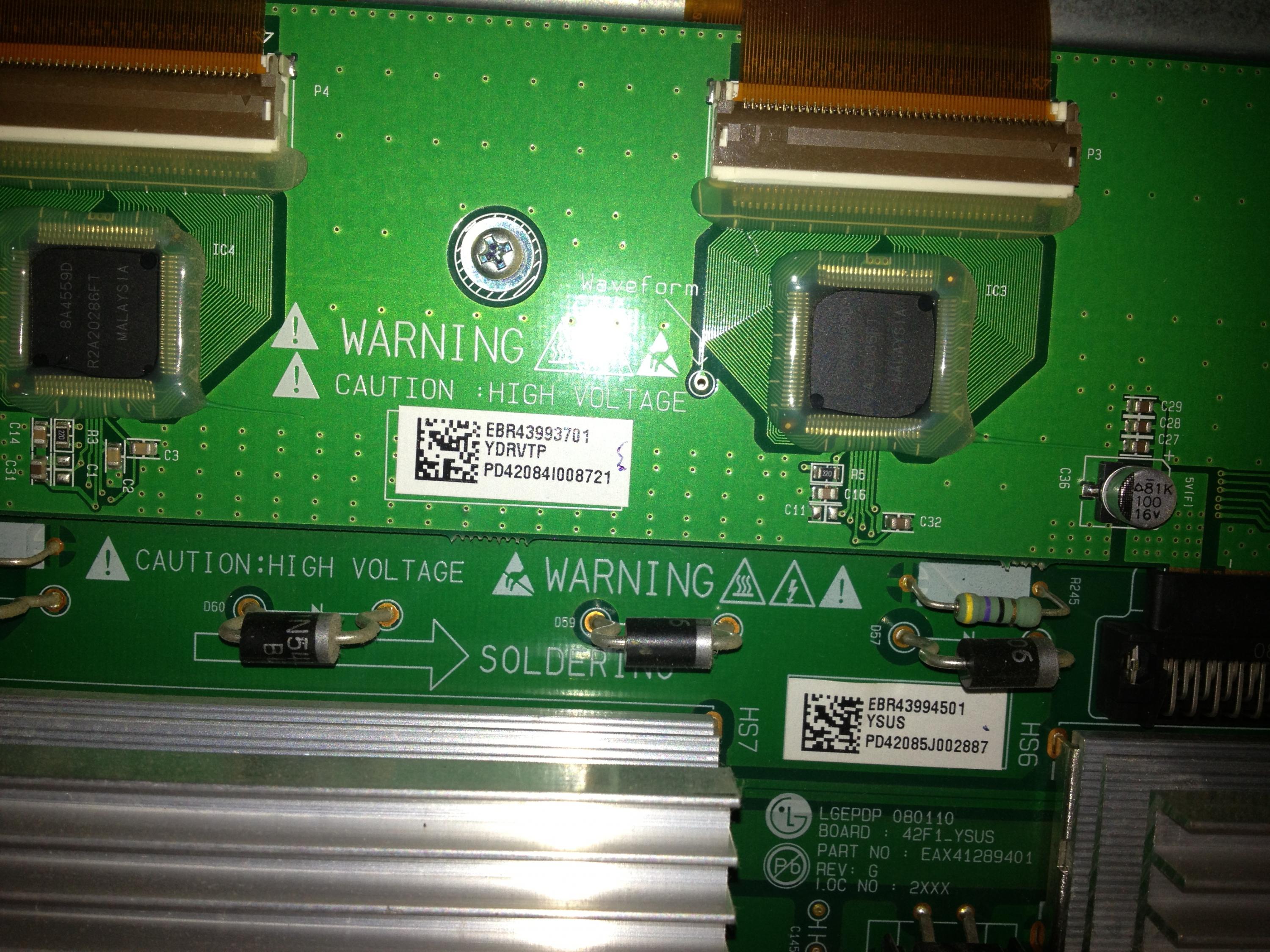

                              OK, my suggestion would be the 2nd buffer IC from the top has failed on the Y-buffer, perhaps it is intermittent. Each IC chains the signal to the next. Look at the part # on it. They may be replaceable or you can get a whole new board.
                                ok should i google this sticker?
                                hope you can see the number of the IC in the picture.
                                any guess why does it happen randomly?
                                  Do you have freeze spray or a hairdryer available? I want to rule out nearby MLCC too. It's probably related to the heat produced by the ICs.
                                  Here is the chip, $13 each, so see if a buffer board replacement will be cheaper (perhaps you can get it from another TV with cracked screen, but beware sometimes buffer is damaged by cracked screen.)
                                  http://www.aliexpress.com/item/IC-CH...631122161.html
