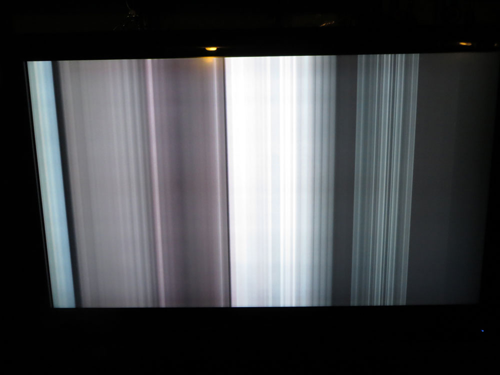

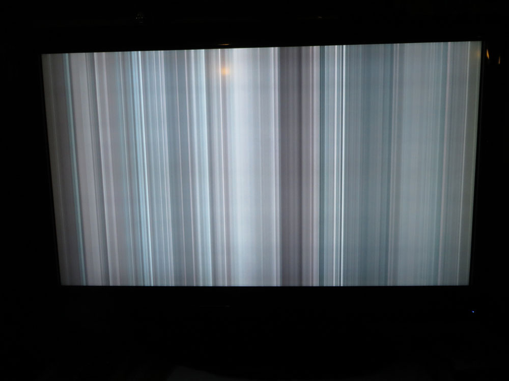

    Insignia NS-L37Q-10A Picture Problem

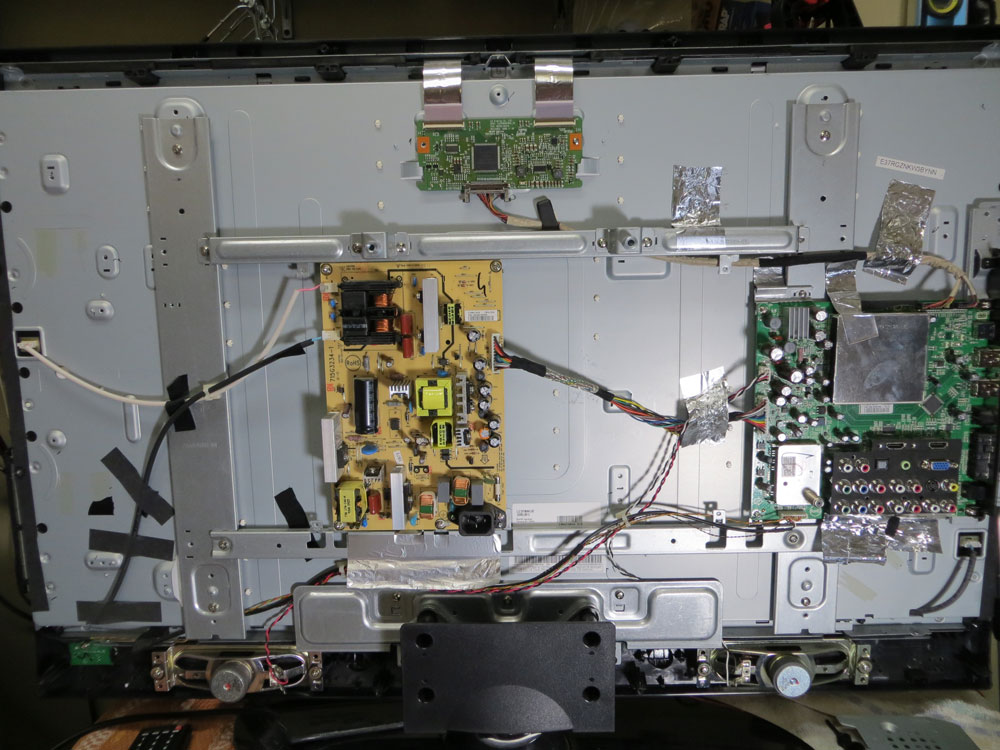

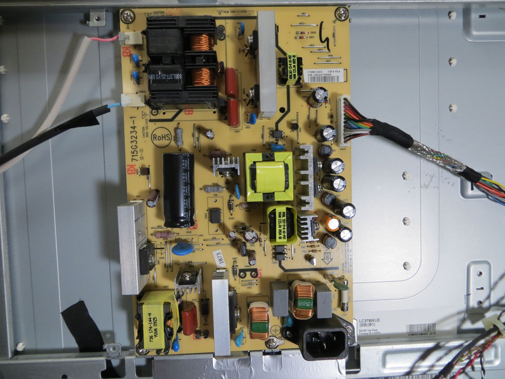

    I have a Insignia 37' TV that has good sound, but has moving vertical lines that move with the source picture/sound. I have checked voltages on the power supply and they all check good.
    E37RGZNKW3BYNN
    MFD 9H26
    MFG Date Rev B August 2009

      Re: Insignia NS-L37Q-10A Picture Problem
      I have received no reply to my post????
      I suggest reviewing the sticky "TV and Monitor basic troubleshooting guides".

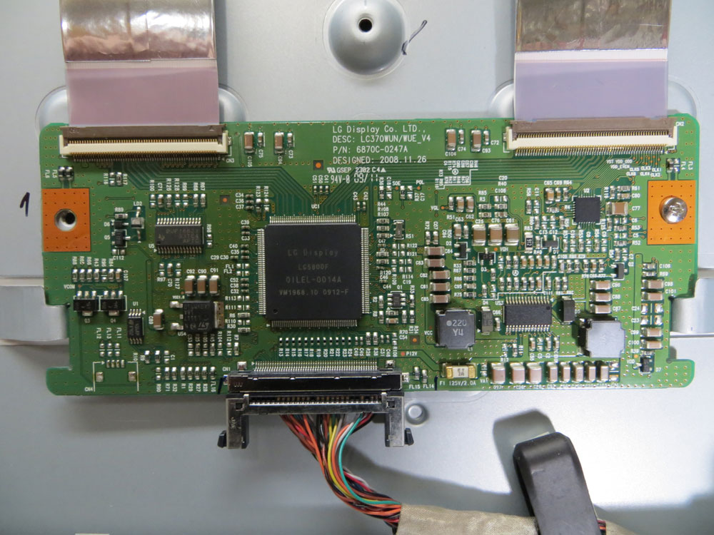

      I did find the problem and repaired this TV.
      It was a bad T-Con board.
