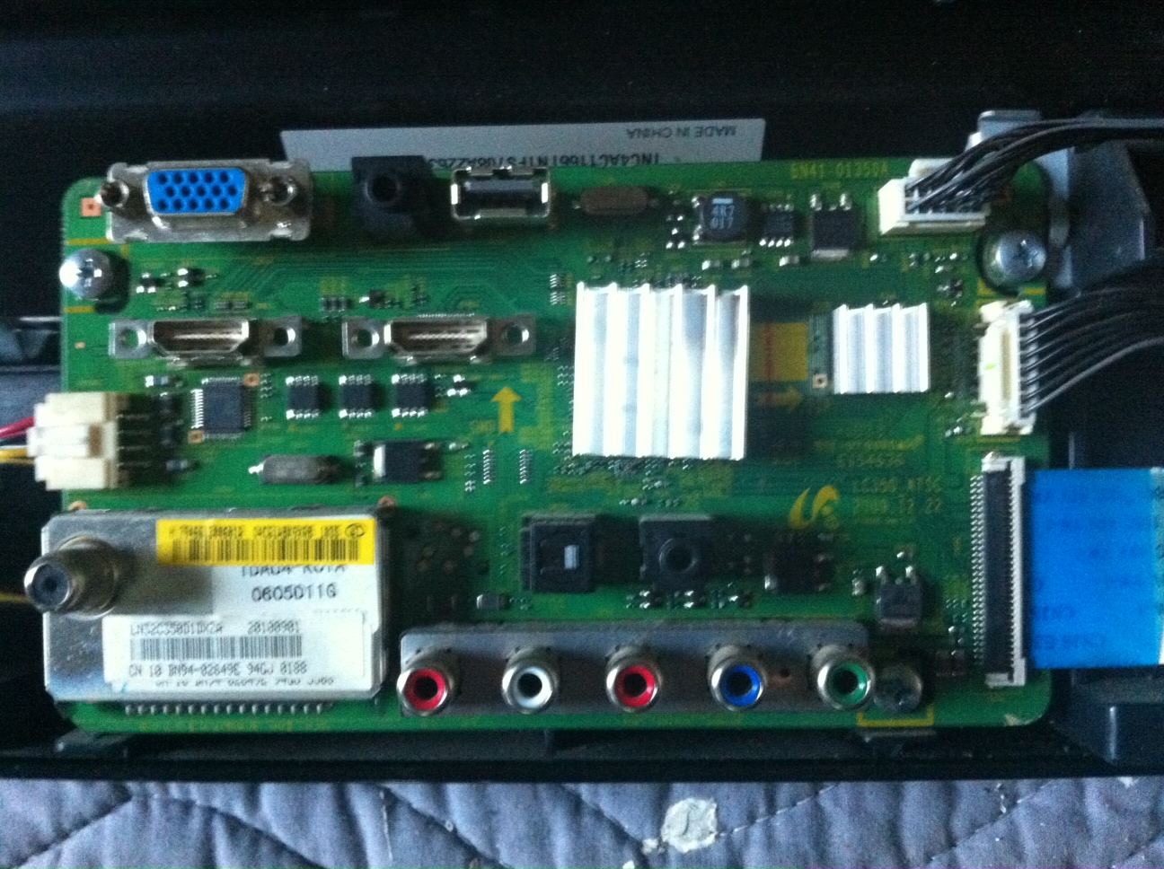

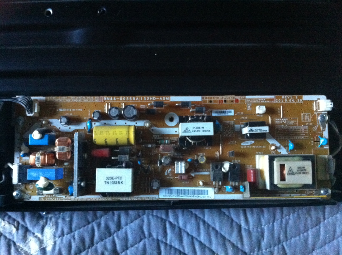

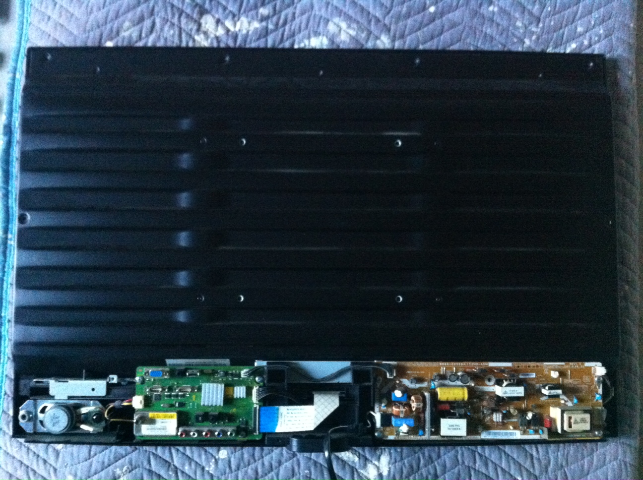

    I have a Samsung 32" LN32C350D1D that is freezing up 1-3 minutes after power on. Here is what happens. Power TV on, everything appears fine, video and audio display fine from any source. After 1-3 minutes, the picture just kind of dissolves into a few vertical lines in the colors of whatever source material was playing at the time. The audio continues to work. The onscreen menu will not display after this happens. Turning the TV on and back on immediately restarts the sequence with it working fine for 1-3 minutes.
    I've taken pictures of the boards, attached. Just wondering where to start on troubleshooting this one. My understanding is the TCONN on this board is integrated into panel? and may not be replaceable.

    Does this sound like a main board issue or a power supply issue?

      Re: Samsung LN32C350D1D Picture Freeze
      I would recommend checking all voltages leaving the power supply before and after the issue occurs. If the voltages remain steady the whole time then probably suspect main board. If any voltages drop, then look at power board.
        If the audio is still working then the main board is still working to some extent...
        When the freeze issue happens is the backlight still on? Can you take a picture of this happening and show it..
        Could be something overheating on the main board. Freeze spray (ironically) might be of use to track down the point of failure... could be bad cap, cold joint or IC overheating. Better pics of the boards, back and front would be helpful..
          I'll try to get better pictures tonight, the back light is definitely staying on.
