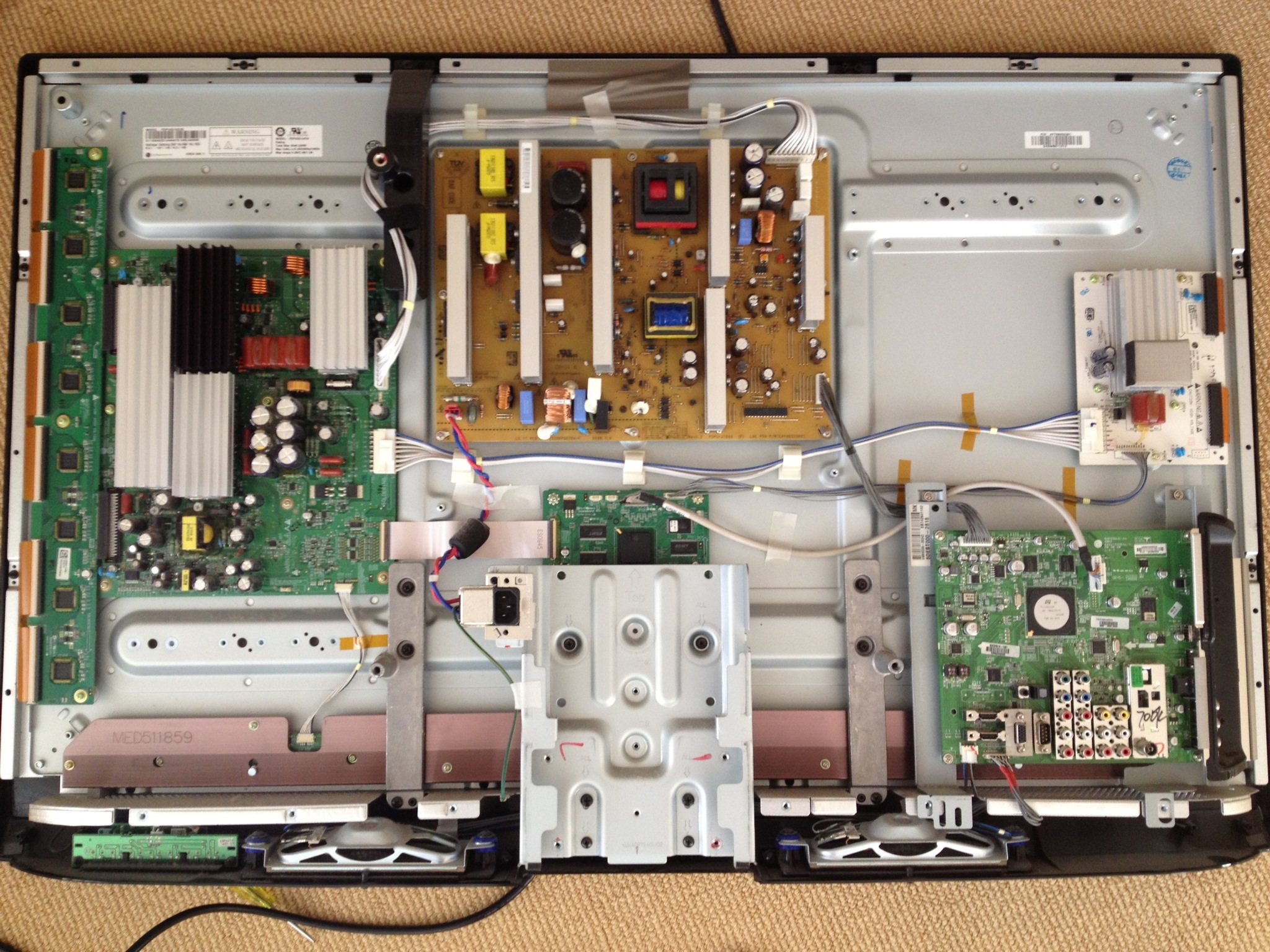

    Can you post some pictures of the chassis layout?

      Re: LG 42PG20D Plasma freezing up
      Photo attached shows chassis layout (I hope, posting from my phone)
              OK, on the left of the TV, the large board with heatsinks is the Y-SUSTAIN (connected to Y-BUFFER), and the smaller board on the right is the Z-SUSTAIN.
              In the middle of this you've got the power supply (orange) and below it, you've got the control board. Can you get me a photo of the control board? I need to be able to see the points marked "EXT AUTO GEN", if they are present.

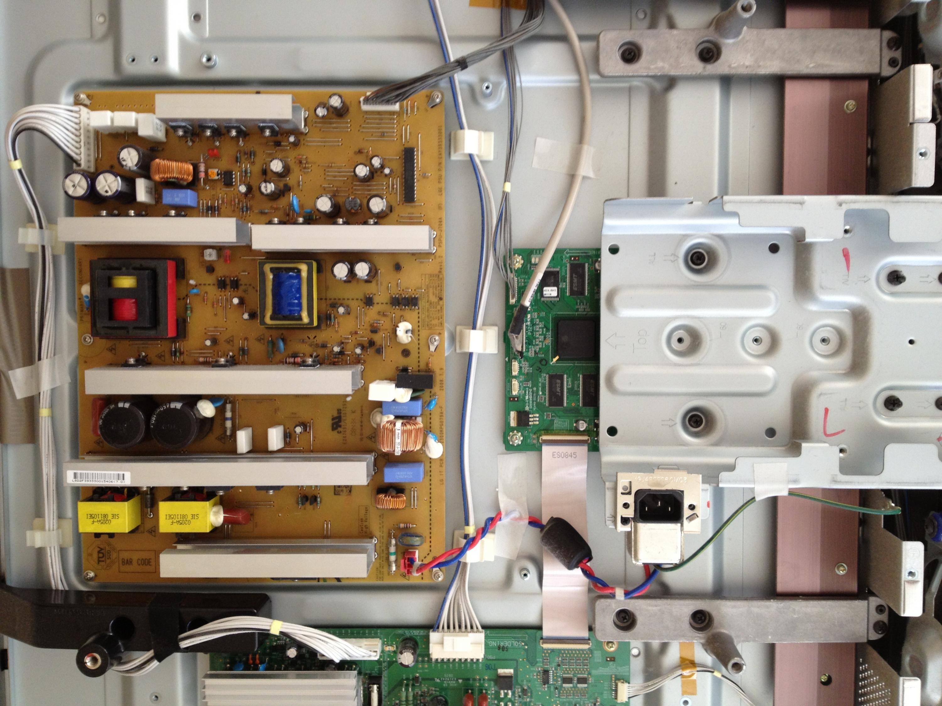

                This is the best photo I have at the moment of those 2 boards. I will take another photo next time I'm at home. What are your thoughts on the problem so far?
                  You can try jumpering EXT AUTO GEN with a 100 to 470 ohm resistor (if you do not have one places like Jaycar sell them.) This will put the panel into a test mode, showing patterns one after one. If it does not freeze, then we know the problem is with the main board, if it does freeze then it is a control board issue. At which point, you can use freeze spray or a hair dryer to locate any thermally sensitive parts, or you can replace the entire board.
                        Test patterns work perfectly and have been cycling through now for over 5 minutes.
                        So its the main board?
                          Yep. So if the problem happens after about 3 minutes you need to try and lengthen it. Begin by targeting the large "ST" processor with freeze spray. If it lasts much longer, then it probably has a bad BGA joint (like Xbox 360 and PS3 RROD/YLOD.) If you don't have freeze spray you can try heating up parts and see if the problem occurs quicker but due to how quickly it occurs it might be difficult to find the faulty part.
                          Or you can swap the whole board. Remember you can only use 42" board in 42" 720p PDP.

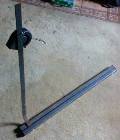

                                    Originally posted by tom66
                                    If you don't have freeze spray you can try heating up parts and see if the problem occurs quicker but due to how quickly it occurs it might be difficult to find the faulty part..
                                    I rigged up this with a bit of square tubing.
                                    I attached two PC fans to it (powered by either a car battery or 12V supply from the TV's power board) and focus it on the different boards to track down thermal problems..
