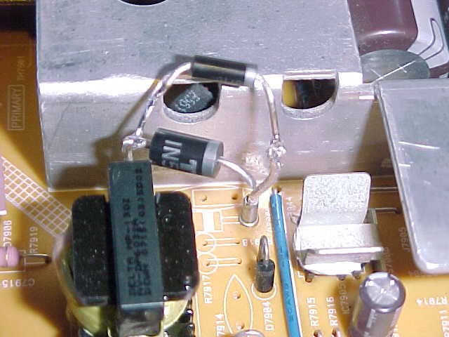

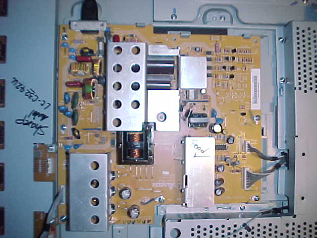

    Symptoms, Problems: TV DEAD, no power, no standby light, no nothing.
    STORY: Client TV had power problems, probably new power supply. So, I ordered one.
    Compared the 2 PS units. tested both. New one worked. Old one is dead. The new power supply fully functioned the TV. So, no problems elsewhere.
    Decided to rebuild the OLD PS unit.
    Tested all caps, trans, some resistors, transformers and found all good.
    Finally tested all the little diodes. All good but one. It "BEEPED" and was shorted.
    Reinstalled the rebuild. TV did not work., reinstalled NEW PS unit = DID NOT WORK! ??? Dah?
    THOT for the DAY:
    When R&R'ing a pwer supply board - even though the ground holes where the screws go, "look," "seem to," even "seem to all tied together, the board needs ALL the screws replaced to funtion.
    Problem: When R&R'ing the boards, to quicken the time, I used ONE screw, "THINKING" it would ground the whole PS unit.
    Don't under estimate your stupidity - it can lead to waste of time and money.
    WHAT WAS REPAIRED: One diode (D7907) beeped and was replaced. Fixed the whole TV power supply and now works fine.
    PS. Before a new PS is ordered, chack that one diode first!

                    I have same exact symptoms that "WierdVideos" described on the rdenca198wjqz power supply, and also suspect bad diode D7907. Where can I get one of these? I've check digikey, but get no results using their search field. Is there any special methodology when looking up parts at digikey? Thanks
                    • jetadm123
                      • 2169
                      Re: SHARP 32" LCD TV POWER SUPPLY rdenca198wjqz
                      You need to use the part number stamped on the diode itself. It should be a 1N5383, which is available from digikey.
                      • phil@philporter.com
                        • May 2013
                        • 113
                        Got the parts from Mouser and installed. Works fine! Thanks.
