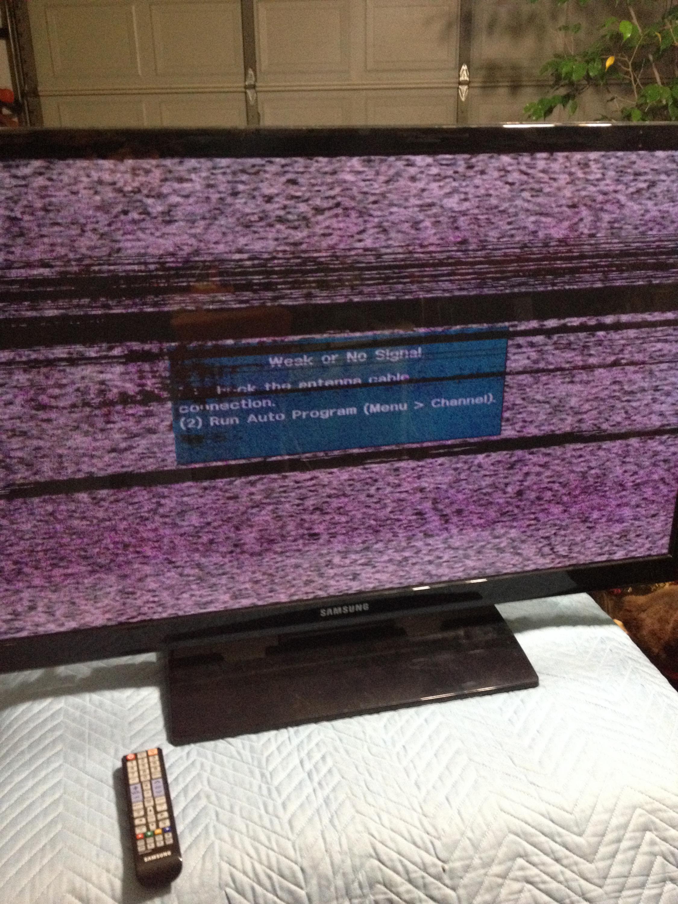

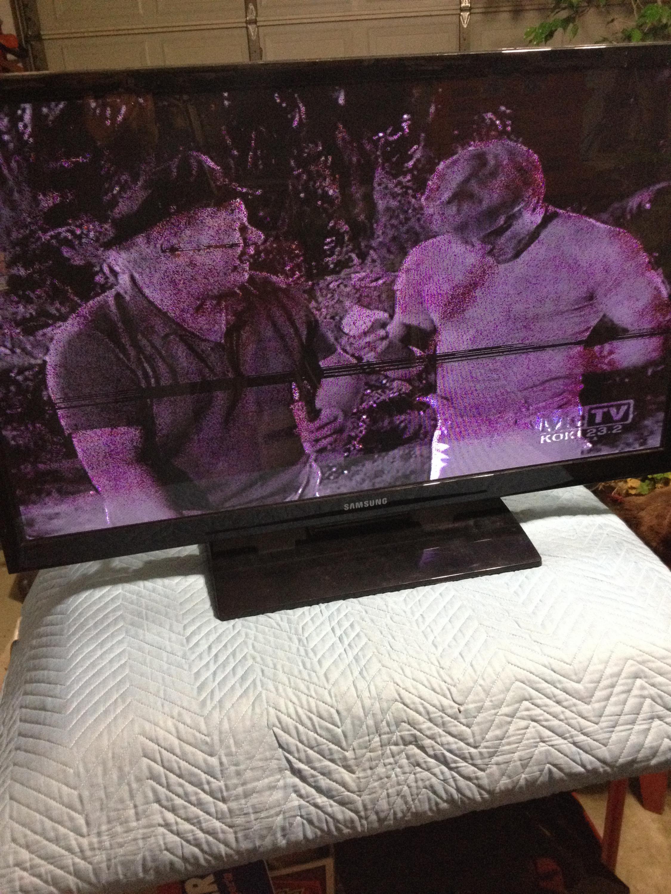

                installed y main,y buffer and x main and It fired up with a lot of black lines, see pics. Ran it for awhile just to see what would happen and almost all lines gone but now have a purple haze and some solarization going on.
                Just hoping someone has seen this before and it is not the screen.
                  Re: Samsung PN43E450 Panel flashes no video VS VA drop
                  Check X-main. Make sure all cables seated fully. If you have a scope, now would be the time to check the X-main output waveform. Also check Ve.
                  It's an odd fault. The purple tint is classic X-main fault, but the horizontal lines have me a little worried. The fact that they go away though is a good sign generally.

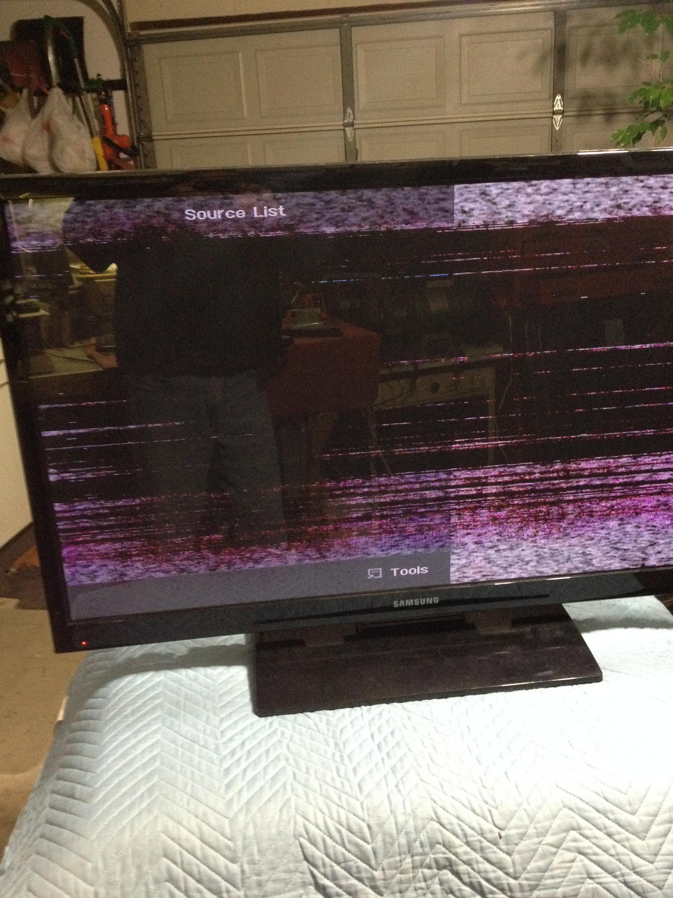

                    Summit going on with the X-Main, Have you a scope?
                    Those remaining black lines are probably the tabs need reseating in the plugs of buffer-board--they can be a pain to get right in as some have small lugs on the sides that need to locate in slots....

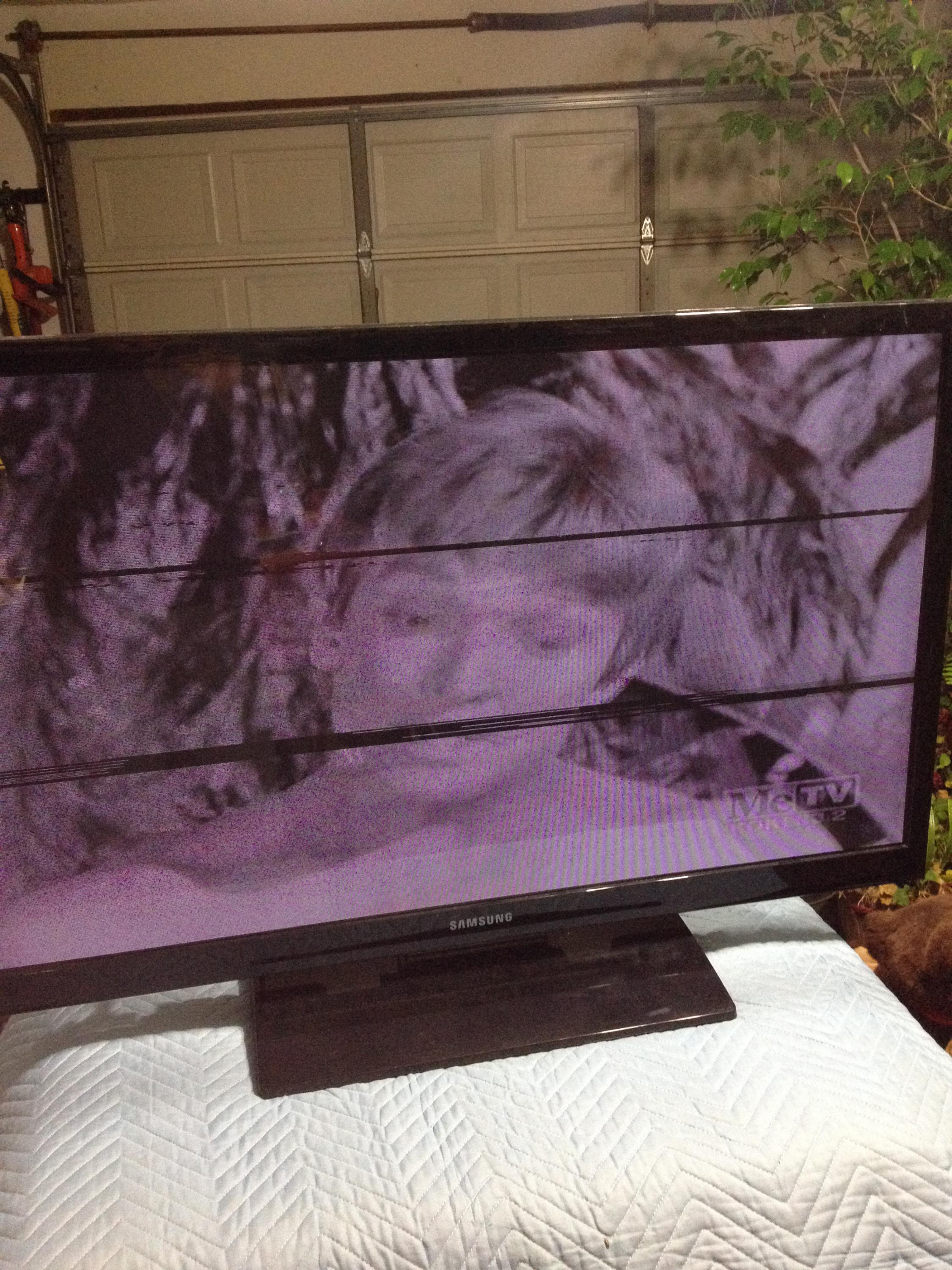

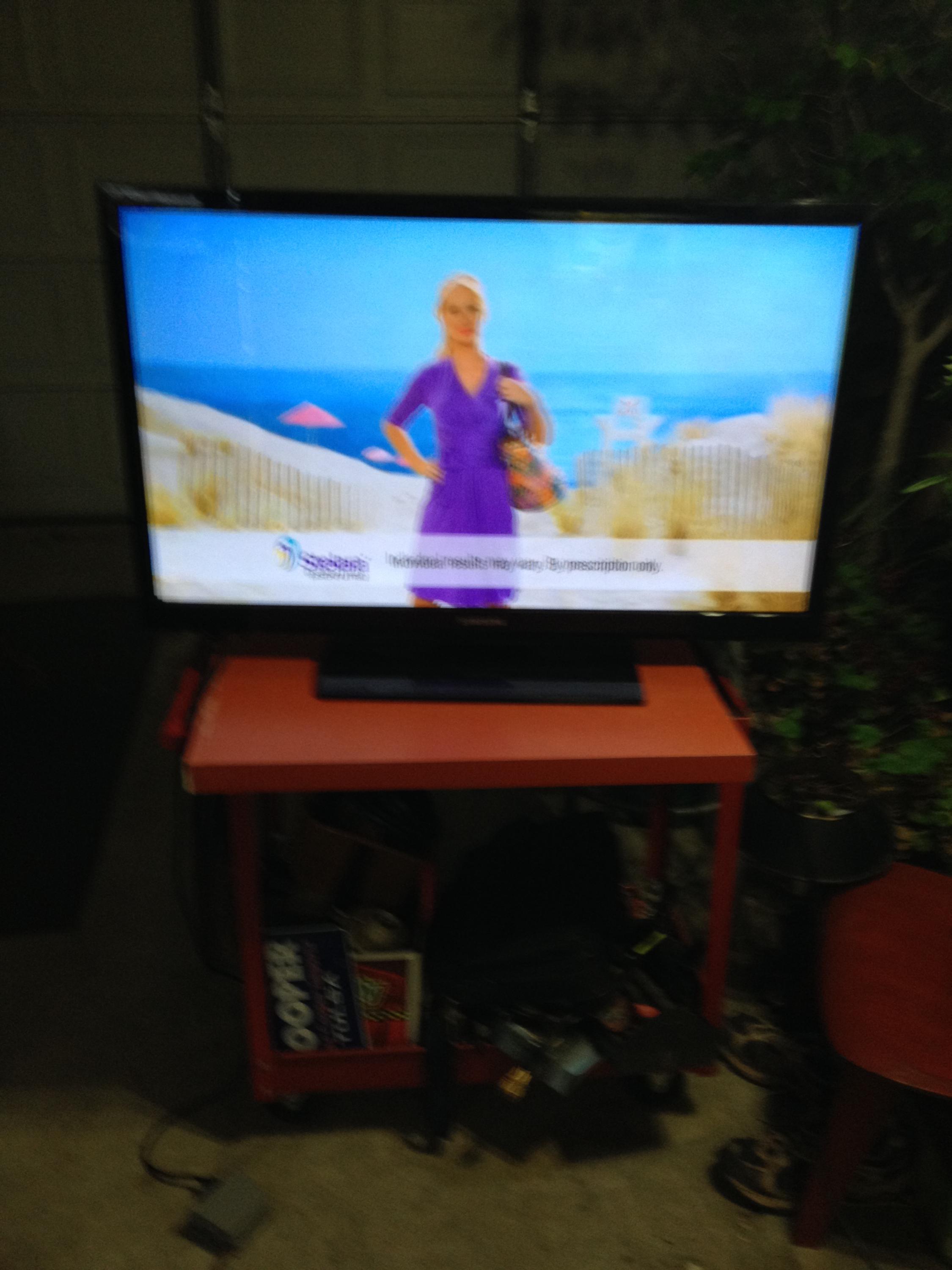

                        Checked y buffer board ribbons and all lines are gone. checked ve and it is 94vdc. Checked all connections at x main. would it hurt to try old x main and see how display acts or will it blow the y components? here is pic as of now. still has that purple haze which makes picture darker.
                          Anyone know what the Ve voltage should be? I am getting 94v.
                            Sounds about right.

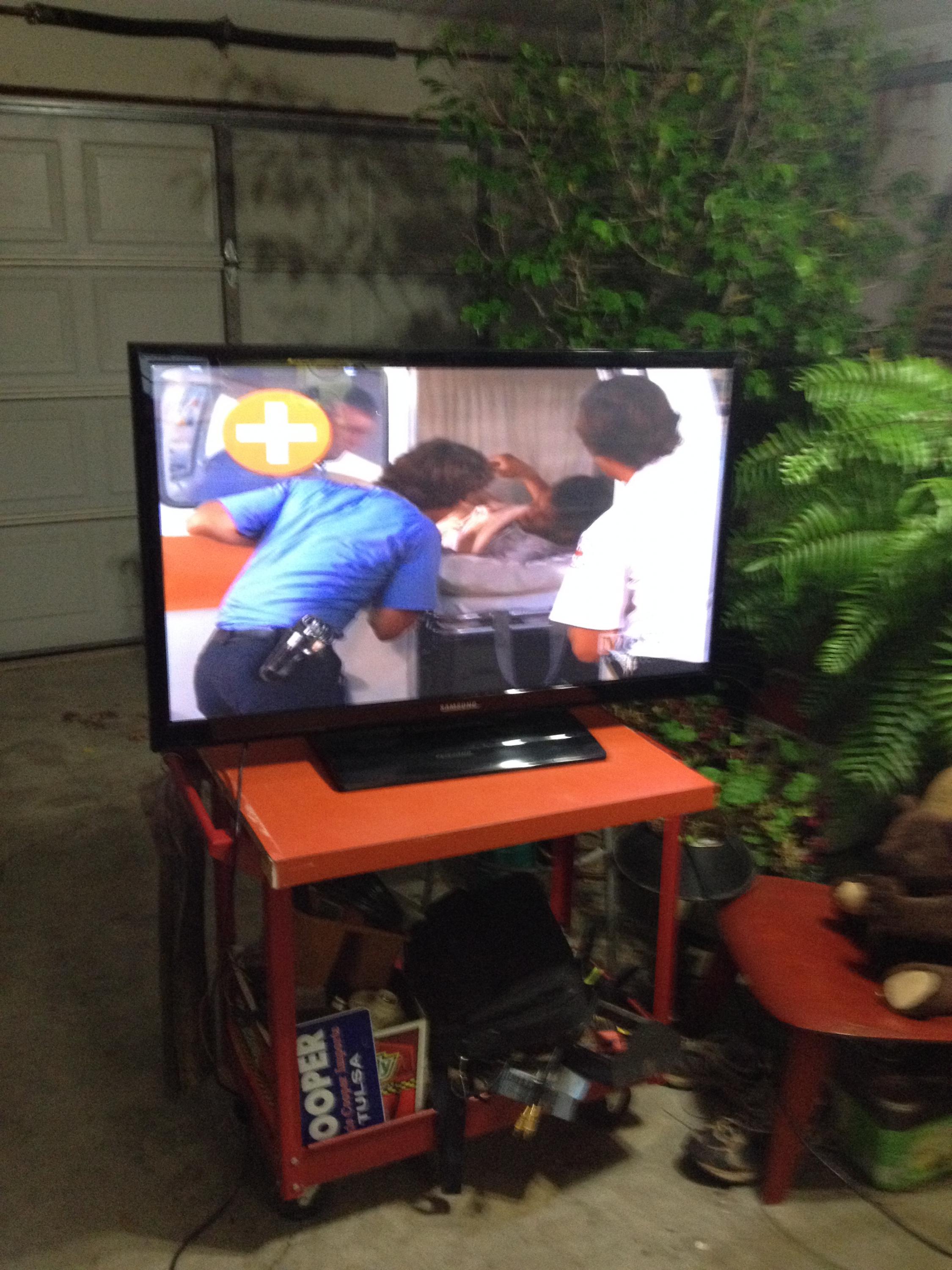

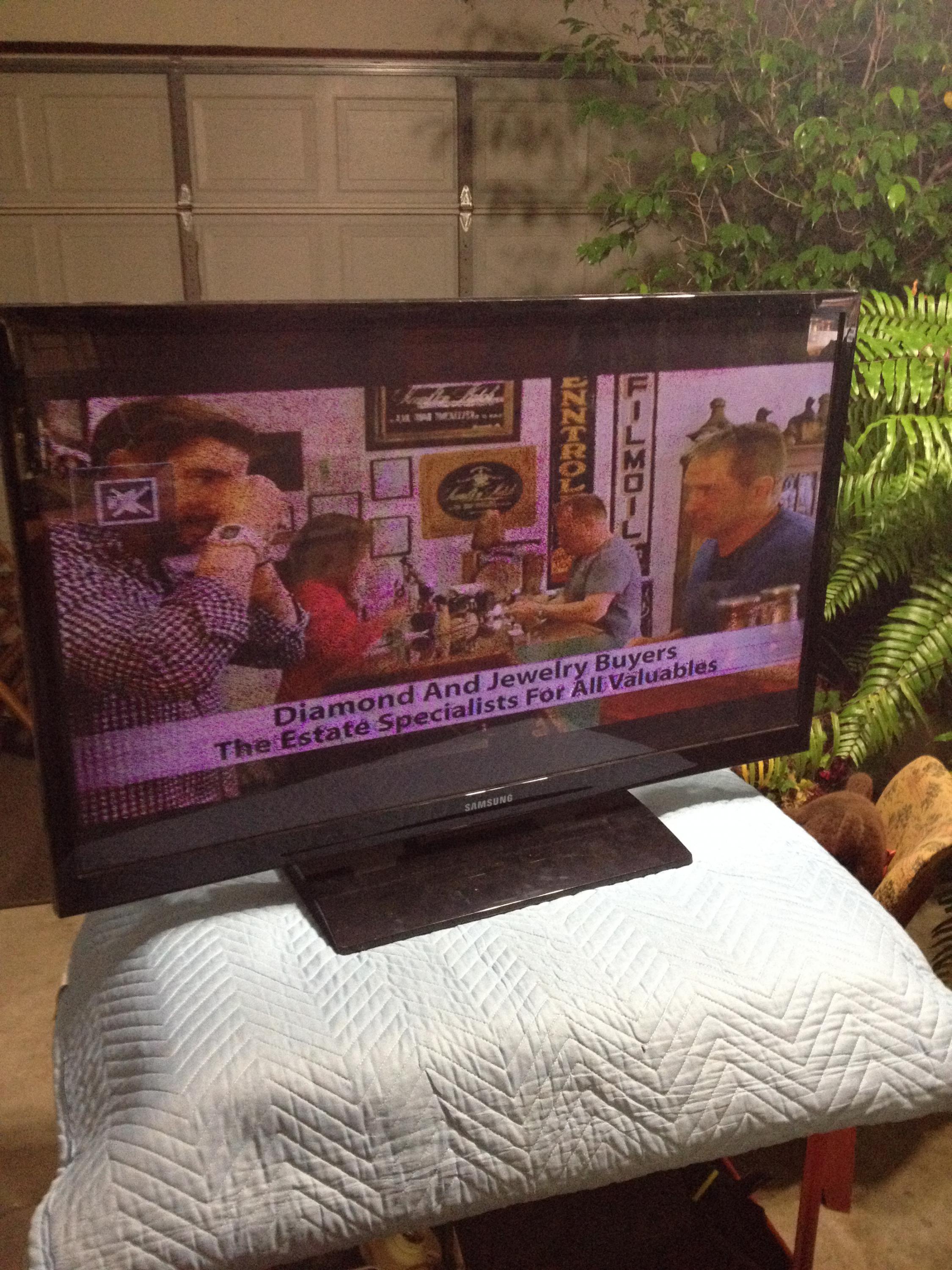

                              Success! I worked and checked, rechecked, studied these last few days and finally decided after reading tom66's thread on plasma repair to try my original X main and bam, perfect picture! Thanks tom66 and Alastair E. So Shopjimmy can make mistakes too.
