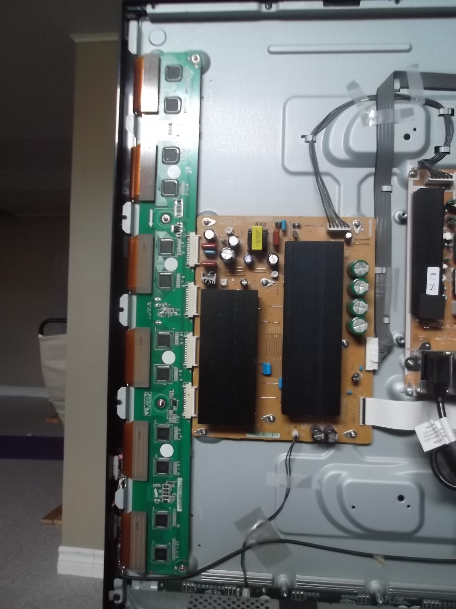

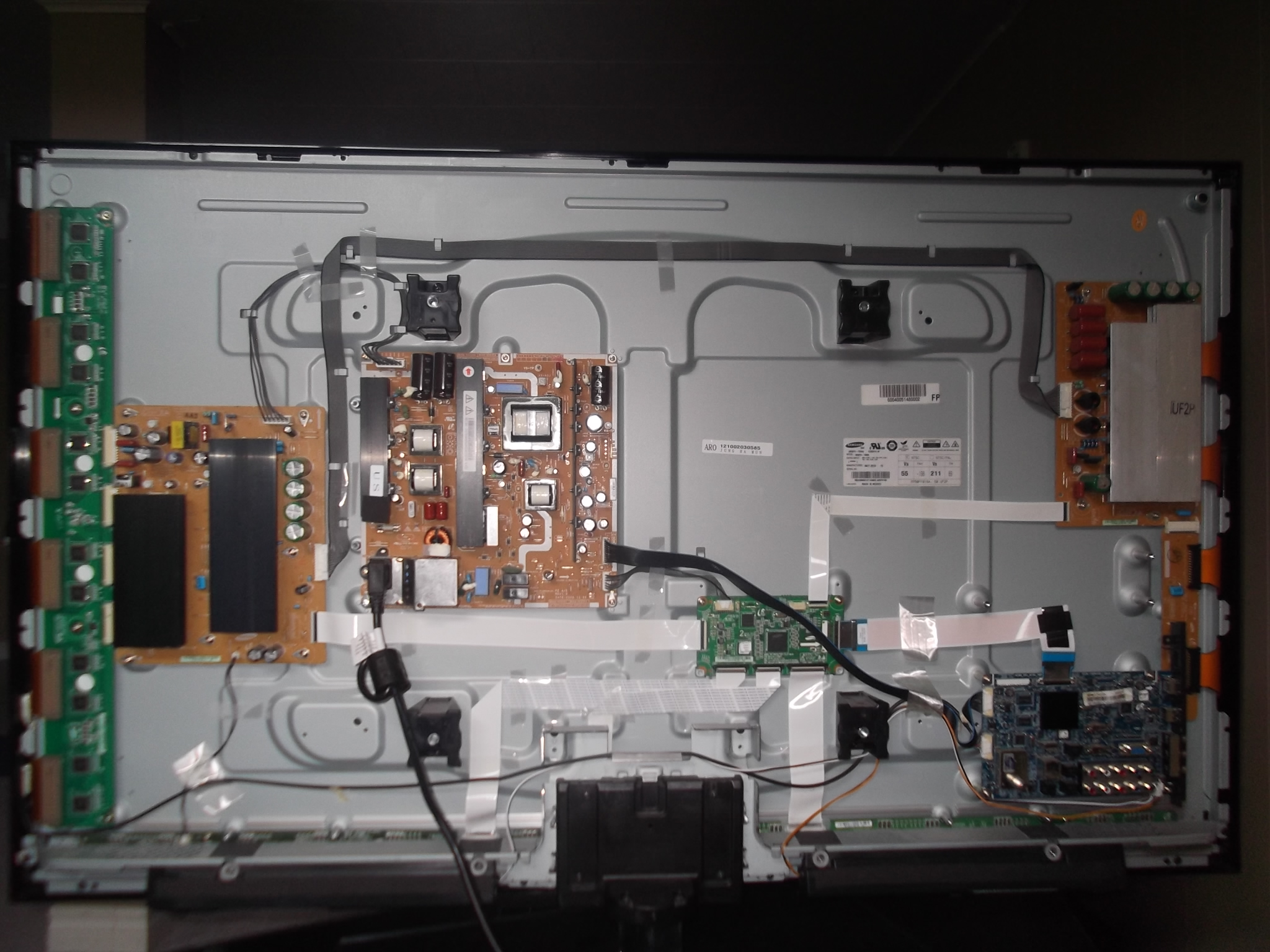

        The Y-buffer and possibly Y-main are likely at fault.
        Now, time to take some pictures and show us the layout, so we can help locate replacement parts and highlight test points.

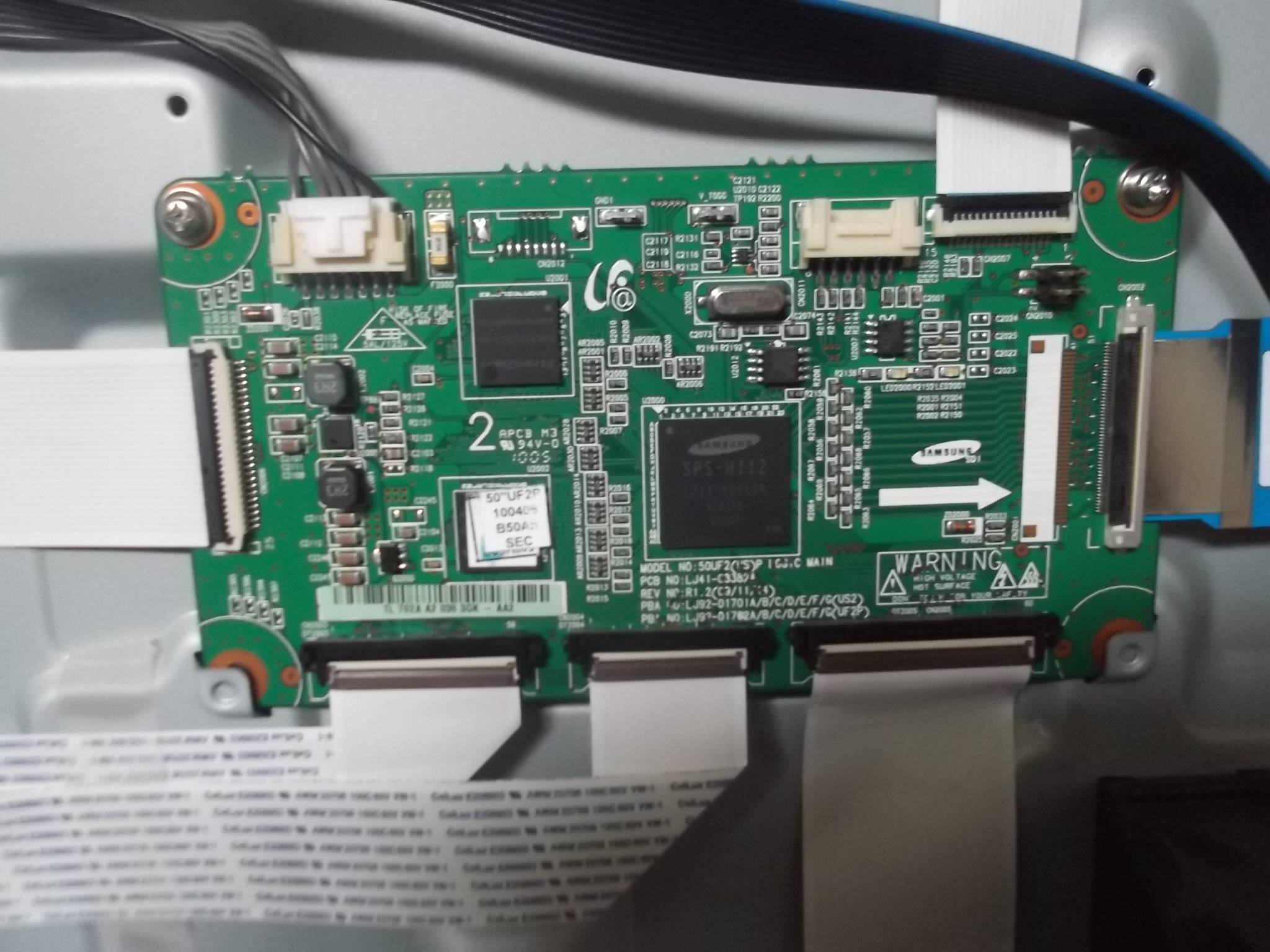

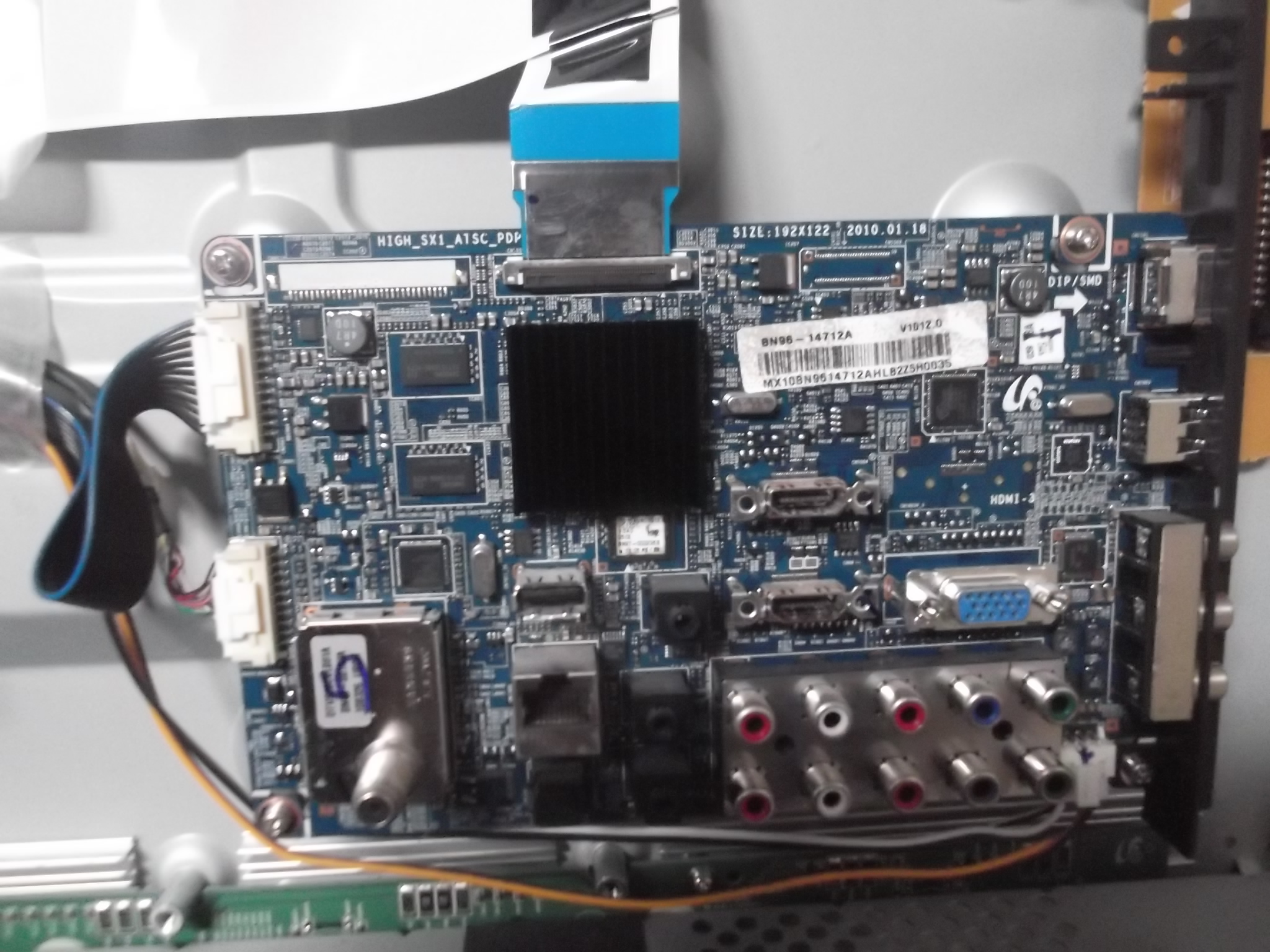

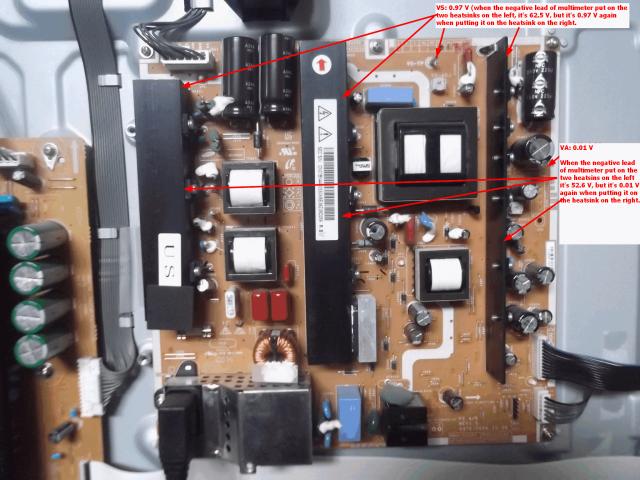

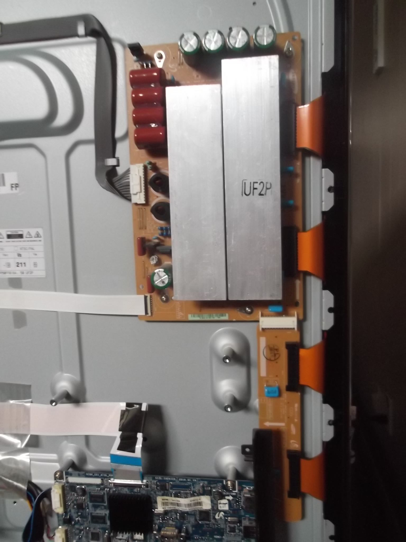

          Here are some pictures, please let me know if they are OK. Note that there is on gif file with some testing voltages I got here, please let me know if you need any more details, thanks a lot.

              Re: 50" Plasma Samsung TV (Model code: PN50C540G3FXZC), sound without picture!
              OK, the Y-buffer board is the green long thin board in this image.
              https://www.badcaps.net/forum/attach...2&d=1366571842
              It needs to be removed for testing. Follow this video. Focus around the connectors which are approximately for the same area as where the fault occurred.
              https://www.youtube.com/watch?v=51SZsfH60EY

                Thanks for the instruction but didn't find any short circuits around all 6 connectors.
                  OK, in which case I cannot guarantee the buffer board to bad, but due to your symptoms, I think it is probably the fault, 90% confidence.

                    Before finding a replacement on the Y-buffer board, can you please let me know if the voltages from the power supply board I tested are correct? As I noticed that the VS and VA ones don't match the numbers on the label of the panel and among the 3 heatsinks, the right two seem not connected/grounded to the panel or chassis properly as it gets a voltage of around 53V.
                      Good point. Maybe you have bad Y-main too. Try unplugging the Y-main and re-testing the voltages. If the voltages come back, plug in the Y-main and unplug the buffer board from it. Wait 3 minutes after unplugging the set before changing anything.

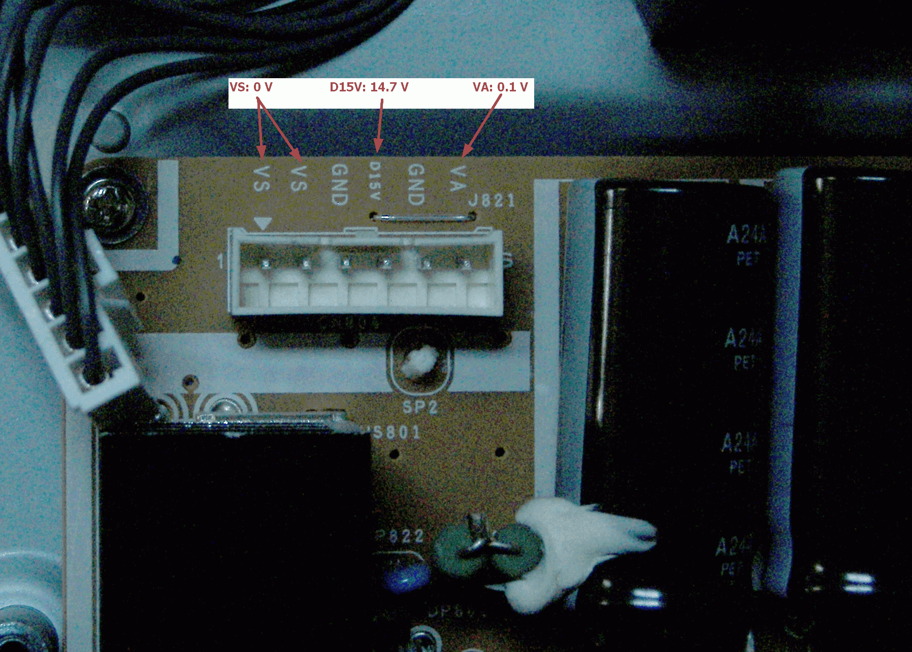

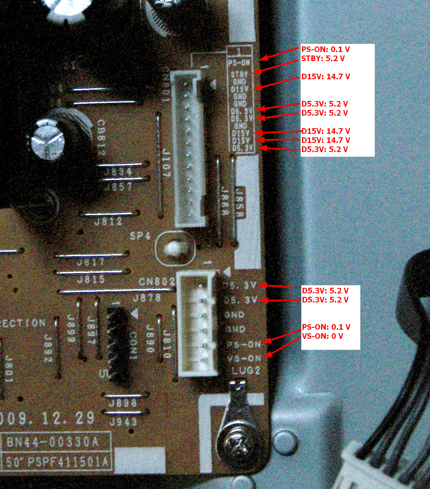

                        No luck to get the voltages back. Without Y-main, the VS is 0 V and VA still 0.1 V.
                        Here are two attachments with the voltages I got.
                        Top right corner of the power supply board: 100_6091.PNG
                        Bottom right corner of the power supply board: 100_6092.PNG
                        Please let me know if this helps narrow down the problem on it. Sorry that I put a wrong voltages in one of the first batch of pictures (DSCF8648.JPG)

                                  Here is a PDF with comments with voltages measured in different situations. Please let me know if you need any more info. Thanks for the help.
                                    Something's not right. Only ~10V on Vs? It should be around 200V, exact value on plasma panel. Did you have the X-main removed too?
                                      Yes, I had the X-main removed and it is 9.7 V. So the PSU has problem?
                                      Thanks.
                                        Possibly the control board is shutting it down. Unplug all power, set your meter up to measure Vs then plug in power. Does it spike to around 200V after a few seconds?
