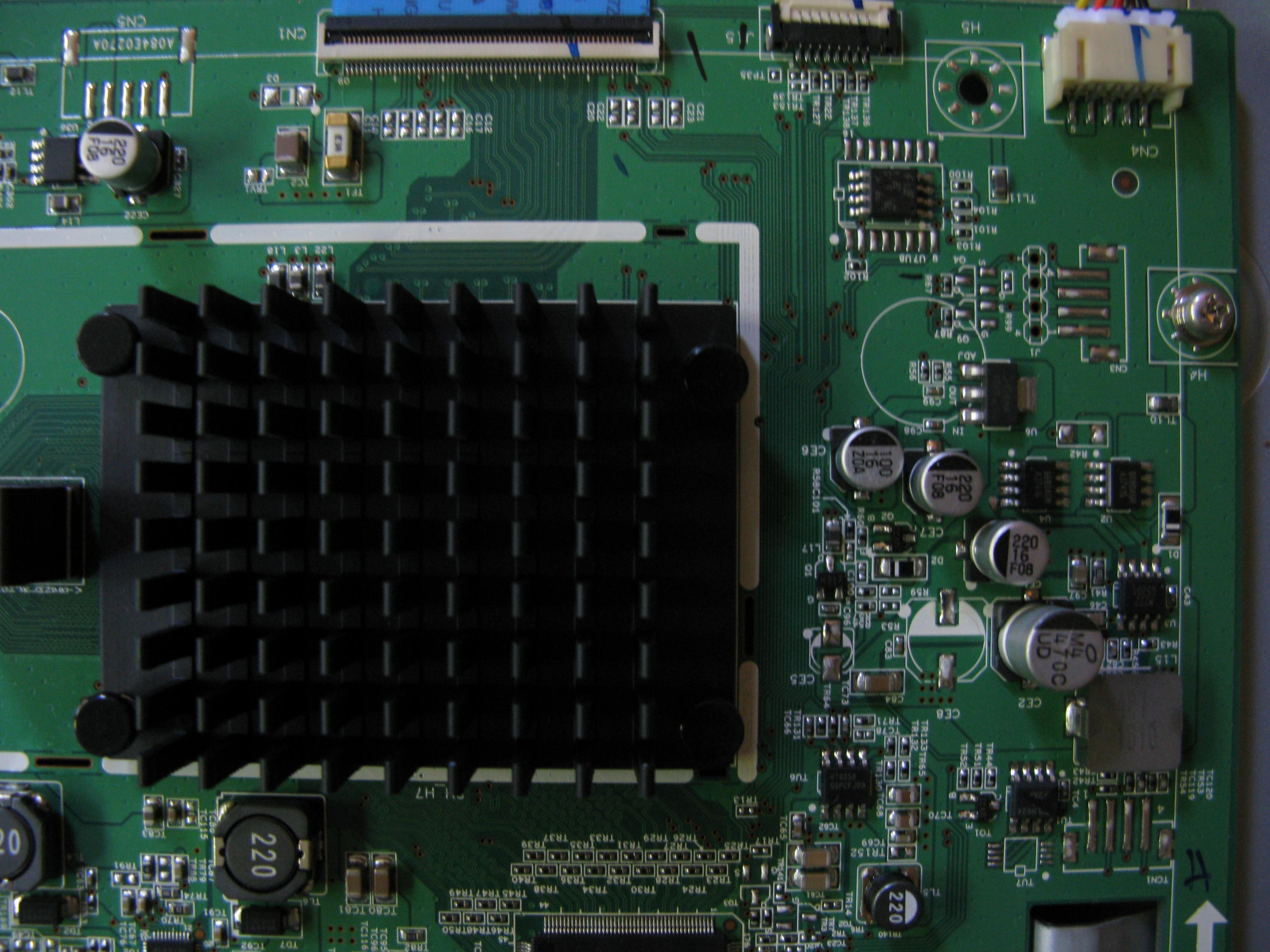

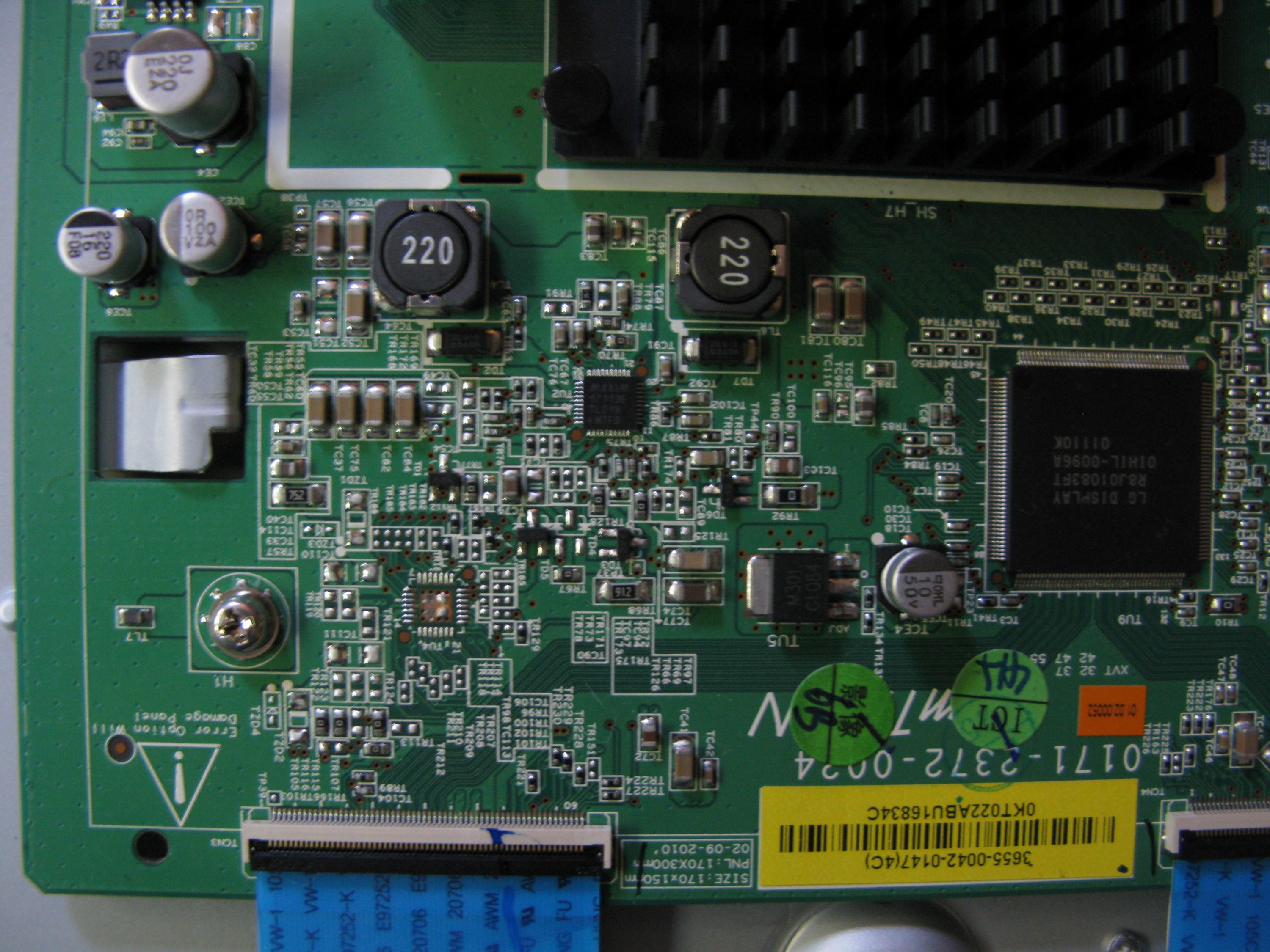

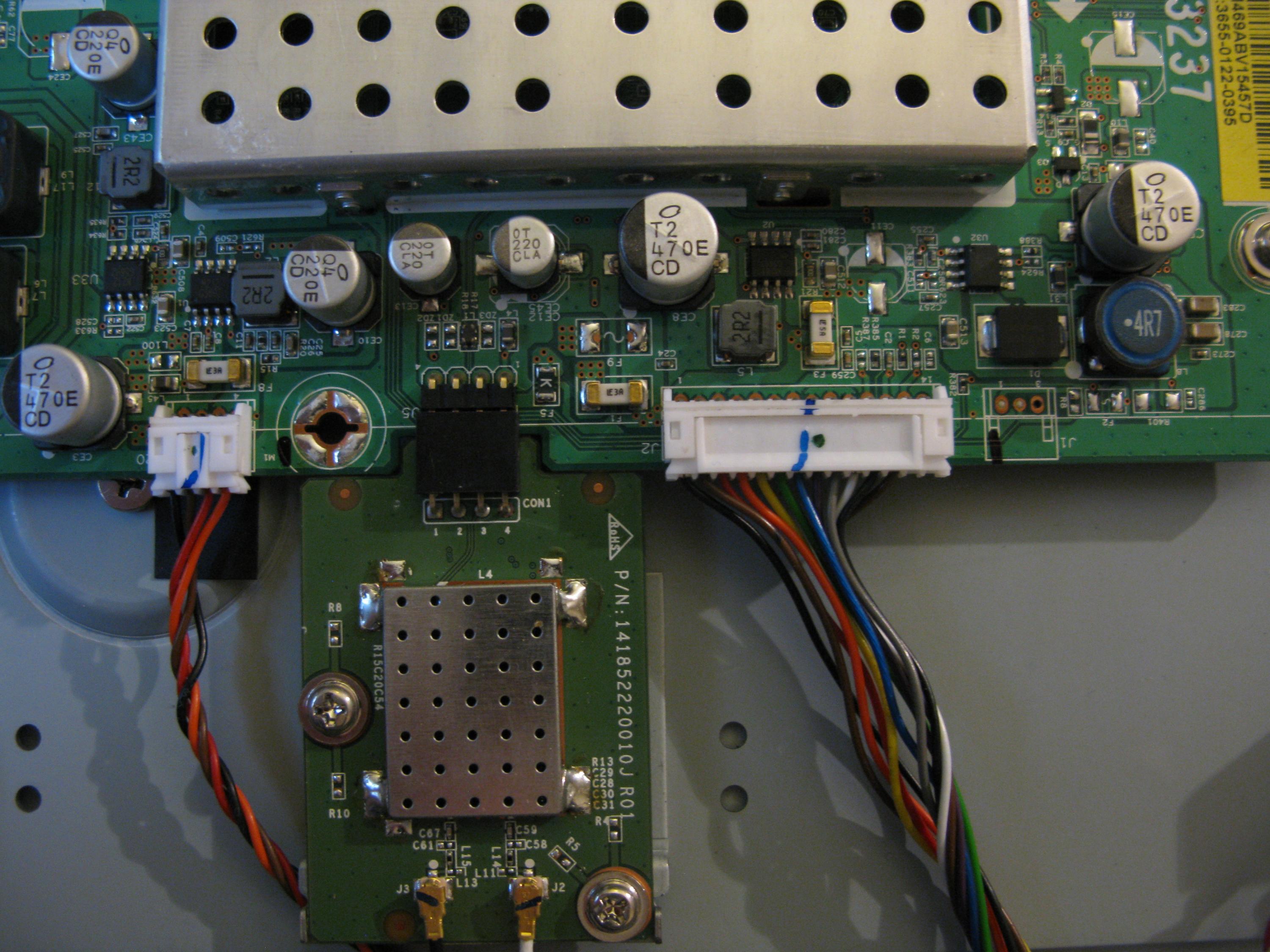

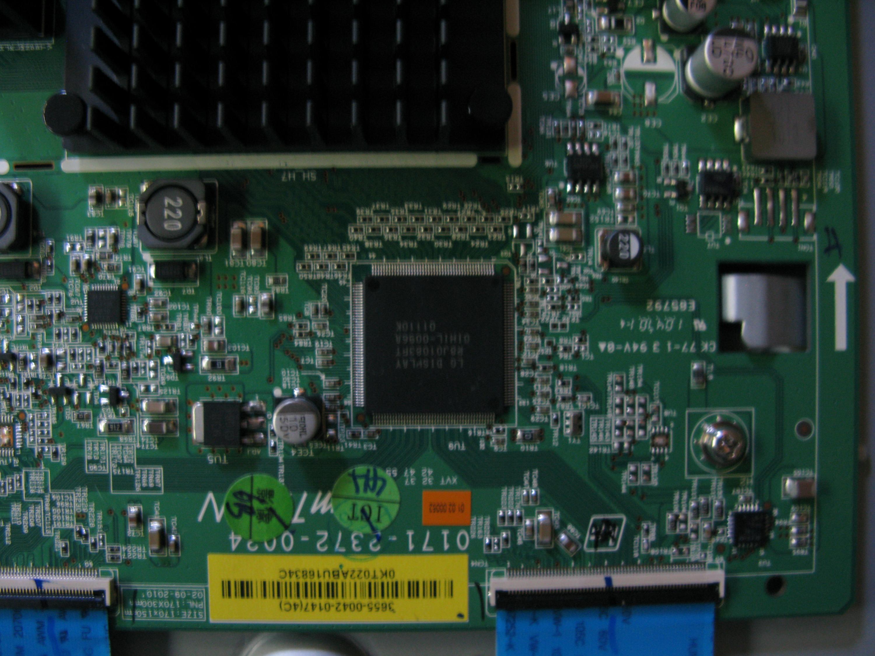

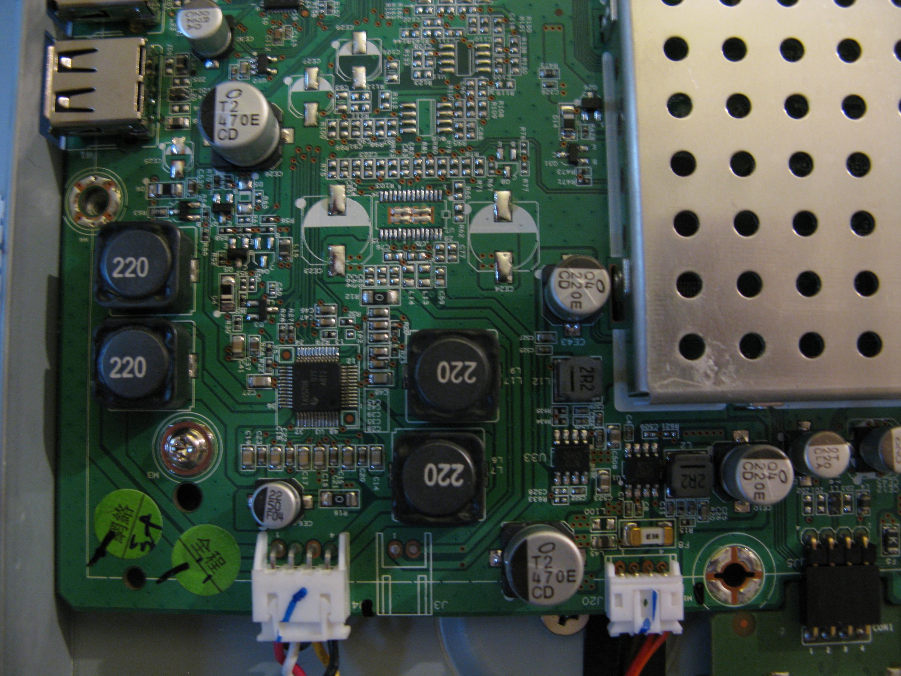

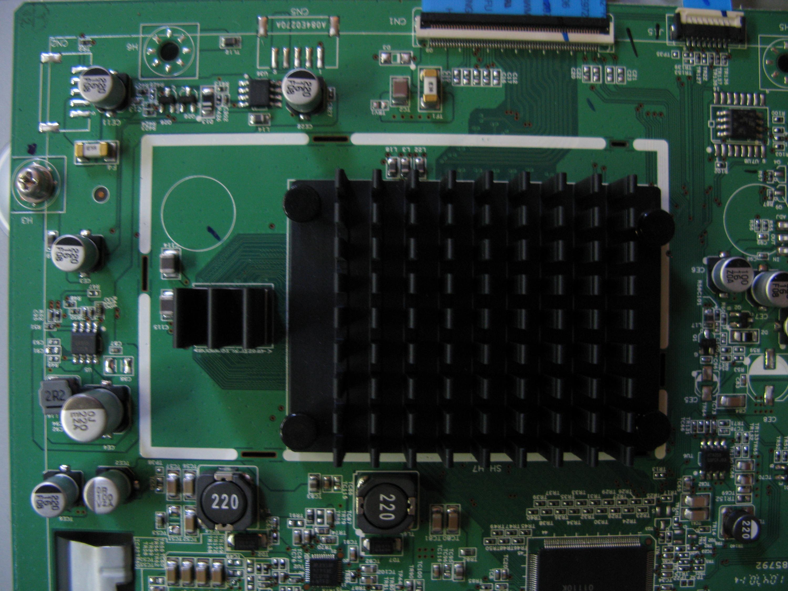

    Inverter boards are a good start but the power board cannot be ruled out just yet. Posting pictures would help as well.
    • AlDunbar
      • Apr 2013
      • 3
      Re: Vizio XVT553SV Sound, no picture
      Sorry for the delay. I am now set up to reply quickly.

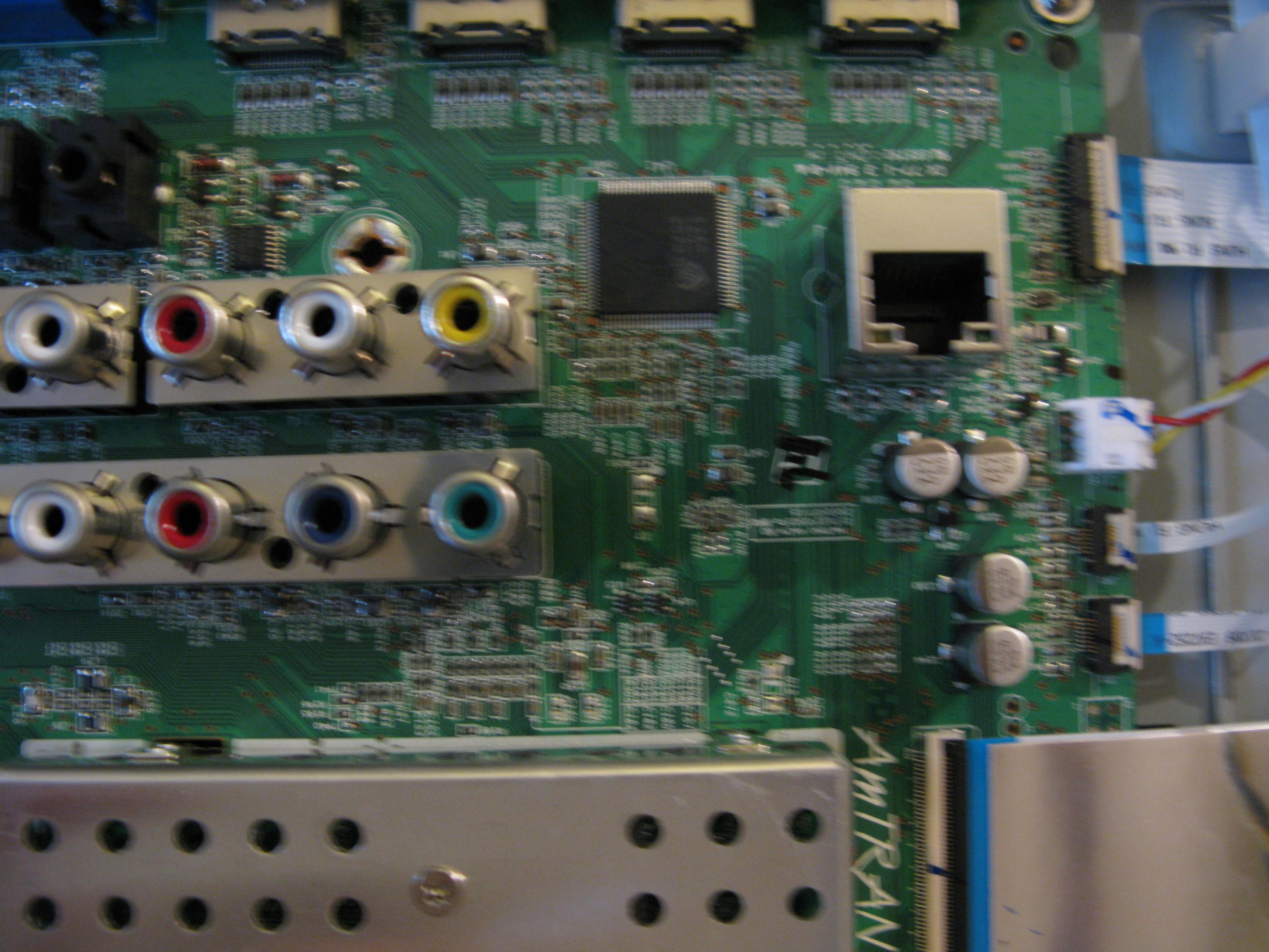

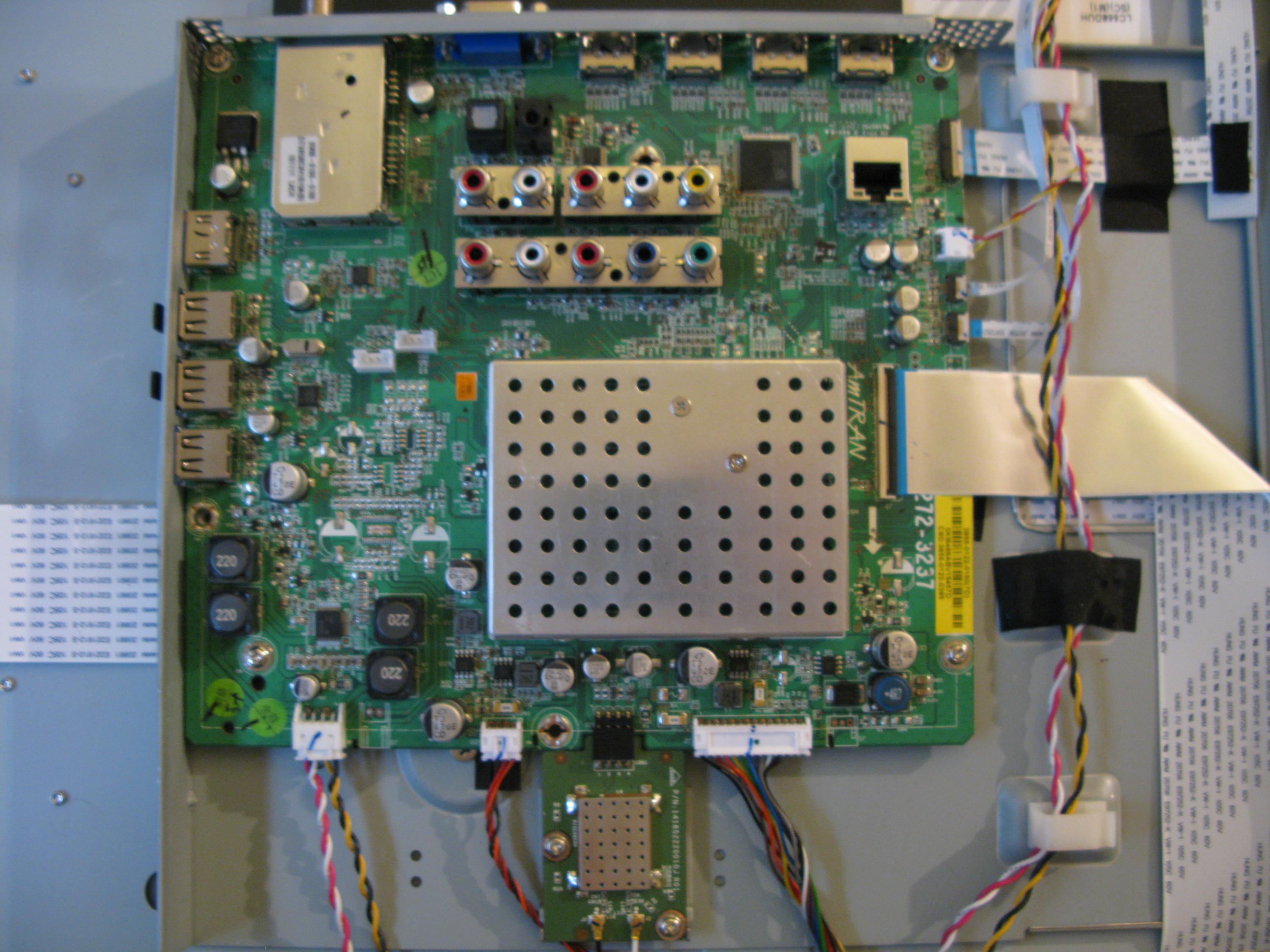

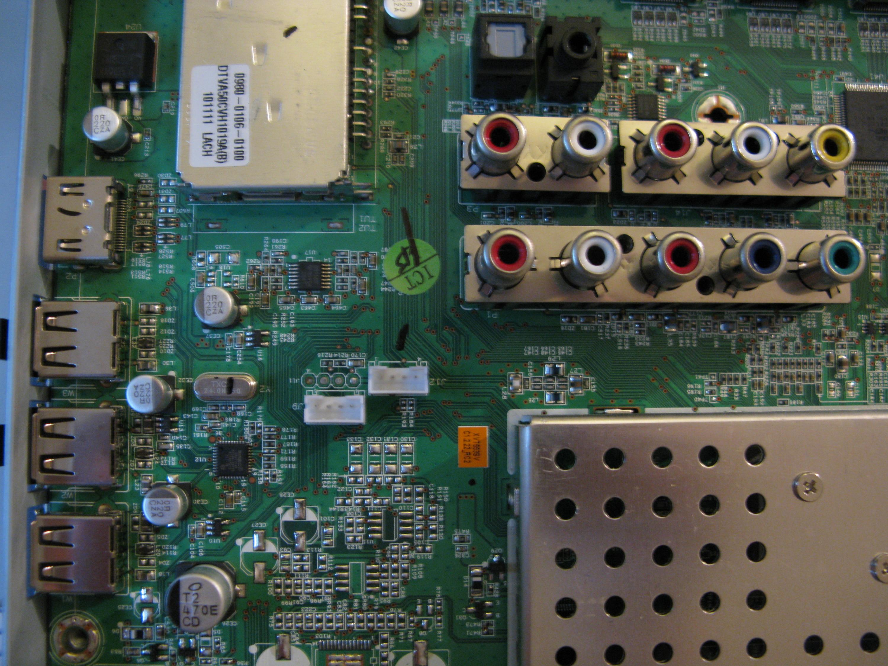

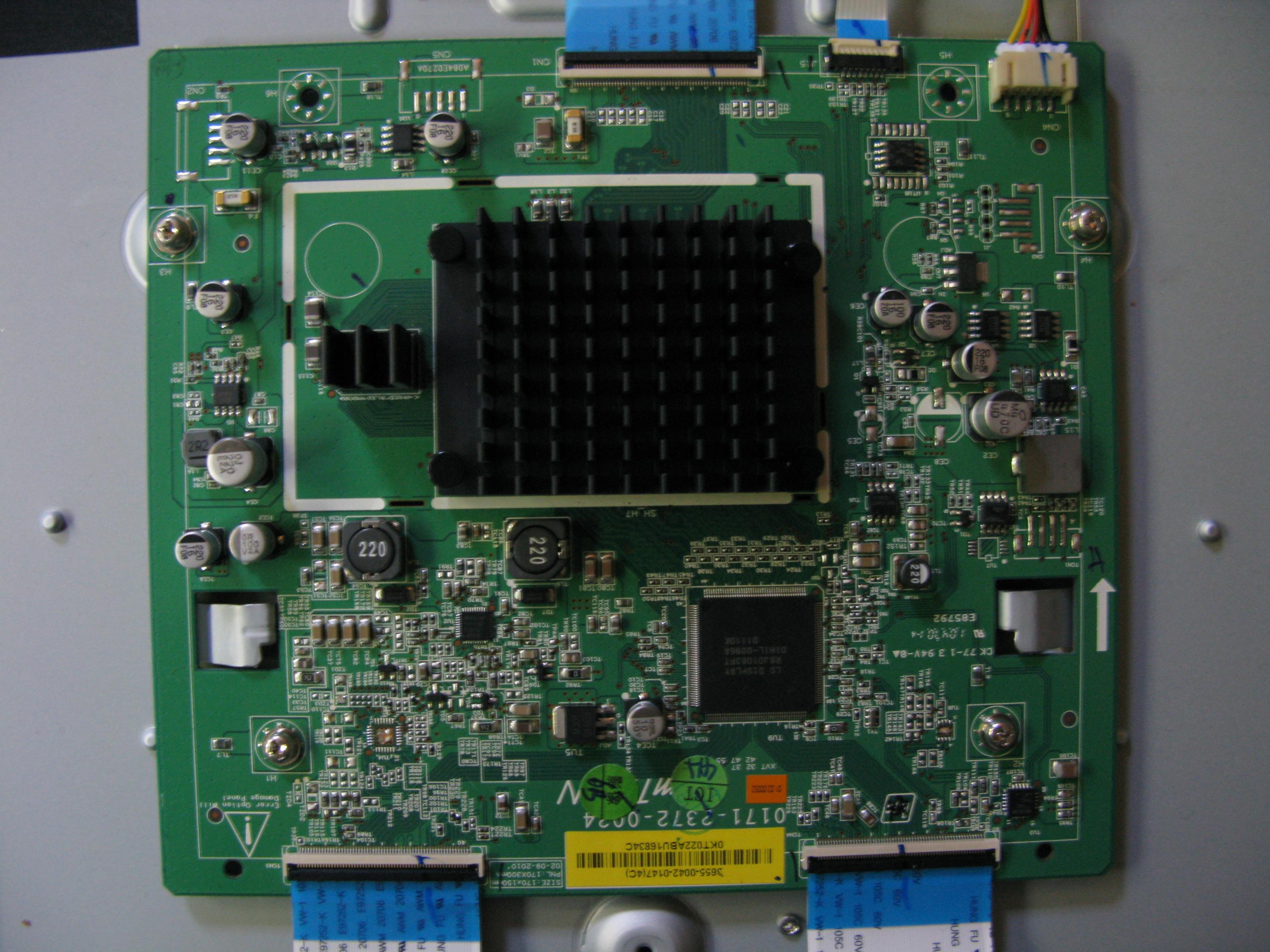

      Here are two boards, some pics better than others.
      Of the two other full-sized boards, one is the large power supply board and the other has "LED driver" printed on it.
      Please let me know what else I need to show.
