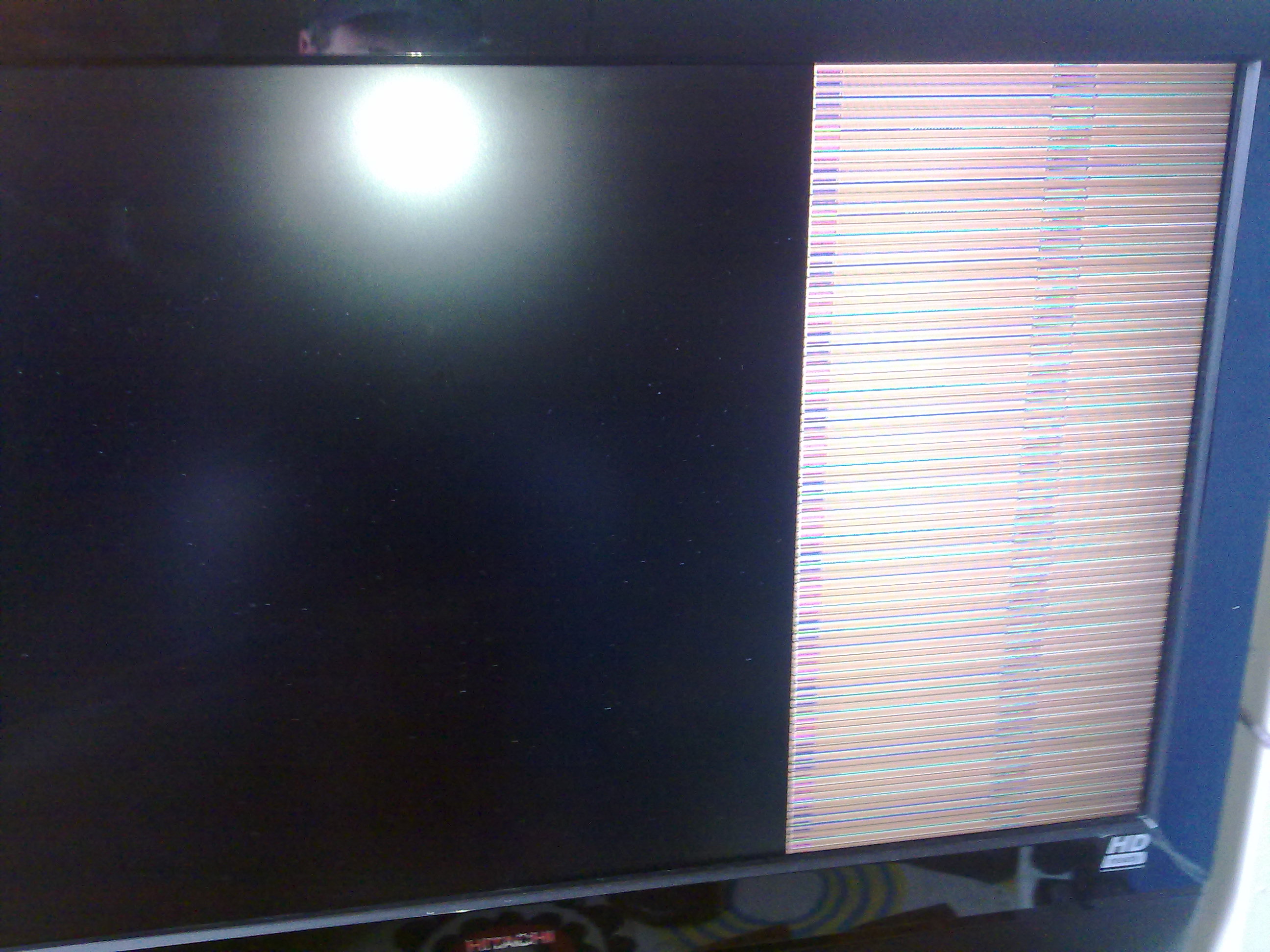

        Re: Hitachi L32HP01 No menu in DTV
        Hi Again
        Just done a couple more checks on the tv and dont think it is the digital board, I have uploaded pics of problem, personally think its a corruption problem but not sure, any ideas?
        The first pic is with the tv in hdmi connected, I do have audio

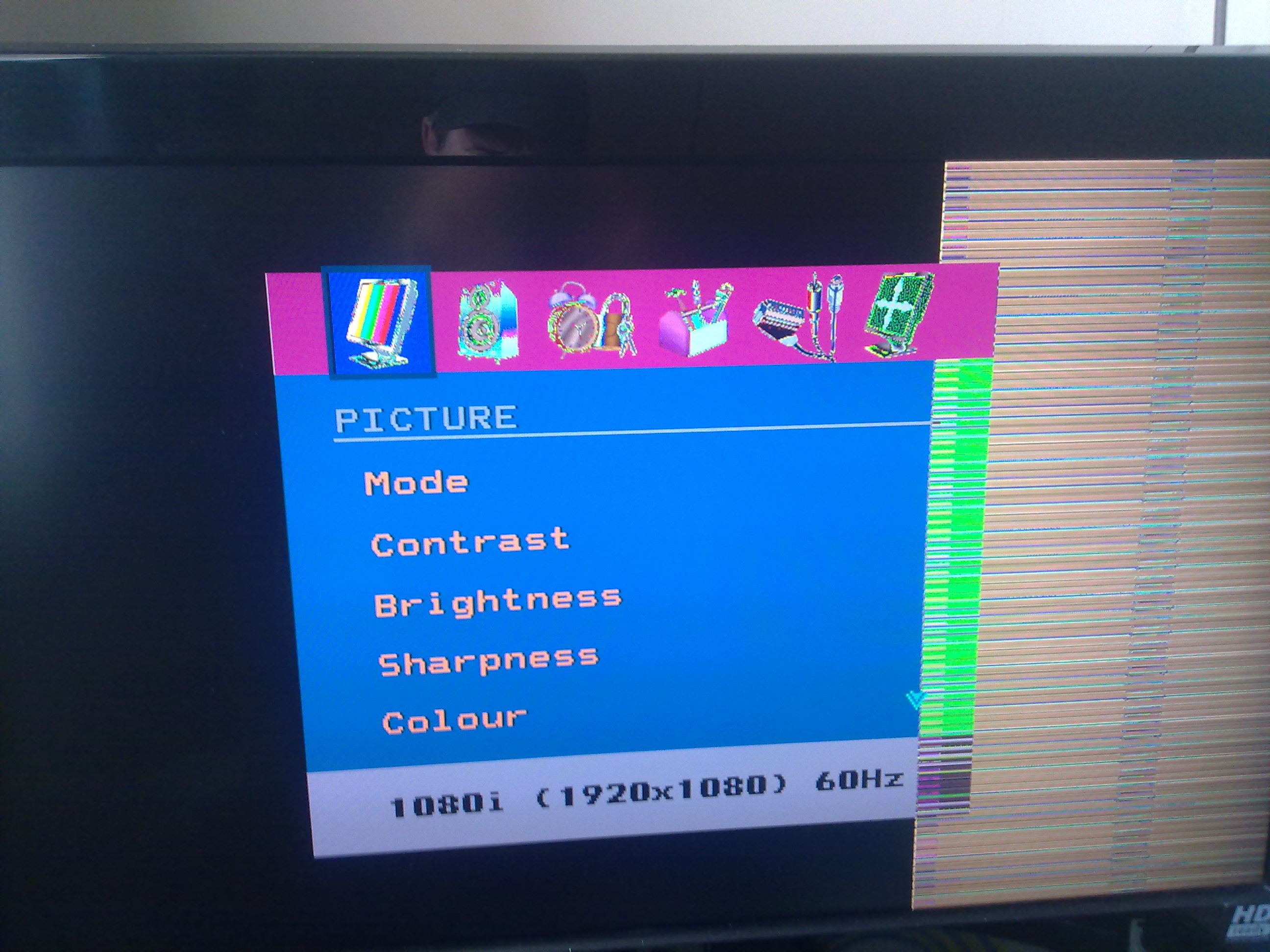

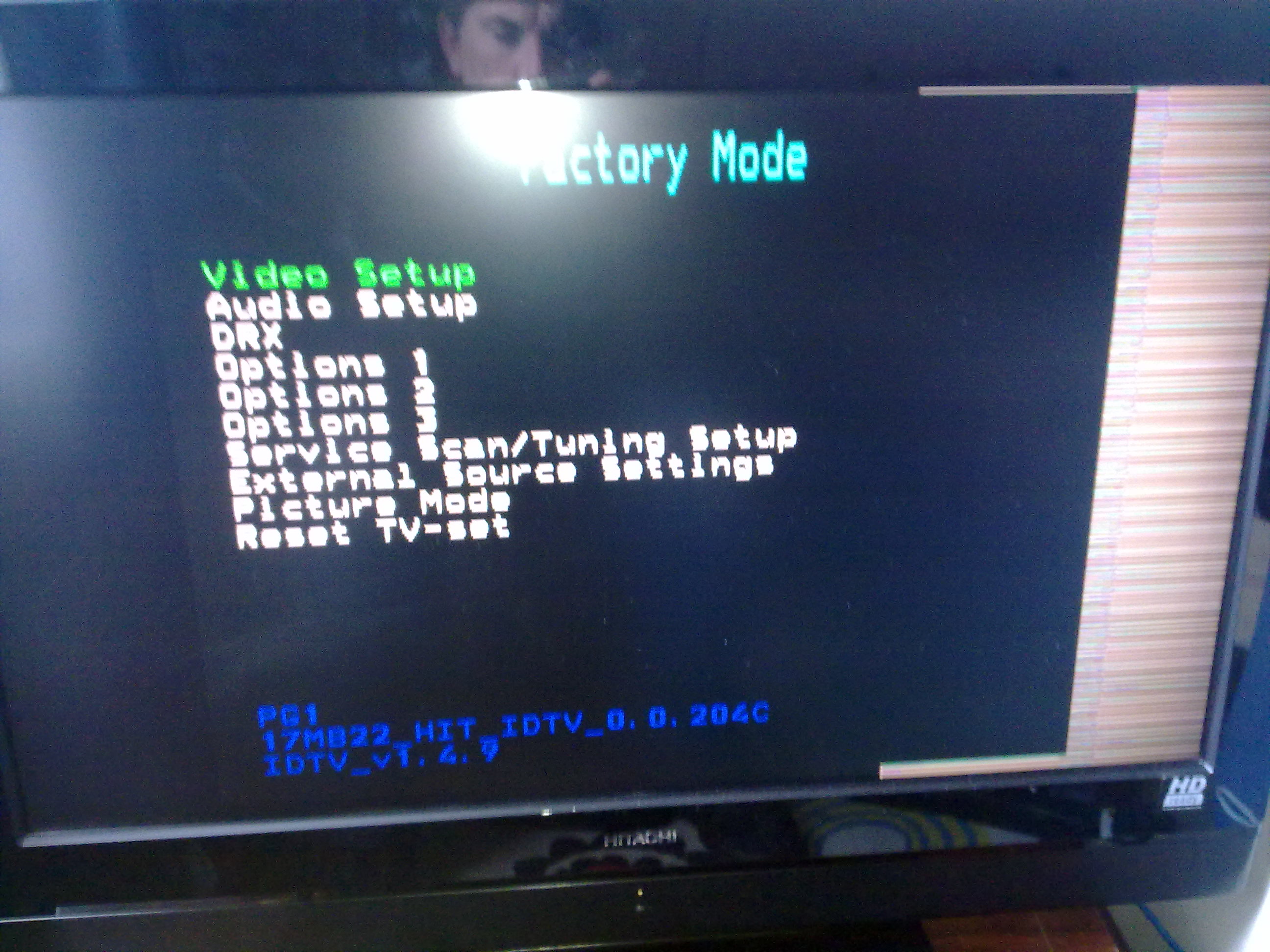

          Check LCD panel sticker - CHIMEI, Samsung, CHUNGWHA etc. Change LVDS setting to match in service menu.
          11.1V is too low for 12V too!
            Cheers Tom changed it to the correct panel but no luck, changed the lvds mode to off and the main menu has come back but still only a third of the screen showing very distorted
                Will answer my own question just put another working board in running with bang on 12v and everything booted up picture perfect dtv has returned
                Thank you Tom, I would of been chasing my tail for hours on this one
