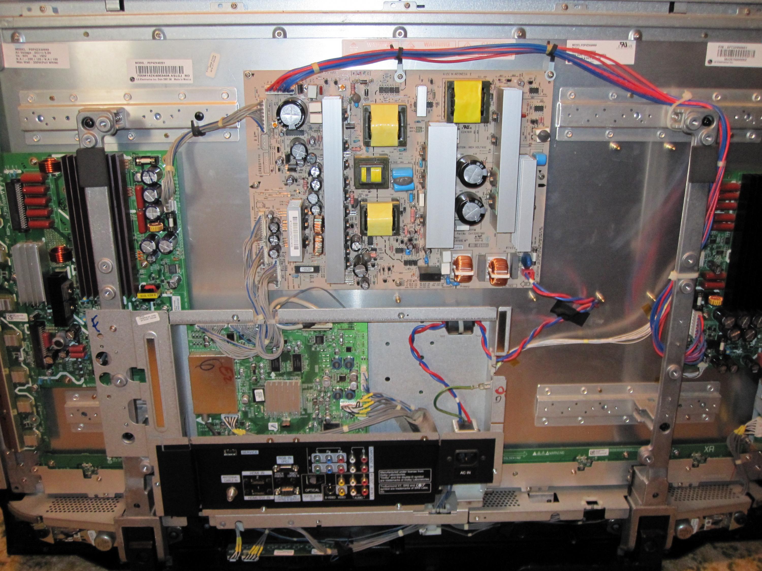

    Hi, have another one here to attempt to fix.
    Did the light bulb trick, no light with boards connected or disconnected.
    Three green leds on control board lit, i believe there are four, and one on main board.

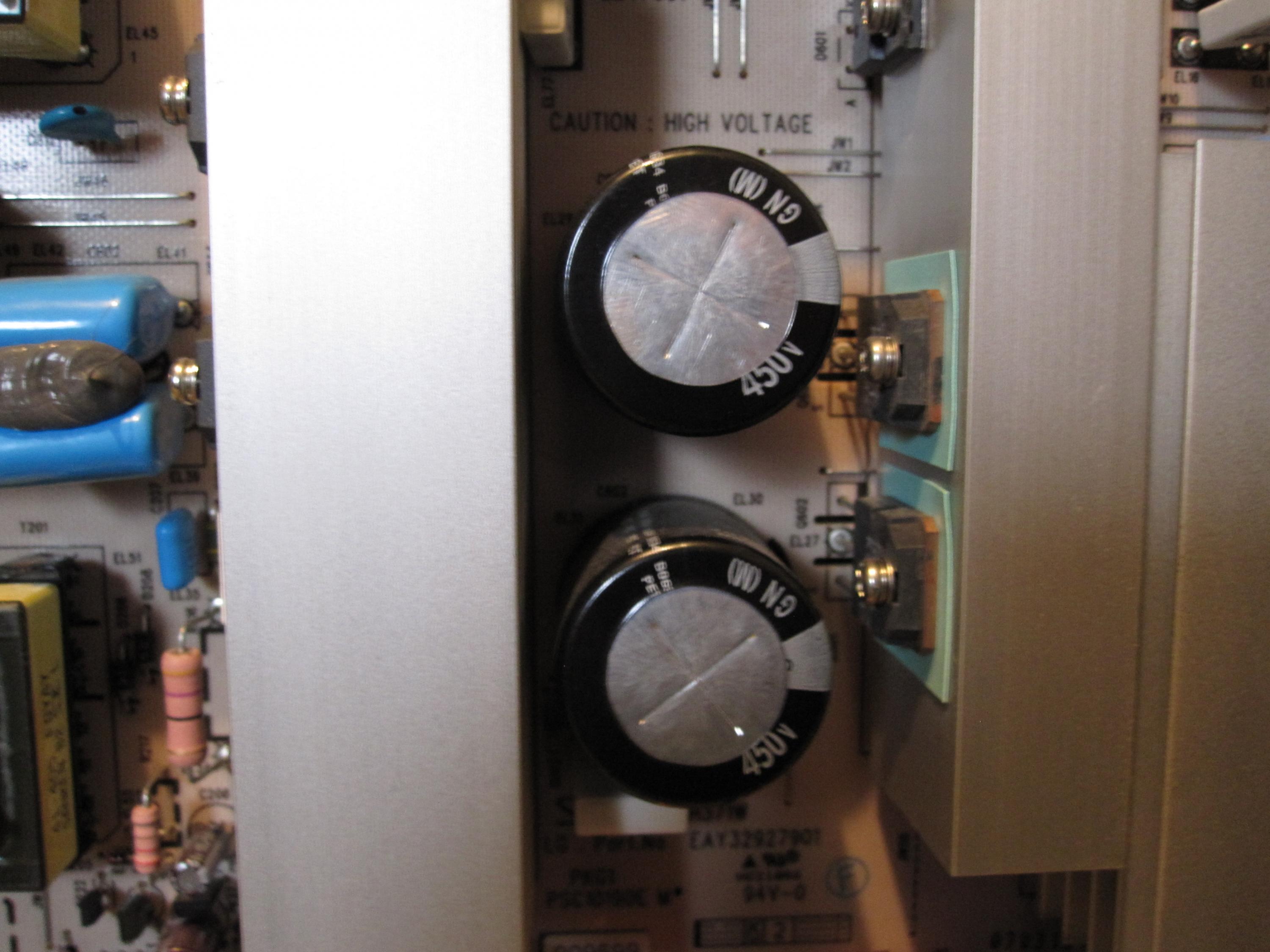

    Two 450v 270uf Nichicon caps look slightly bulged.
    Took some voltage readings at the connectors. VS :190v, VA :60v on the sticker.

    Anyone have any thoughts on these figures, pics to follow.
    I have read it could possibly be a ipm on y board!
    Any help is appreciated.

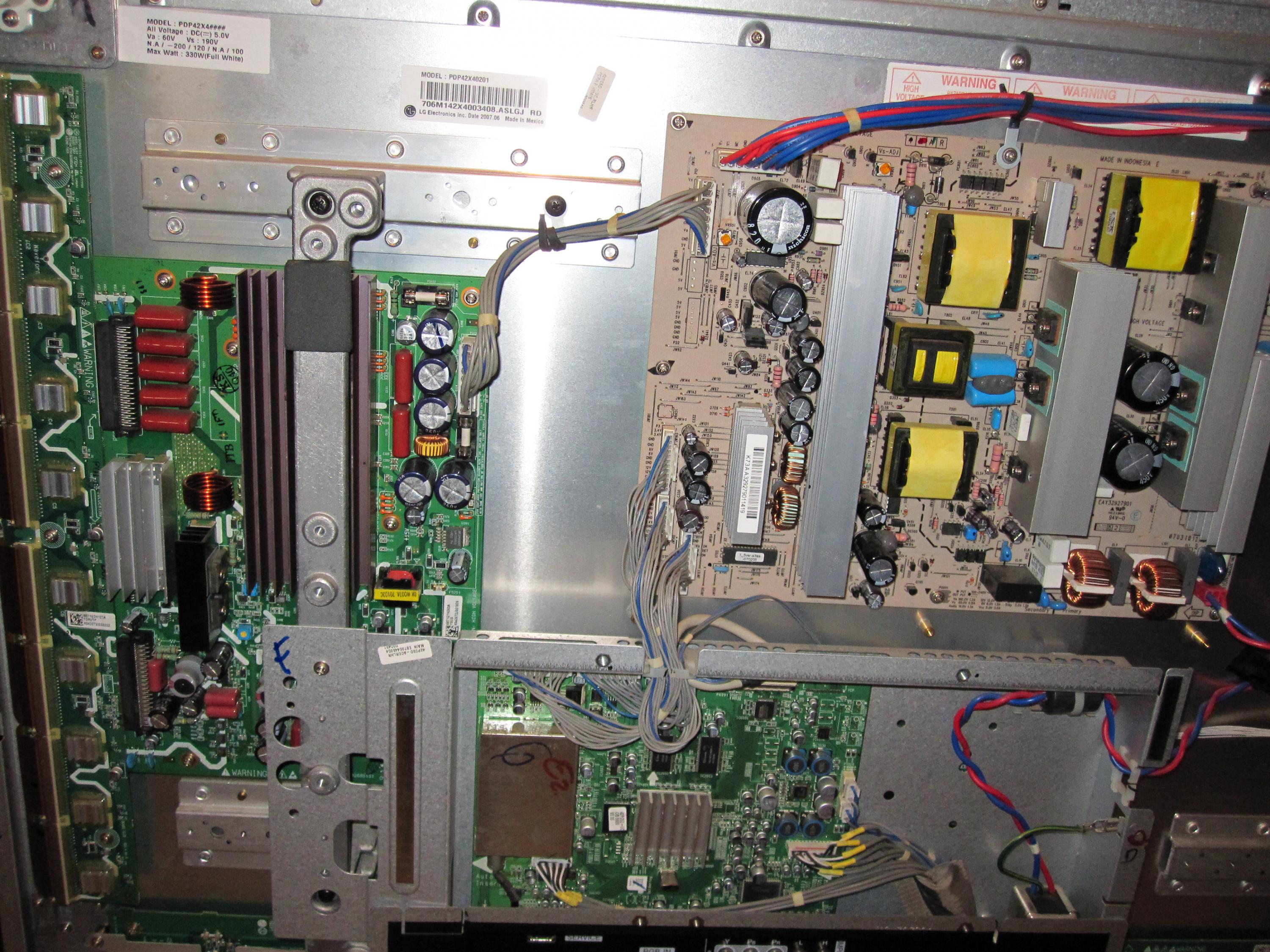

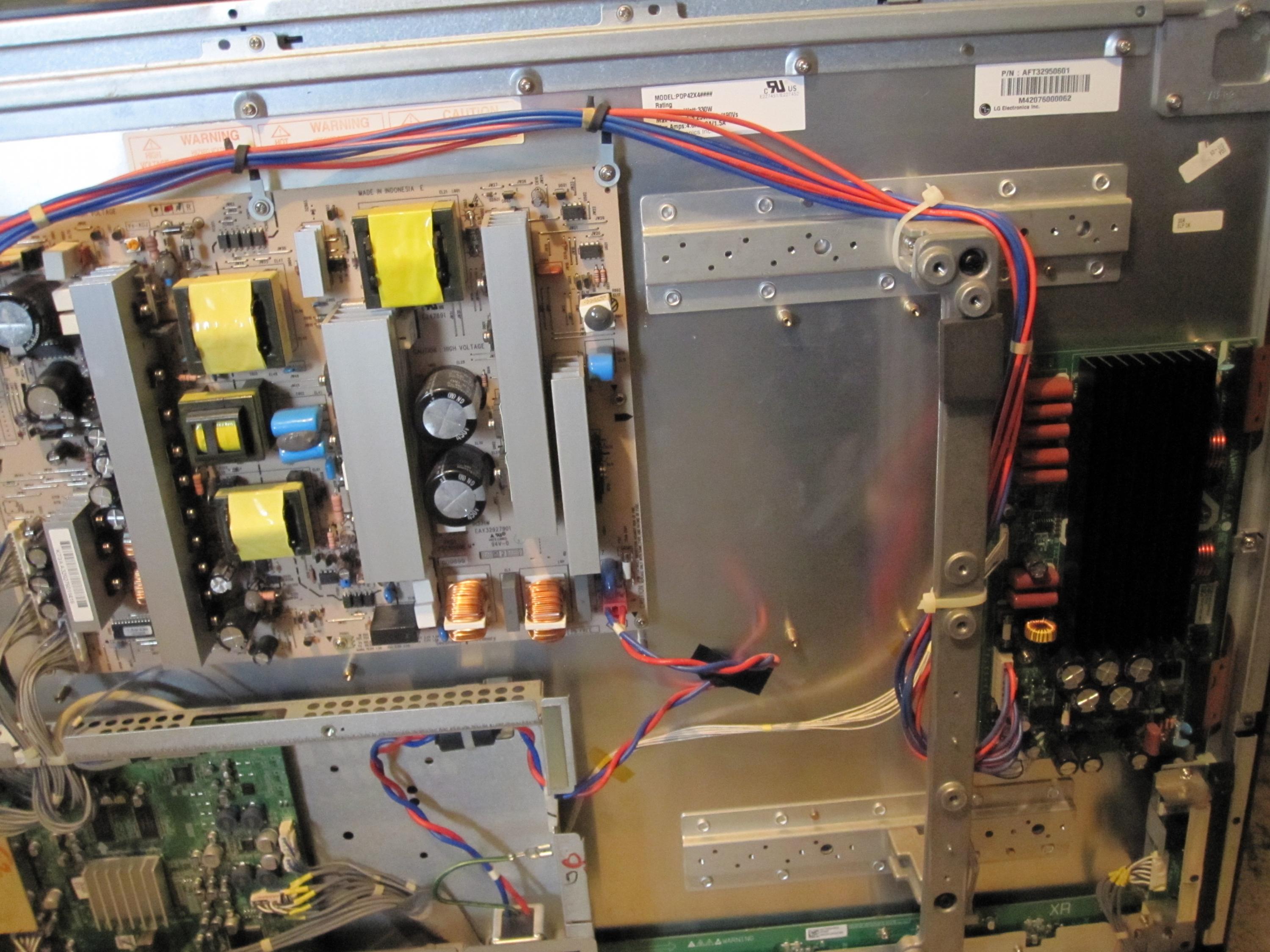

    Here are a few pics.
      Re: LG 42PC5D Plasma no pic but sound
      On the top left of the Y-sus you have a bank of five red capacitors:
      https://www.badcaps.net/forum/attach...5&d=1365742983
      Check the voltage across any of these (they are in parallel.) What do you measure?
                The LEDs are good. All lit is bad. Otherwise is OK.
                I have had bad IPM which tested good on meter (diode test) but was dead anyway. Sometimes it would make a ticking/clicking sound.
                You need to compare the voltage on the Y-sus caps to the same on the Z-sus' five red caps.

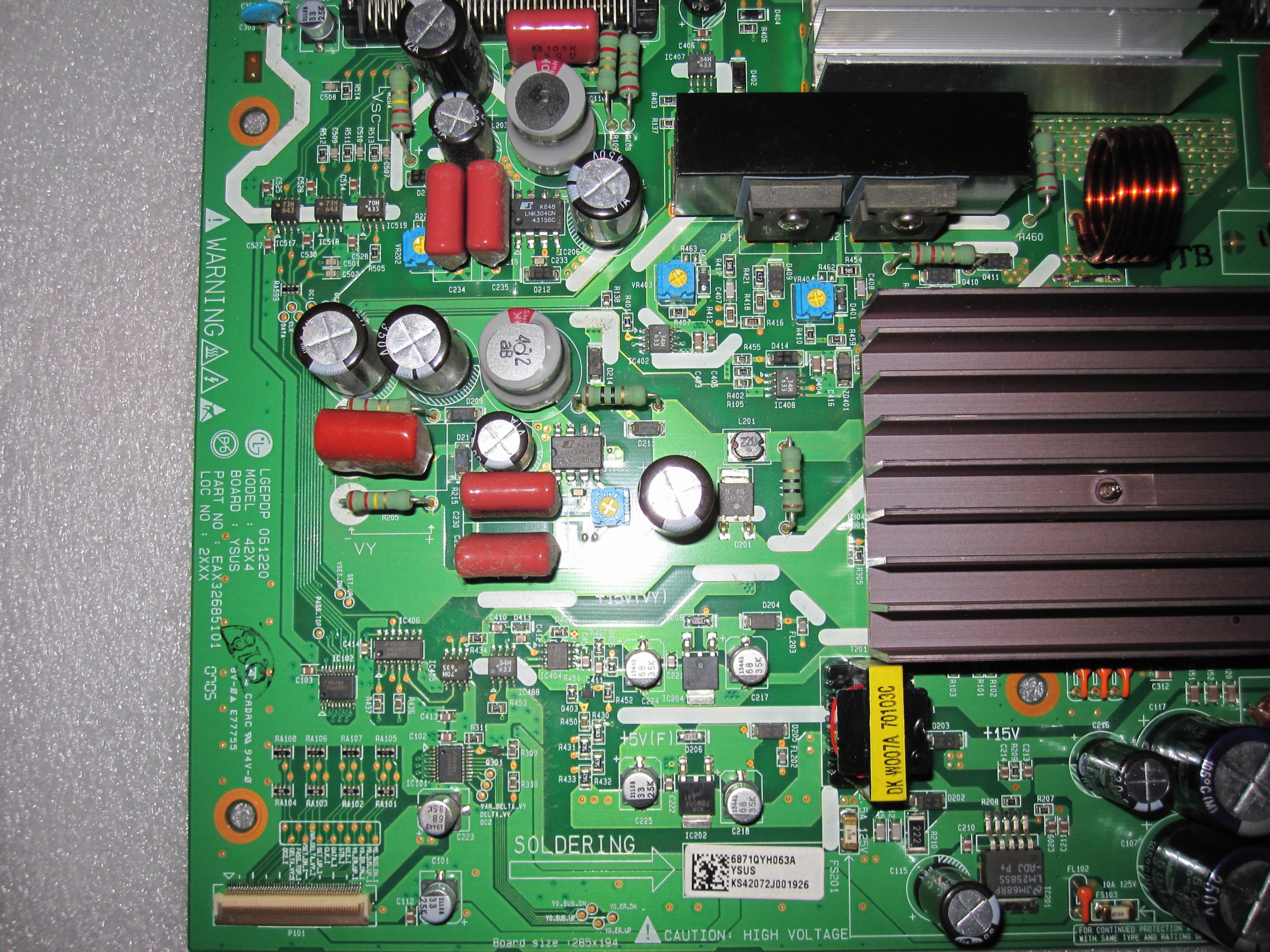

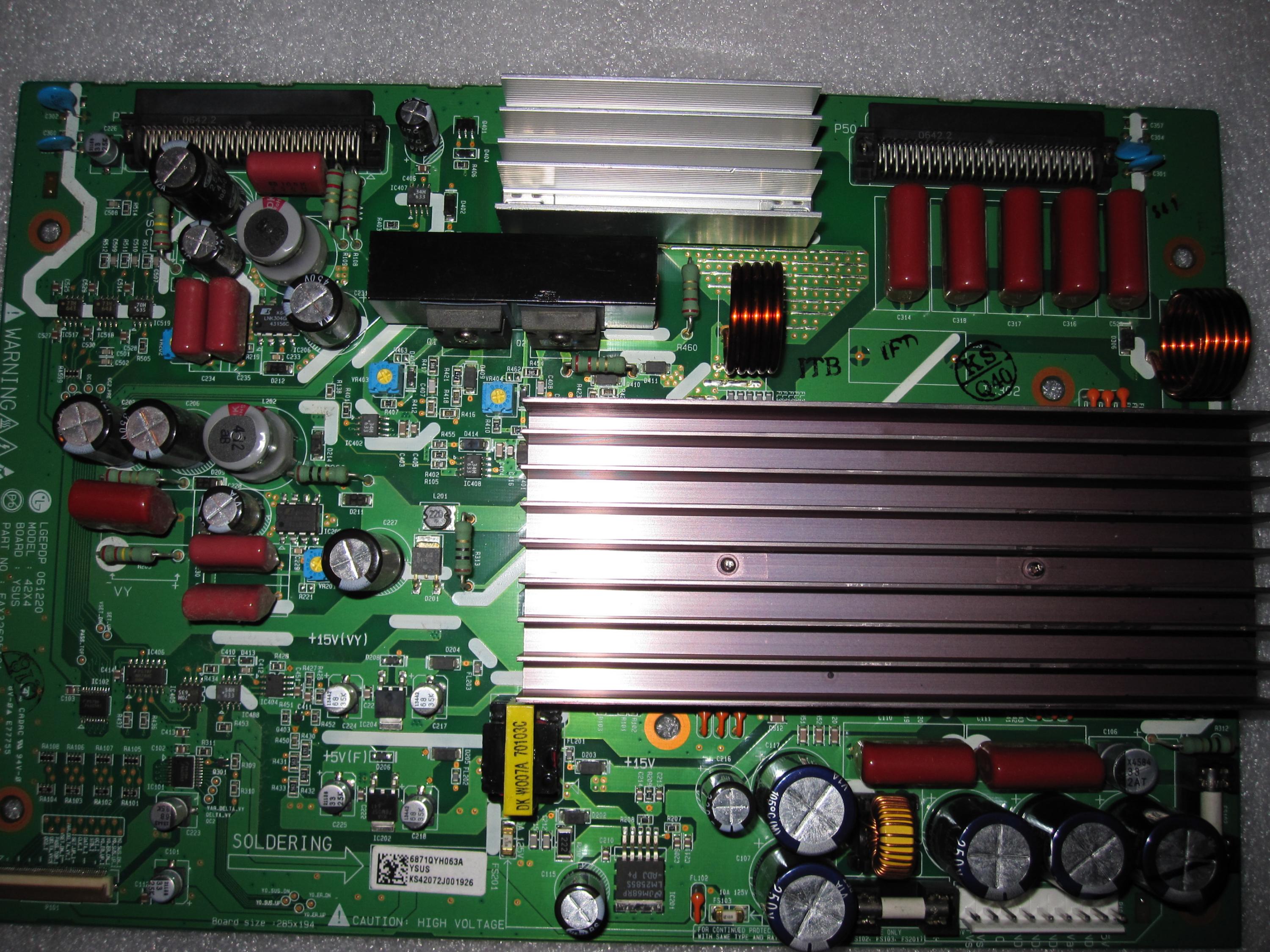

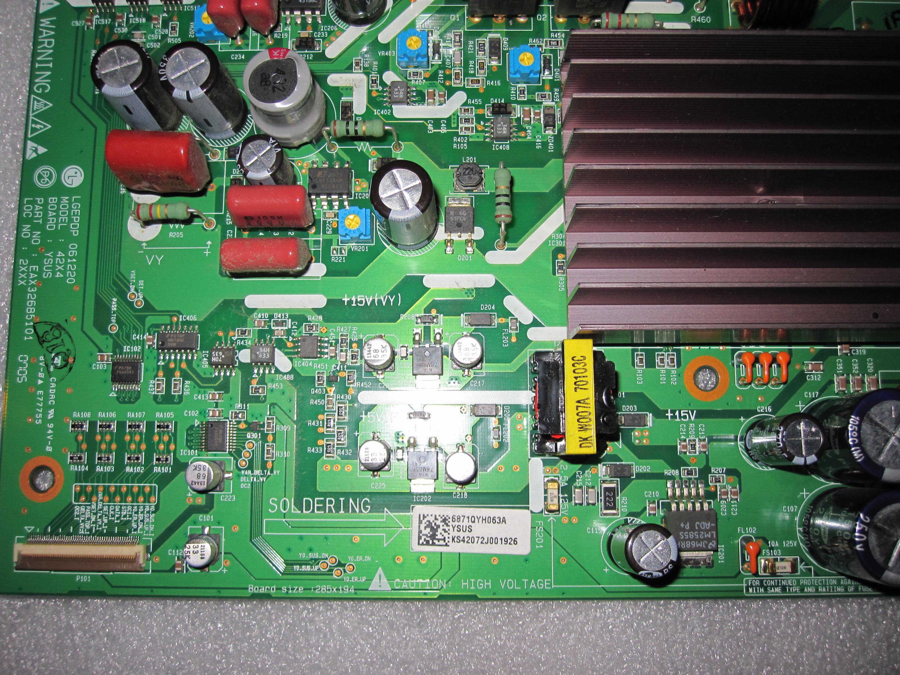

                              Ysus caps read 96.1v and Xsus is 87.2v, both fluctuate a little, five red caps. Copied from previous post.
                              I checked diodes at D202, D203, D204, D205 plus others on ysus.
                              I get in diode mode.
                              D202 forward .434v reverse .790v
                              D203 forward .433v reverse .841v
                              D204 forward .446v reverse OL
                              D205 forward .443v reverse OL
                              So it looks like the first two are bad! Checked others on the board and they test like the last two.
                              Also checked Q1 and Q2 mosfets.
                              Q1 D to S 160.8 kohms
                              Q2 D to S OL
                              Looks like Q1 is bad! That heat sink was very hot also.
                              Is there anything else i should be checking? resistors?
                              The bad diode has F46J on it, I can't seem to find a replacement.
                              Pics of ysus.
                                  Q1 G-S and G-D too.
                                  D's need to be verified out of circuit as they may be OK.
