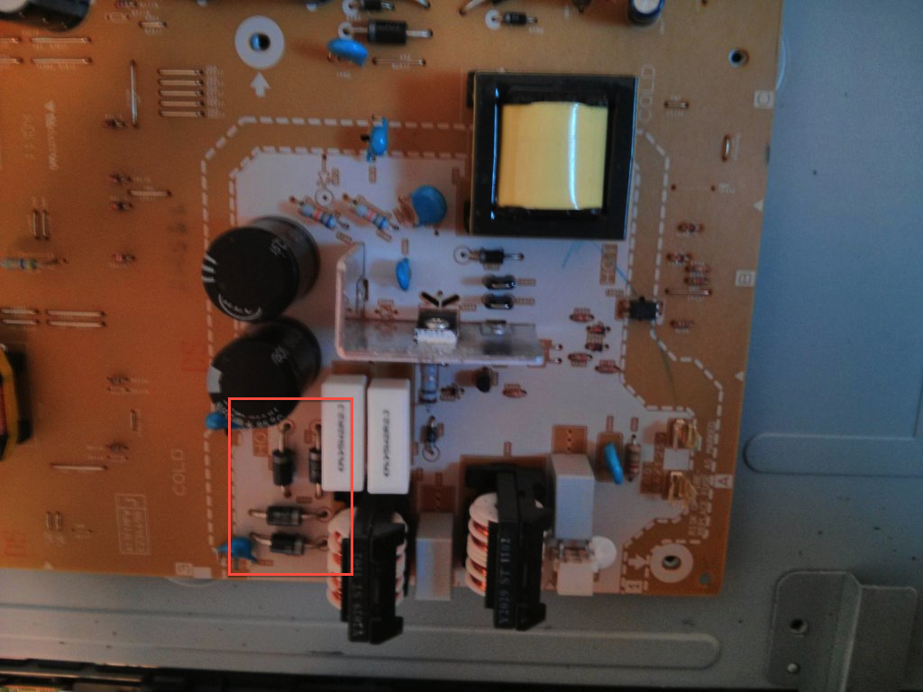

    Here are some pictures of the power supply. Sorry for the picture quality. The flash washed it out too much so I had to use HDR mode. My hands aren't quite steady enough for it:

                        Am I correct in assuming this chip is the bridge rectifier? I found a tutorial for testing them but I'm not certain exactly where it is.
                        I have two large caps and if I'm using my meter correctly, it says they're both bad. According to the capacitance test outlined in my manual the caps aren't charging at all.
                        EDIT: Uploaded the picture in an attachment. I can't find anything on this PCB that looks like a bridge rectifier.
                          Re: Magnavox 32MF301B/F7 blowing fuses
                          Ya, but seeing how I see four very large diodes all close to each other, I'm thinking the power supply designers decided to use four large diodes instead of an all-in-one bridge rectifier. I'd check those for shorts. And I would check those two big capacitors for shorts also.
                              Well damn. It appears all four of those diodes are shorted. 0.55V going both directions on all of them.
                              If I'm reading the caps correctly they're shorted as well. Both are a steady 1.8 ohms. They should climb in resistance if they're good, no? I also did the capacitance test using the setting designed for it on my meter and it reports they do not charge.
                              Given so many failed parts it's probably safe to assume there are more? I left this out in the OP but now I feel I should note, these fuses did not fail gracefully, even the second one which was plugged into a good circuit. It failed with a bright flash of light and the inside of the glass is smoked as a result.
                              Is this a lost cause for a novice like me or is there more testing to be done?
