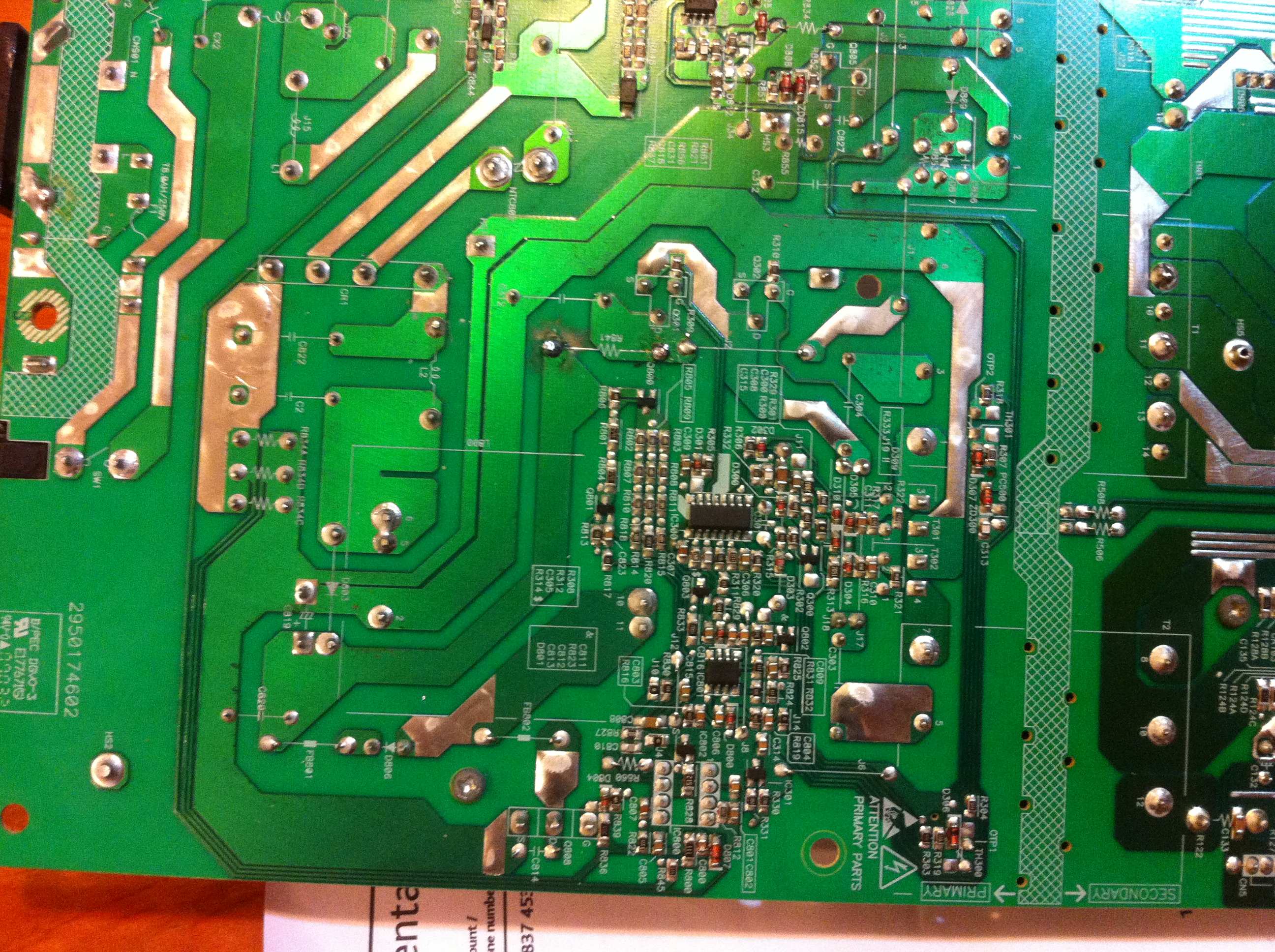

    The model is at4220b and power supply board is a delta dps-291ap , it happened after we unplugged it from the mains and then replugged it in, there is no standby light and it won't turn on, the fuse is good in primary power supply and we have 240v coming in, no leaking or bulging caps and nothing looks shorted or dry soldered, no power on pson wire , no 5v 12v or 24v on wires from the power supply board, I had power supply board out and looked it over, when I fitted it back in , I turned it on, heard a crackle from power supply board area and it powered up , with standby led and also turned on, when I pulled the power it would not come back on, I can use a ddm and repair car computers but could use some help with this , thanks in advance
    Re: Acer 42" LCD tv no power or stdby light

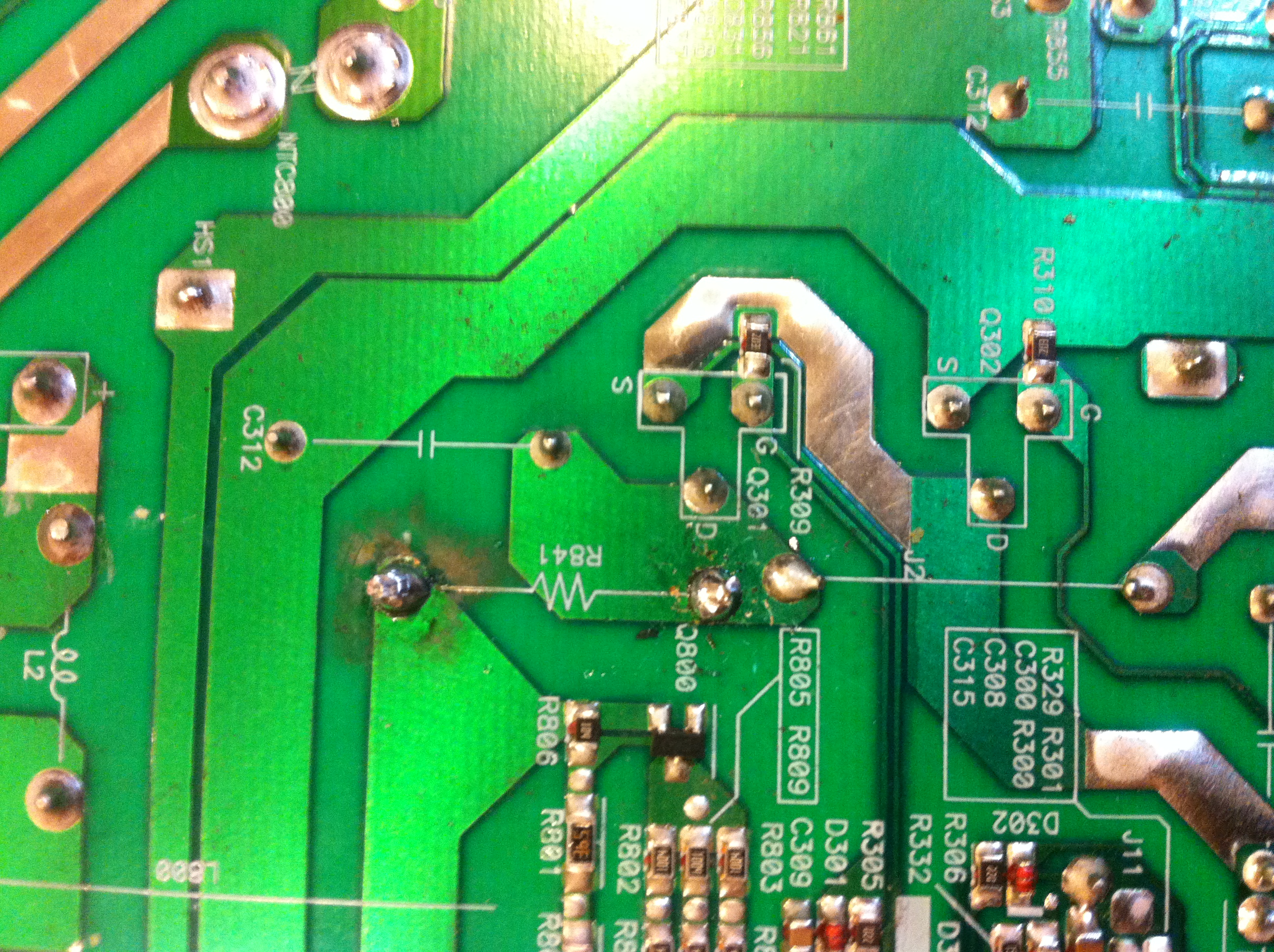

    just found a blown resistor in the primary circuit of the power suppy, its resistor R841 can someone please tell me the ohms, board is a delta DPS-291AP
      Any pictures of the board?
        When you do a picture show where the resistor is/was.
        Have you taken the resistor off the board - sometimes is blows off one side
        but you can see the markings left on the other side?
        If its burnt try cleaning with isopropyl alcohol.

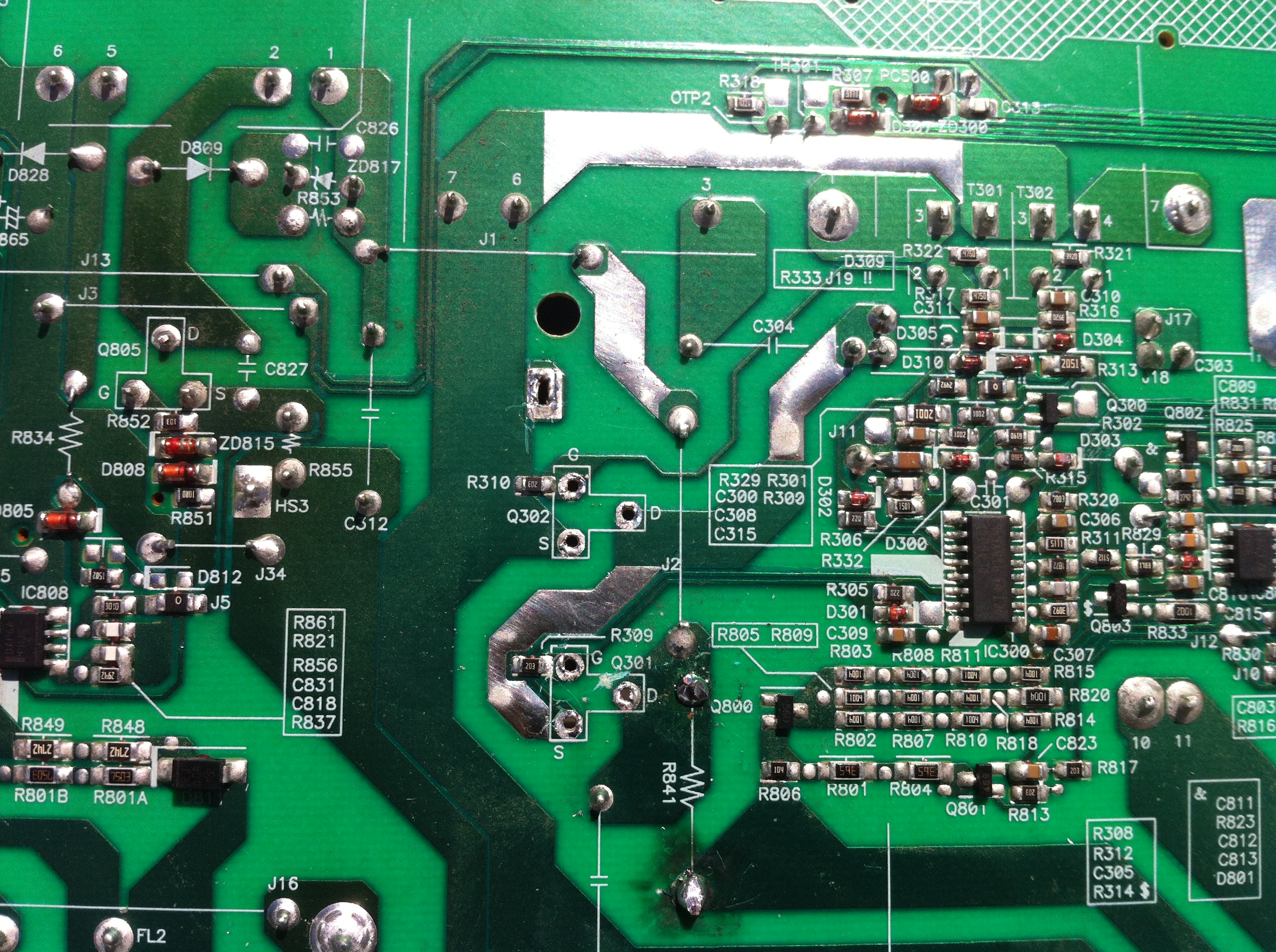

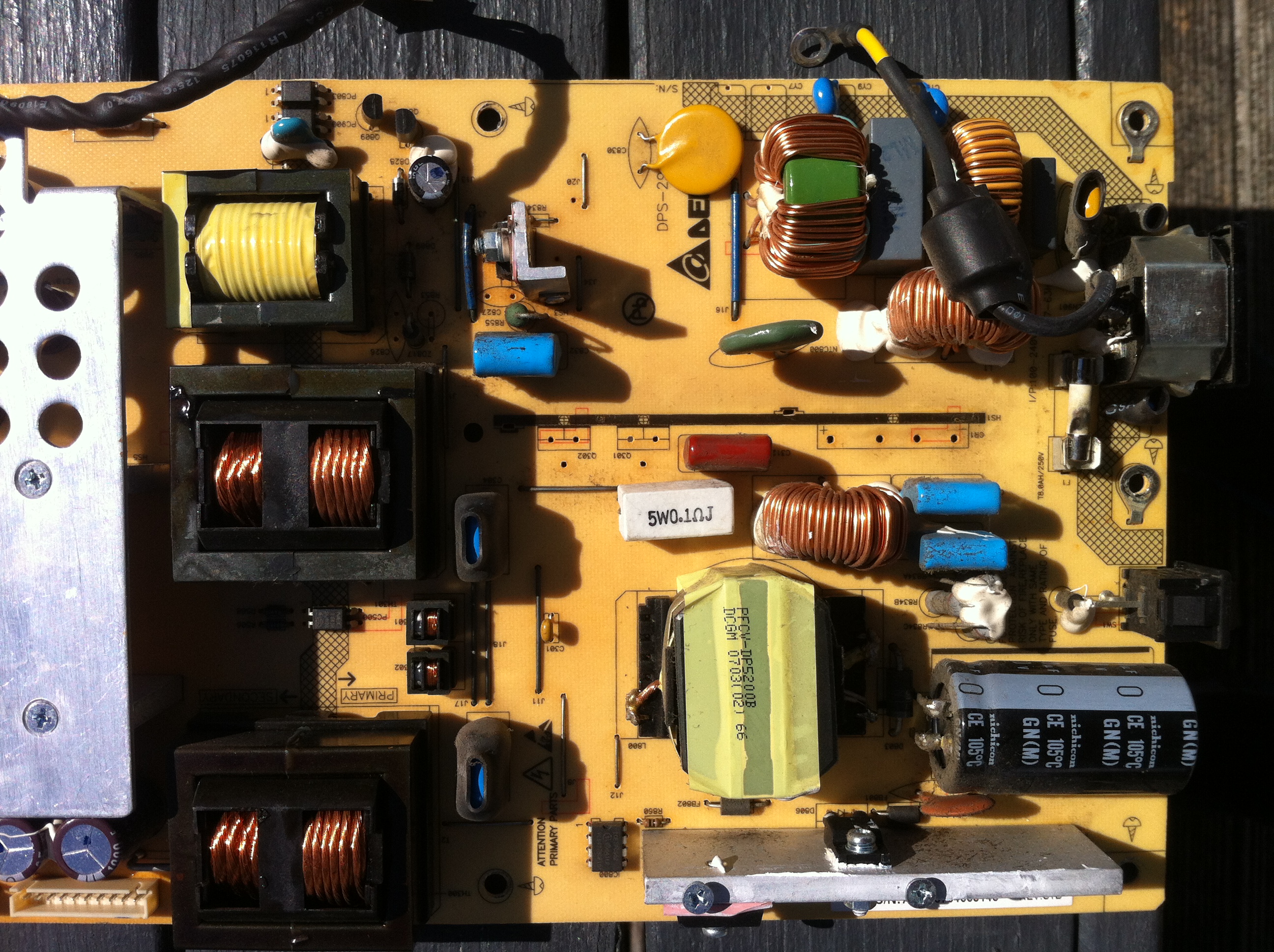

          I replaced the resistor, it was 0.1ohms, was a carbon resistor but could only get a 5w wire wound resistor, the board had been out all night and when I went to put the resistor in had a few big sparks as cap discharged, about 4 sparks in total. all in and still nothing,
          one photo is of the board and I have circled in red where the resistor sits underneath. the second photo is the replacement resistor (red circle) and the FET that it connects to (black circle) there is a cap that jumps the same gap as resistor,

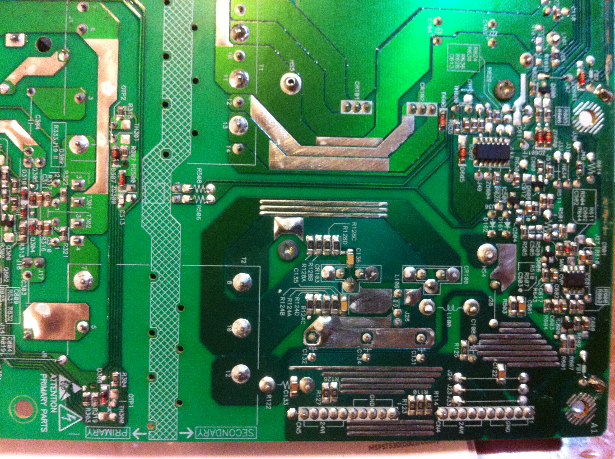

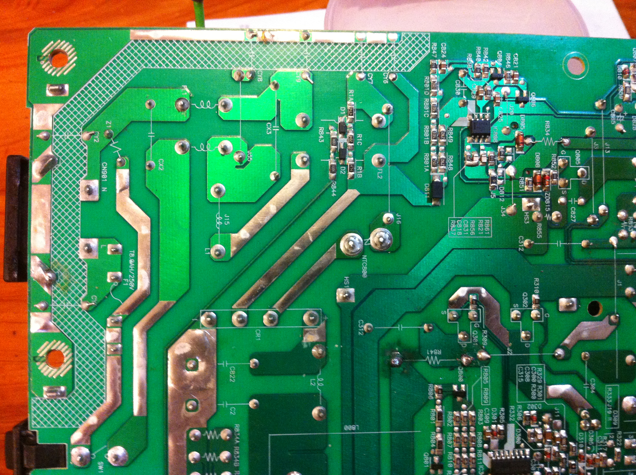

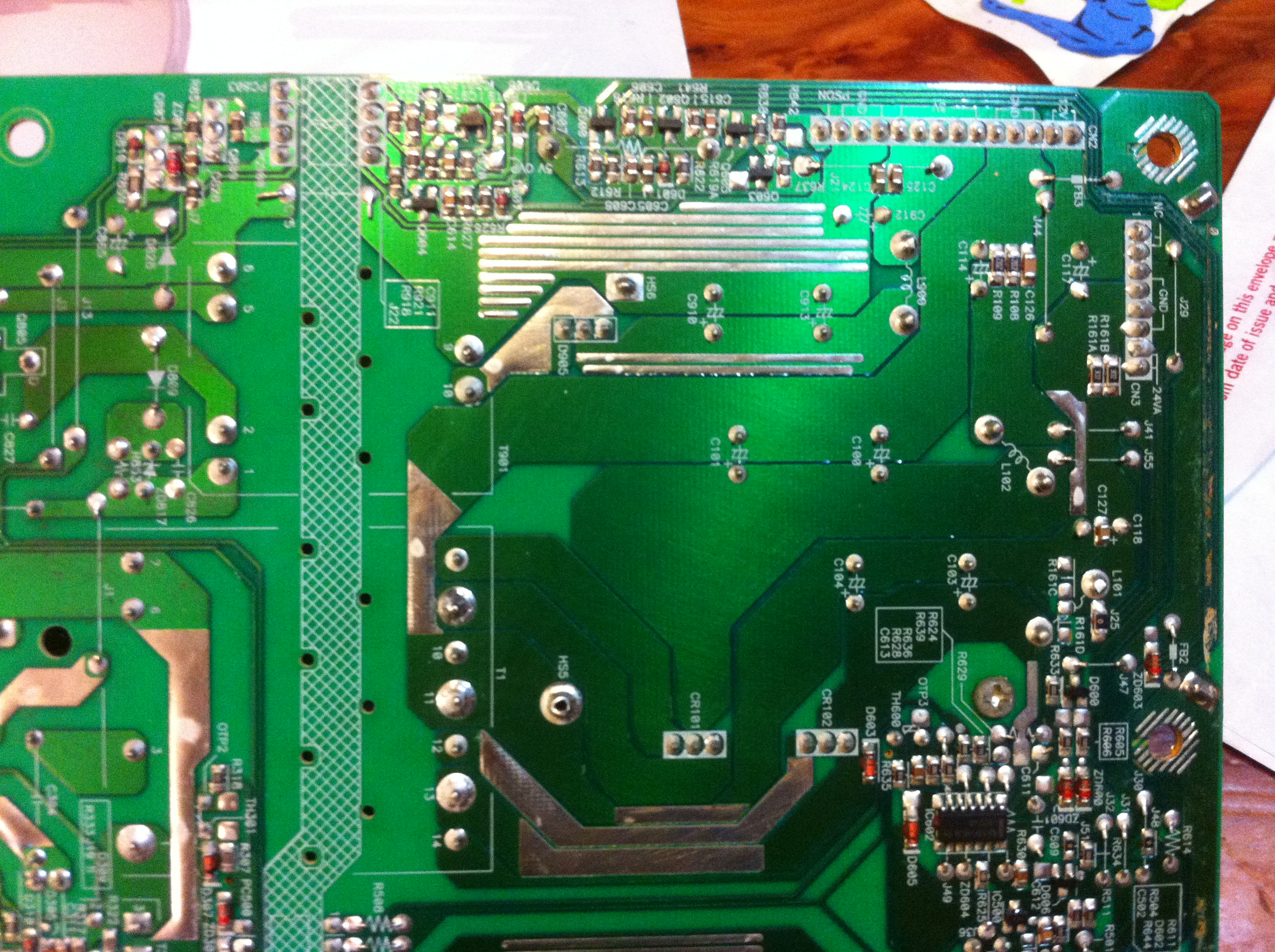

            Can you please use the attachment function to upload the pictures? Please do not post the pictures in line.
            I would like to see the good pictures of the bottom side of the board, also in 1/4 section so I can trace the connections.
            That resistor may be fusible resistor for circuit protection for the B+, cannot tell until I see the bottom side of the board.

              hi, the burn mark around the resistor is from the first cap discharge

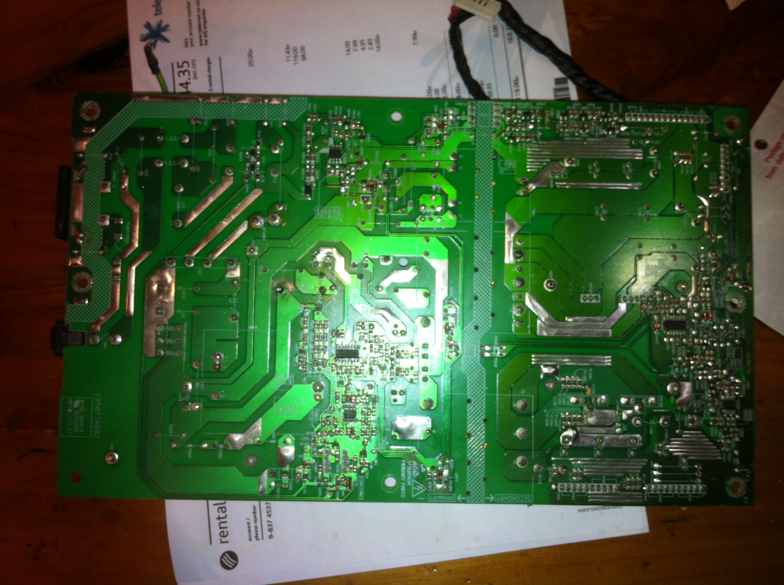

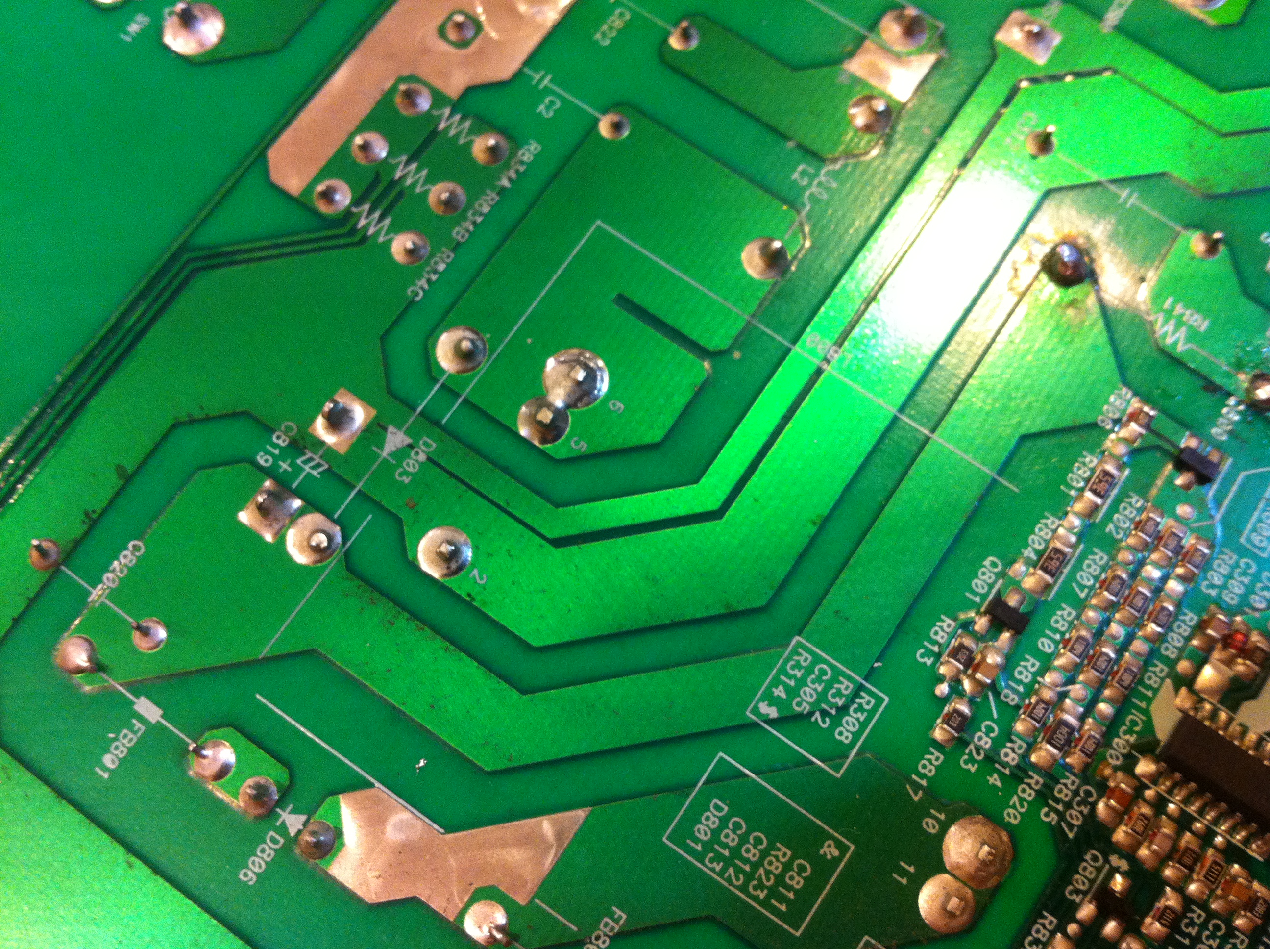

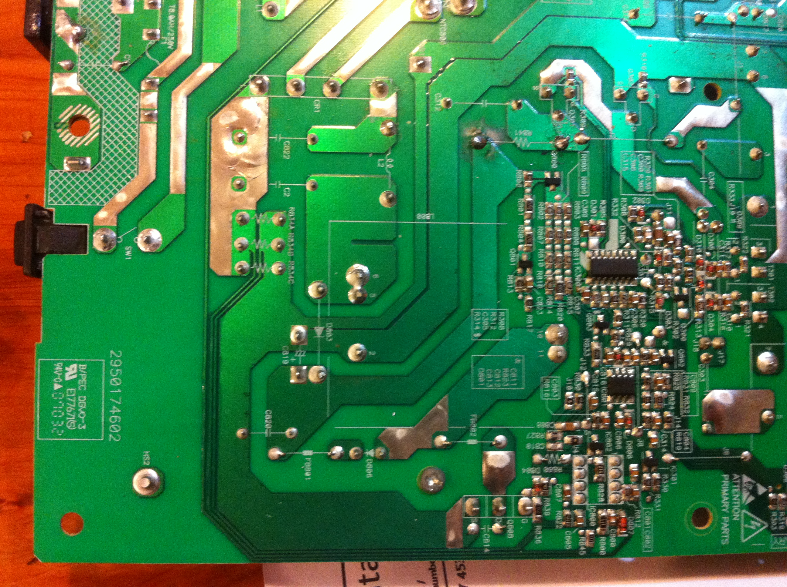

                here theres might be better.

                      Well, I download the pictures, some are not in focus.
                      Do know how long it will take me to look at the traces on the board based on the pictures and tray to draw up the diagram without having the board in front of me?
                      If that is too long to wait, then I am sorry for asking for good clear pictures.
                        Sick 'em!!!
                        Listen this is a good place for answers but you have to be patient. I have a few pieces needing repairs that have been on my bench for a week or so because I can't find manuals. It takes a while and these people aren't paying the bills by replying to this thread. Hell, I am at work to pay my bills. I am betting, because I haven't had time to actually go over the blurry pictures, that more than just a resistor is bad. That resistor is probably meant to blow because of another failure (0.1ohm is usually a fuse resistor). More information is needed, like a schematic, to find out what that resistor is protecting and what it is protecting that component from.

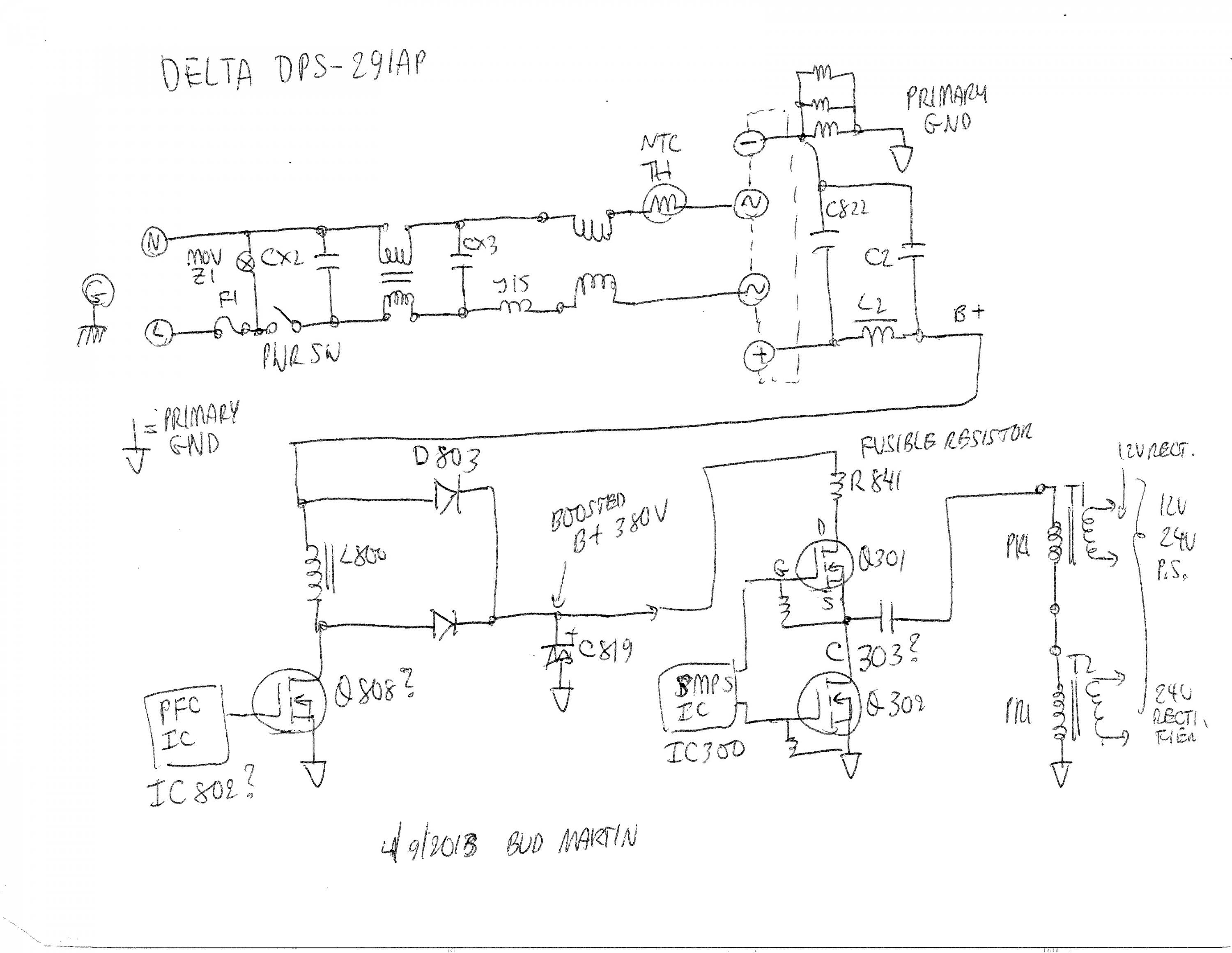

                          This is what I get from looking at the poor quality pictures.
                          Q301, Q303, IC300 should be replaced. The component around the Gate drive circuits of Q301, Q302 also must be checked damage.
                          Q808?? (PFC Voltage booster) need to be checked also.
                          The 12V, 24V rectifiers in the 12v/24v section also need to be checked.
                          You should put a 75~100W lamp in series with your power cord so you will not keep blowing the new fuse if the shorts are not located, the lamp will light up brightly if short circuits still present.

                            on a side note, ive been looking into why all 3 legs of the fets had shorted, and from my results heat is the killer, but its no too common for all 3 to be shorted, usually just 2 legs short. could a failed driver cause the fet to short this way?, I understand that the driver would now be receiving the full current as it backtracks up the gate, from the board that will be ic300 for q301 and q302.
                              If the one of the IC Gate drive out put stuck HIGH that MOSFET will be fully on, so when the other MOSFET in this half-bridge drive circuit turn on, it will be like putting dead short on the B+ LINE.
                                That is exactly what seems to be happening, is there a way to test the gate drive circuit with the mosfets removed?, as I'm having to import them from uk to newzealand would rarer not blow up some new ones, I am looking to buy an oscilloscope in a couple of weeks, no help right now of course.

                                    You better replace the IC rather than taking a chance of blowing up your new MOSFETs. I ave a feeling the Gate drive components (didoe, resistors) are likely to be damaged when about 400V is dumped (shorted Drain to Gate) through those sections.

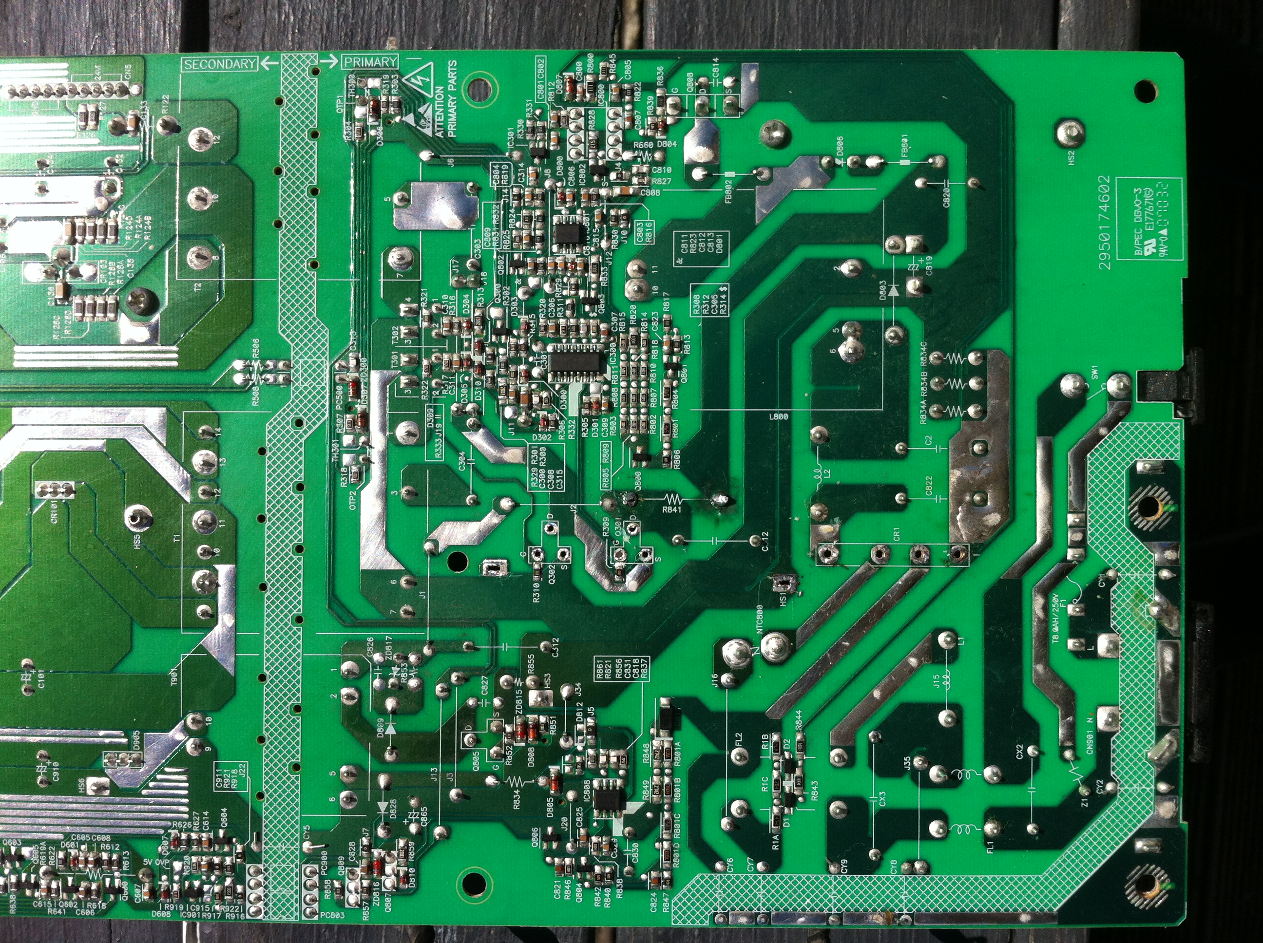

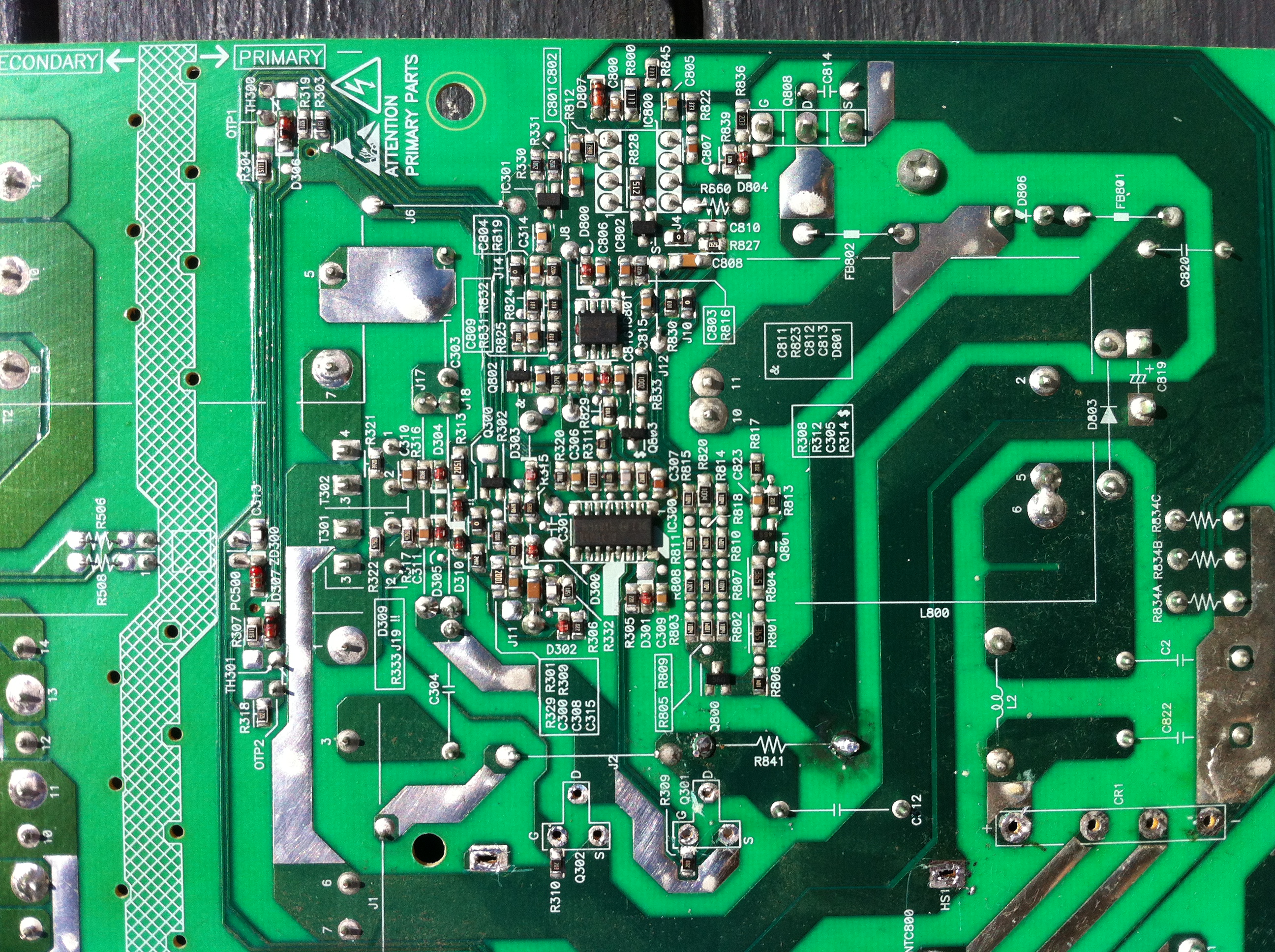

                                        Ok , will replace the ic aswell, which are the gate drive diode and resistor that I should check/replace? ,
                                        here are some much better pics, with same phone but with sunlight.
