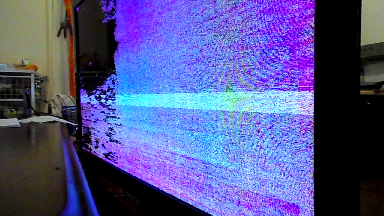

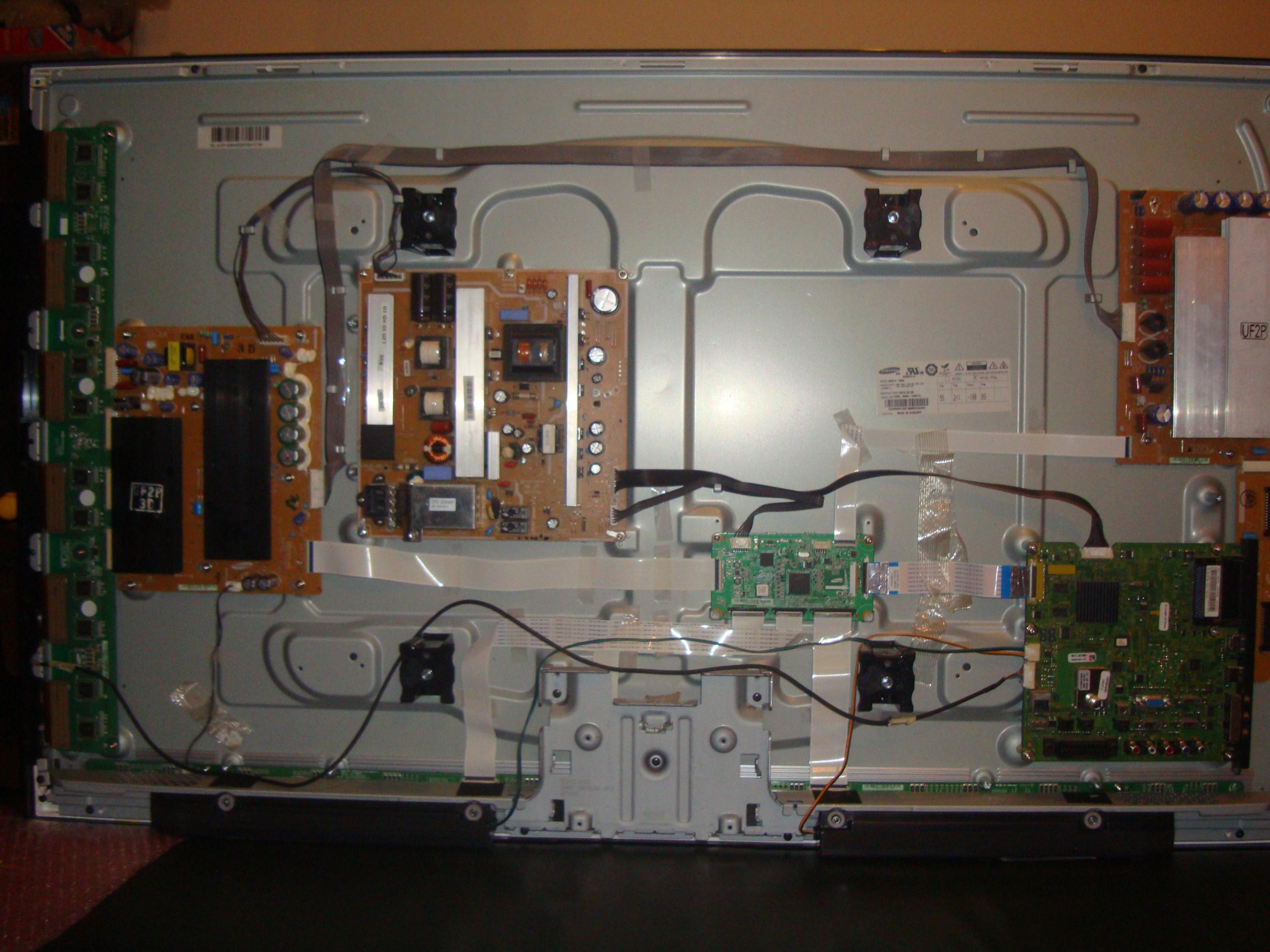

    I have a Samsung PS50C550 plasma that does not turn on.
    The screen flashes on briefly for a split second, i have taken a video of this and managed to get the frame out that has what is shown on the screen when it powers on.
    It looks like there is an issue with the left side of the screen.
    Can someone help me diagnose this fault, my suspicions are that the screen is broken but if it is electronics and can be fixed that would be great.

    Looks more like an X-main or control board fault.
    See: https://www.badcaps.net/forum/showpo...61&postcount=2
    for a test to make

      The TV behaves exactly the same with pins 3 and 4 shorted on the test connector shorted.
      I have measured the Vs and Va voltages after turn on and these go up to the correct level but drop straight away, but these voltages stay steady at 211V and 55V with the Y-Main board ribbon cable disconnected.
        Re: Samsung PS50C550 briefly turns on with partial white screen
        It is possible you have a Y-main defect then. The best test involves an oscilloscope, but if you do not have one you can check the FETs and other devices for shorts.
                    You will have to provide some pictures and I can indicate the places to test.

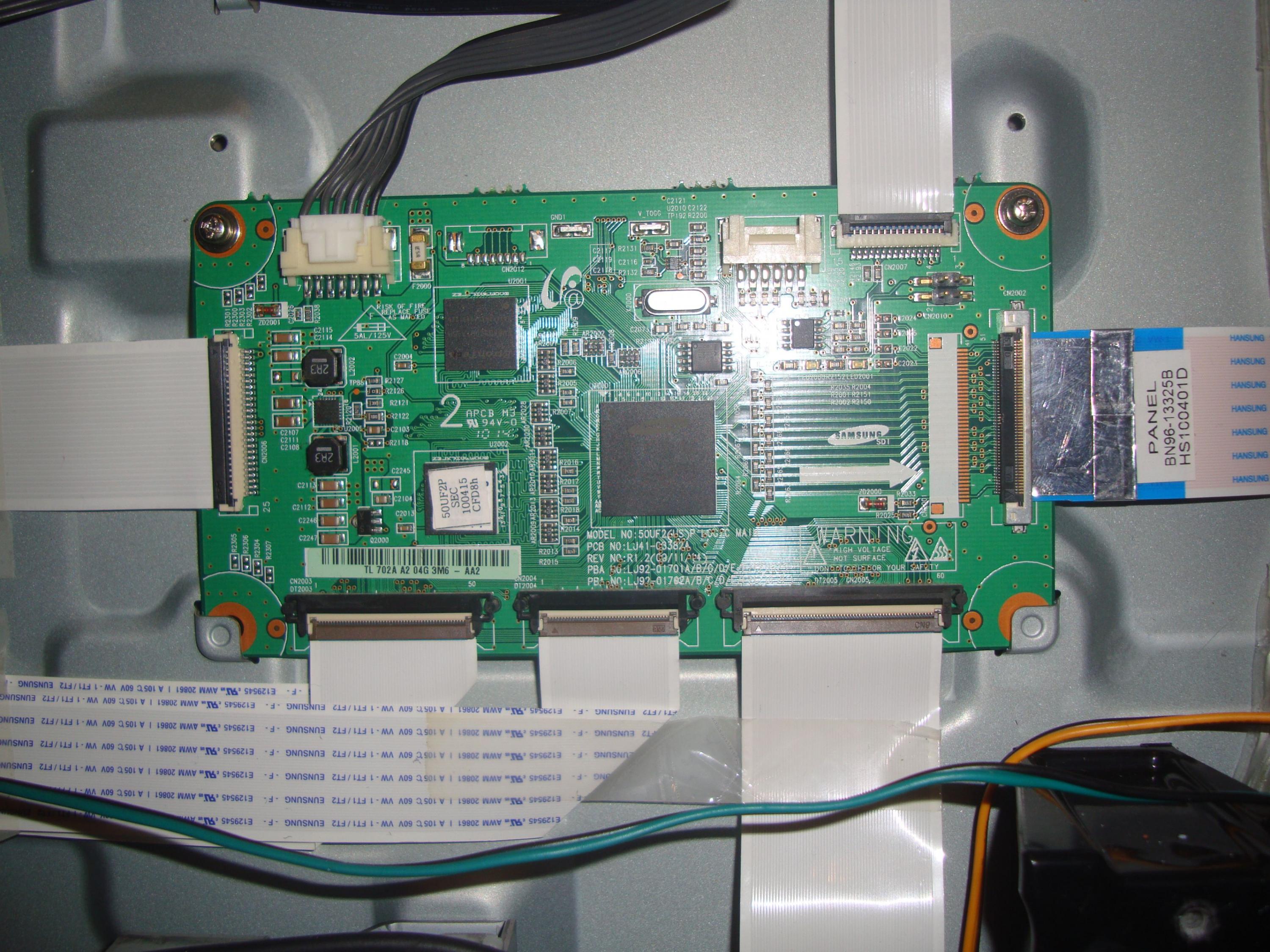

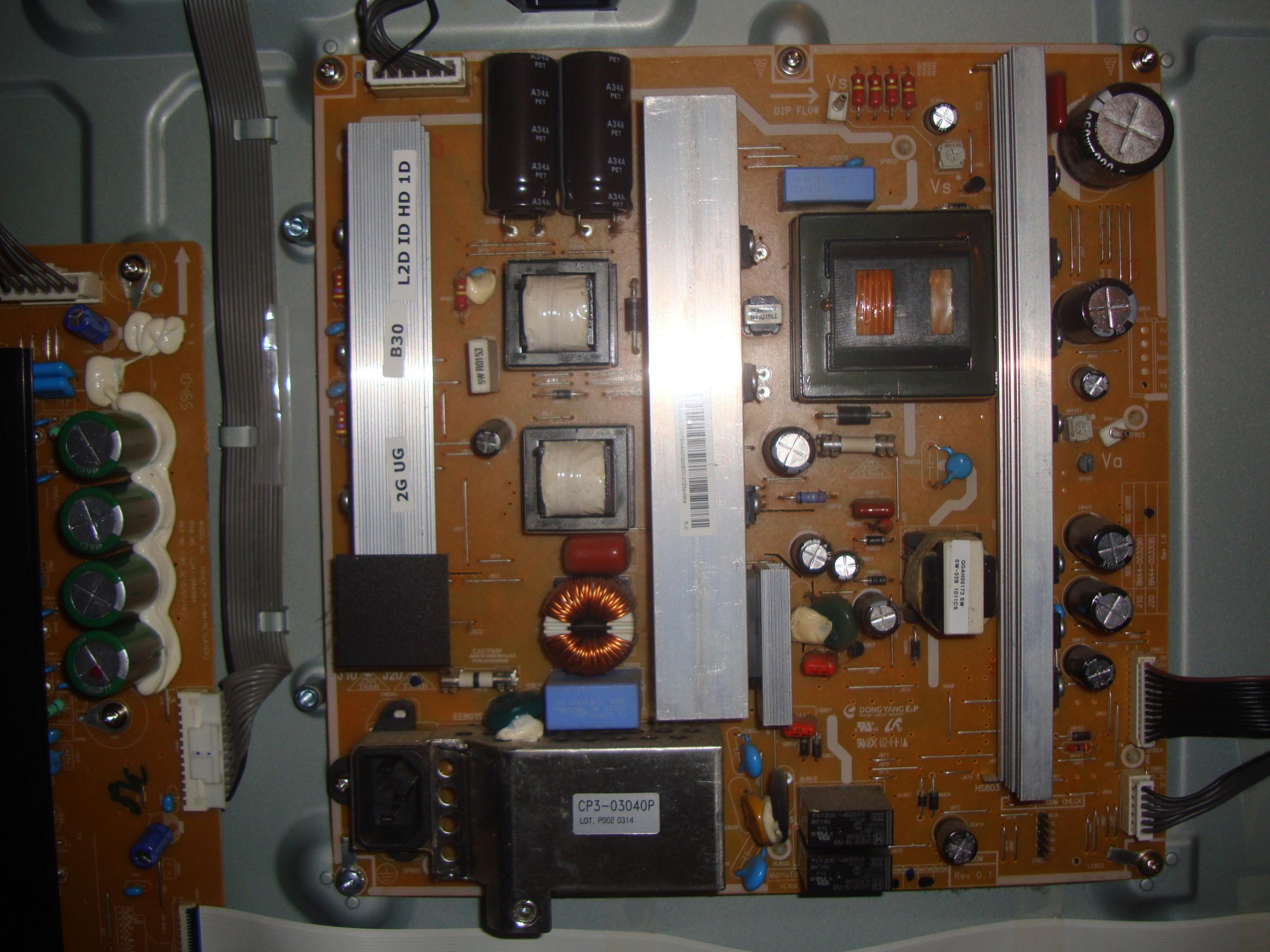

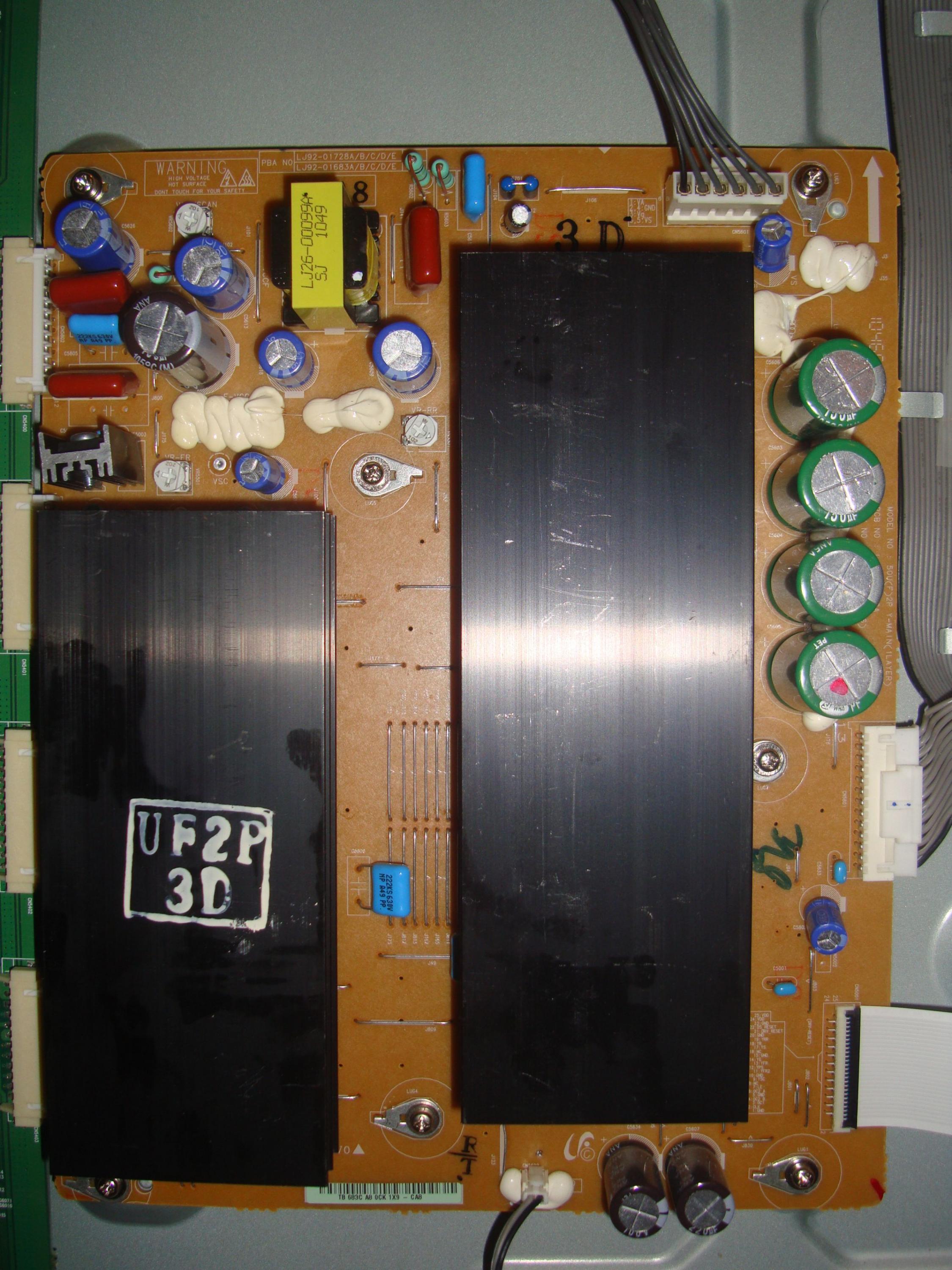

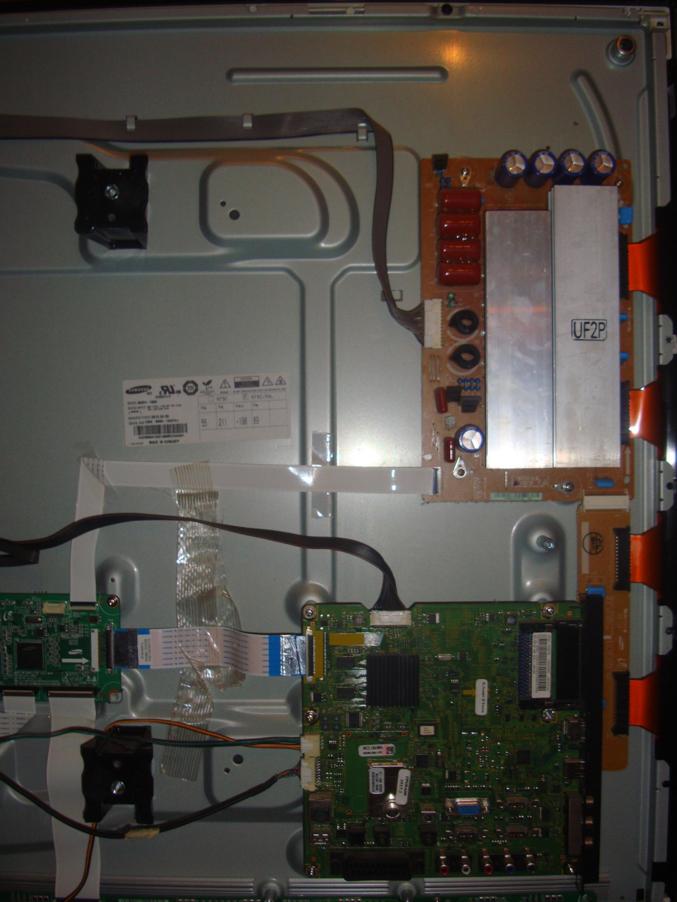

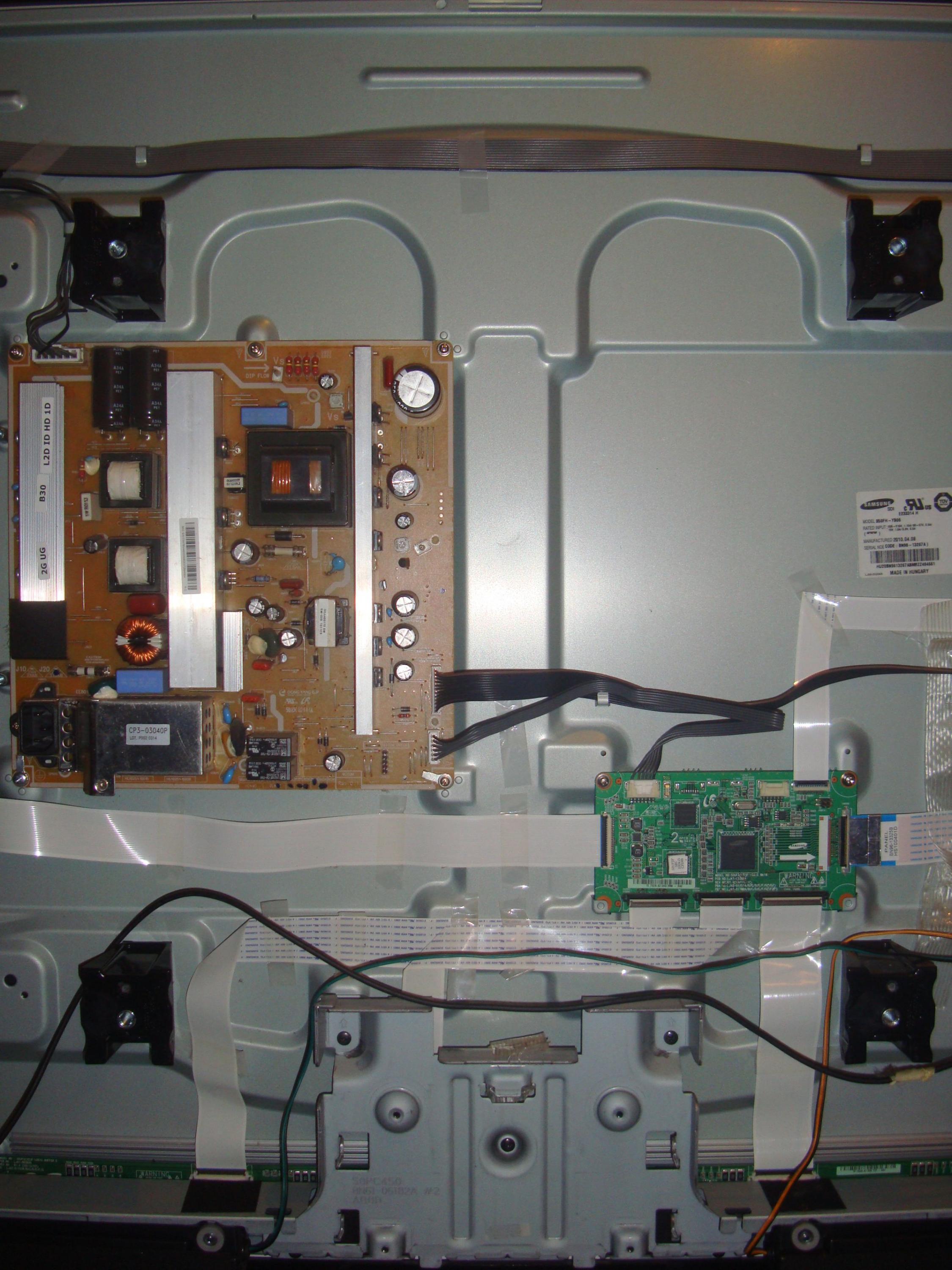

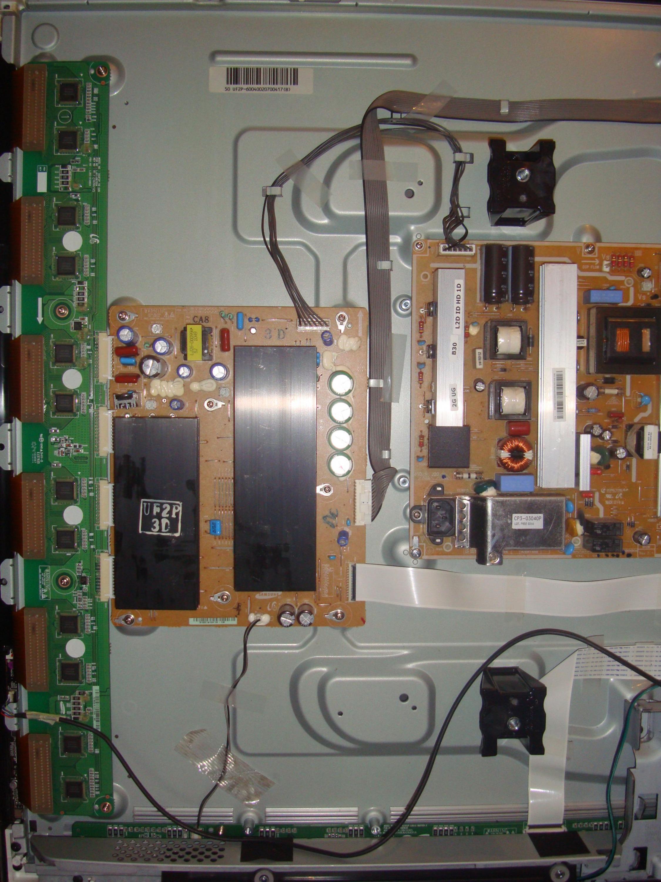

                      Hi Tom,
                      Sorry it took so long, here are the photos of the TV internals.
                      Regards,
                      Stu
                        Can you remove this board and take a picture of underneath it?
                        https://www.badcaps.net/forum/attach...7&d=1366286544
