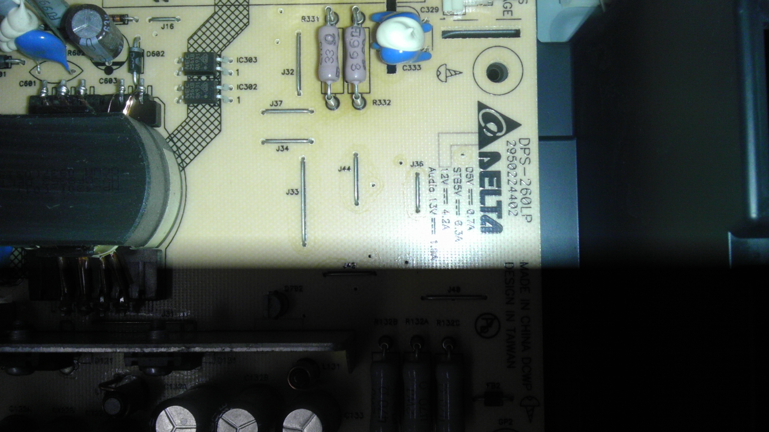

    I have a sanyo DP42849 that a friend gave me, he said that it just quit working when he went to turn it on one morning nothing happened. When i plugged it in i got no lights not even a standby or power light. When i took of the back cover i found a bad IC (will post pictures) on the power supply board. There is no other damage or bad caps that i can see. I have searched and looked through service manuals but none of them show this IC. Does any one know what IC i need and where i can order a new one. From the pictures do you think there is more damage and should replace the whole power supply board. I thought if i could just replace the IC that would be the way to go.

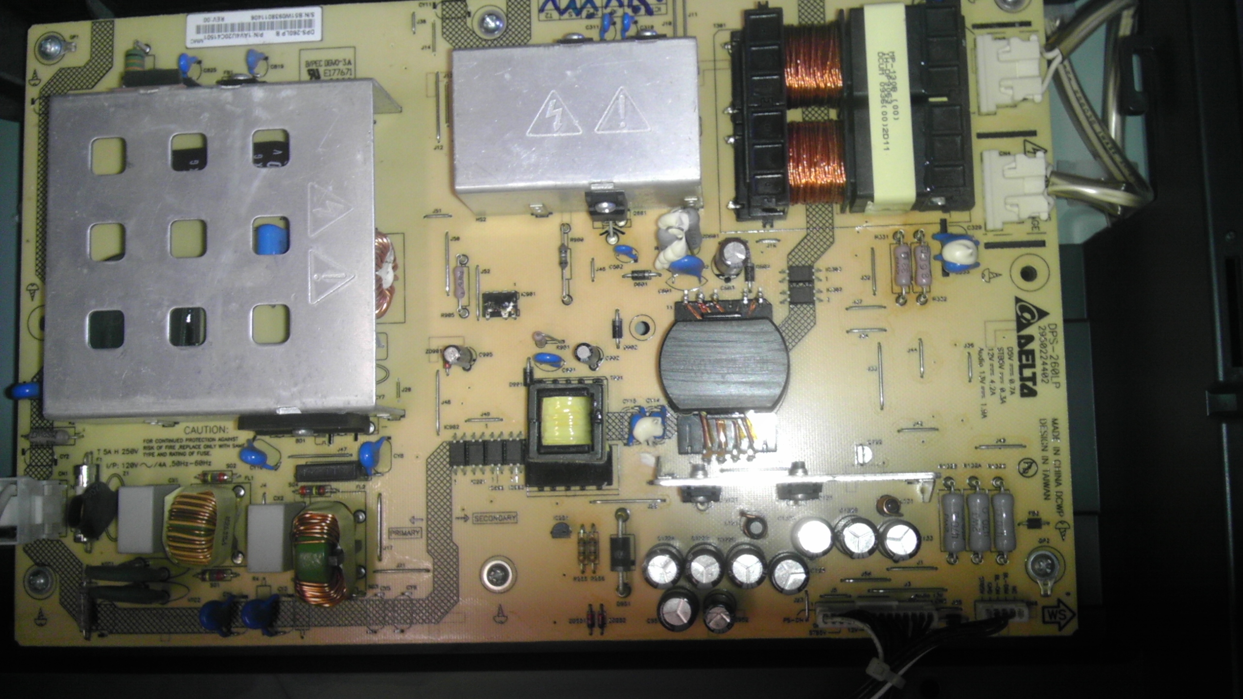

    Cant find a schematic. Found this high res image of the board.
    http://assets.shopjimmy.com/media/ca...20c41500_1.jpg
    Somebody might be able to recognise it from the high res image. It's the PWM chip by the look of it... If this chip is blown you'd also want to check the three pin FET just below it on that image... it's labelled Q601, it could also be shorted. Also B01 the main bridge rectifier.. Maybe check the main transformer as well. The fuse may be blown as well.. To be 100% sure you'd need to check all the components, but if you're playing the odds they are the ones I would check first..

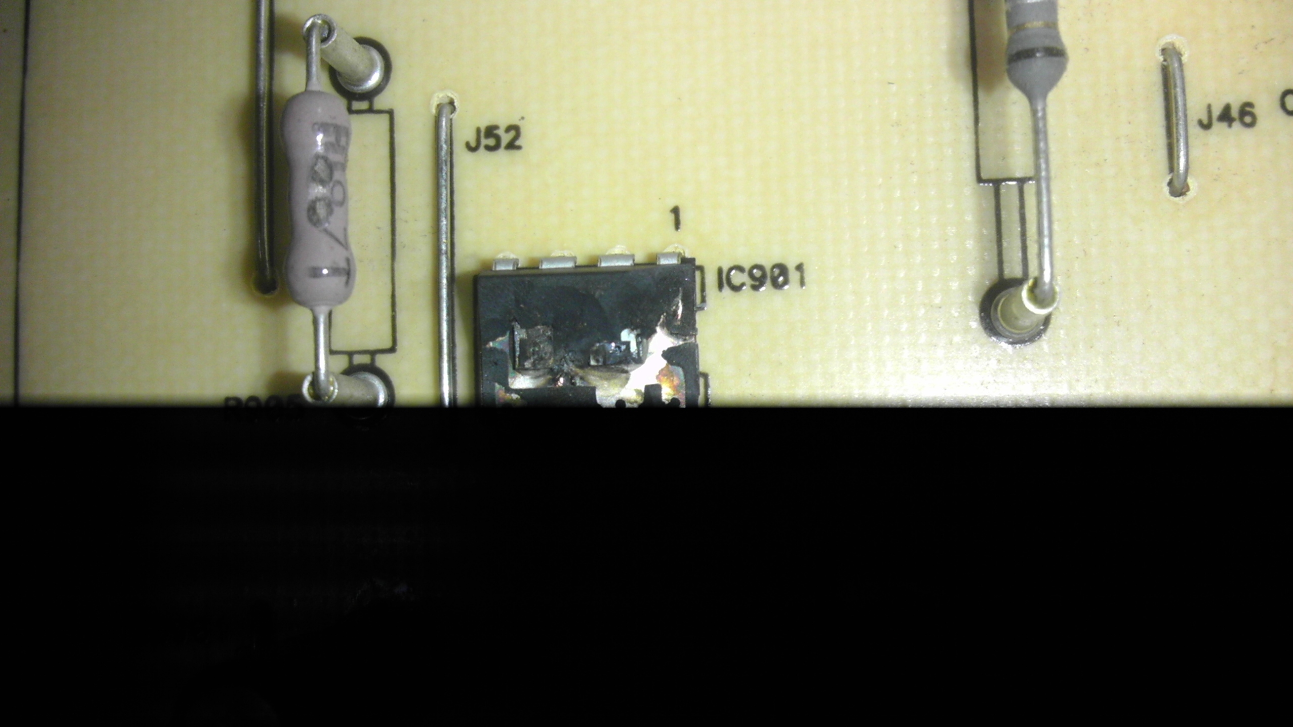

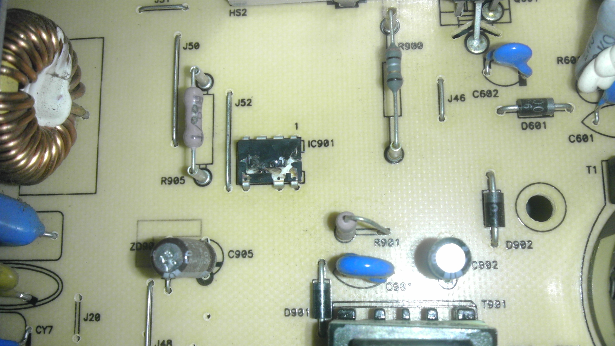

            Re: Sanyo DP42849
            We have had a few of these recently - main problem was the transformer which is a proprietary part - I have sent a PM to th emost recent poster and asked if he still has his board and what is IC901
            • tw2005
              • Oct 2011
              • 6458
              Re: Sanyo DP42849
              My eyes are not great but it looks either A6062H or A6069H. Maybe the specsheet will give a clue on it's ratings. I'm thinking the last digit looks more like a 9, maybe someone with eagle eyes can pick it.

                Re: Sanyo DP42849
                Hi - I had come to a similar conclusion yesterday but eyes were going so gave up.
                Anyway with your input and fresh eyes I have found an exact match
                http://img04.taobaocdn.com/bao/uploa...pg_310x310.jpg
                fxdfireman if you updated your profile with country we could help source one
                http://www.digikey.com/product-detai...art_dkc_buynow

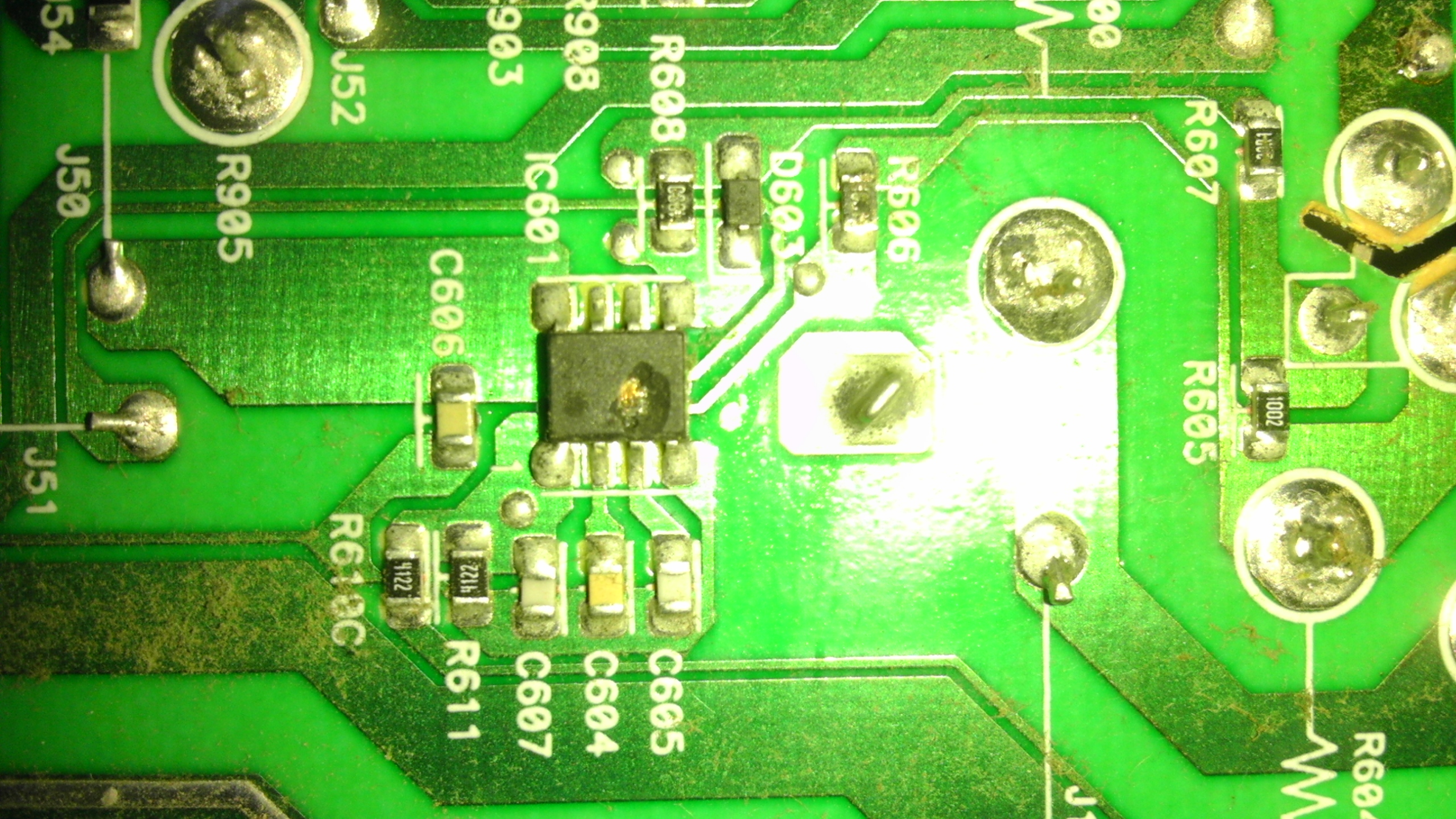

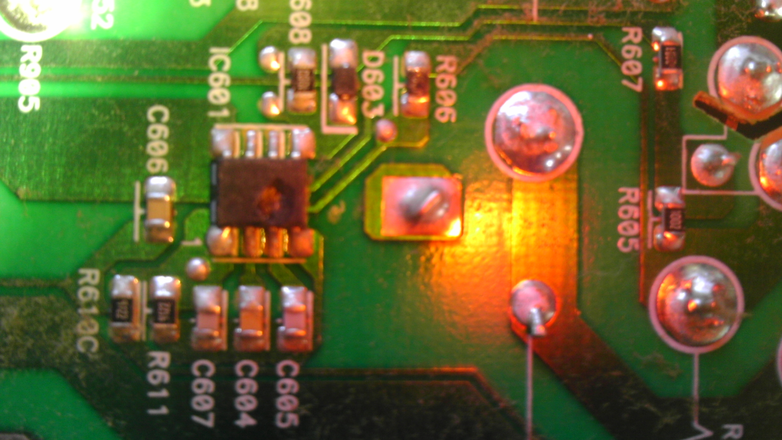

                            So i took out the power supply and was going to install the new part when i looked on the backside and noticed another bad IC, IC601 (will post picture) Does anybody know what this one is? is it worth trying seeing i already have the other one, or should i just admit defeat and order a new board.
                            • selldoor
                              Slow Learner
                              • Dec 2010
                              • 7870
                              Re: Sanyo DP42849
                              Can you try and clean it with isopropyl alcohol - can you read any numbers on it?
                              • fxdfireman
                                • Nov 2010
                                • 86
                                Re: Sanyo DP42849
                                I couldn't see any numbers on it. I look in the service manual but they don't show the power supply. I can try cleaninng it when i get home from work.
                                  Re: Sanyo DP42849
                                  Looks like R606 is bad too, so the FET it is attached to probably failed short.

                                    I got the same problem As FXDFIREMAN with "IC901" - i have not pulled the board out yet to see if there are more problems on the bottom

                                      I found other problems on mine and ended up just changing the power supply board. TV works good now.

                                        Hey FXDFIREMAN -- after reading all the post, I remove my board and found the same damaged ic601 on the bottom as well as the ic901 on the top... I guess I will follow your lead.. Do you rememeber were you purchased you new board???? the major referral company is out of STOCK.....THANKS
