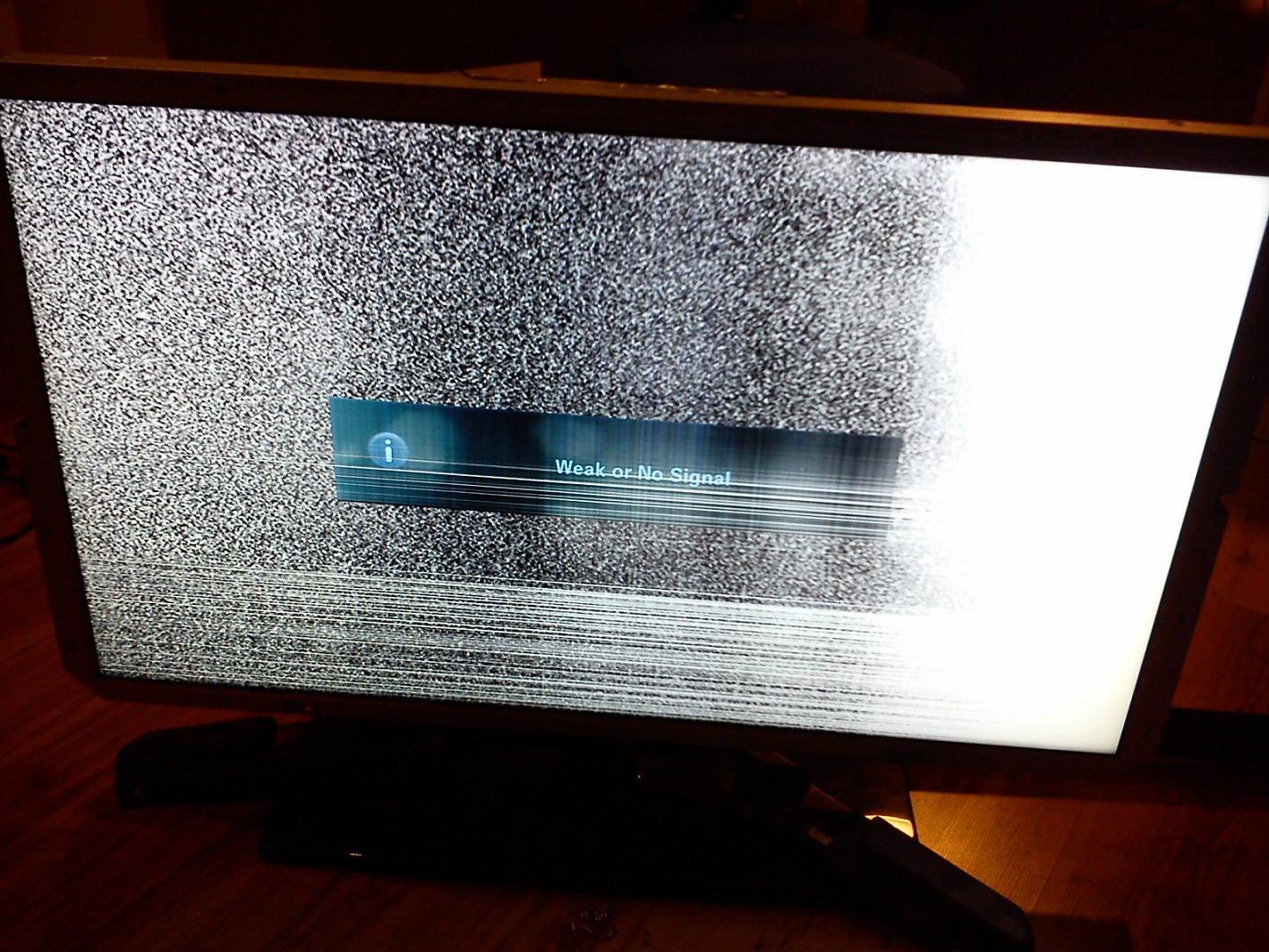

    Hello all!
    I am having a problem with mentioned LCD TV. This is my first LCD TV that I am repairing. Before I try to fix something that is already working I would like to ask for some help. The screen has some horizontal lines and the right side is very bright. Everything else works. The voltages on the power supply PCB are max 5% lower than stated on the PCB and all capacitors are normal, at least visual.
    Any advice would be great!

    Re: Samsung LE40A699 picture problem
    Never seen that. But it looks like a bad panel to me. Like a diffuser has failed. If you feed the screen a fully white image (may be done from the service menu, or a computer) does the right hand side appear much brighter than the working parts?
      There is no difference in brightness... I tried it with service menu...
      When I was taking it apart, to see if the connectors from T-con to LCD panel are faulty, it suddenly started working, but the next time when I turned it on it was the same again... And I can't reproduce the working screen...

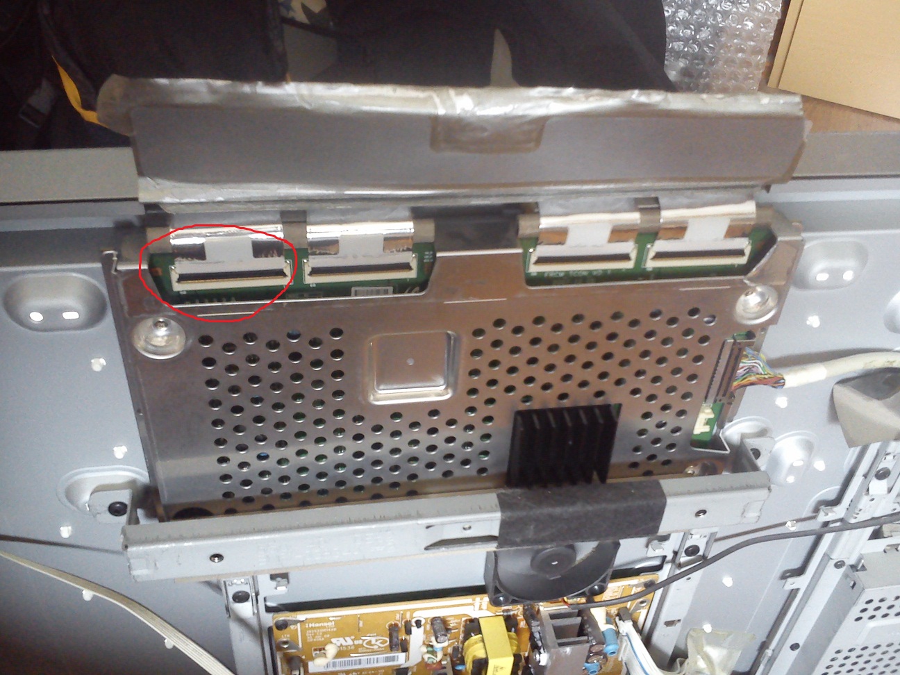

          The diffuser is OK, because that on the right side of the screen are lines, some of them brighter than the other. If I press on tab bonds, nothing happens. What about some ICs on the tab bonds? They get quite warm.
            More update. If I unplug one of four connectors that go to lcd panel, turn on TV, turn TV off, and then plug that connector back, and turn on TV, then the picture is almost 100% good. Maybe some problem with power supply on T-con board?
              The ICs themselves can be defective. I would also recommend checking the VON, VOFF and AVDD voltages on the T-con board.
                  Von is a little low but probably normal; it should be closer to 25V. Does this T-con have two ribbons to the LCD panel? If so, check if it rises with one side unplugged.
                      Hmm, when in working state, if you apply slight pressure to the tab bonds, does it go wrong again?
