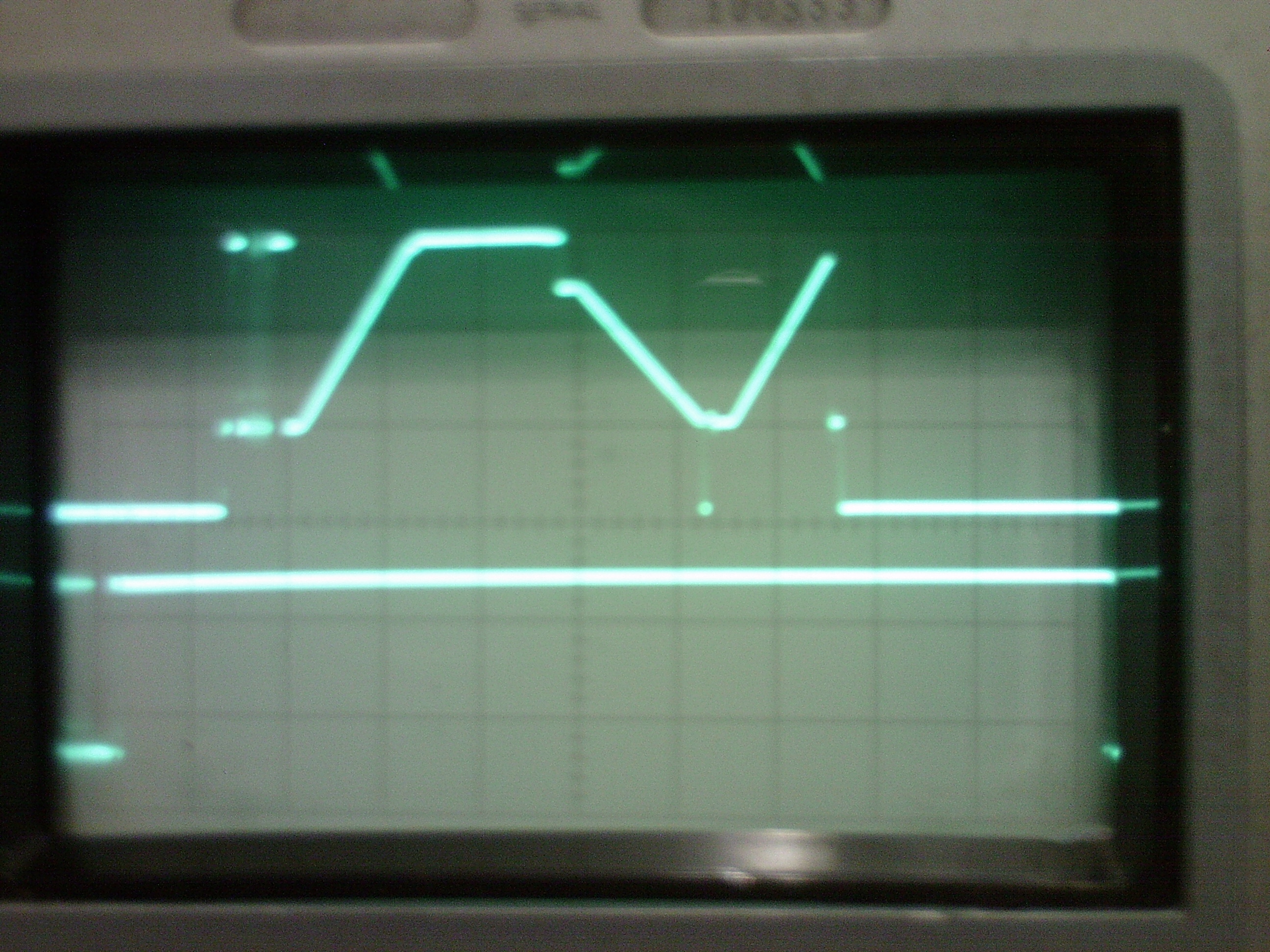

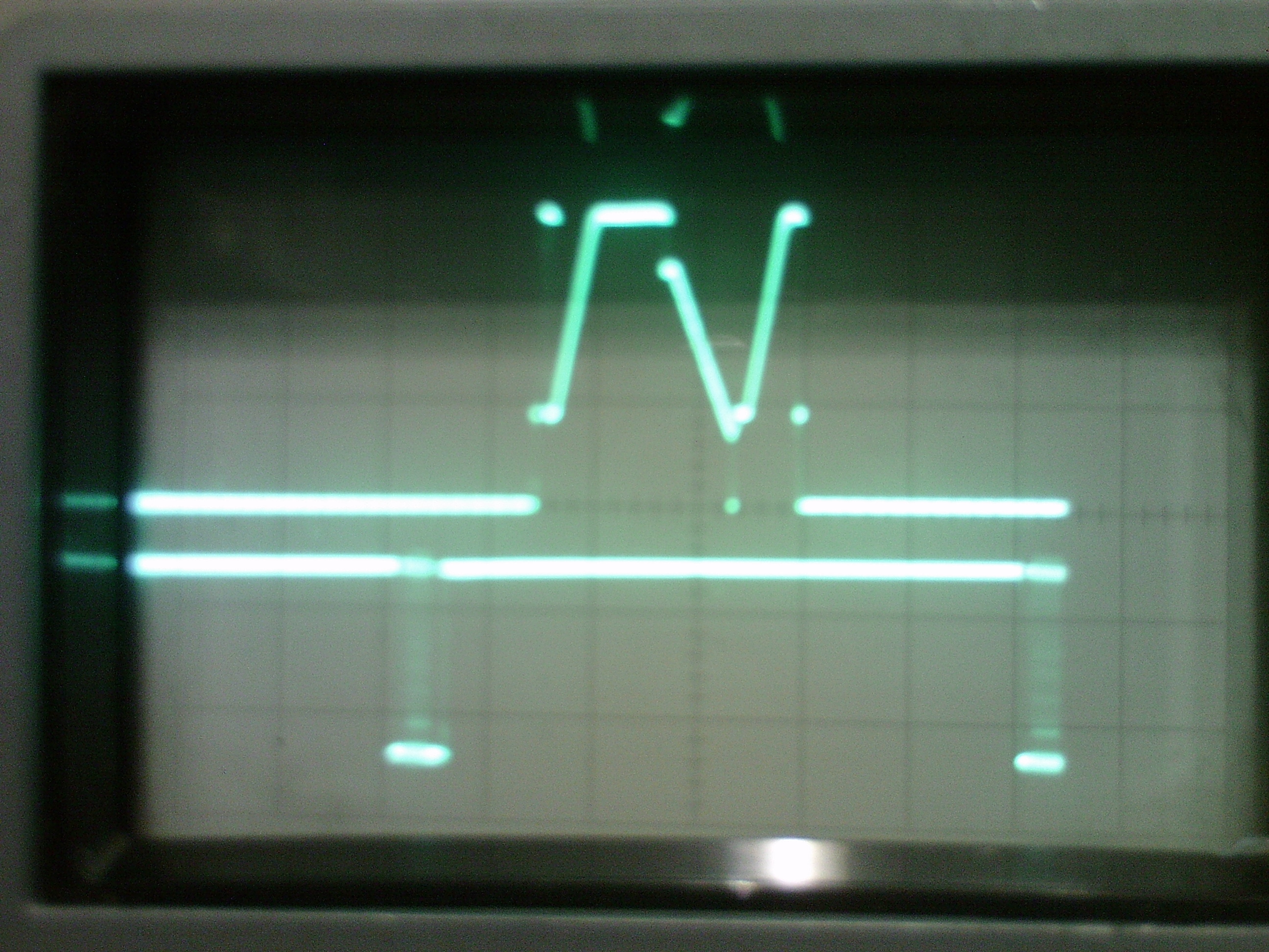

                              Ha!--Yes, Only doing it to gain experience on these things!
                              So--we have some (No!) Progress....
                              The voltages are all present and correct.
                              The ZSUS is outputting its square-wave and is in time with the YSUS 'frame' square-waves.
                              The 'Ramp waveform--Which is a bugger to trig on! is only half right.
                              The 'set-up' ramp and flat-top are correct and set to 10uS, as per manual--pot alters it normally.
                              There is No set-down ramp, it returns direct to base-line after the 10uS flat-top of the set-up ramp.
                              Adjusting the set-dwn pot just moves the ramp in relation to whatever the scope is triggering to.
                              This ramp waveform appears to be repeated twice--although are slightly different- before the 'frames'
                              Looks like this fault is on the YSUS. The IPM is mildly warm, the block of 10 MOSFETS under the heatsink are cold.

                                Re: L.G. PDP42V7 chassis Black screen, only a few random pixels here and there...
                                Can I see a picture of these waveforms?
                                Z-sus should have a ramp too.
                                  Here you go--Pic quality is crap and I'm not sure the timing from the top (ysus) to bottom (zsus) waveform is accurate--it shifts about with trig-sync of scope...

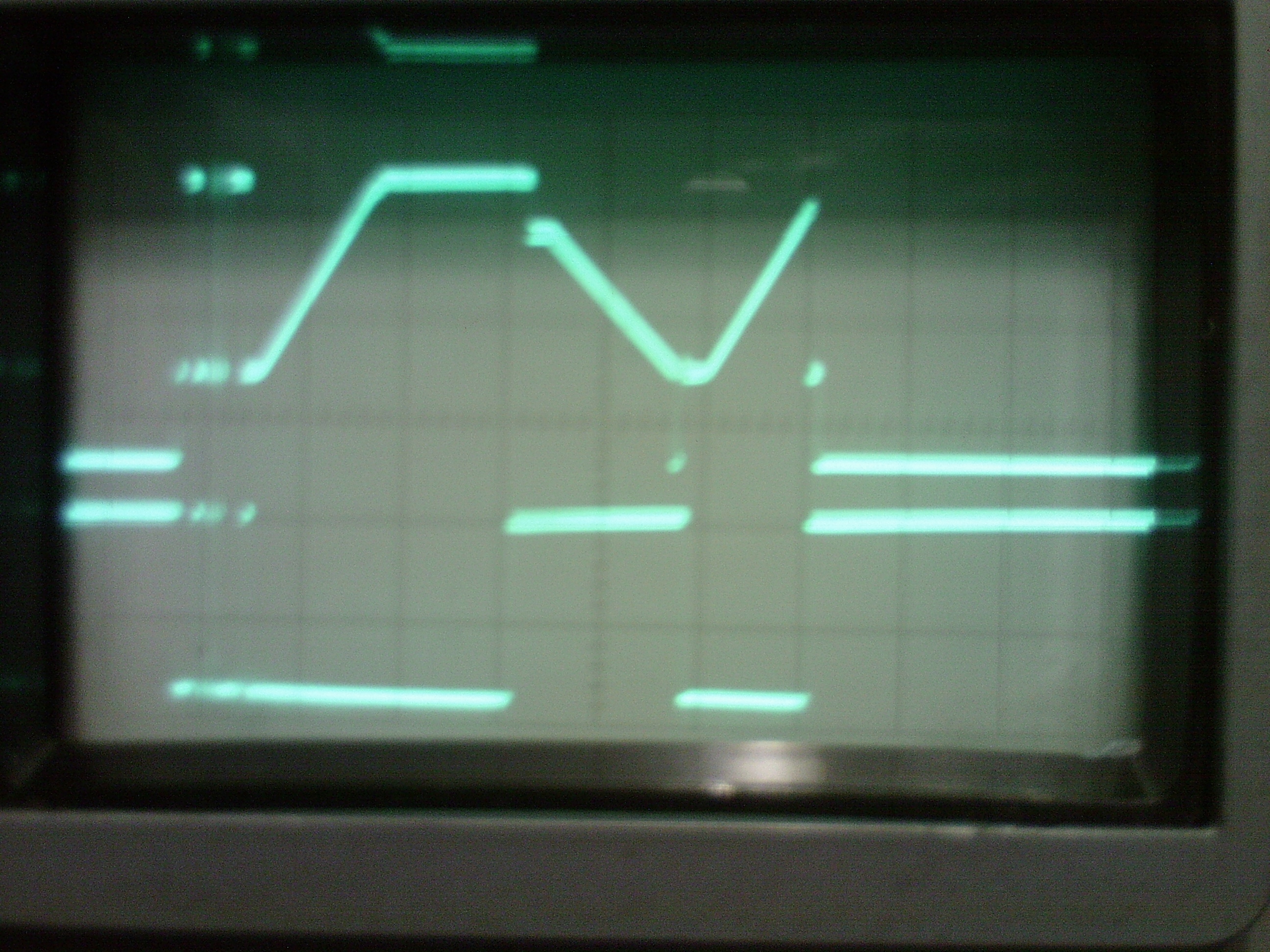

                                    BTW--There doesnt appear to be any ramps on zsus. Looks like I was hasty saying there was no set-dwn ramp--as I say, it was hard to trigger on these waves, took ages to get much sense outta my old scope...
                                    Looking at service-manual--there should be a square-wave directly under the ramp wave--which doesnt seem to be there I'll check its not the scope telling me lies...

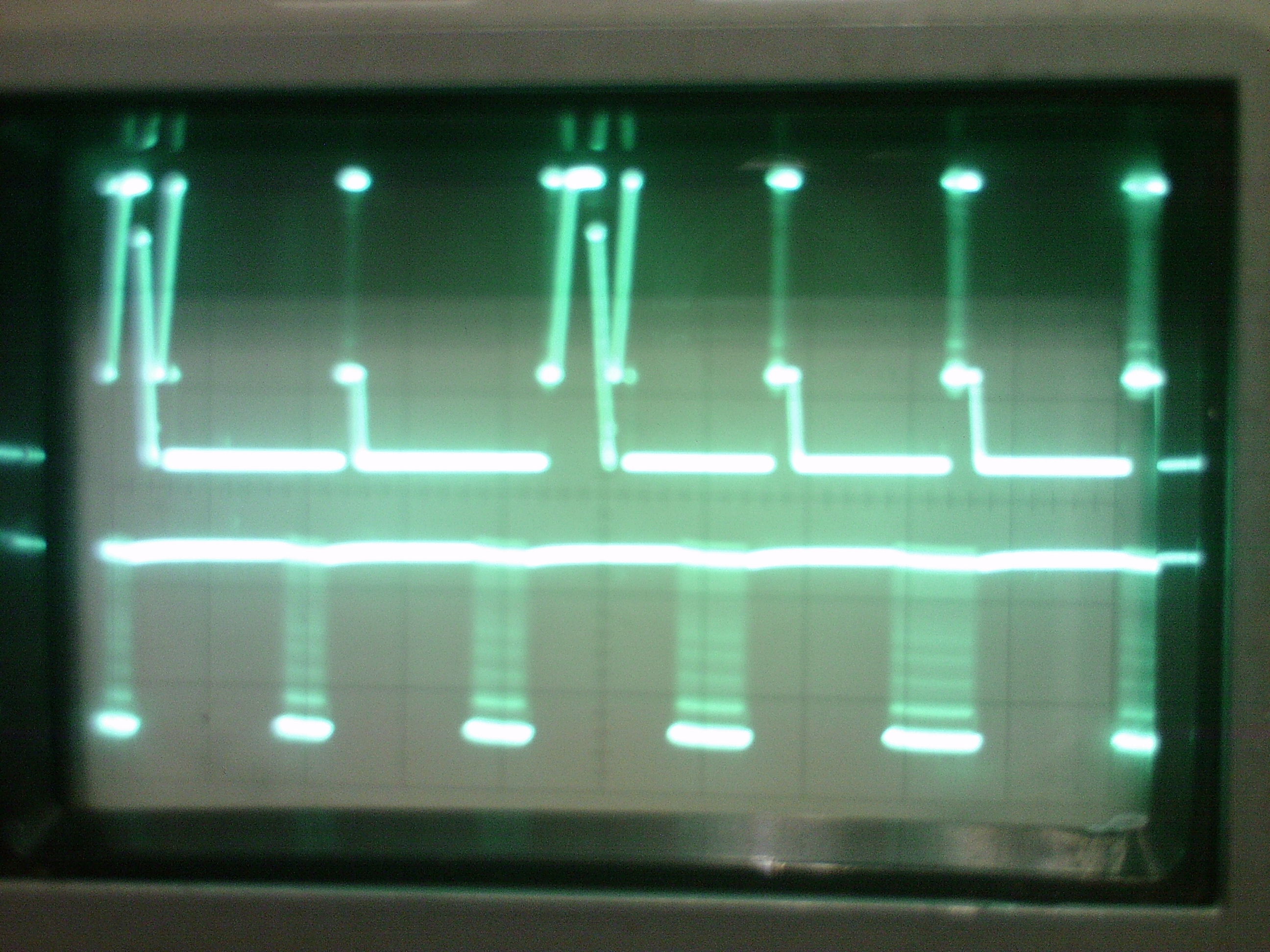

                                      Now got to grips with the scope. Looks like the bottom ZSUS wave is Inverted to what it should be in the manual diagram--its not the scope doing it...
                                      Here you go--
                                      TELEFIX
                                        To get clearer shots of scope, try using sport or fast shutter mode on camera.
                                        I don't see why the waveforms would be different unless something is wrong with the control board.
