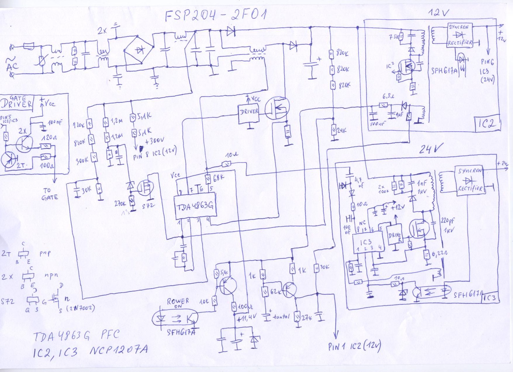

    Hello, GRUNDIG AMIRA 32LW82-7505BS does not start, I opened the beast I saw waving: FSP204-2F01 (S07)
    calcined part I gets another wave FSP204-2F01 (S07) was the case, he walked after quarter of happiness around, I stop and then turn on the TV, the camera does not start standby indicator lights up and the tensions cn1: 12v is available, but tensions cn2: 24v no, I changed the capacitor CS12, CS13, sc 18, SC19, both mosfet QS3, QS4 n430af more picture coupler ic1 sfh617-4: unsuccessfully trying diagram of power supply FSP204-2F01 (S07) ..
    Today and found myself looking for cold solder joints, unfortunately without success I hope you can help me. Thank you in advance ...

    Not much information - found this if you can follow it.

      selldoor hi, thank you for the pattern!
