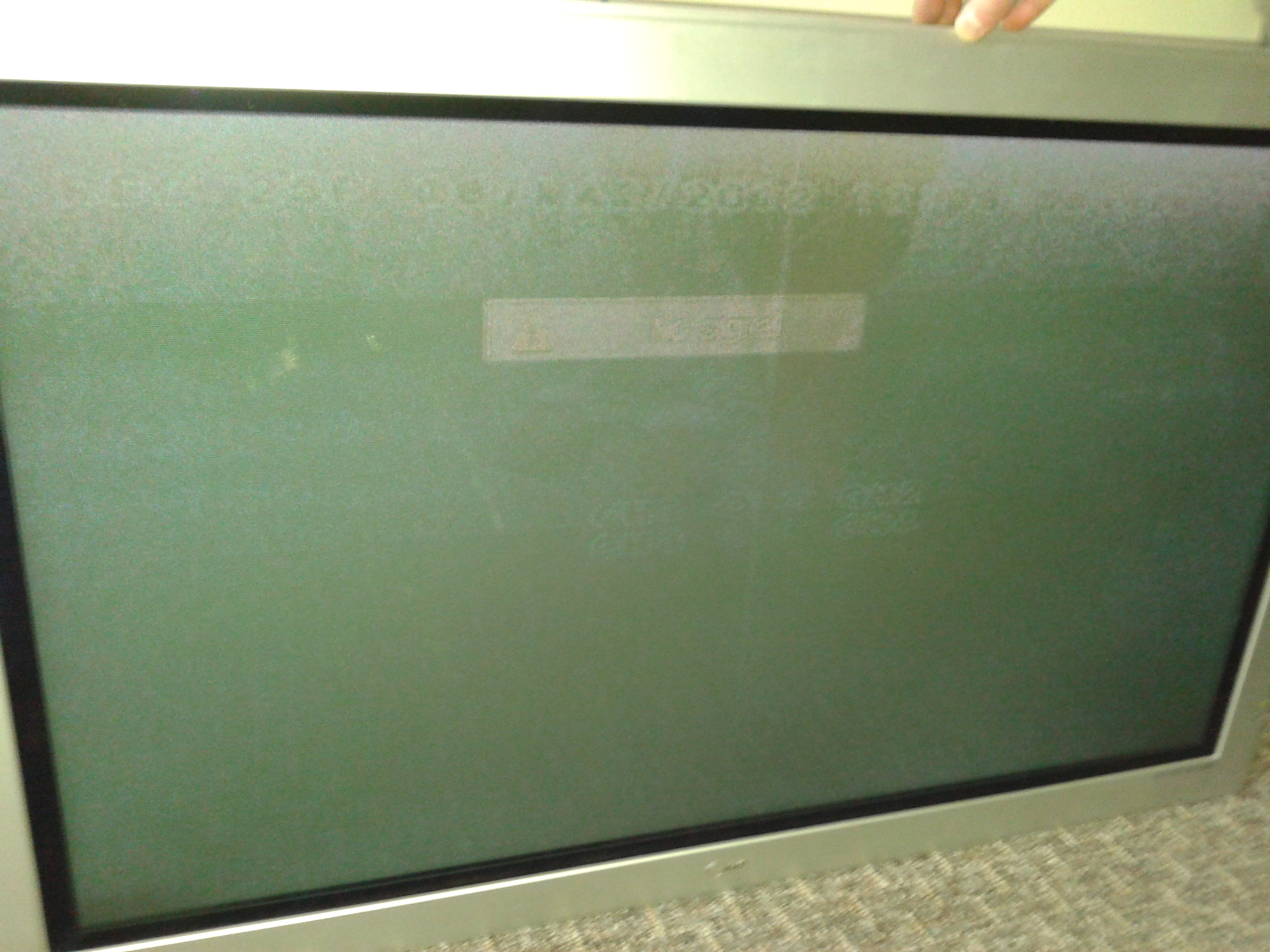

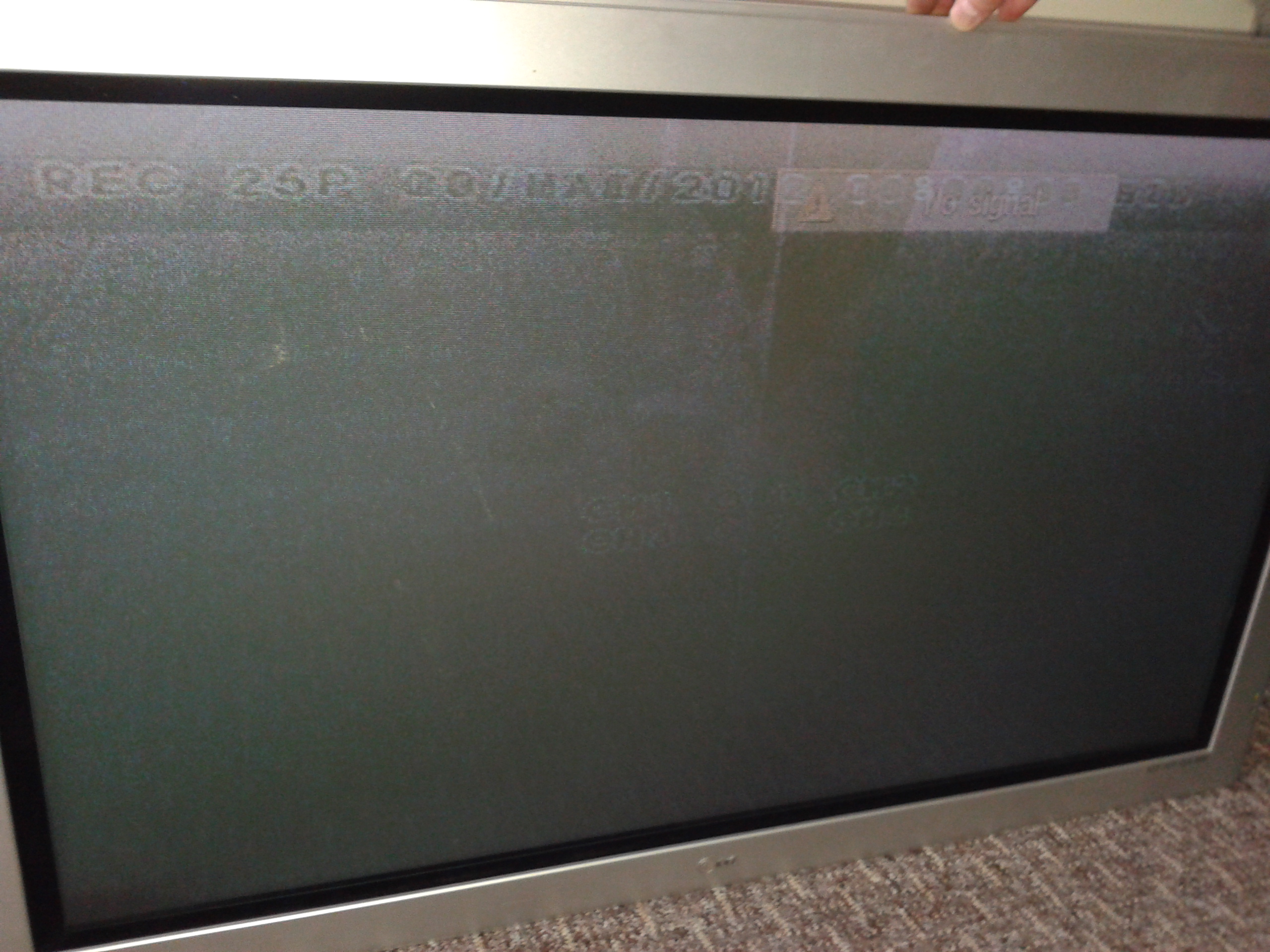

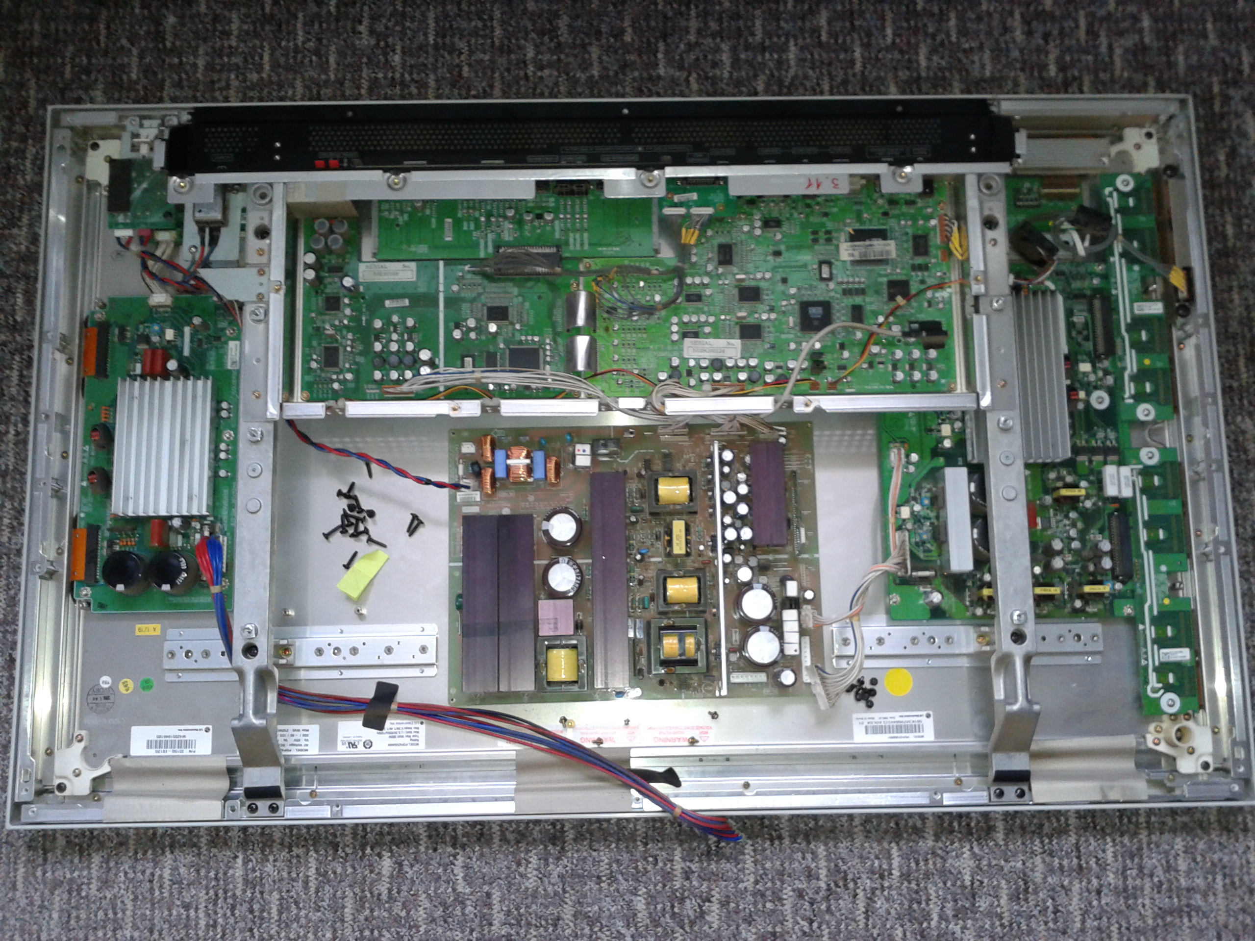

    Hello you all very kind people , i have LG plasma TV MZ-42PM13 with faulty screen. I guess that this is maybe not screen failure, rather than electronic curcuit. TV shows last seen screen (when it was working good), from CCTV cameras. Picture is grainy and it flashes in and out randomly. I have never repair plasma tv so please forgive me my lack of knowledge .
    If someone have met with such failure from LG plasma tv and want to share with me solution to fix him i will be very grateful .
    Cheers
    Thomas
    Re: LG MZ-42PM13 Grainy picture with quick fading in/out
    The "last image" is probably due to burn in, which will not be repairable. The phosphors on the panel have been permanently damaged.
    However, you may be able to fix the dim image; in this case, it's probably the Z-sus.
