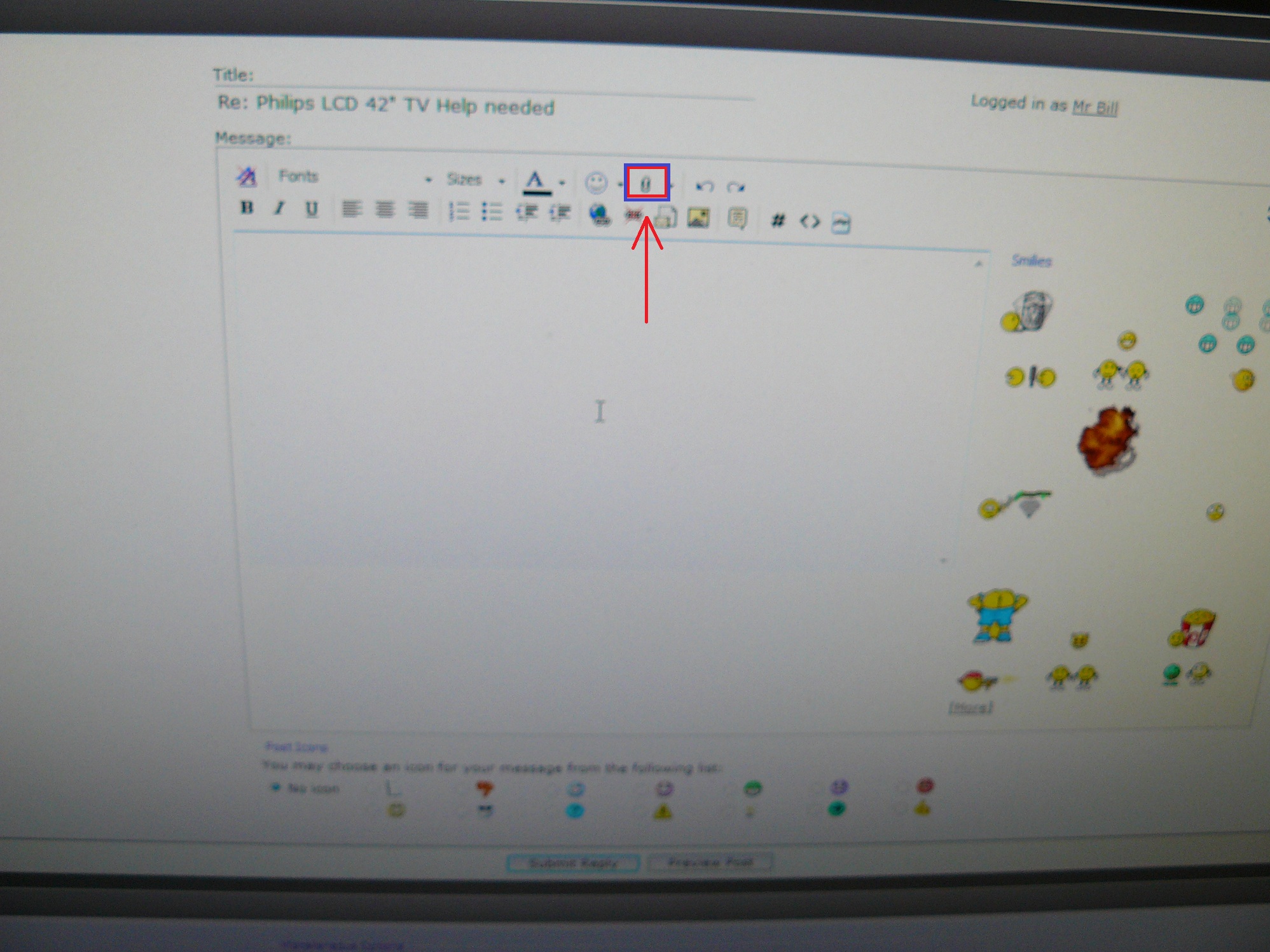

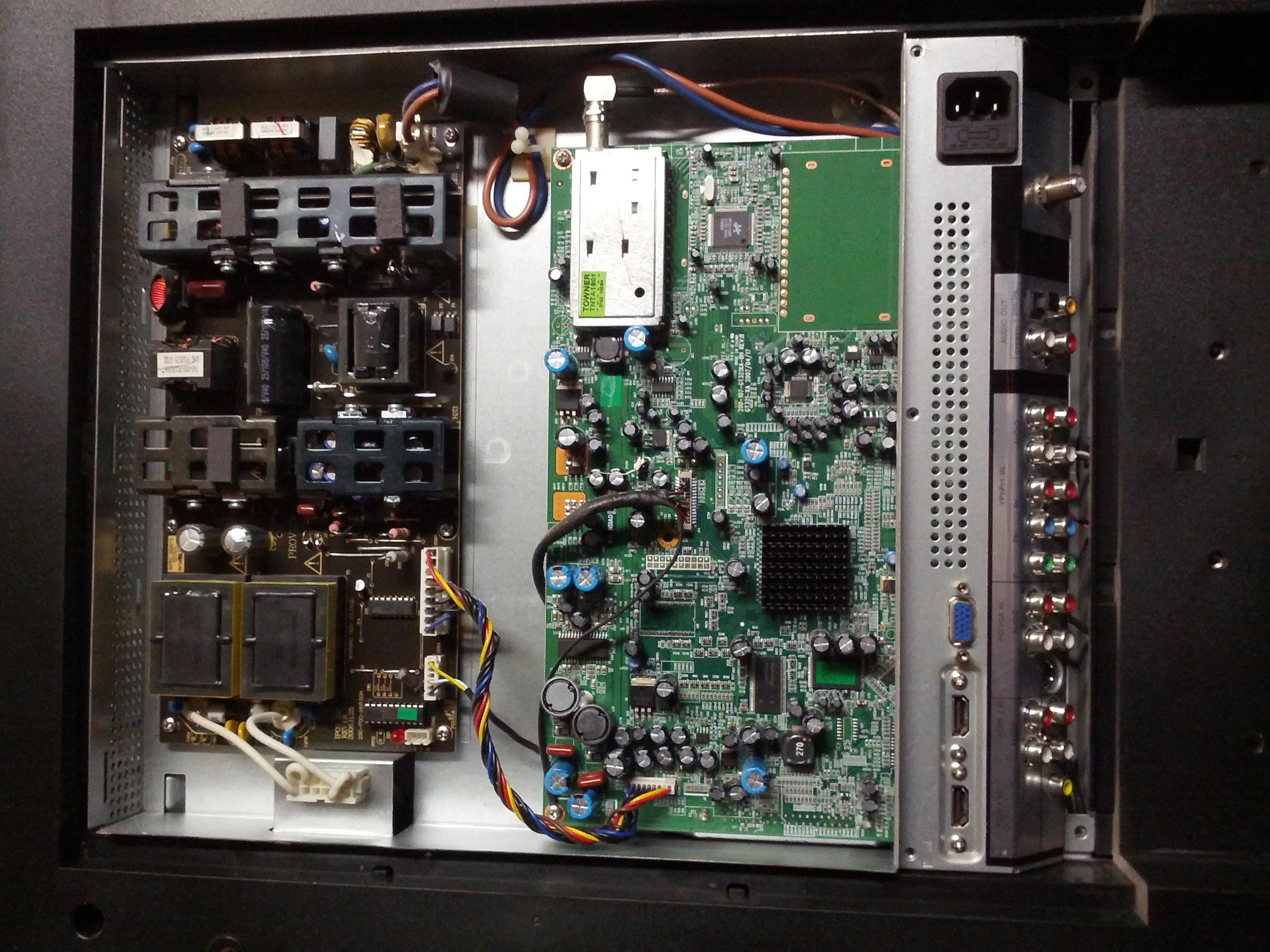

    Please remove the backs of the tvs and post pictures of the power supplies. Make sure the picture is within 2000 x 2000.

          pictures of power supply on memorex

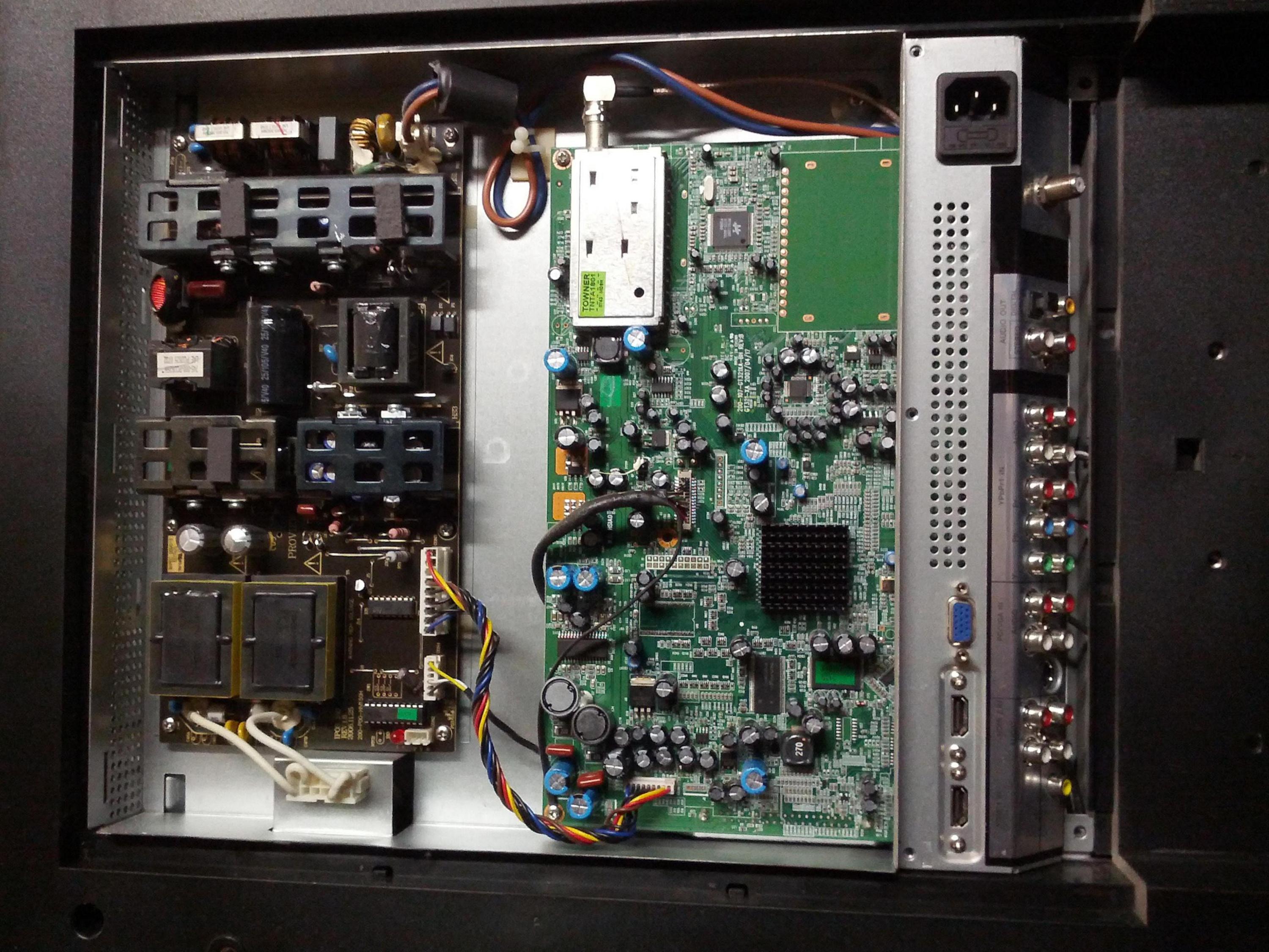

            same pictures just trying to make sure they are big enough let me know if I need to take other photos or closer photos

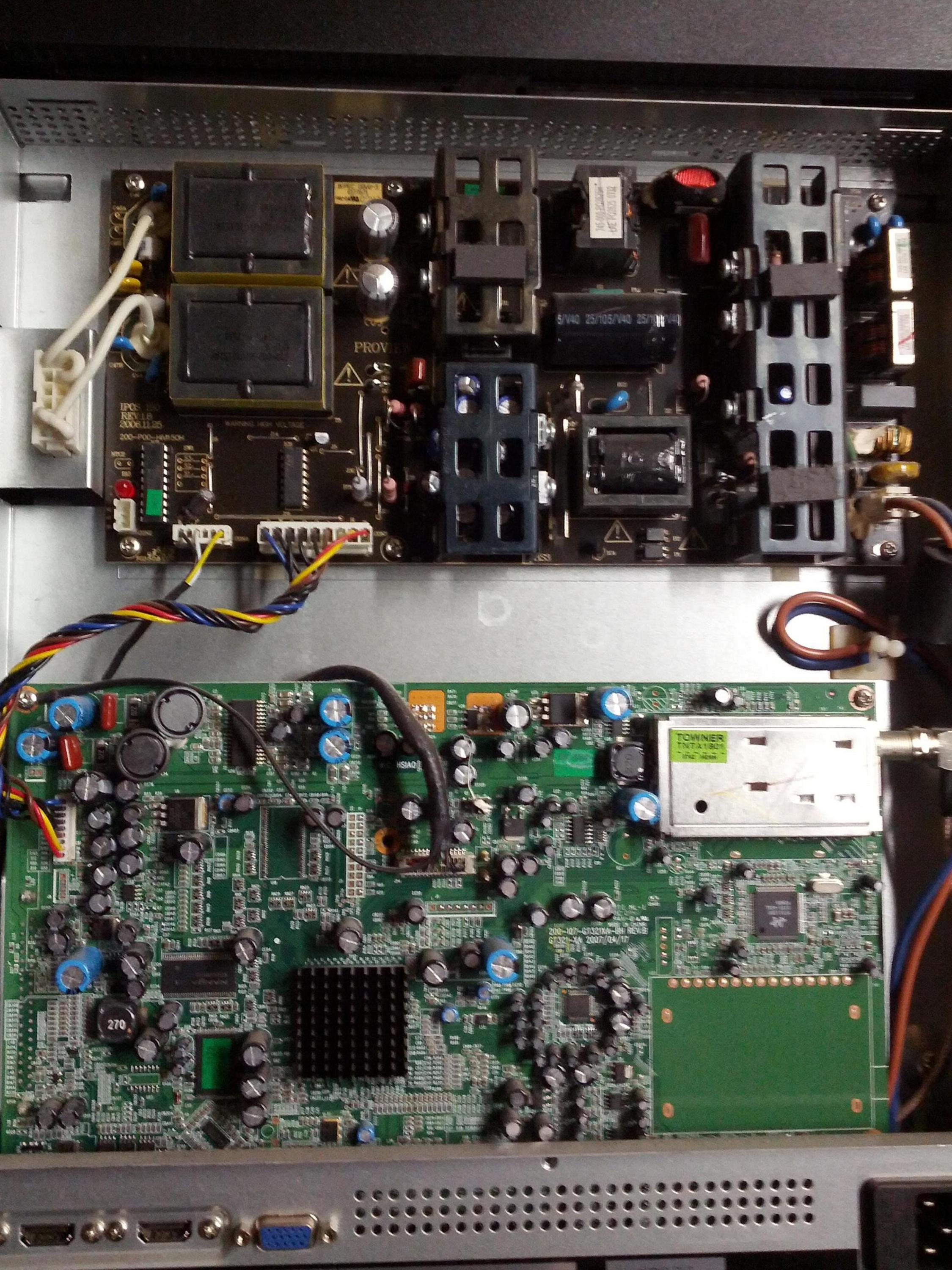

              Well you have at least one obviously bloated cap on the power supply. I always advise people that if you see one bad cap, you should replace them all (cockroach theory).
              My standard advice for replacing caps (regulars may skip).
              https://www.badcaps.net/forum/showpo...84&postcount=3

                    Got the old caps off the board ordered all new ones just waiting on them to come in once they do I will put the board back together and see if it works. I tried getting the caps at my local radio shack so I did not have to wait on them to get here but they did not carry what I needed

                          Replaced the caps today put everything back together and the TV works perfect. Thanks for all the advice and help this was my first TV repair I am glad I could get it fixed instead of just throwing it away. Thanks again
