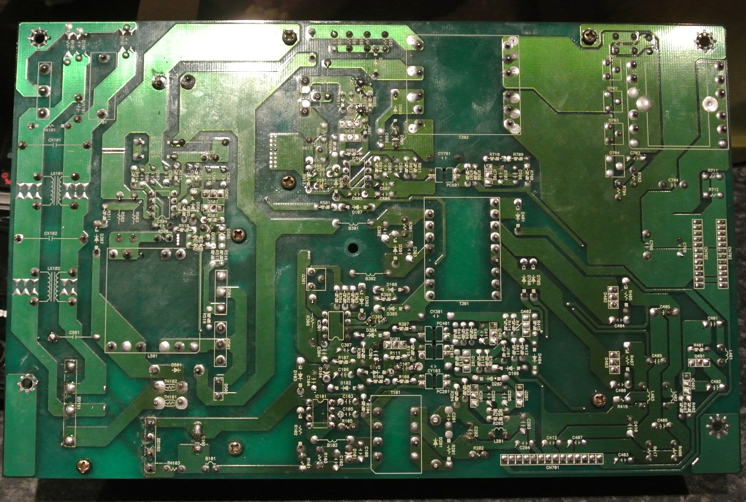

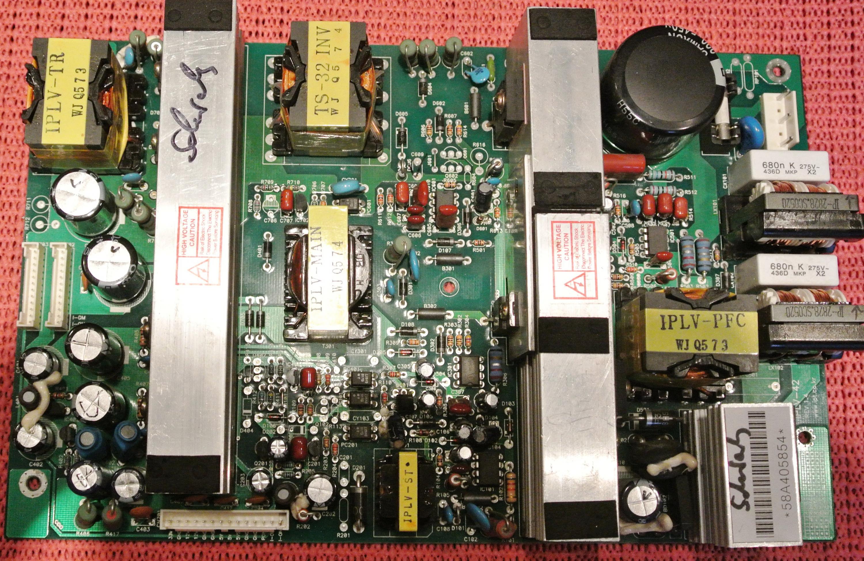

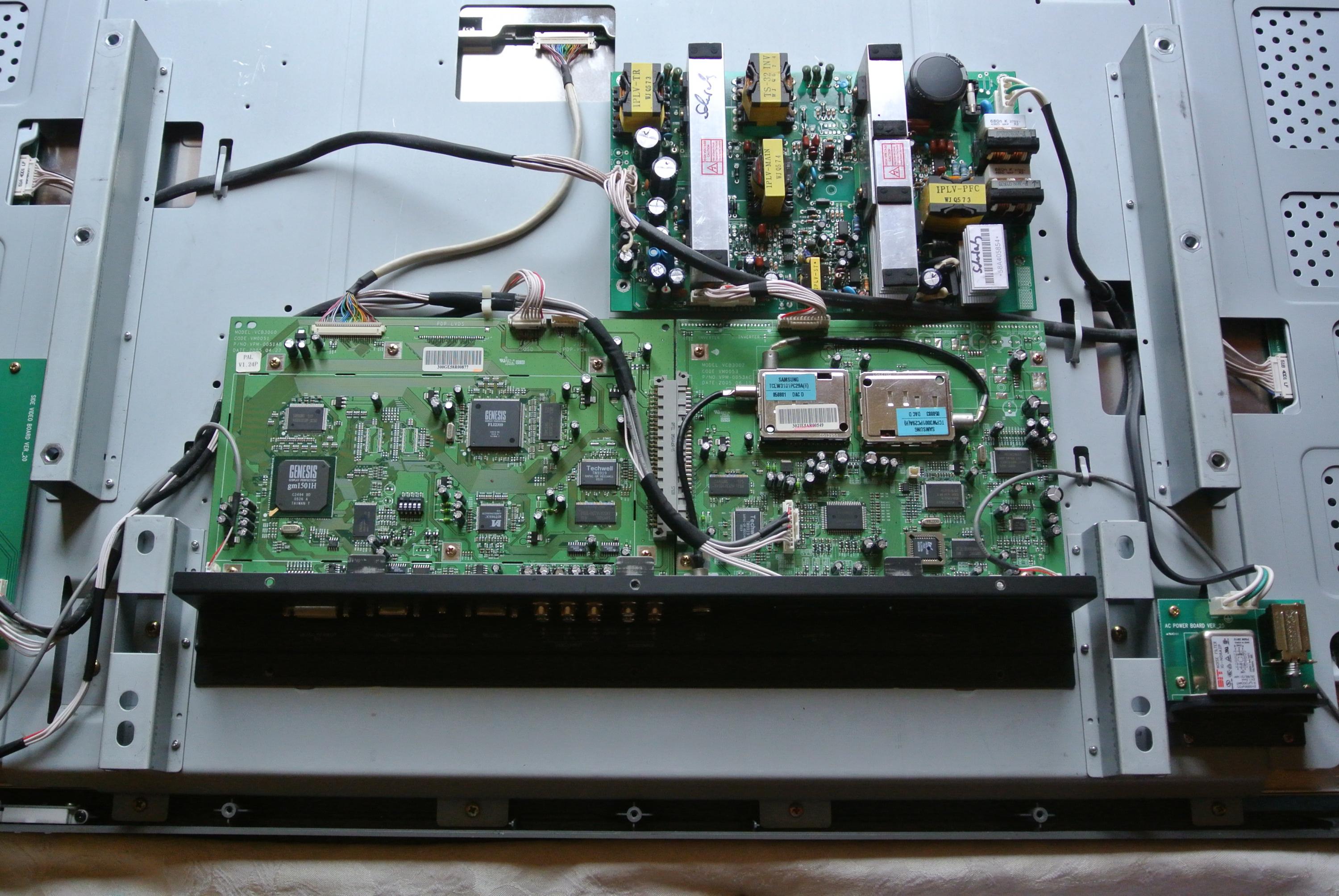

    Hi all this Atec 42” came in stuck in standby.
    Shows red light on standby but when you press power button it goes green then goes orange .
    But the screen shows no sign of life at all .
    Power supply is an IPLV-42 .

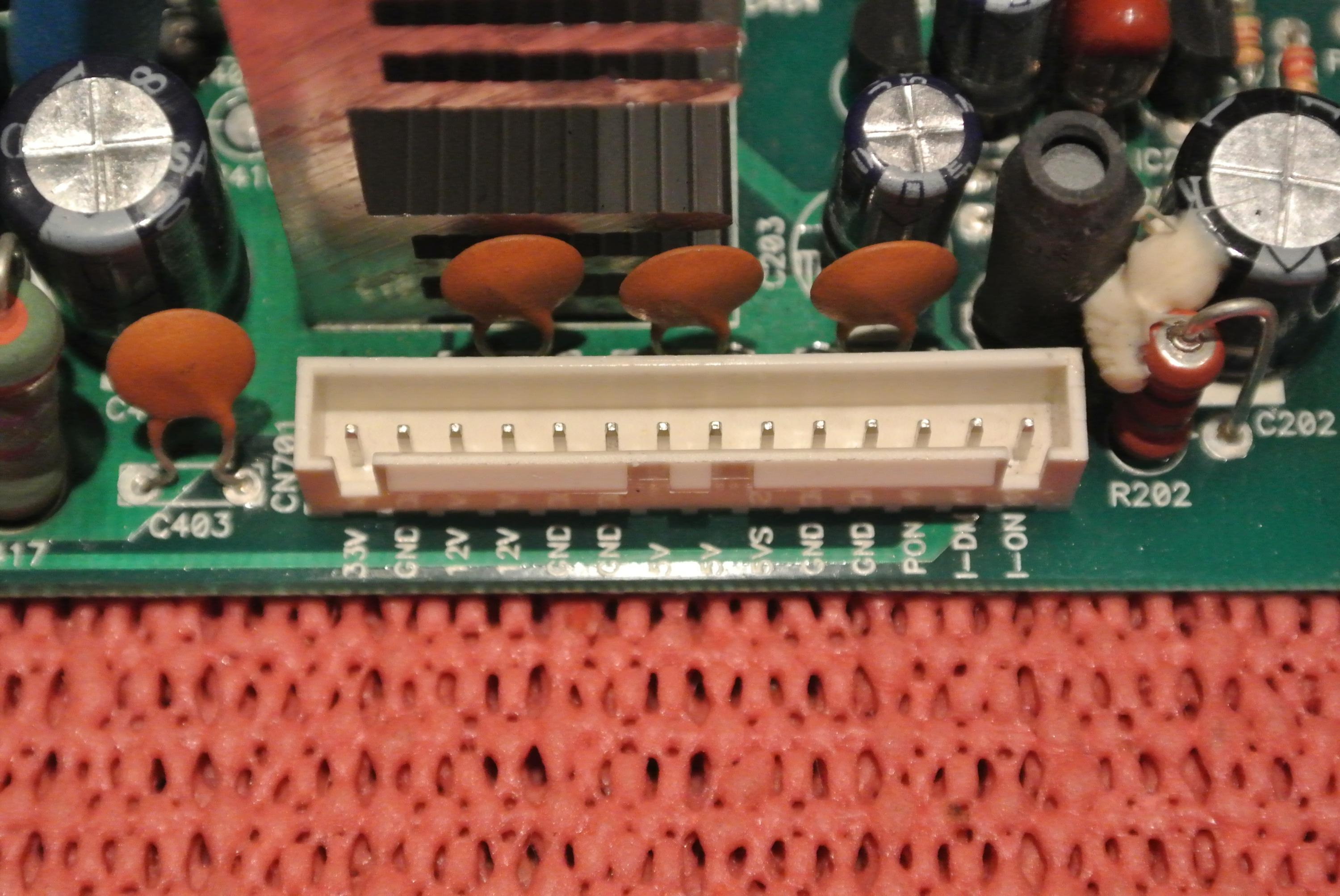

    No 24v at the inverter plugs (not shorting to ground ).
    No 33v on psu to main board (not shorting to ground ).
    12v and 5v on the main to psu all shorting to ground .
    Q101 short not yet changed
    The short appears to go all the way back to the schottky diodes for the 12v and 5v rails .
    Any ideas as to what could cause a complete short like this I don't want to just change parts and blow them .
    Thanks in advance
