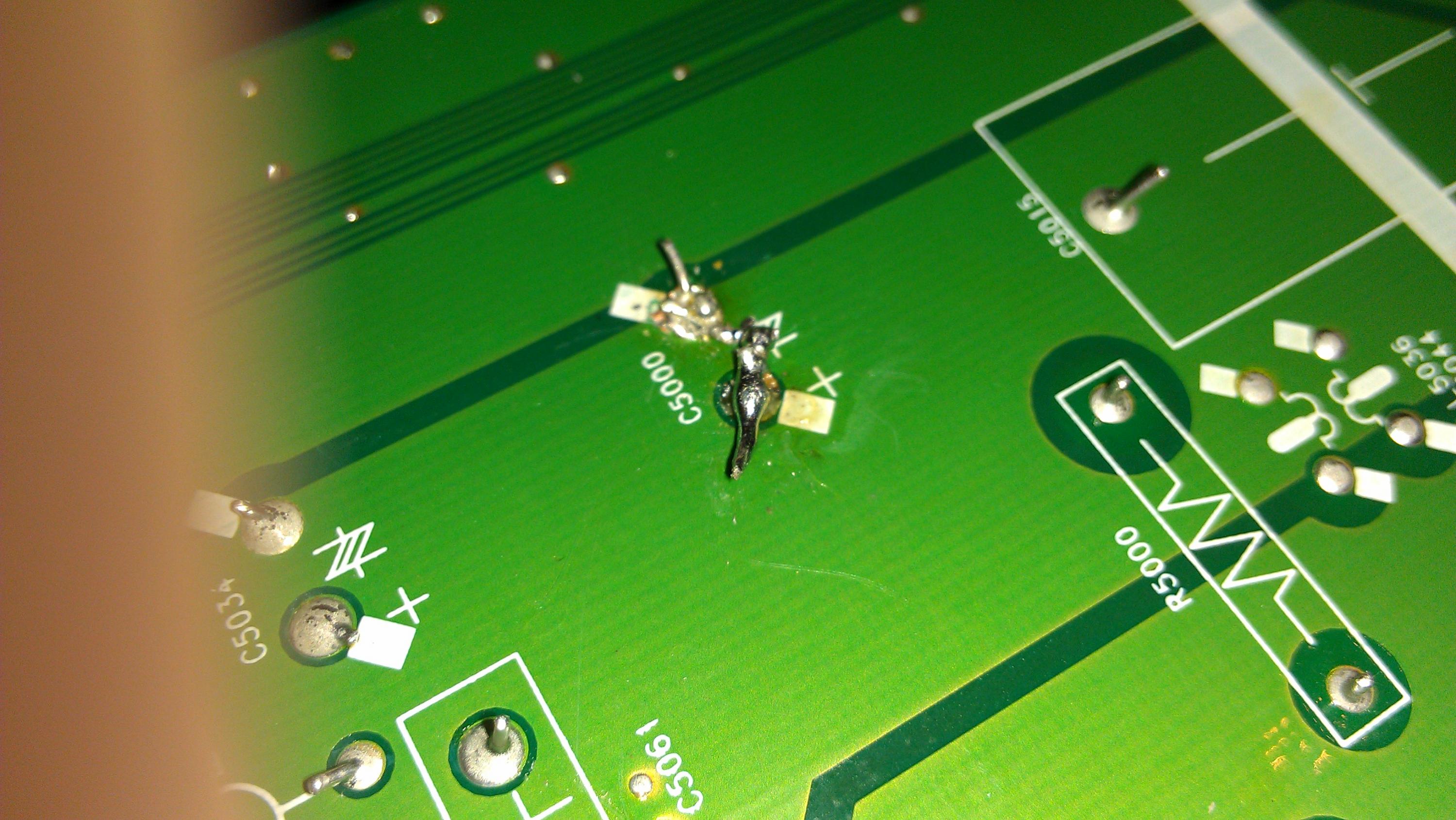

    I pulled out the Ysus board and checked the cap the kid put in, what a mess
      Re: Magnavox 50MF231d 37 Blown Fuse/supposedly solid green light when turned on
      Oh dear ... wow. I'd be amazed if that works at all. Remove all of the solder and resolder it.

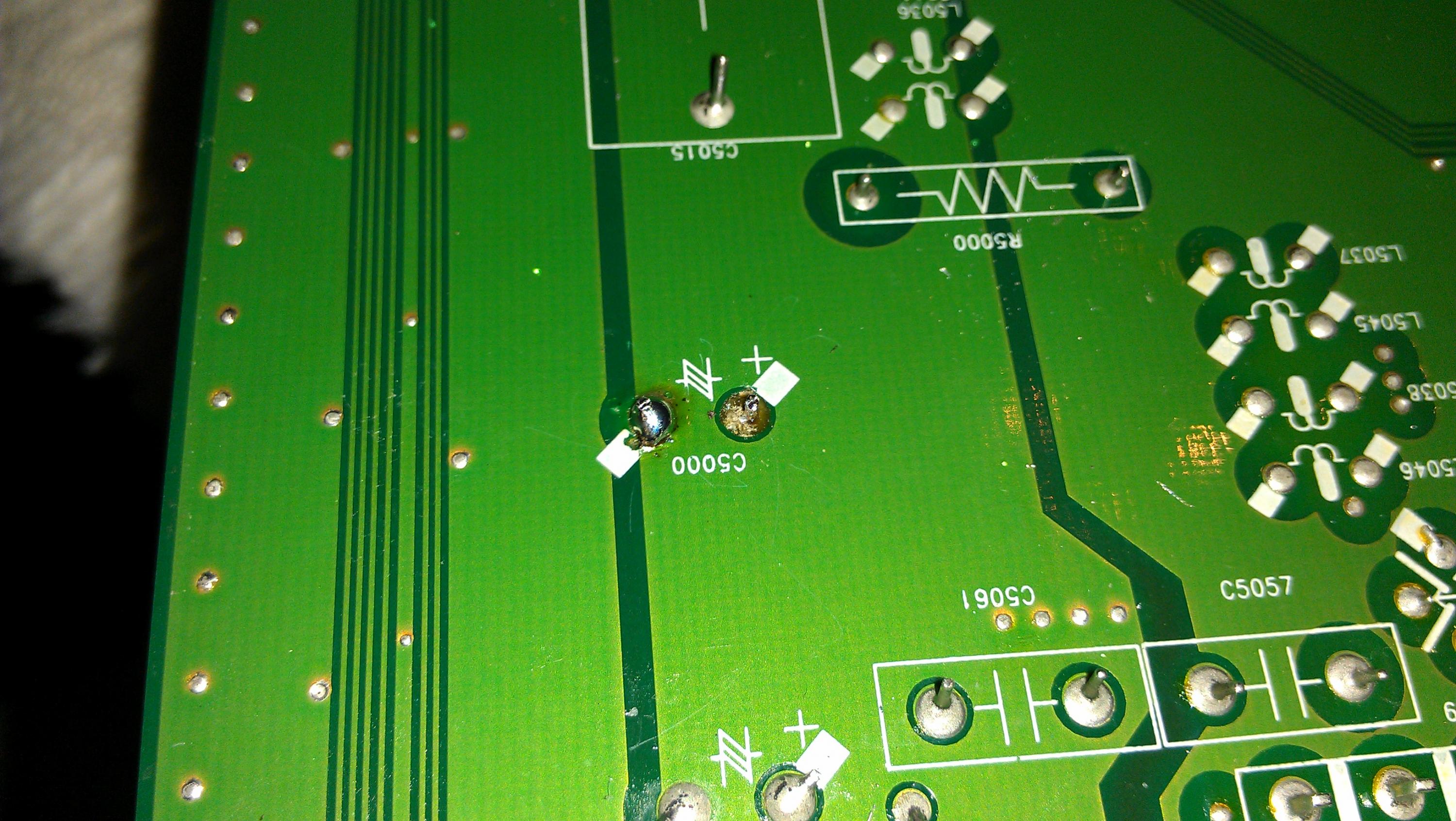

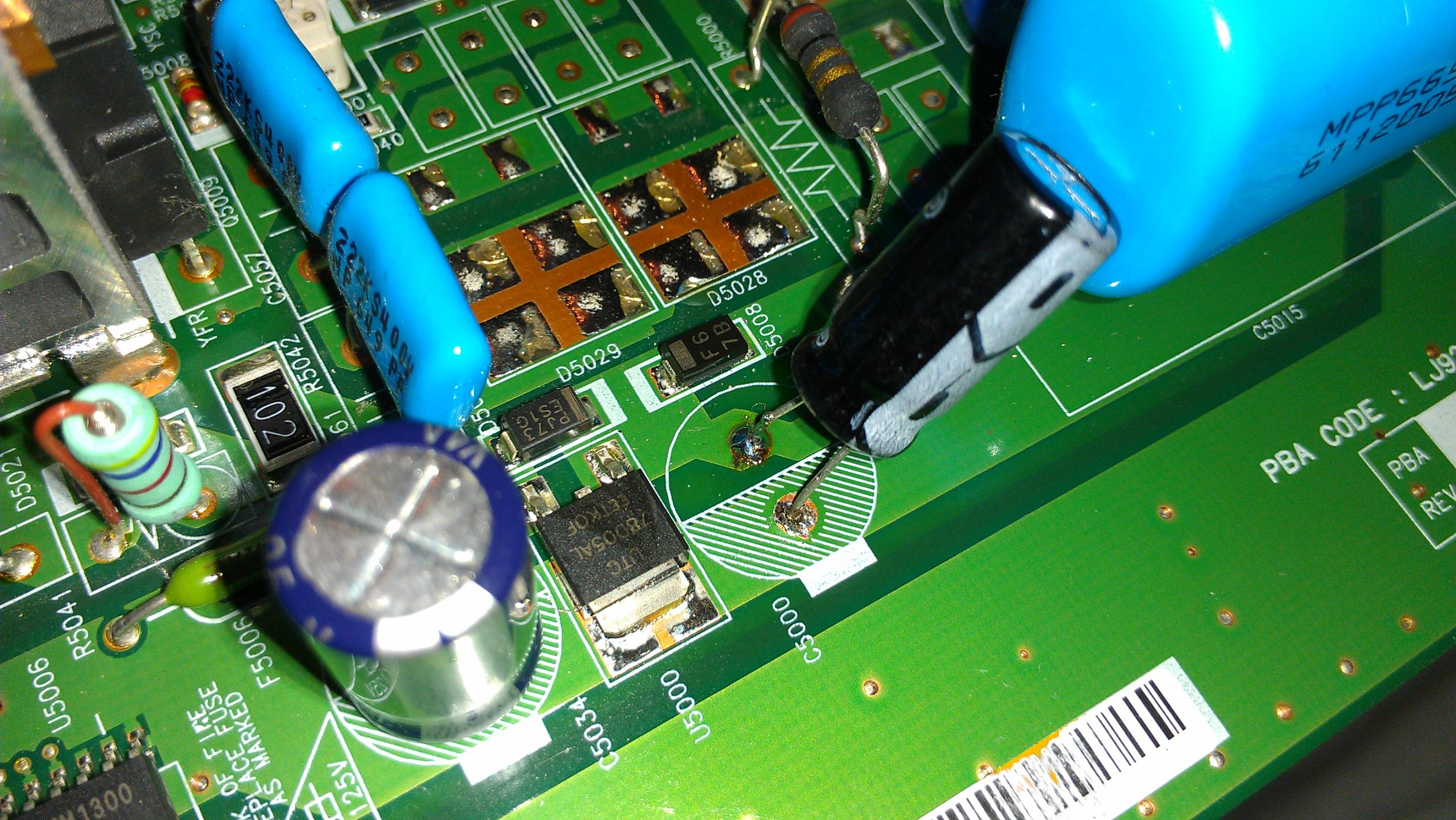

        I pulled it out but unfortunately i only have the other capacitors that the guy gave me. The copper pad on that side was missing, which I guess her thought he could just solder the two leads together. I soldered the one leg to the other side if the board as that where it should connect to. Here is a pic of the repair.
          That should work.

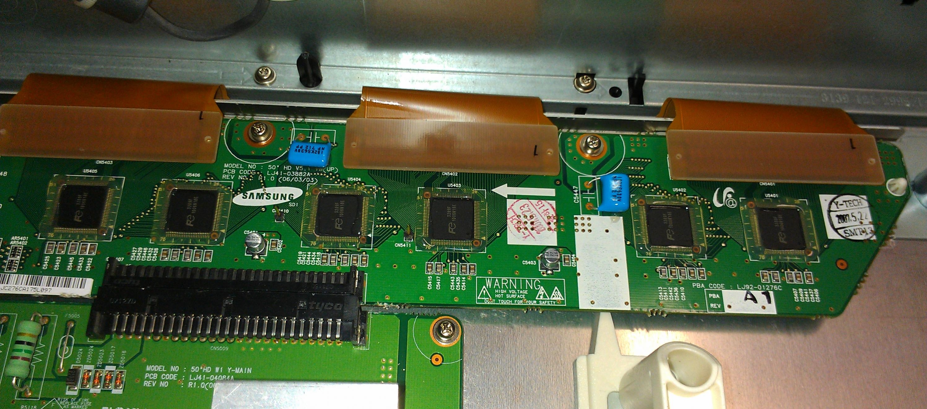

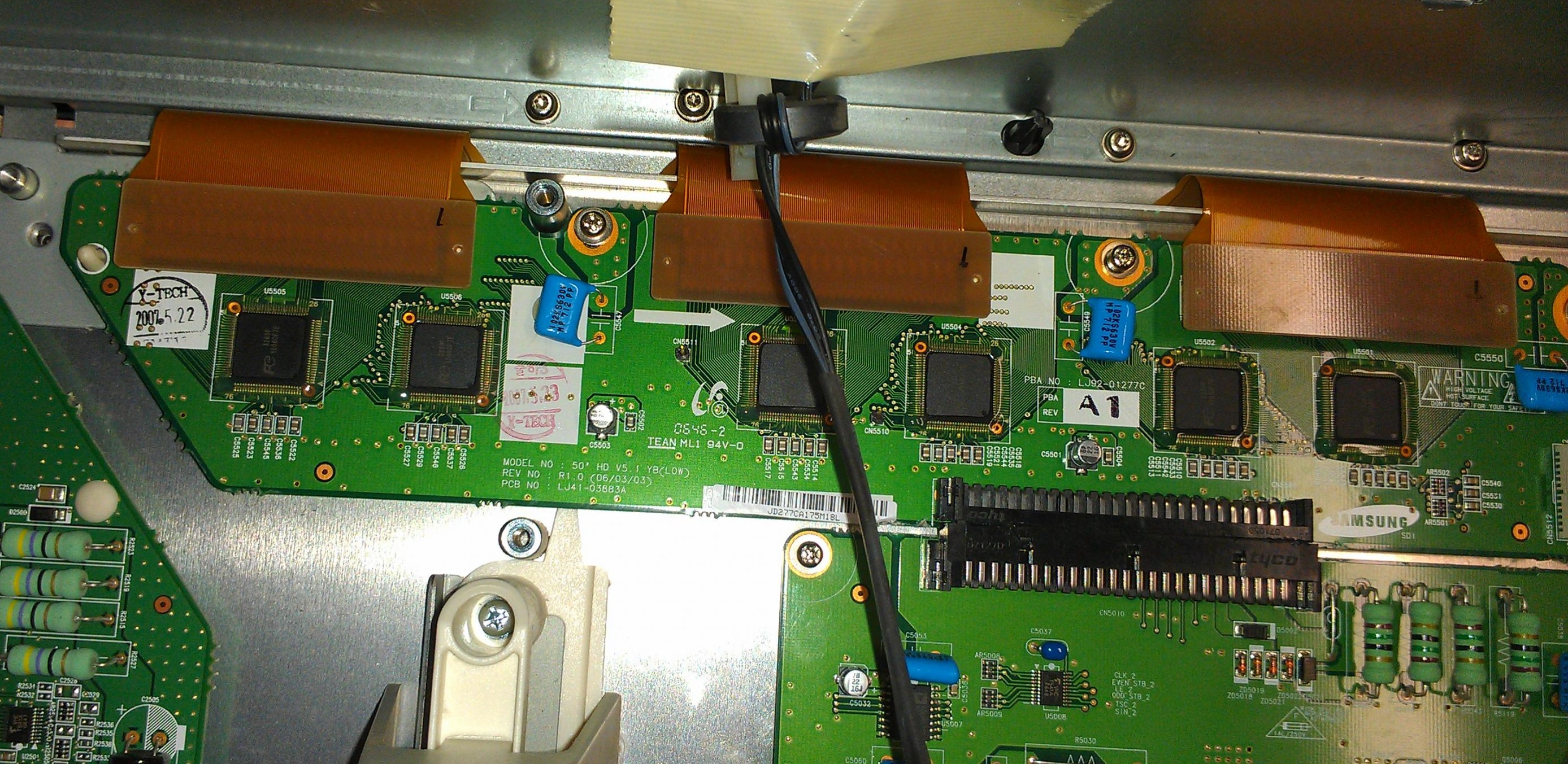

                      I had to put this away for a while. I am just getting back to it. I went through the Y-sus and found two rows of diodes shot near the black connectors. Also found the other cap near the replaced one was on its way out as it now shows a bulged top.
                      I ended up getting another Y-sus board and checked those diodes and they measure good. I dont want to put in a new board and kill it, so I need to know how to check for a bad Y-buffer.
                      Before, it would turn on and then shut down right away. Unplugging either the X or Y board would allow the power to stay on. Should I be looking at replacing the X-sus also ?

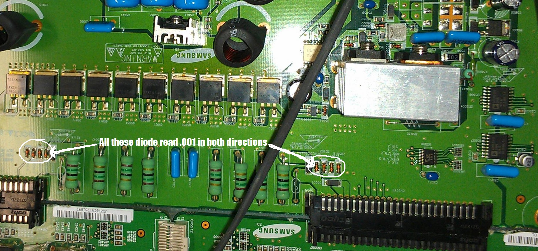

                        This is what I found when going through this board so I got a replacement
                        that is .001 VDC in diode mode
