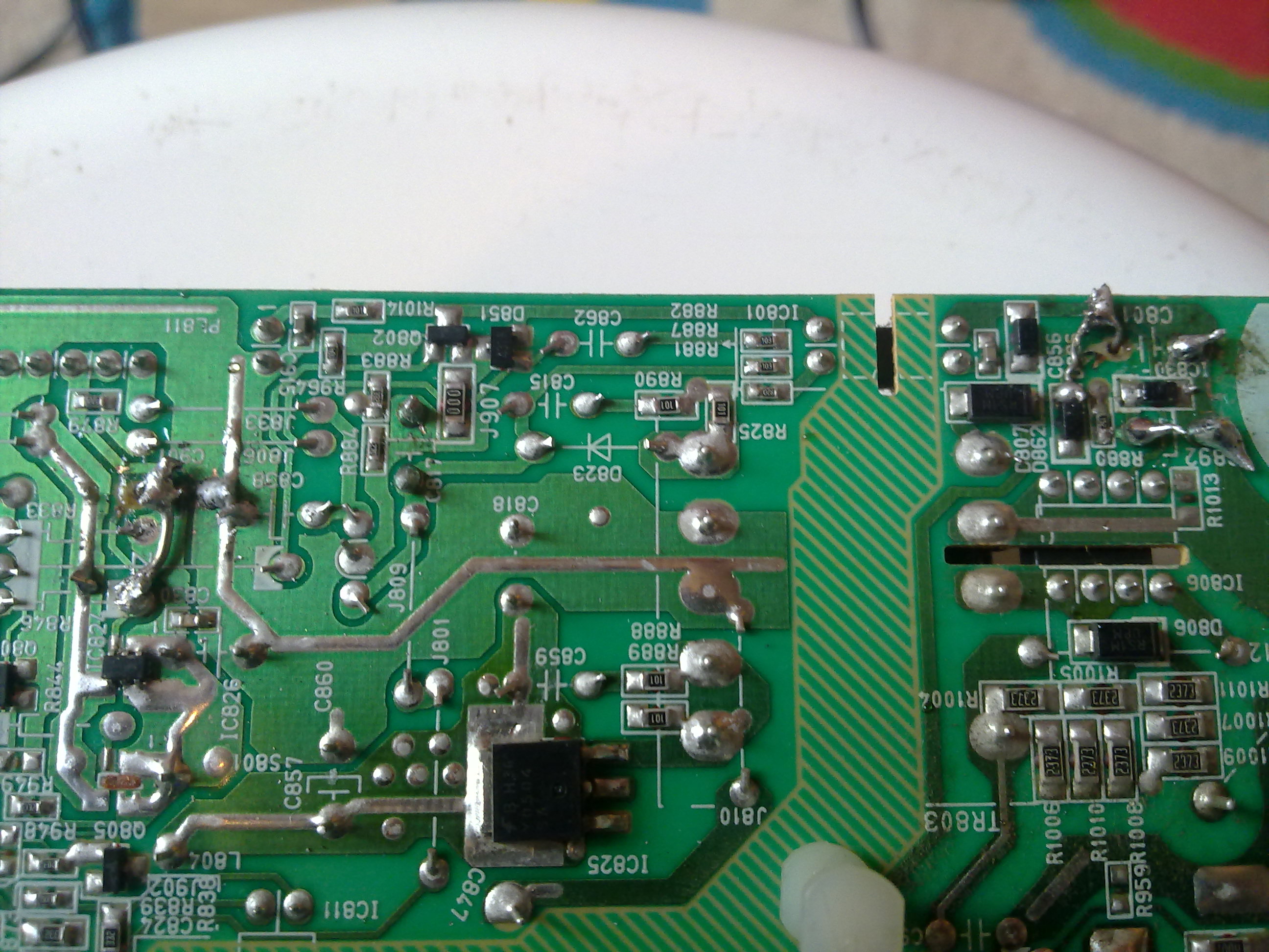

    Hi
    Strange one, I got this tv and it has a bit of a strange fault, stripped it and found a butchered 15-9...someone has destroyed c901 & c801 and created there own poorly made tracks
    Anyway the fault is with the remote control, first thing in the morning or when the set is cold it will not start off the remote control but will start of the side buttons, once warmed up you can turn it on/off by the remote all day long.
    I thought it may be the remote sensor or main board so I fitted the PSU in another vestel and the fault was there on the other model.
    It looks like the psu has had the reliability kit and the joints all look ok, I checked r917-919and plopped another blob of solder on them all just in case.
    Anyone had this or have any ideas...do you think this has something to do with the Voltage Regulator??
    Thanks in advance
    Re: Technika LCD32-207/17pw15-9
    C878 and C877.
      Cheers Tom, sorry should of said, even though it looks like it has had a reliability kit fitted in the past I always pop new c877 & C878 in :o(
        Check voltage across 450V cap.
          :o( 334v...I shall now remove this board and jump up and down on it
            PFC IC failure, pretty common..
              Is that IC807?? The 16 leg IC next to the Smoothing cap
                No, it's the 8 pin SMD underneath.
                  Got it IC802, right will replace that now, do you recommend replacing smoothing cap with a 450v 220 cap???
                    Not usually necessary...
                      I have got to show you this, I dont now if I should bother with this board....maybe this should go in the hall of shame, looks like they pulled the pads on c801 c901 and done a errrmmmm dont know if I can call it a repair, proably got the pidgeons to do it
                      But thanks for your help Tom, just about to put the IC on so I will let you know how it goes.
