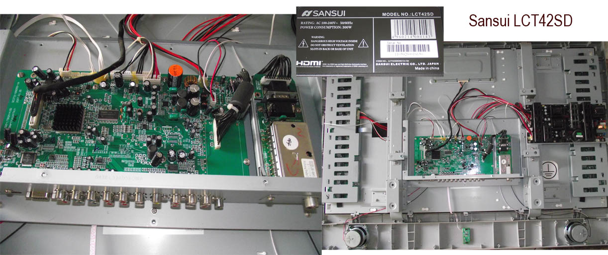

    Sansui LCT42SD
    Hi, guys.
    This LCD works fine as a TV via the RF [aerial] input.
    But it does not process any signal feeding via any other plug.
    Customer kids use it for playstation via HDMI or RCA inputs.
    I told customer the signals board might need replacing -and it's not cheap.
    Am I right?
  • burntfingers
    • Jan 2011
    • 148
    Re: Sansui LCT42SD
    Removed back cover, checked plugs, supplies, all seemed to be OK.
    Connected DSTV to video inputs and suddenly it's working fine.
    I had tried it before and all inputs would not work [except the RF].
