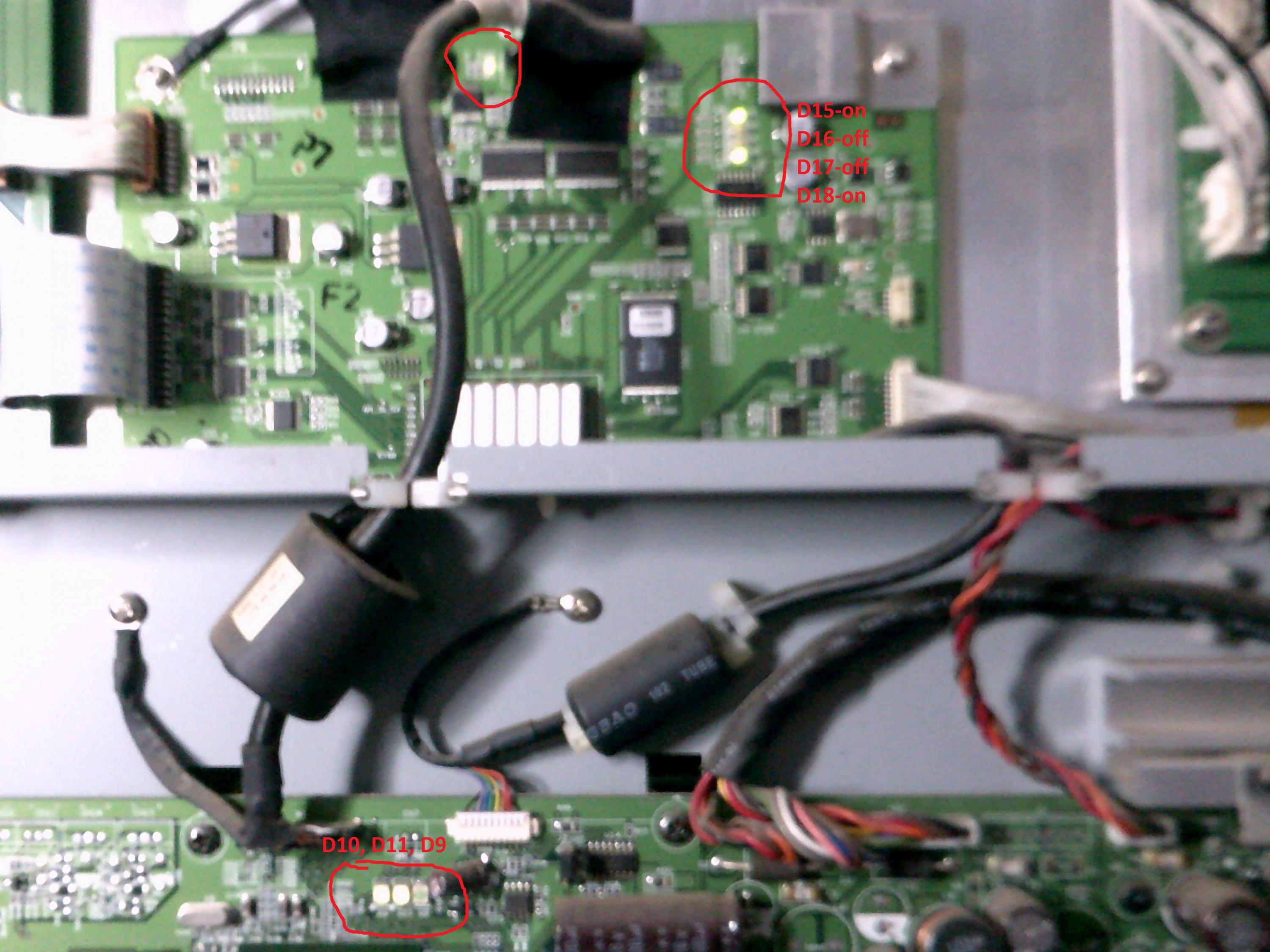

    I found this post, I seem to have the same issue.
    https://www.badcaps.net/forum/showth...ghlight=p50hdm
    All voltage from power supply board is good. No low glowing light on panel.
    -Plug in
    10 green led blink then amber
    D10-on
    D11-flashing
    D9 - off
    -power on
    solid green led
    D10-rapid flashing
    D11-on
    D9 -off
    I disconnected ysus - same results
    reconnected ysus and disconnected zsus - same results

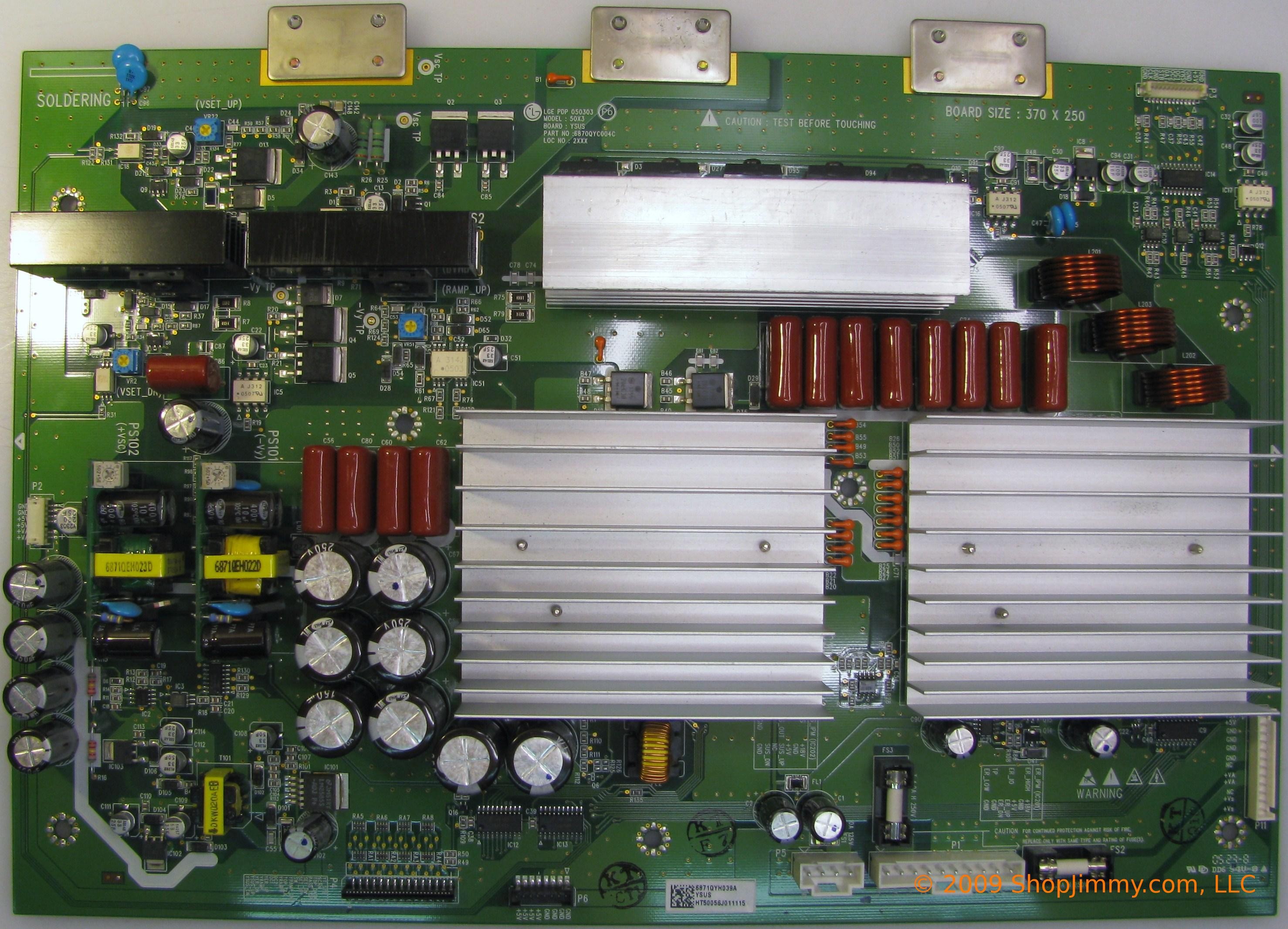

    There seems to be no change when troubleshooting. This makes me think ysus like in link above.
    If I am correct in suspecting ysus board what should I look at on the board?
    The two fuses are fine.
    No scope, just a dmm.
    The pic of ysus board is from SJ not actual board.

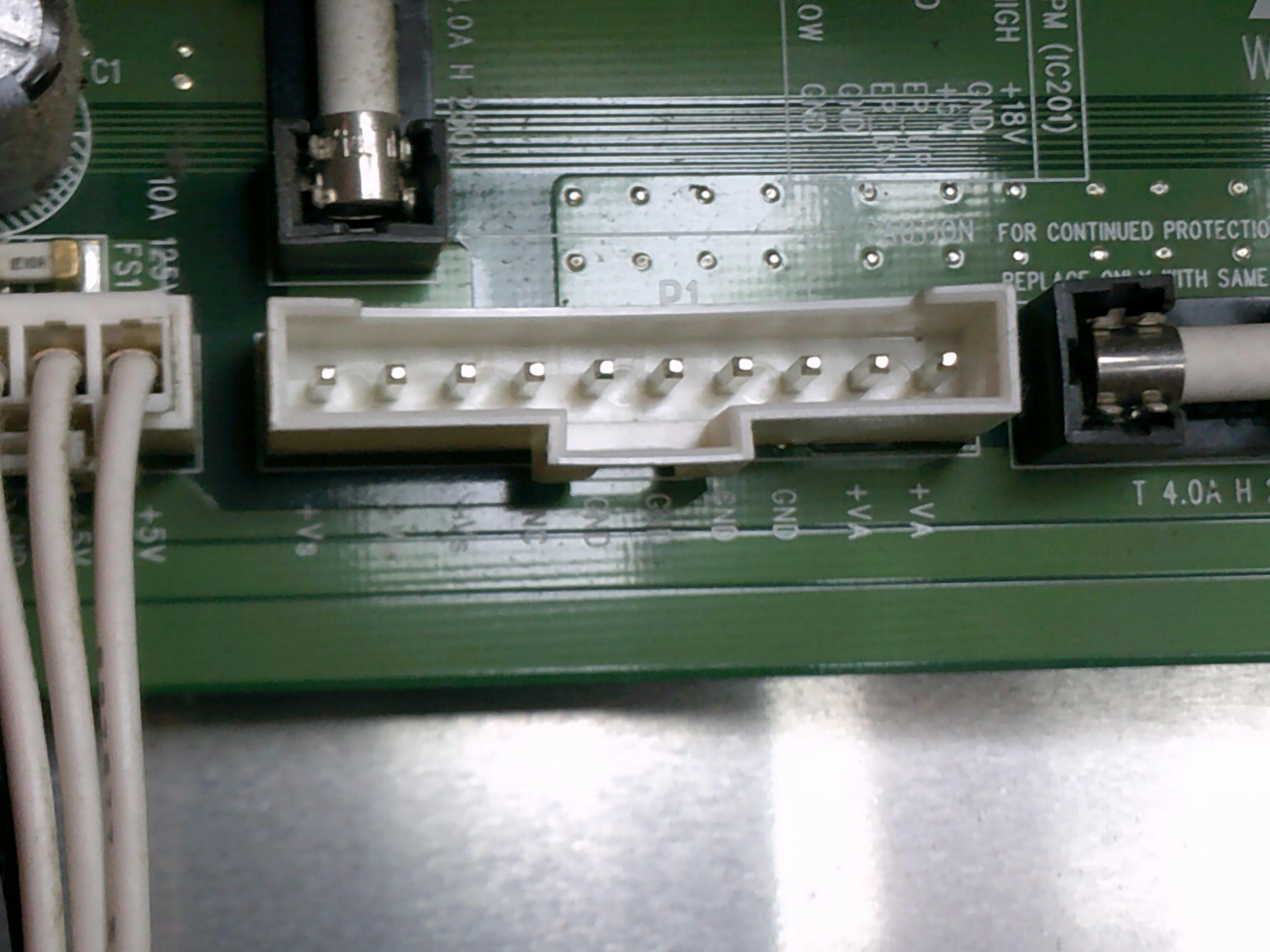

      This is what I got with ground probe on chassis and testing connection P1(connected from power board) in pic. (fuses are good)
      vs- 197.3vdc
      va- 59.8vdc
      Max vs-200vdc
      max va-61vdc
      Rated:
      vs- 197v
      va- 60v
      If there are other TP I should check I will need some help.(loc,voltage)

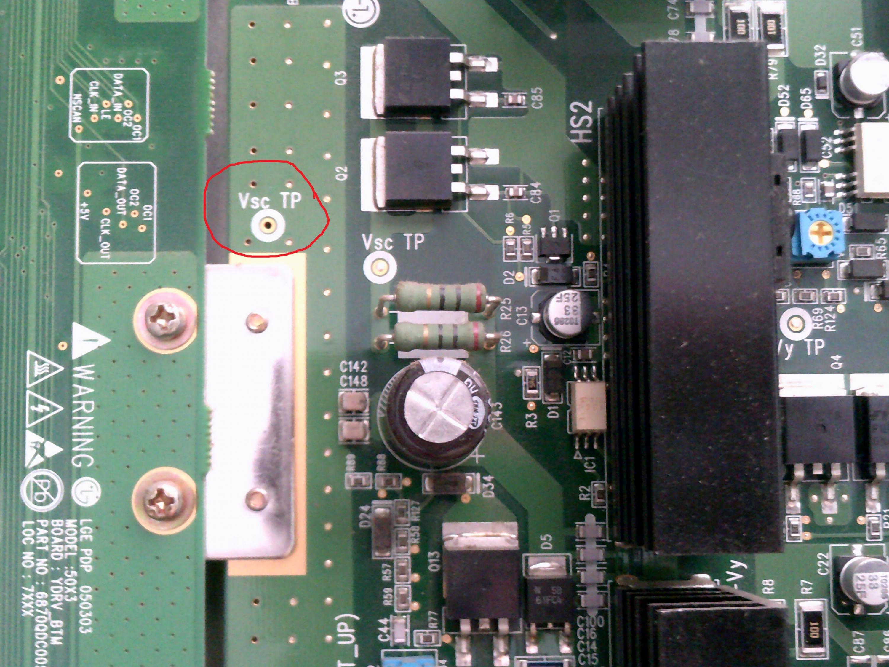

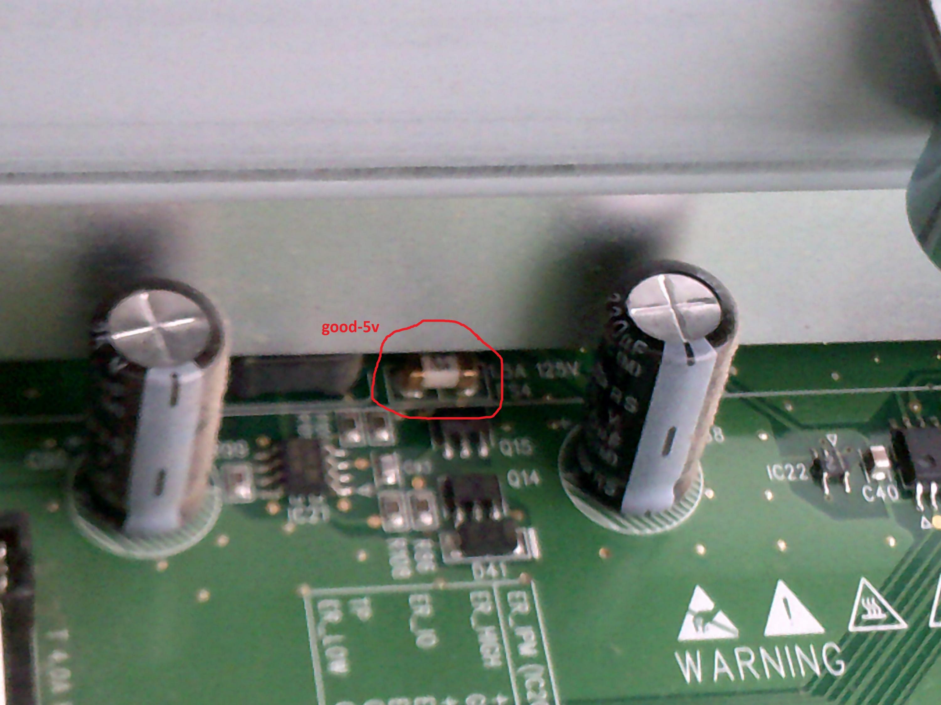

        I missed a fuse on ysus in pic but it tested good and there is 5v. through it.
        I'm still not 100% sure it is the ysus. Are there a few TP I can check to confirm?
        Is it safe to check vscTP(see pic) with dmm?
        -or, is my best option to send it out to be fixed since I dont have a scope?

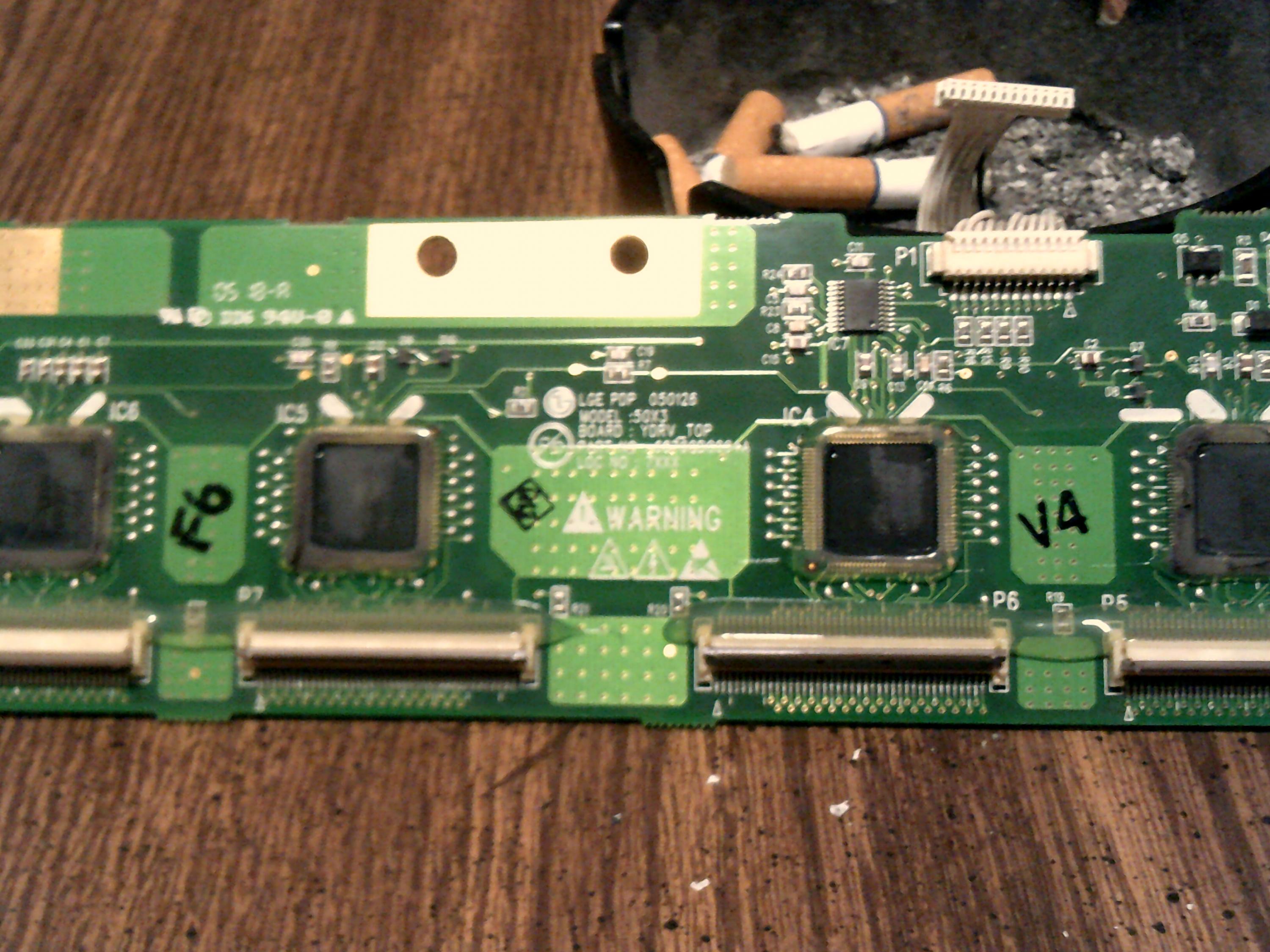

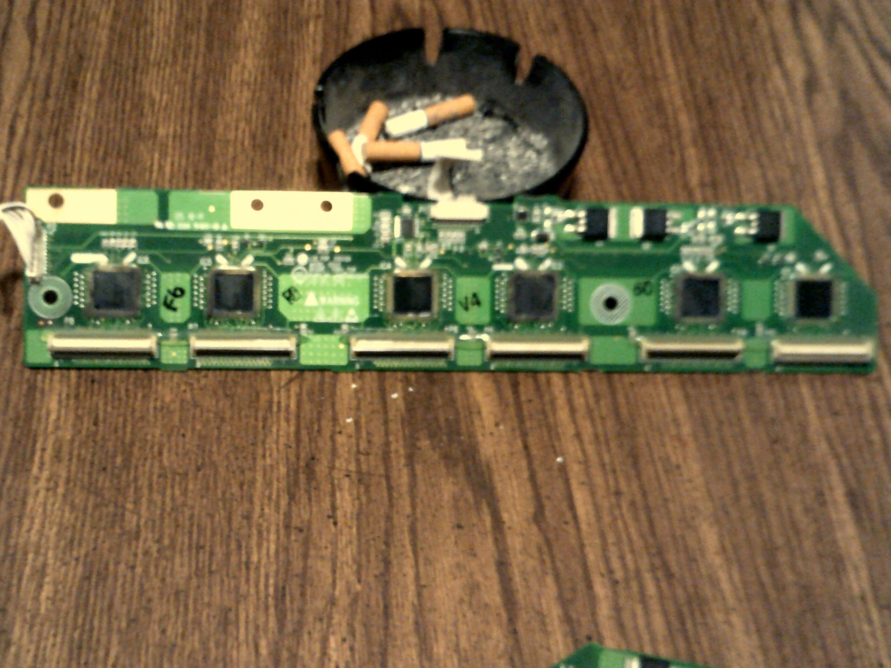

            This link shows how to test buffer boards for this and similar. Mine were good so no need to order any with ysus.
            http://blog.coppelltvrepair.com/2010...-lines-in.html

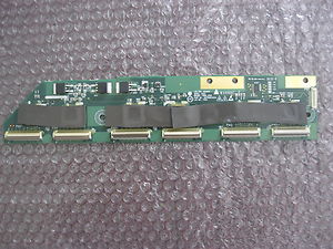

                I can't identify what pin to probe for sustain output(@minute1:50).
                pulled a few pics off internet.
                  Re: Vizio P50HDM no picture... ysus??
                  Need a closer picture, can't see anything in those.

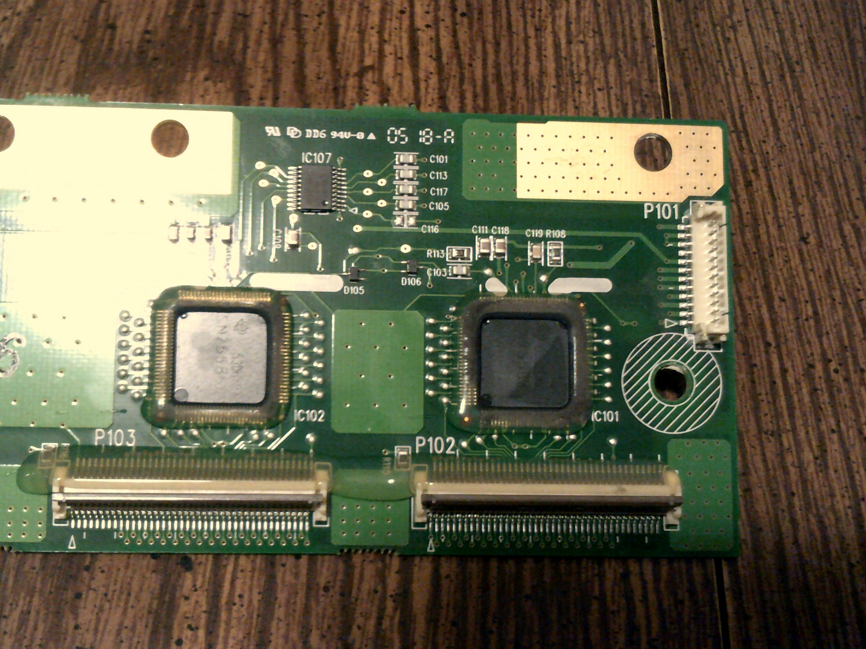

                  • ryan74
                    • Oct 2012
                    • 471
                    • usa
                    these are a bit better.

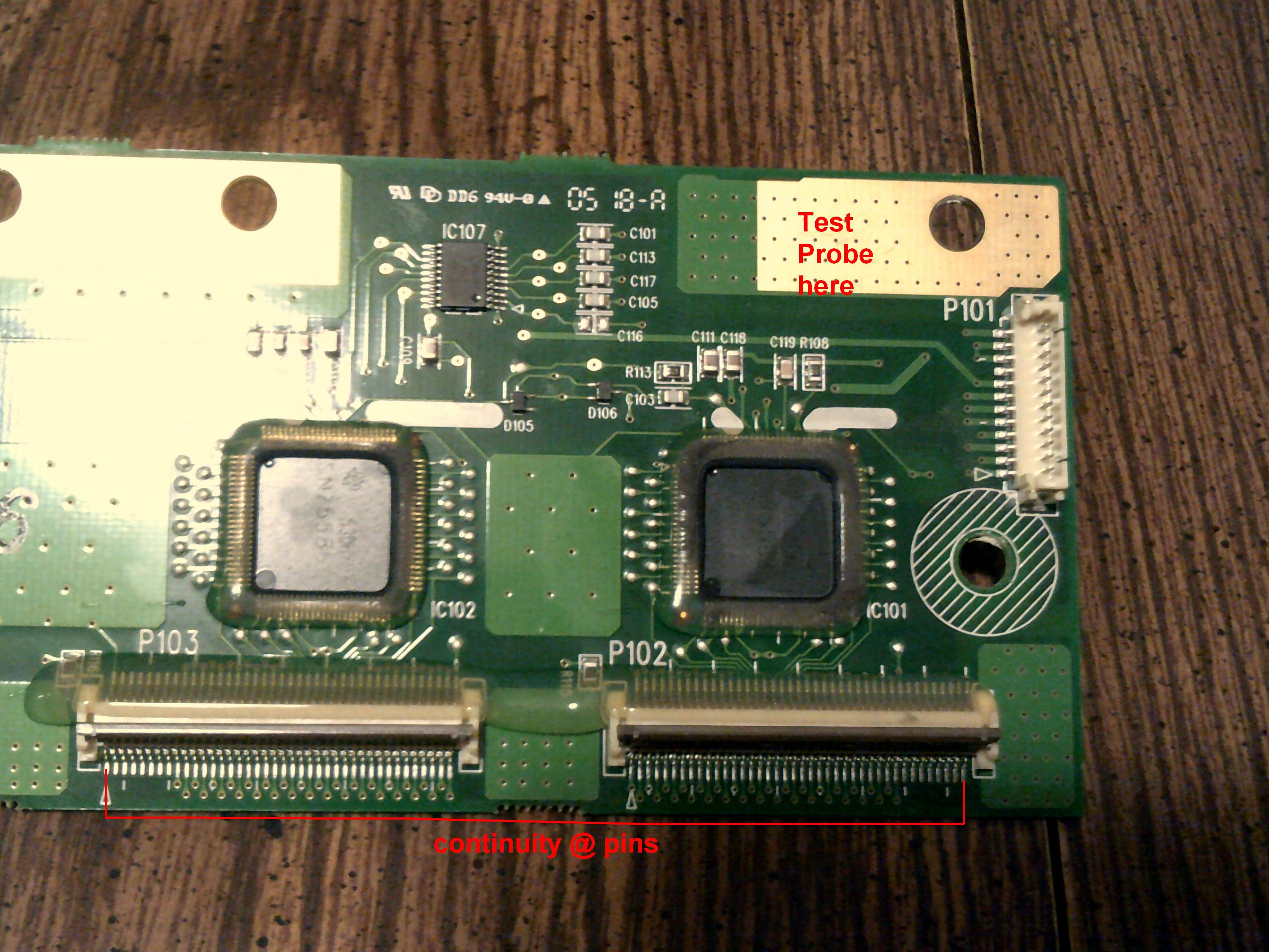

                      while waiting I checked every pin/pad on 1 of the buffers. I got continuity shown in pic. Either the far left or far right pin on all connections had cont..Except the one on the far left end(not shown).

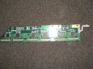

                        Update-Nevermind I got my answer to this...Yes
                        anyone know if this will work?
                        mine is:
                        LGE PDP 050303
                        Model:50X3
                        P/N:6870QYC004C
                        6871QYH039A
                        KP50055J001088
                        http://www.ebay.com/itm/Vizio-Y-sus-...item3a7ef6dc39

                          Correction- I don't think this will work, heatsinks are different and red caps are in a different loc.
                            If all connections are same & board is from same panel it'll likely work.
                            • ryan74
                              • Oct 2012
                              • 471
                              • usa
                              ok today is not my day. lol...
                              my barcode sticker is 6871QYH039A
                              this replacement is 6871QYH039B
                              the pic was of wrong board but seems to be correct part.
                              shopjimmy site says it will work as does the seller.
                              http://www.shopjimmy.com/lg-6871qyh0...main-board.htm

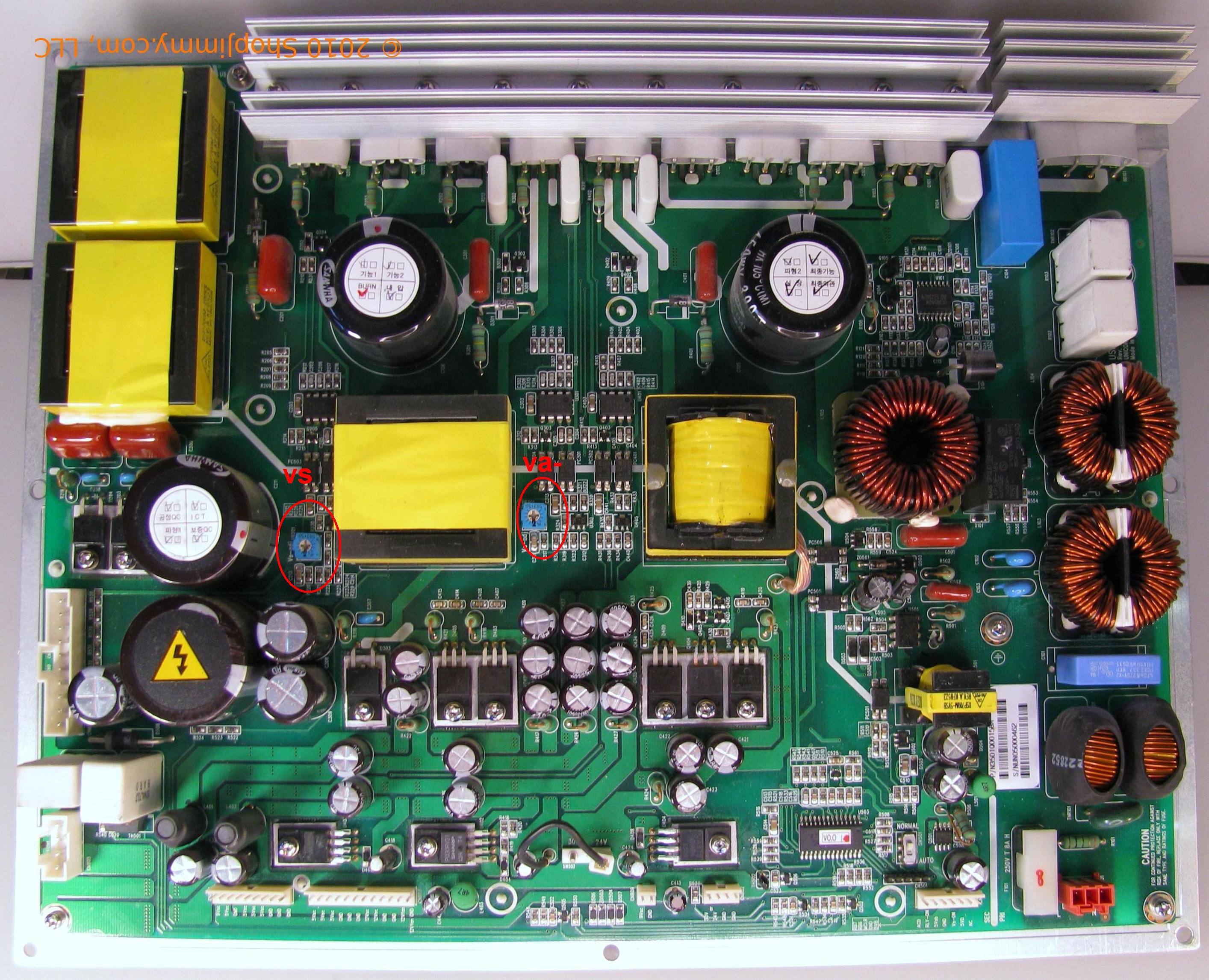

                                        Now I have red sparkles very noticable on black picture and picture flickers. VS and VA are good at 197.1v. and 59.7v.
                                        Panel says:
                                        Max vs-200vdc
                                        max va-61vdc
                                        I can try adjusting voltage a little but can someone verify I located the right pots in pic? I read to check voltages or it could be old age. I would like to fix the flickering first.
                                        Any suggestions?
