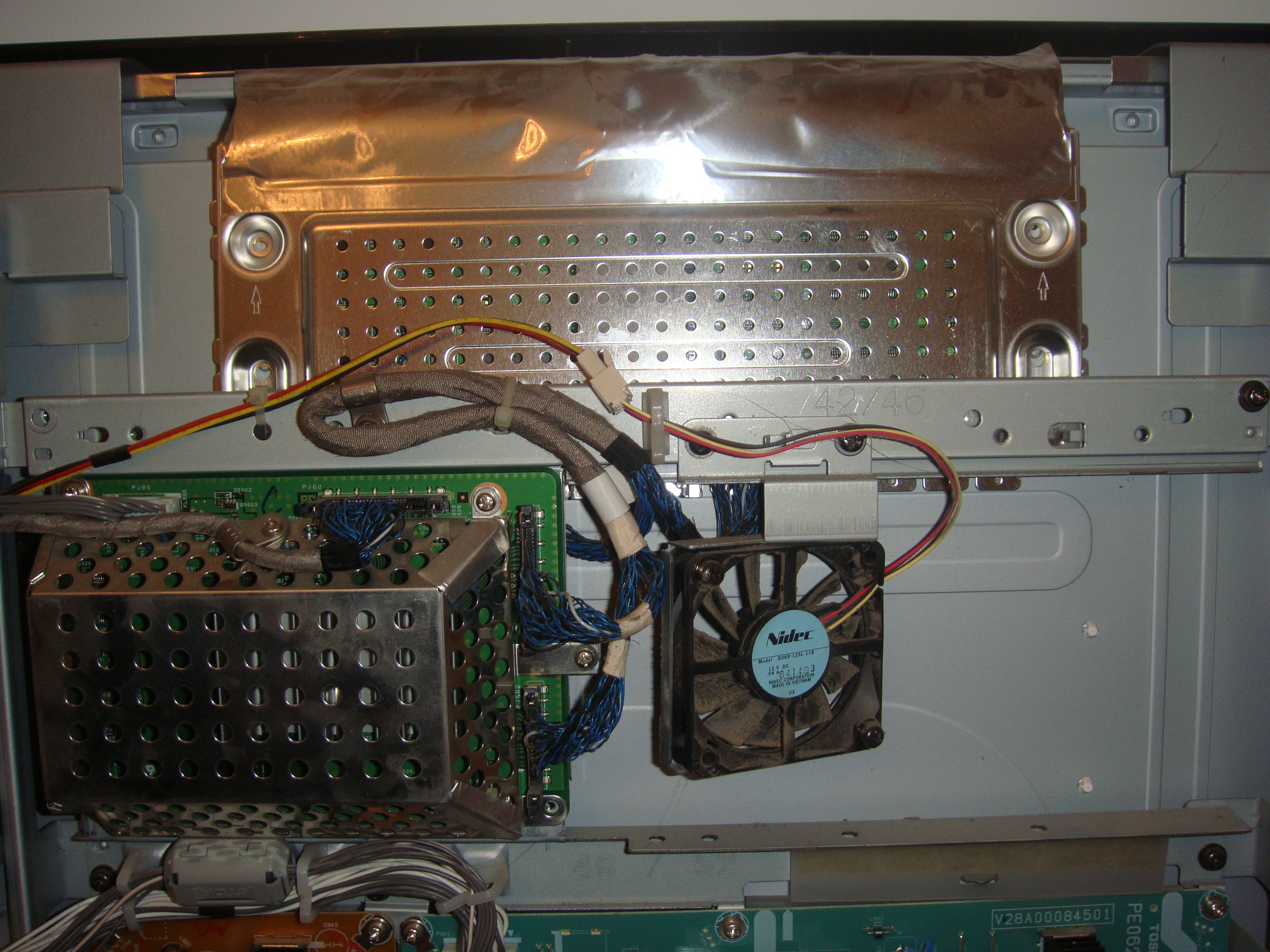

    Hi All,
    Help please! I have a 46 inch TOSHIBA RV555DB that has sound but no picture! The back light is on as you can see it through the holes in the metal panel behind the screen. The PSU does make a whine when it is first switched on. I was wondering if it was T-Con? I am prety good with a meter so wondered if I could prove it by checking some voltages?
    Thank you in advance
    Andy

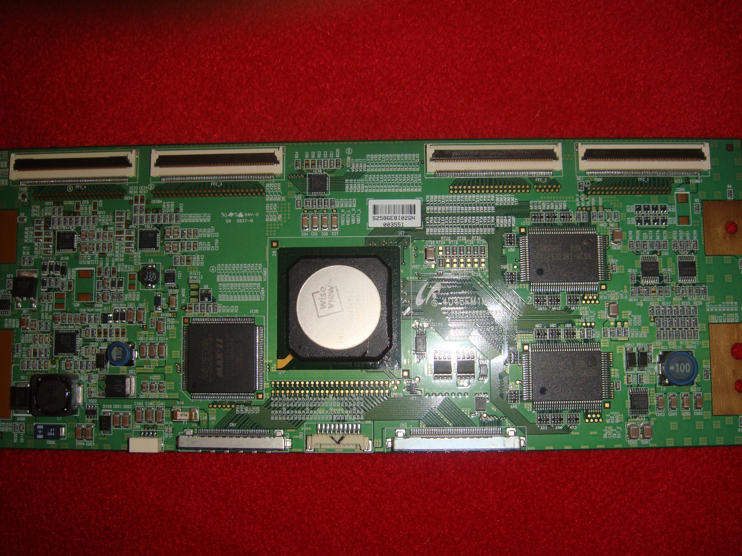

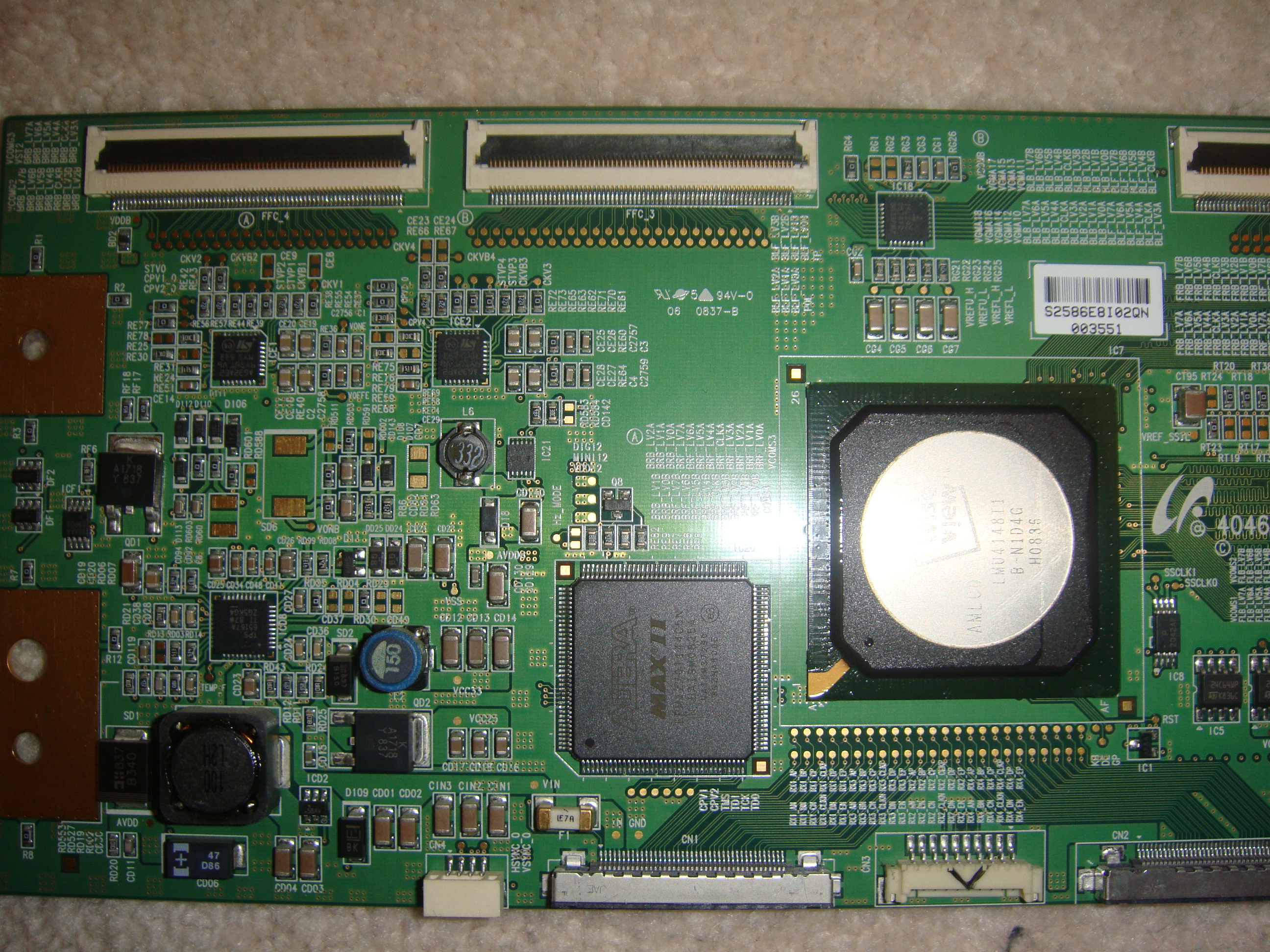

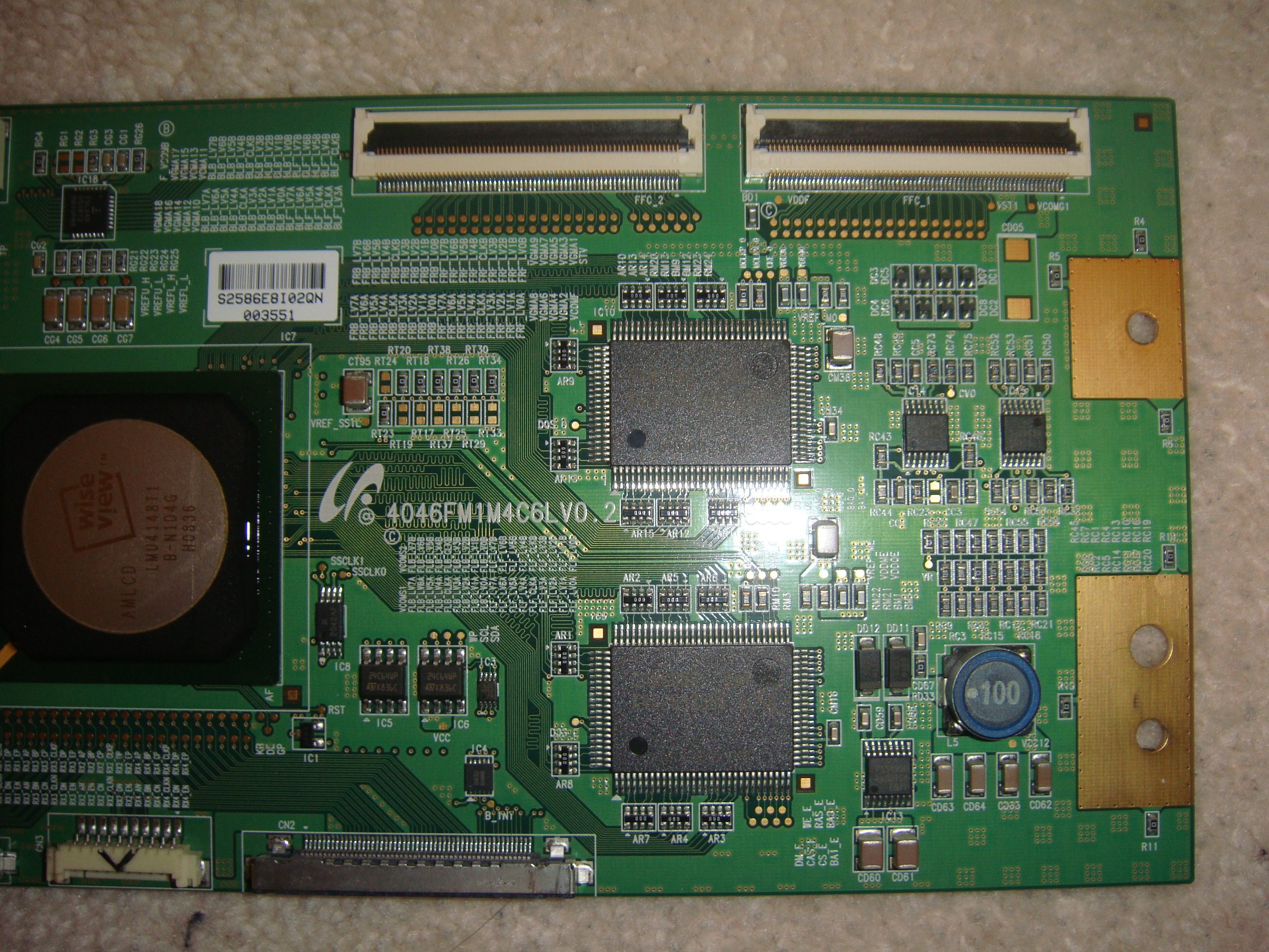

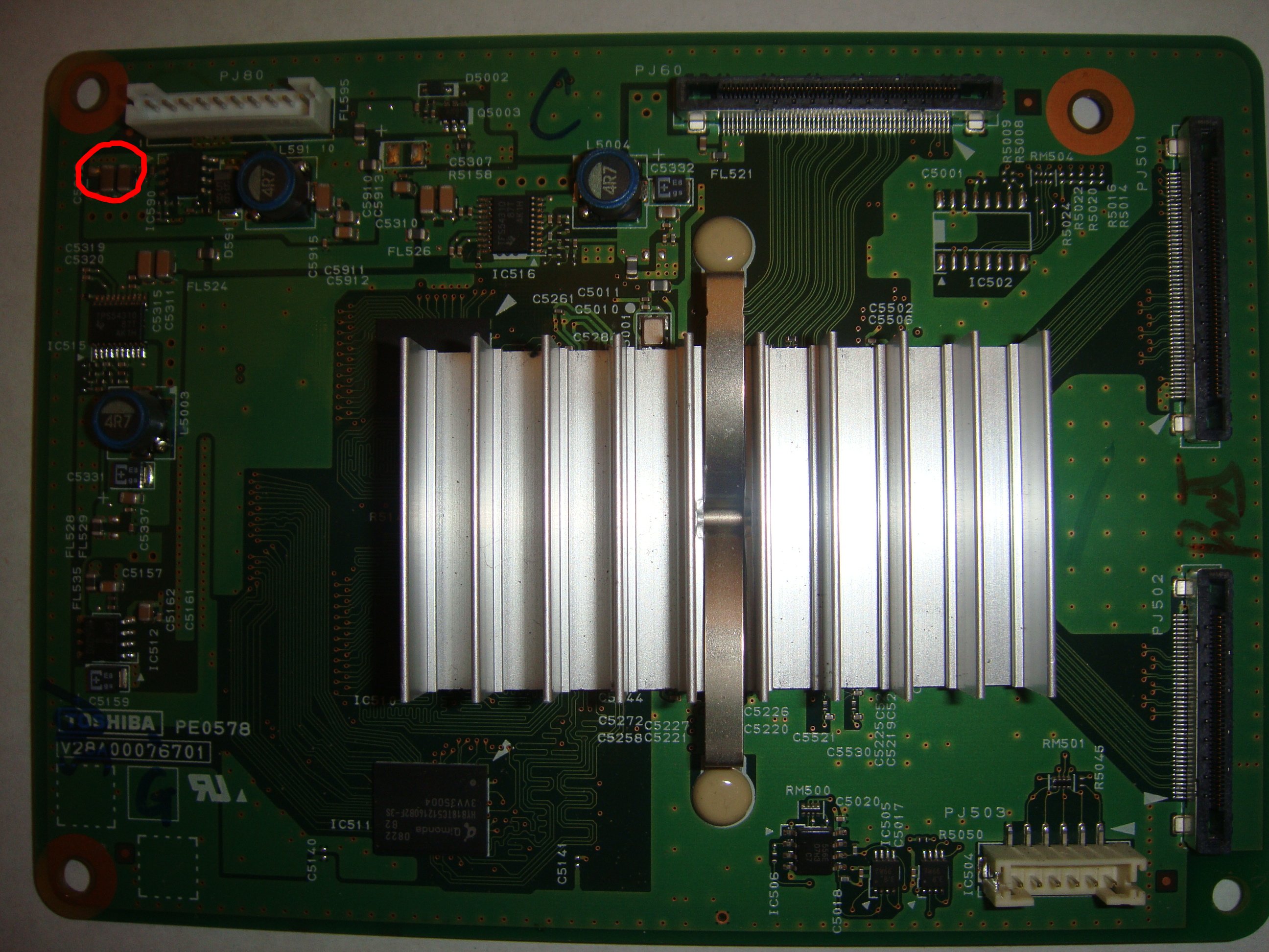

    Could well be the T-con.
    Pictures of the insides of the TV would help us help you. Especially a clear picture of the T-con.
    • Andyd1970
      • Feb 2013
      • 374
      • united kingdom

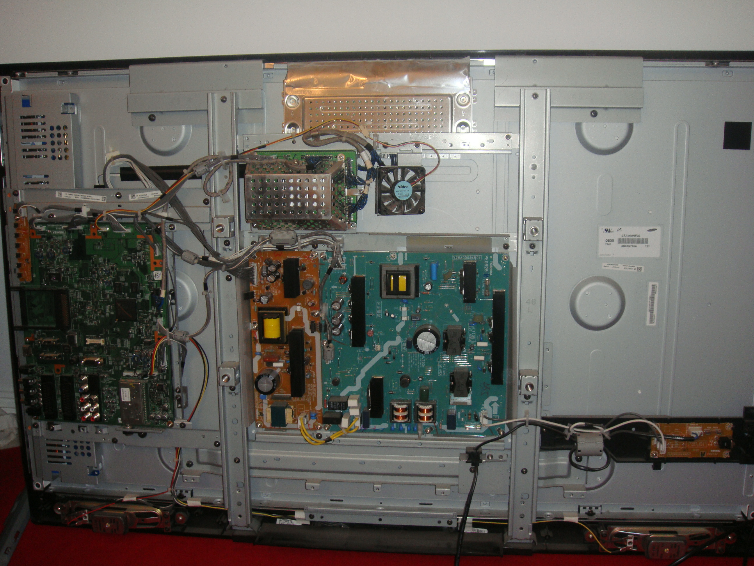

      Re: TOSHIBA 46RV555DB No picture but sound back light is on
      Hi Tom66,
      Thank you for the reply, great to know people are out there with your knowledge.
      See attached pics of the back of the TV to give over view and close ups of the T-Con.
      Thank you for your help.
      Andy
        OK, with your meter, can you test the voltage on both ends of "F1" on the t-con? It's that white/gold object near the left main data connector.
          Hi Tom,
          Just checked and I read 12.1volts each side, it did dip to 11.3v for a moment and then back upto 12.1v. I did notice a constant ticking from the PSU.
          Andy

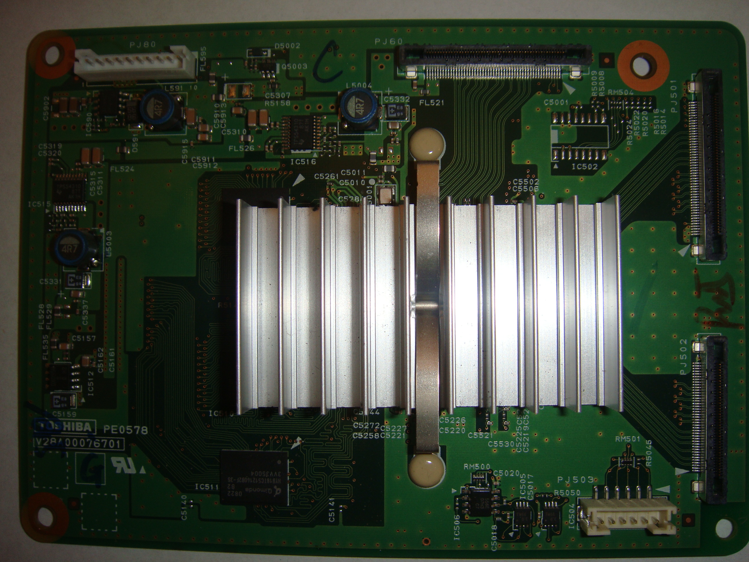

            I think you'll need to remove that shield from the 100Hz processing board and get a picture of that. Perhaps something on that is bad. Is the ticking a relay clicking sound or quite faint?
            • Andyd1970
              • Feb 2013
              • 374
              • united kingdom
              I have removed the shielding and cannot see any obvious damage or bad components, I used an eye glass to look closely. See attached pic. The ticking sounds like a relay ticking in the bottom left hand side of the PSU.
              Andy

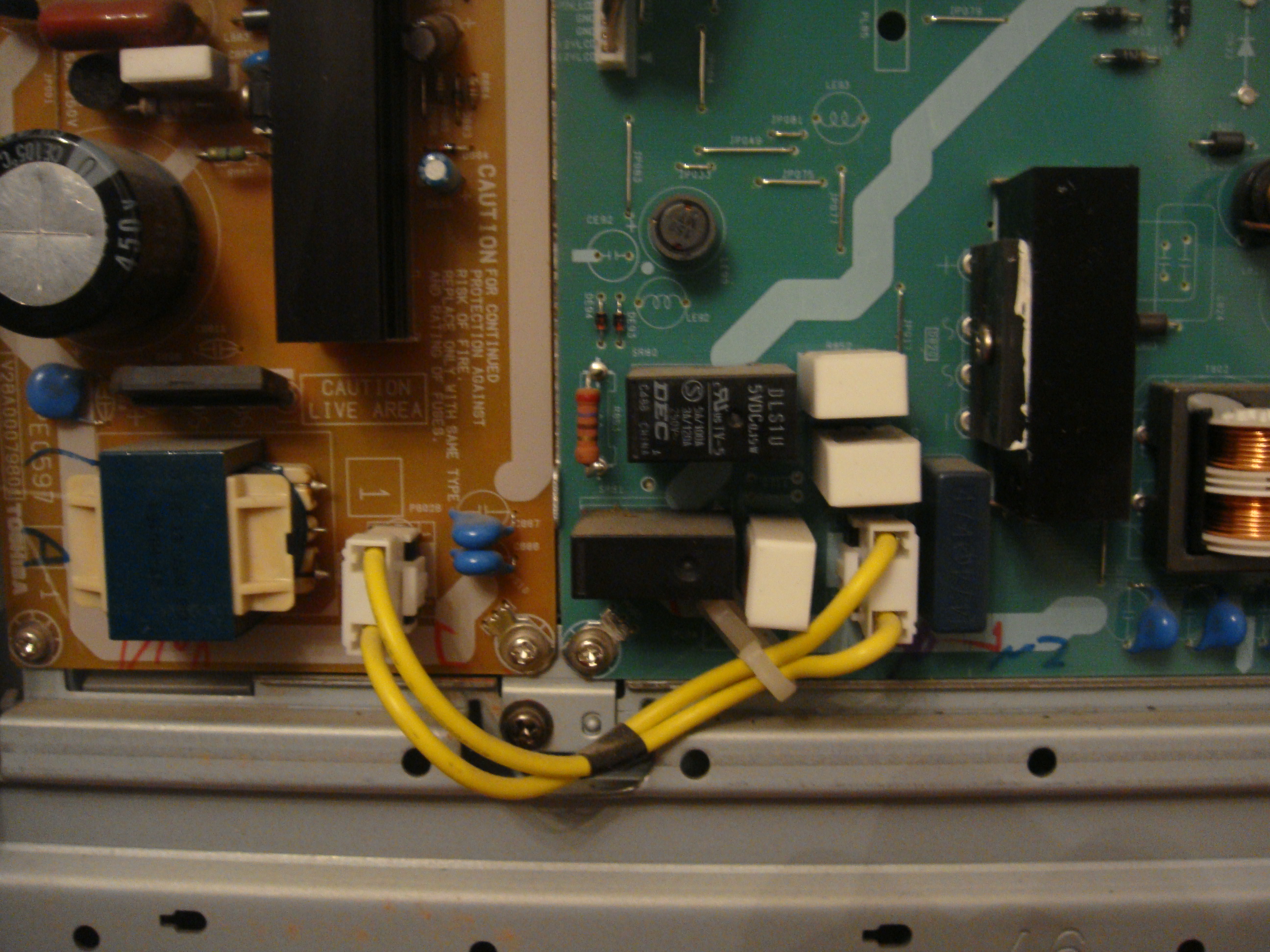

                    OK, let's try a different angle. On the PSU, can you locate exactly where the clicking is coming from?
                    • Andyd1970
                      • Feb 2013
                      • 374
                      • united kingdom
                      I am pretty sure it is coming from SR80, which is in the bottom left hand corner of the PSU it is the the second from bottom relay, in the attached picture.
                      So the checks we have done has that proved the T-Con and the other board are ok?
                      Andy
                              It is quicker that once a second. The board to the left of the PSU just shows the bottom of it in the last picture when first switch on the transformer on it squeals and then settles after about 5 seconds.
                                  100% SR80 is ticking
                                    It is whining or ticking?
                                    • Andyd1970
                                      • Feb 2013
                                      • 374
                                      • united kingdom
                                      SR80 is just ticking I guess about 2 times per second.
