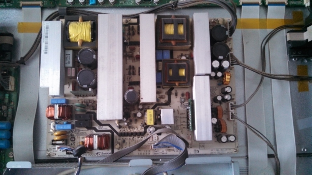

    Problem been coming on for a week, clicking with red light flashing when I try to turn on, unplugging for a couple of minutes solved issue for a while. Today it did not.
    Research found history of capacitor problems with Samsung TVs and info about lawsuit (which does not cover this model).

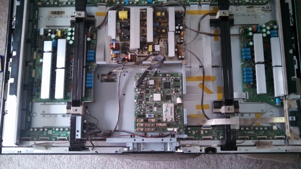

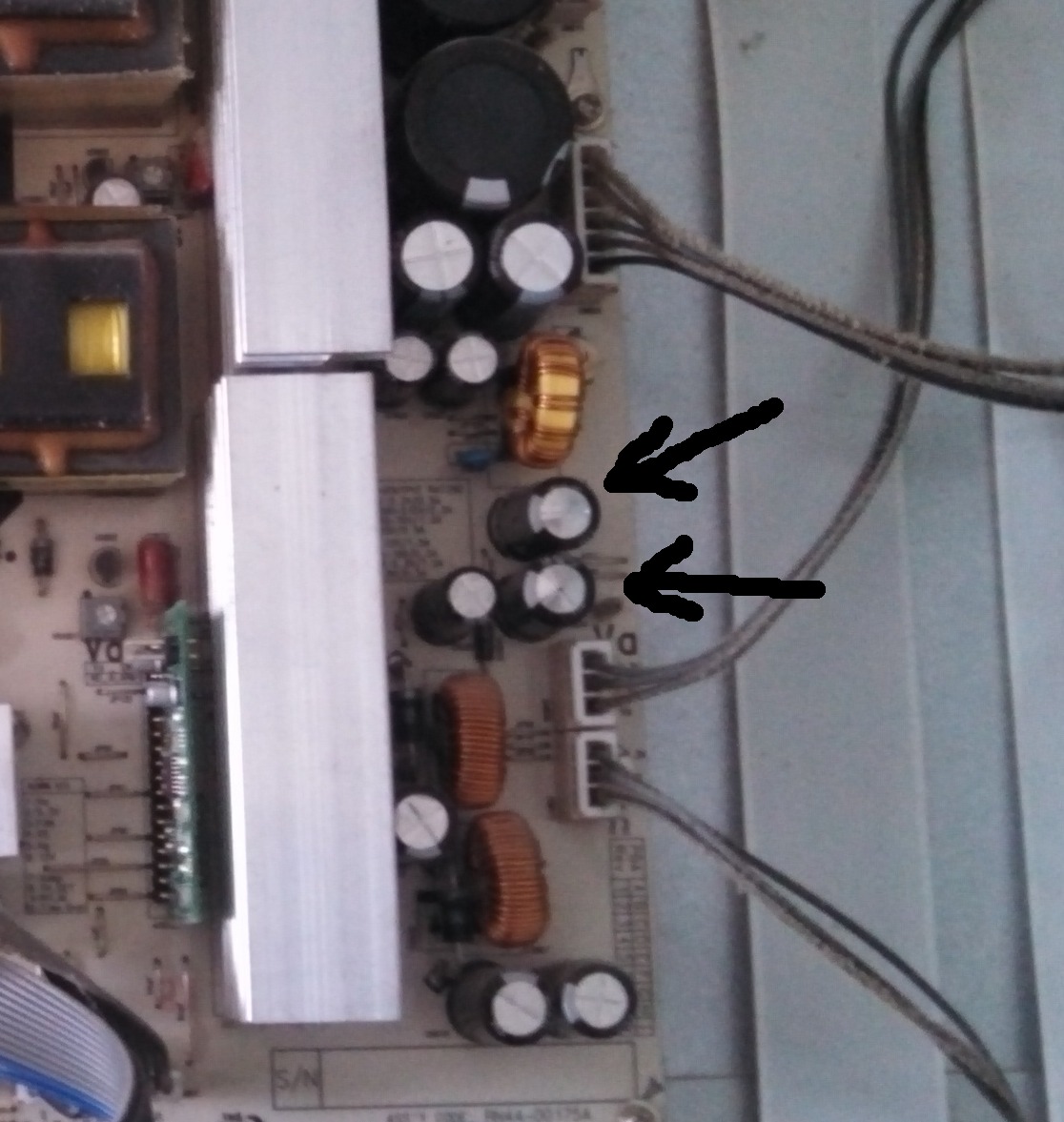

    I took the back of TV off and see 2 capacitors with obvious bulging tops on what looks like the power board to me (see pics).
    All the talk is about the 1000uf 10v caps being the culprits, and the solution being to replace them with 1000uf 25v. Do not see any obvious markings on caps to tell me what rating these have.
    1. Does anyone have a schematic of this power board that can identify the caps noted?
    2. Should I replace any others while I am at it? None of the others look obviously bulged.

    I suggest you take the caps out and have a closer look post pictures of each side of the cap and the top and bottom - must be some clues on them.
    That board gets hot from its own generated heat and from the whole set as it is at the top. Already knowwing the problem with samsung caps you should be looking at replacing them all - certainly those 10 medium size ones in that section.
    You should really have checked it out when it first started going wrong - hopefully delaying has not caused damage to other components
    You may find this helpful
    https://www.badcaps.net/forum/showthread.php?t=21947
