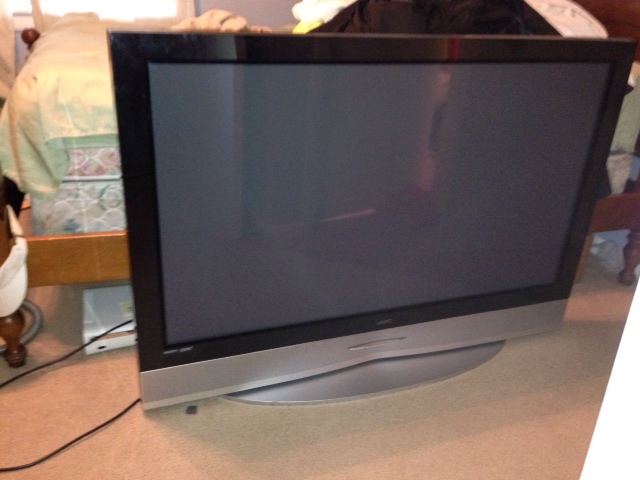

    Hello all, I am a complete newbie so be nice. Here is the situation:
    Ok so I bought this television for cheap IMO from a friend ($100). I figured since I'm good with programming and computers I could tackle fixing this Television set.
    Symptoms: TV Powers on picture and everything is great but powers off and makes a clicking noise after about 5 - 10 minutes.
    Model: VIZIO VP50 HDTV20A
    on the Plasma panel it reads Samsung PDP Module Model: S50HW-YD02
    The main power supply is LJ44-00132B
    I do not really know where to start but I figured before ordering a power supply (which I think is the issue since it makes a clicking noise and powers off after a couple of minutes) I figured I would ask for help on here and possibly get some expert advice.
    I went out and bought a multimeter but I really only know how to test continuity so if you say test this, I won't understand.
    Any help would be more than appreciated. I will post pictures if necessary.

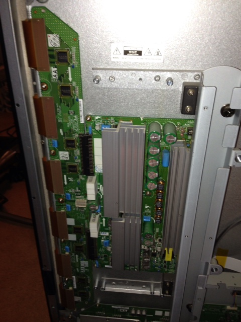

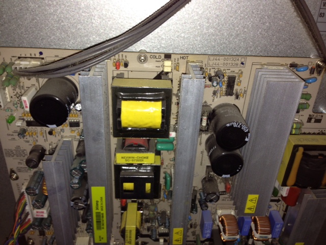

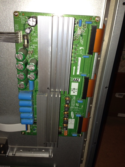

      Here are the images. Thanks for your quick response!
        Re: Need some Help with VIZIO VP50 HDTV20A
        OK, so this is your PSU board.

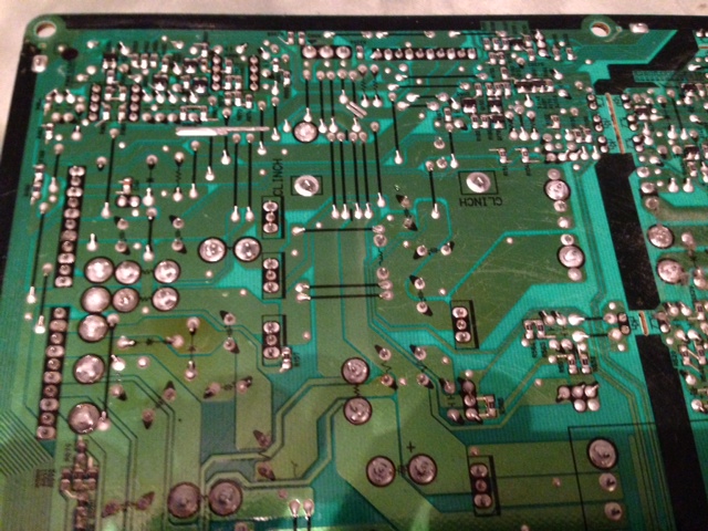

                        No. You can locate the cold joints and repair them with just a soldering iron. First take out PSU & take pictures of bottom. Unplug TV, wait 5 mins first.

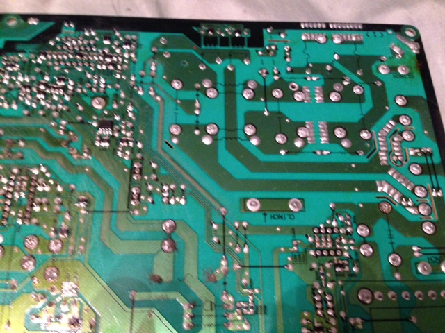

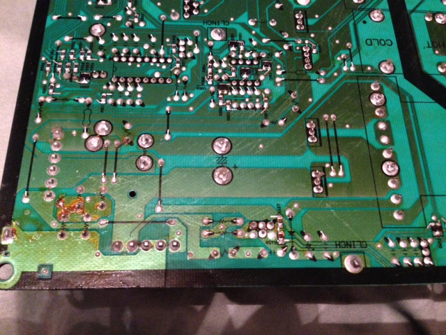

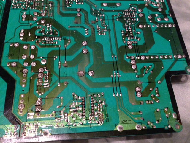

                            Okay, here are the pictures from underneath the board. I took pics of each quadrant and a picture of the entire board.

                              I'm scanning the board now but I don't really know what to look for as far as cold solder joints. Let me know if you need larger pictures or if you know where the most common colder solder joint is on this particular board. I really appreciate your help tom66.

                                  I've looked over the board several times. I mean I see places that look dingy but nothing major? Can anyone see any blatant cold solder joints from my picture? Sorry I am a newb when it comes to this kind of stuff. Thanks again.
                                    Need a clearer picture to see cold joints.
                                    I'd suggest resoldering every joint on any of the components mounted on the heatsinks.

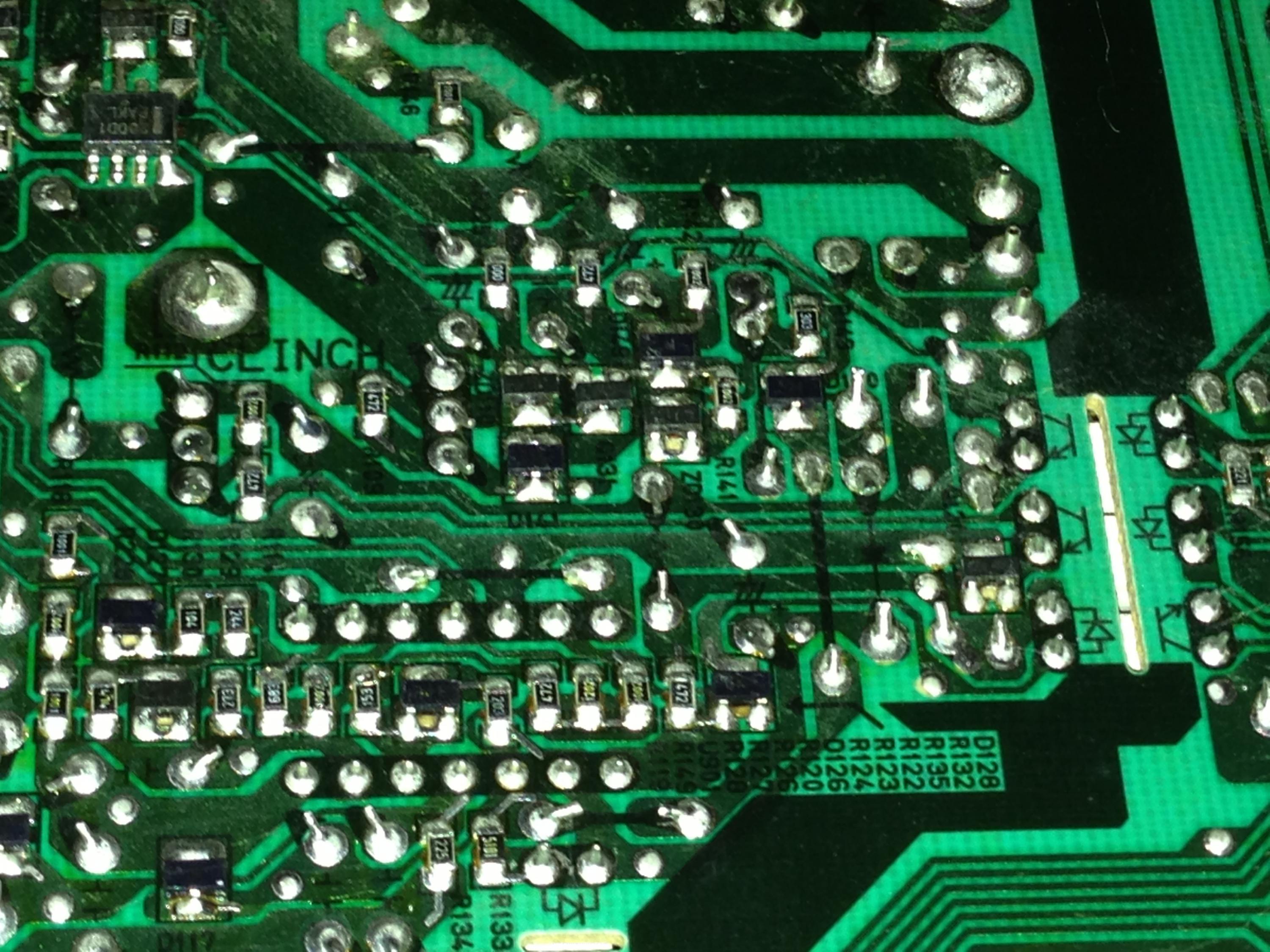

                                      So is that where it says clinch? Am I focusing on the large solder points that are the size of the eraser or the small ones where little piece of this metal is poking through?
                                        Maybe you can see this image better. Do I apply more solder on the larger points or the small ones? Some of them appear to be touching each other (like bridging) but I'm not sure if they are supposed to do that or not...
