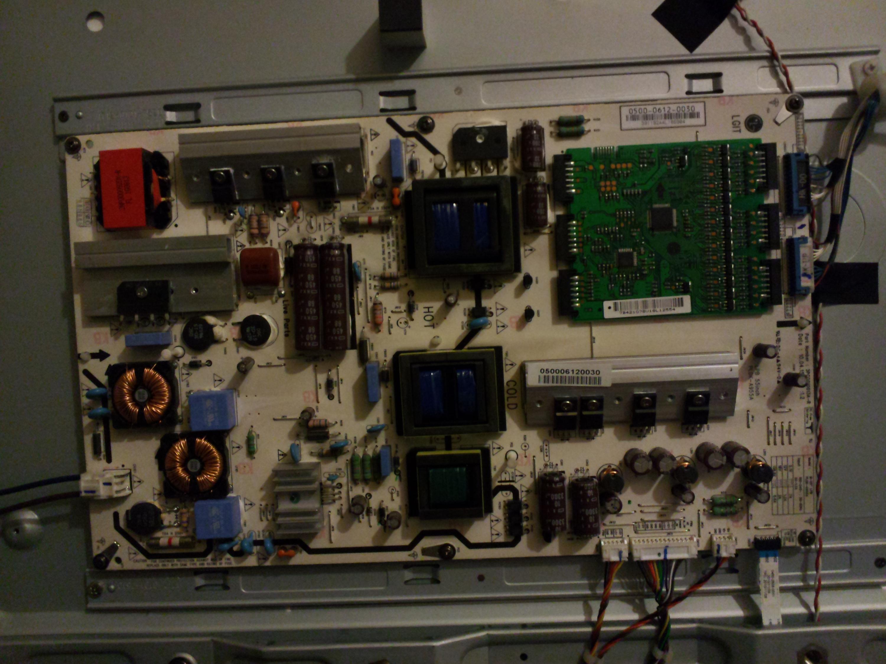

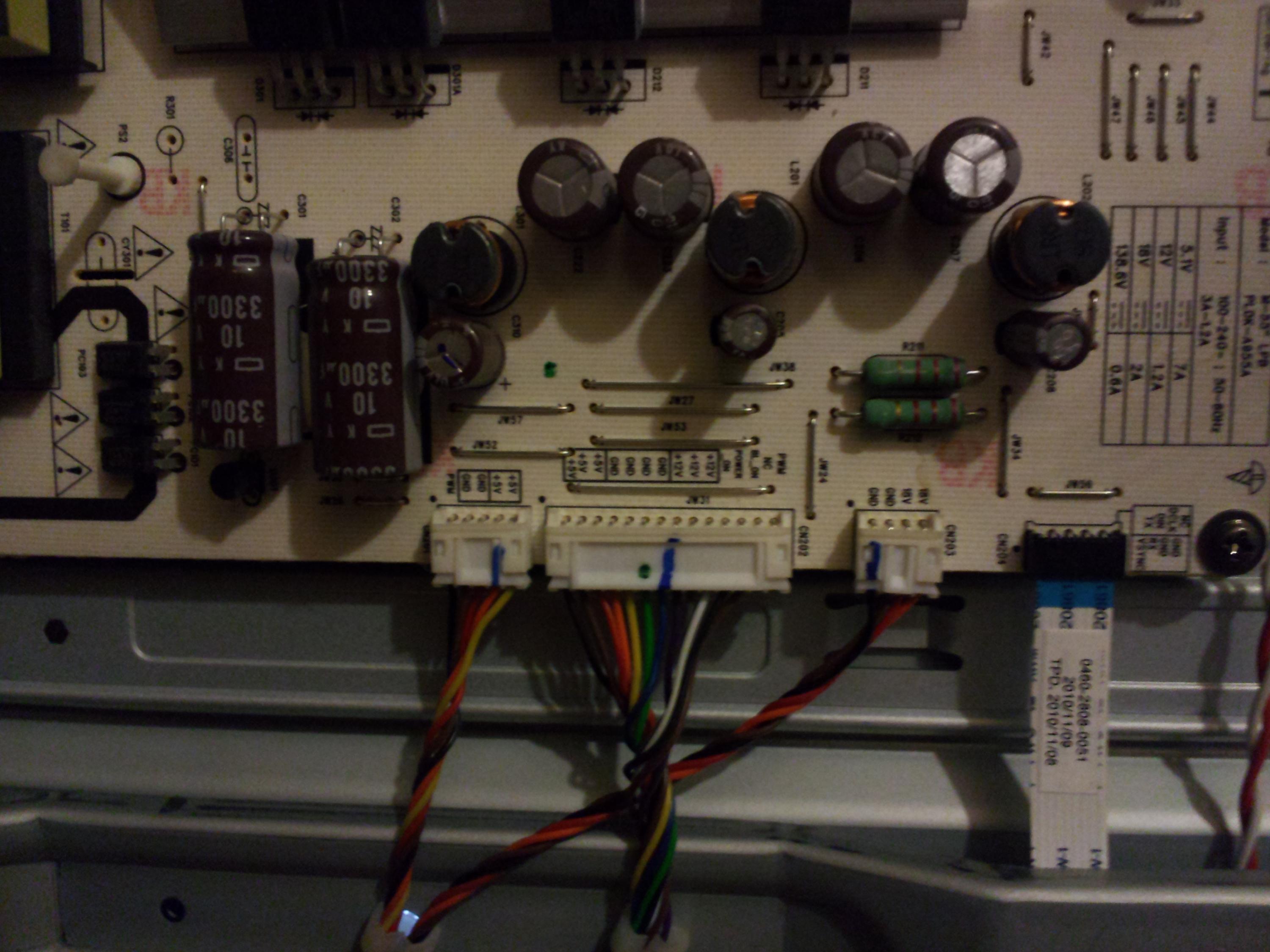

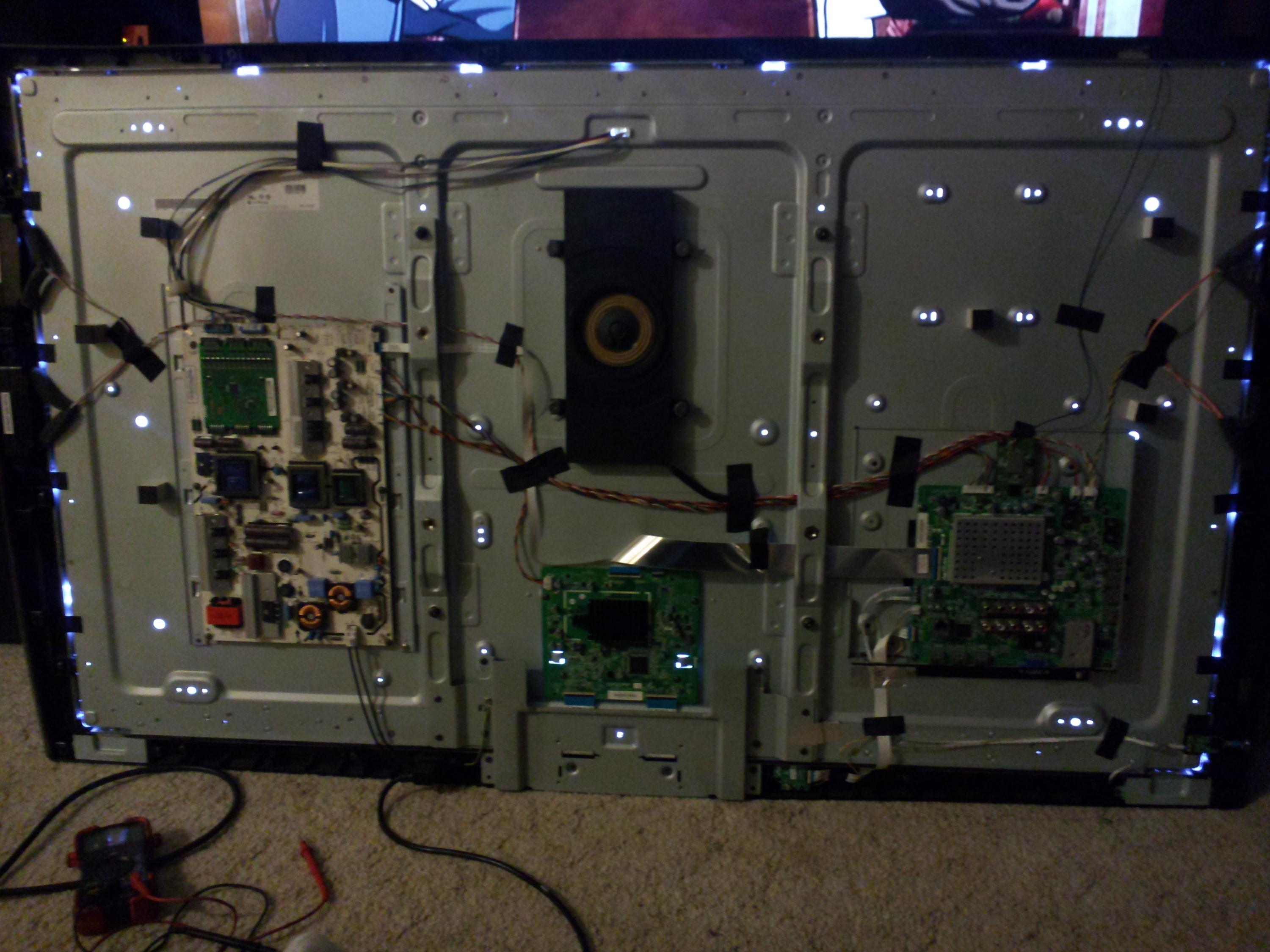

    I have a M550NV that won't make it past the startup. It was possibly hit by lightening. Logo flashes between Amber and White, then startup logo displays on screen (backlight works), about 1min 30 secs no response from remote or side control knob. I need any help I can get. I have some experience in fixing flat screens. All capacitors look good, no bubbles or leaks. Backlight and Readings on the Power Supply are as follows
    18V Standby = 0.00V, On = 18.17V
    GND
    GND
    PWM Standby = 0.00V, On = 3.34V
    NC =
    BL_ON Standby = 0.00V, On = 3.33V
    POWER_ON Stanby = 0.00V, On = 3.19V
    12V = Standby = 0.00V, On = 11.77V
    GND
    GND
    GND
    GND
    5V Standby = 5.15V, On = 5.15V
    Bottom 450V Capacitor Standby = 102.8V, On = 343V
    Top 450V Capacitor Standby = 102.8V, On = 343V

    The most common issue on this set appears to be an issue with the EEPROM causing random crashes.

      Re: Vizio M550NV Shuts down at startup logo flashes then repeats
      That is a classic symptom of a corrupted/failed EEPROM on a Visio. Tom is probably correct.
            So is this something I can replace, I'm very mechanically inclined, have experience with replacing capacitors and I can solder. Would I be better off replacing a board? Does everything sound within spec?
              I dont see the eeprom chip for that model for sale on ebay, there is a guy selling a bunch of similar vizio models eeprom chips, so you could ask him if he can get it. (they run around 20 dollars for the chip)
              Soldering that in is medium - hard difficulty. You would need a good soldering iron, and some patience, and some skill so on, by no means impossible, or the hardest parts to solder. If you can find a working main board for 40 dollars or less i wouldnt waste your time replacing the eeprom.
              Edit: Looks like boards for these are rare, so fetch a high price. There is a repair service for 100 for the board, but if your fairly good at soldering you might want to search for a eeprom to replace the bad one with instead of shelling that out.
                How sure are we it's the EEPROM. I can get a Main Board for $150, but I'd like to be reasonably sure
                  If your M550NV LED TV is stuck on the "VIZIO LOGO" then that a EPROM problem, the M550NV is a smart TV and the EPROM chip is a 16MB chip and most likely is a TSOP-48. Excellent soldering skill will be need if you was able to buy a copy of an EPROM for your TV. Copying your EPROM with those "Internet APPS" maybe copy protected.
                  you need to buy a replacement main-board or call vizio to see if they will offer to re-flash your mainboard
