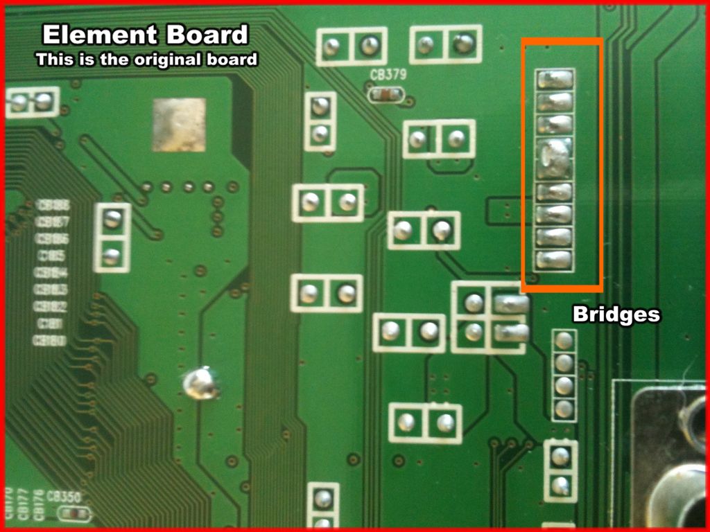

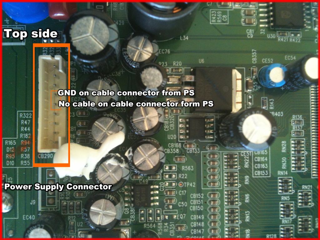

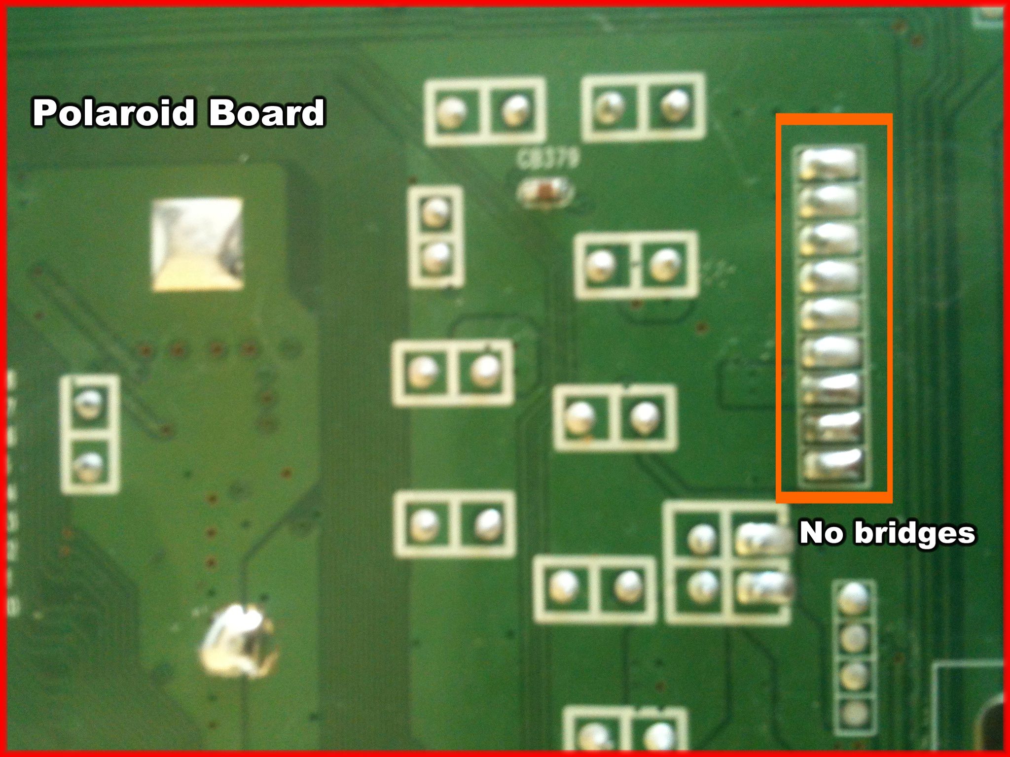

              I found a difference in the original board on the power supply header connections. The original board has two connections bridged to gnd. I have attached images to better explain myself.

                Re: Element FLX3711B
                Maybe it needs that ground?
                  Check for continuity between the unbroken connections. May be a design alteration.
