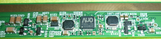

    Greetings from Bosnia and Herzegovina
    The problem is that we do not someone polio panel t315xw06 v.3 water and on the panel were killed integral AUO-P301-30, so please if someone has a Scheme of this panel, because there can not be found that AUO-P301-30 to buy (because perhaps he's not the real name, although it is written on it)
    Thanks in advance

    Is this part on the T-con board?

        Re: led tv philips 32pfl5206h/12 panel
        is, that part of the t-con
          It may be an IC that is not available -- could need t-con swap.
            probably, I'll try to find someone with the same broken panel and use the part with him, later I will post a picture, I found only one company that sells it round but it is currently not in stock
              in this model t-con, along with a panel of no standard connectors for connecting
                It is built into panel on this model? If T-con IC is burning, the panel may be damaged too.
                  I found a picture of the t-con
                  http://teledetali.ru/index.php/compo...1122-as-detail
                    Yes, so it is bonded to PCB which is bonded to LCD -- impossible to replace! Argh!
                      never mind, I'd bought a new t-con and tried to replace only AUO P301-30 because I'm 100% sure it's just up to him
                          http://www.shopjimmy.com/auo-55-31t1...ress-board.htm
                          This may be the board you need?
                          This panel is very recent, so there is not many parts / information available.
                          http://bimg2.mlstatic.com/tela-led-3...355_112012.jpg if this is the same set, then there is a tcon, and it is at the top center, it is not the thin board along the whole top of the tv. If you need the thin board, then you have to replace the whole panel.
                            cK - I think all that has been covered already. He is going to try and get a TCON board
                            or another board with the same component on and harvest it.
                            I discovered the same board as you (post3)it is the board for the LED lights
                              yes, I need a plate (post 9), or just IC AUO P301-30 .... if anyone finds the same round on another t-con board should write the model so that any such attempt to find.
                                40T07-C01
                                and this t-con has ic AUO P301-30
                                  If someone has a T-Con-31T03 C0P can you measure the resistance to ground L201. mine is 5oma
                                    If someone encounters a TCON to use AUO P301-30 can you measure the voltages on its pins
