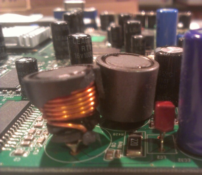

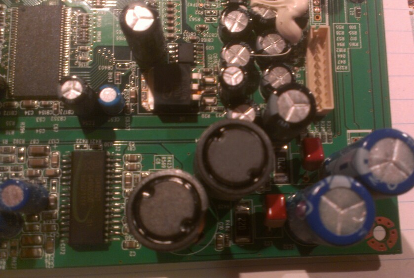

    I picked up one of these much written about Polaroids. TDA-03211C from 2007 with built in DVD. It had the blue / red indicator problem which I solved by replacing the caps on the power supply. Now, it powers up and works BUT after a time (a few minutes or up to 30 minutes) it begins to exhibit some erratic symptoms like pixelating, flashing screen, DVD cycles, buttons don't work. It seems like a power stability issue. I am focusing on the main board because of what I also discovered when I was fixing the PS caps. Board is P/N 200-107-GT321XA-AH rev A GT3213C-XA2. White tag on bottom of board is 21 899-KE0-GT3212XAZH Rev:01.
    As shown in the attached pictures, the coil at the corner of the board is broken. Not sure if it blew apart or was a defect but I know it isn't a good thing. Problem is, I cannot find a schematic on this set anywhere so I don't know the rating on the coil to even know what to replace it with. If anyone has a schematic or knows of a way to figure out what I need to get please let me know. My other option, though I hoped to avoid it, is to purchase an entire board off of ebay or SJ.

    Ended up buying the entire control box which includes power supply and mainboard. Popped it in today and works like a charm. Easier and quicker than repairing the mainboard issue but I still wish I knew what the problem was and whether that broken inductor coil was the issue. But I now have a working power supply with all new caps that I can sell.
