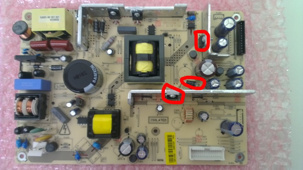

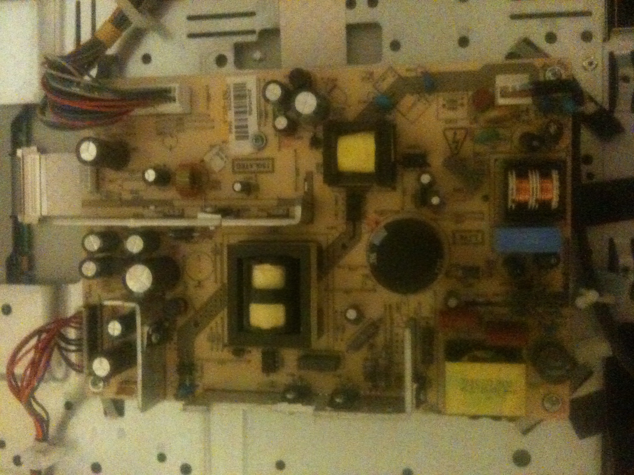

                  Ok,if I place a picture up could you circle the essentials ? Please Tom

                    Re: Onei 26av400
                    • LEEDASH
                      • Dec 2012
                      • 481
                      • Bedfordshire
                      Re: Onei 26av400
                      Also what should these diodes be reading.
                        Re: Onei 26av400
                        I already did so for the same power supply in one of your other posts. But here it is again. Just tell me what the readings are. Also, you NEED to make your pictures clearer -- I do not have this board in front of me!

                          Re: Onei 26av400
                          Cheers Tom,the diodes that are screwed in they have three prongs ? Do you miss the middle one out when testing.
                            Re: Onei 26av400
                            No, test all six pin combinations: 1-2, 2-1, 1-3, 3-1, 2-3, 3-2.
