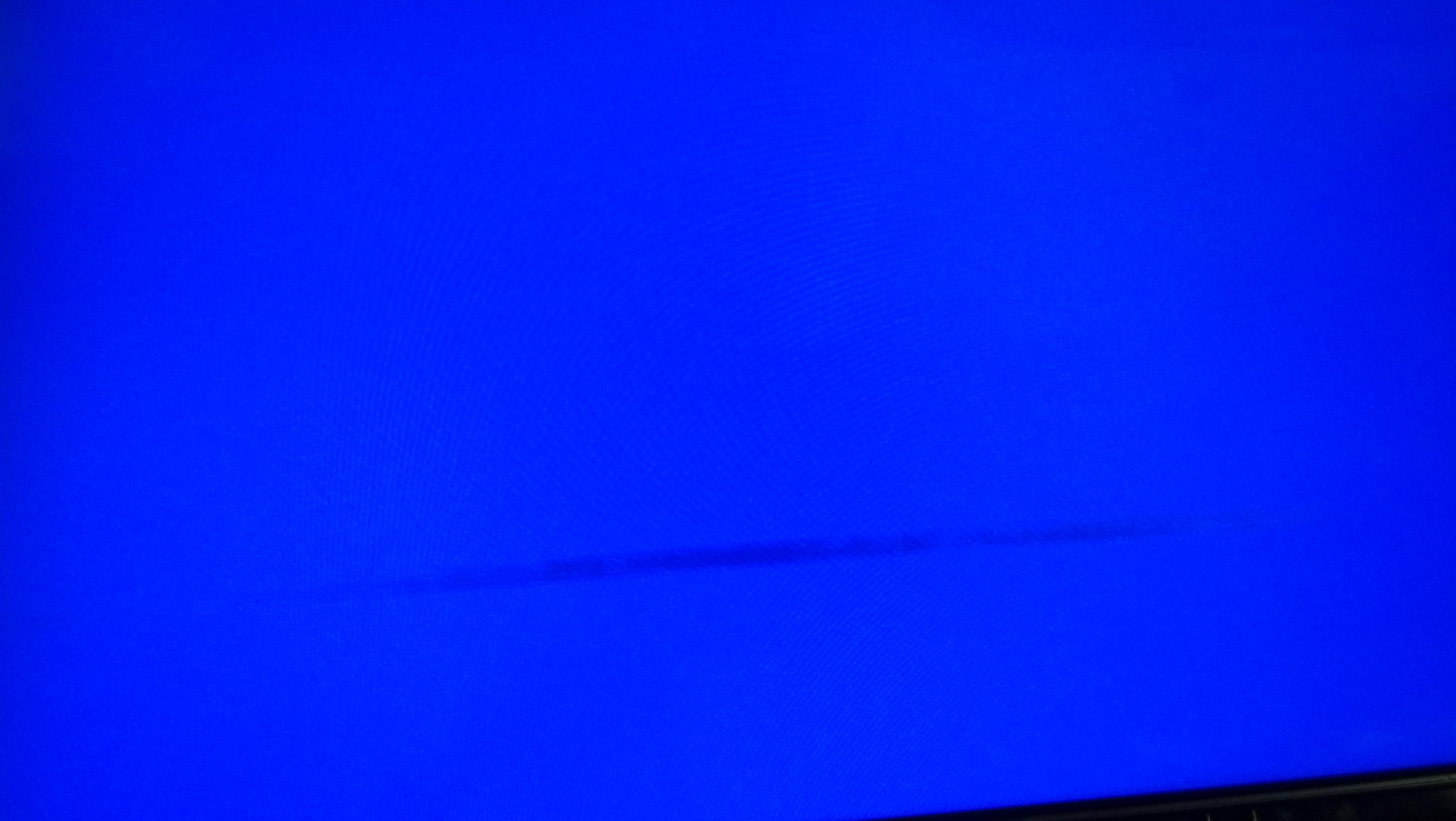

Hi this early vestel with inverter and ccfl backlight came in with no backlight and it was the usual suspects on the inverter board ,4 fets ao4616 ,i ordered a kit and repaired inverter .

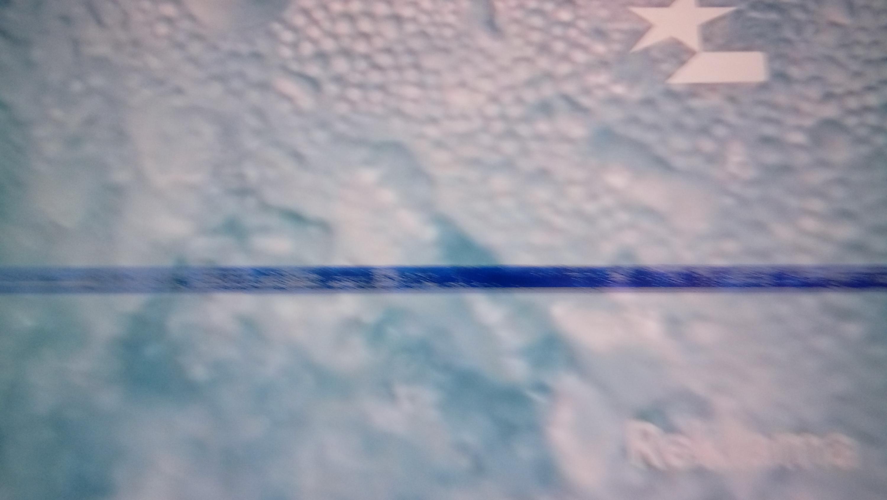

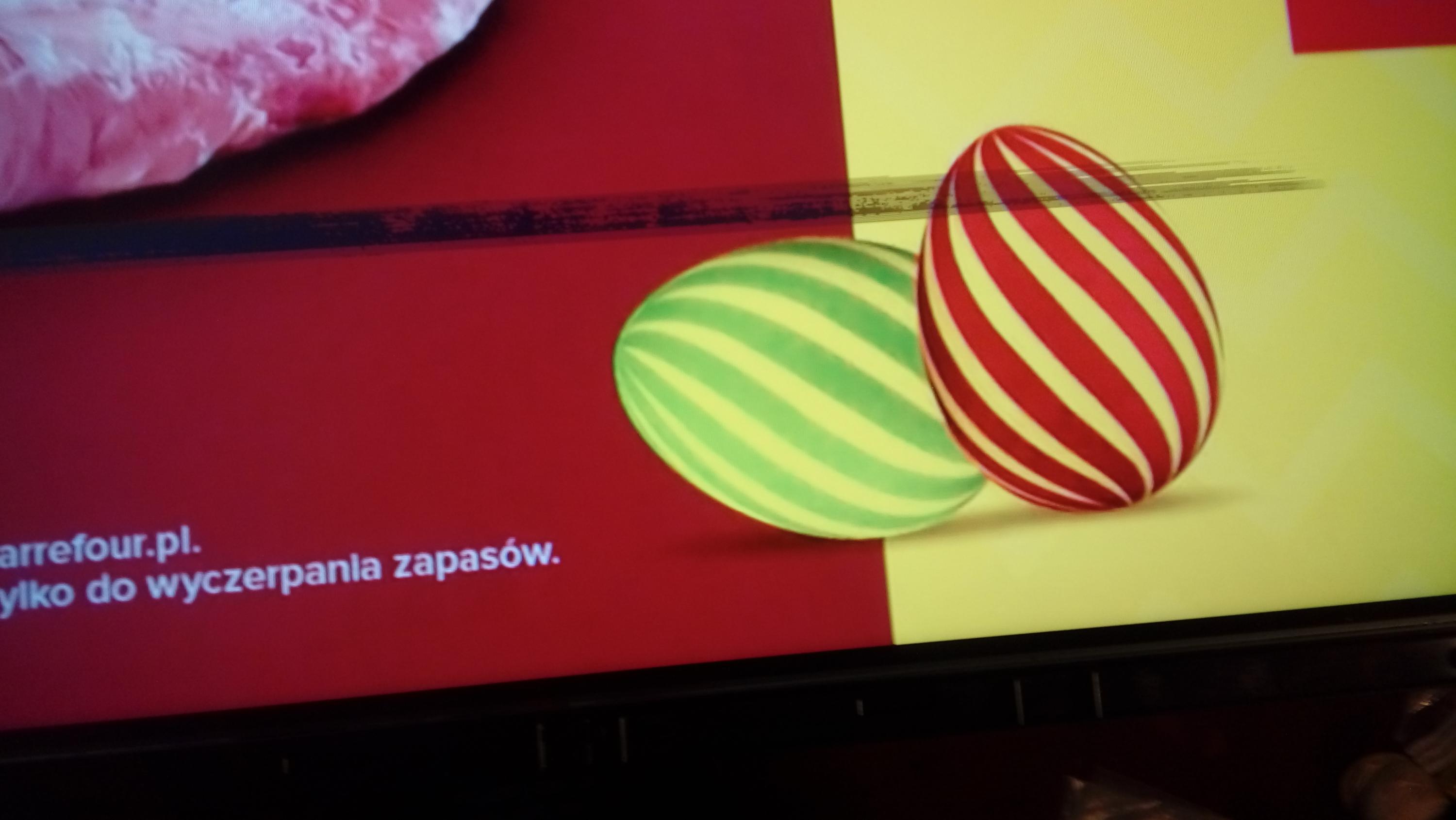

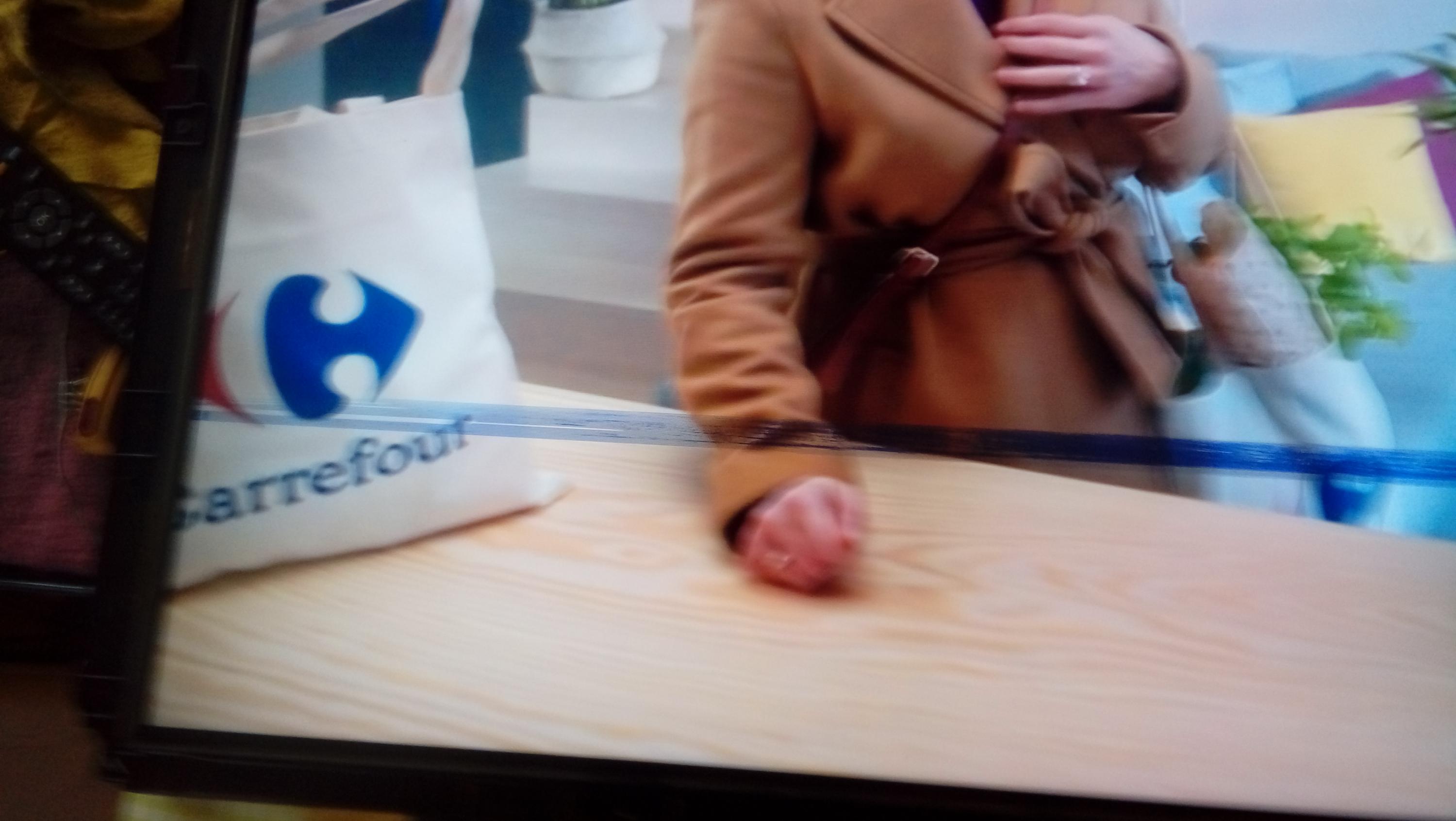

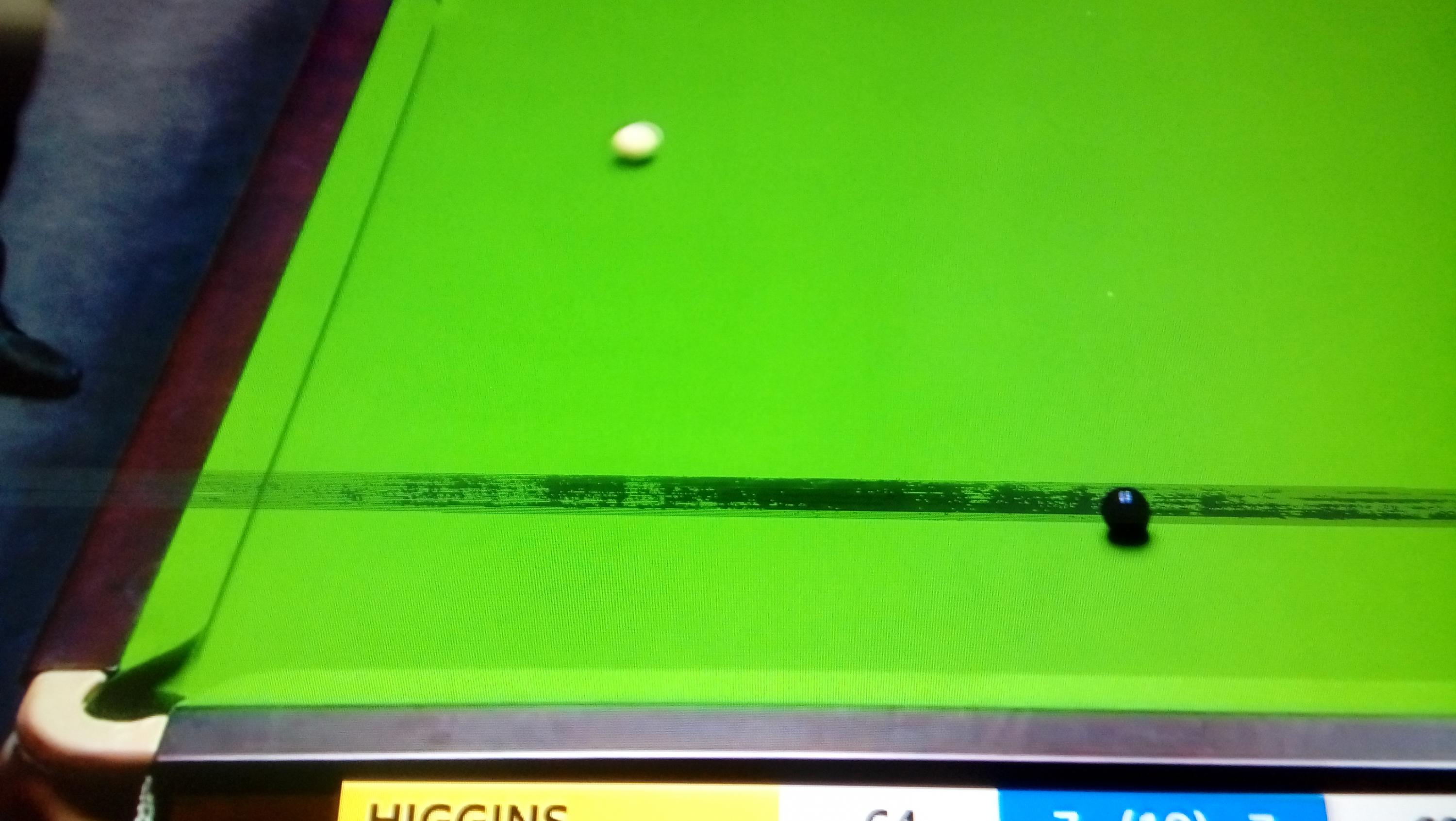

i now have this smear approx 8 inch from bottom on left hand side
its about half inch wide it stops approx 3/4 across .it doesnt change with pic content
i have examined panel closely for any damage ,
none of the tabs are running hot .
would value your opinions if it is the panel.
ive had many plasma and lcd tvs with horizontal lines,
but they usually go right across .
sorry the pics are not the best but it should give you all an idea of the problem
