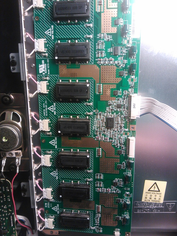

    Hello!
    Samsung LE27T51B, the inverter tries to start, a short noise sound is heard, but no backlight comes on. Please see attached picture.
    Is there any usual failures on those? Bad transformers?
    There are a bunch of SMD fuses, they're OK.
    The inverter does recieve +24V and ON-signal.
    Could anyone tell the resistance readings on the transformers.
    The transformers have marking "4006A533 008"
    Thanks in advance!

      Re: Samsung LE27T51B inverter problem
      I get different readings across the bulb connections.
      1. 12k
      2. 1k8
      3. 21k (?)
      4. 1k8
      5. open circuit (?)
      6. 1k8
      7. 12k
      Obviously there are two strange readings. So perhaps those two transformers are bad.
      Will it be worth a try to change transformers or better find a new board?

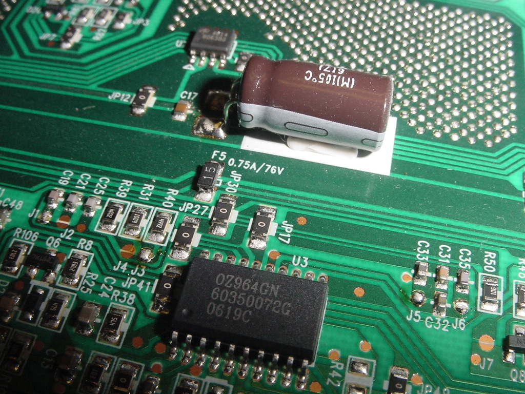

            Does it have one of these black fuse (F5)?
              No, it appears to have only white SMD fuses. But they're all OK.
                Today measured the winding resistances of all the 7 inverter transformers.
                One of the them has one winding open circuit.
                Is it normal that one failed transformer will shut down the entire inverter?
                I assume all transformers with its associated drive electronics has fault detection and will disable all inverter action, correct?
                This boils down to the decision of either replace the faulty transformer or replace the entire board.
                But I think I'll go for the transformer change.
                  Yes, one transformer failed will shut down the inverter. The fault detection works on any bulb open, or any over-currrent of the bulbs.
