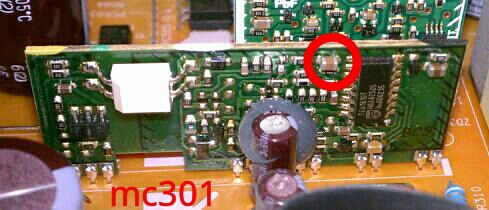

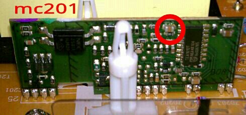

      Would these be the ones? I watched the video and it obviously isnt the same power supply as mine. But these are locateed in the same location to the IC. Also the ones i need are 1uf 50v aluminum caps, right?
        Re: Panasonic TH-58PX600U 10 blinks
        You can determine if those are the problem using freeze spray as he showed in the video, so I'd recommend you try that. I've got no experience with this chassis myself.

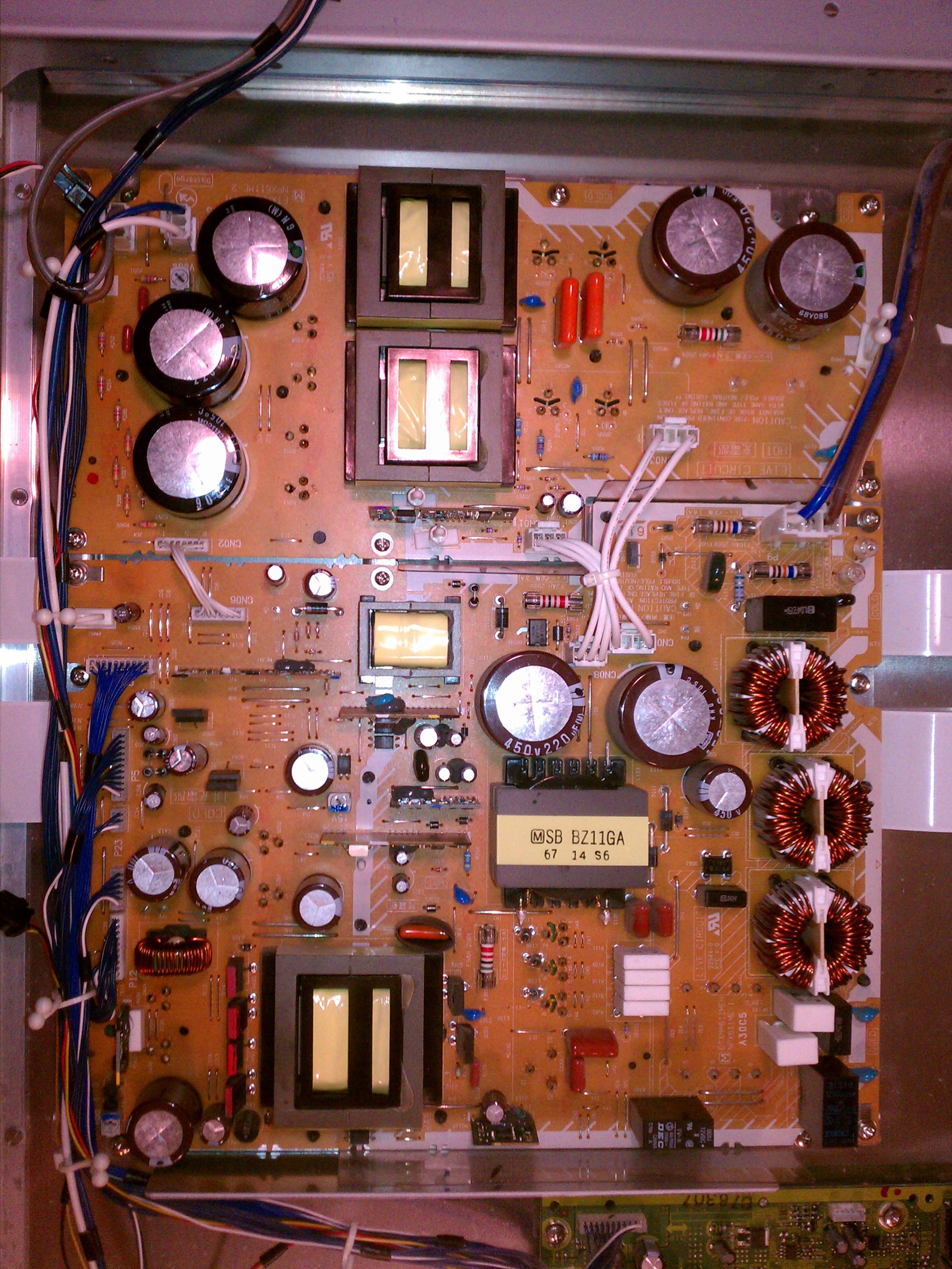

            Can I see an overall shot of your PSU?
            The top of the capacitor is sometimes connected to one terminal or is sometimes floating to an internal node.
              Here it is..
                Bottom of the board, near the brown cap, across from the white-on-black DEC relay would be my guess.

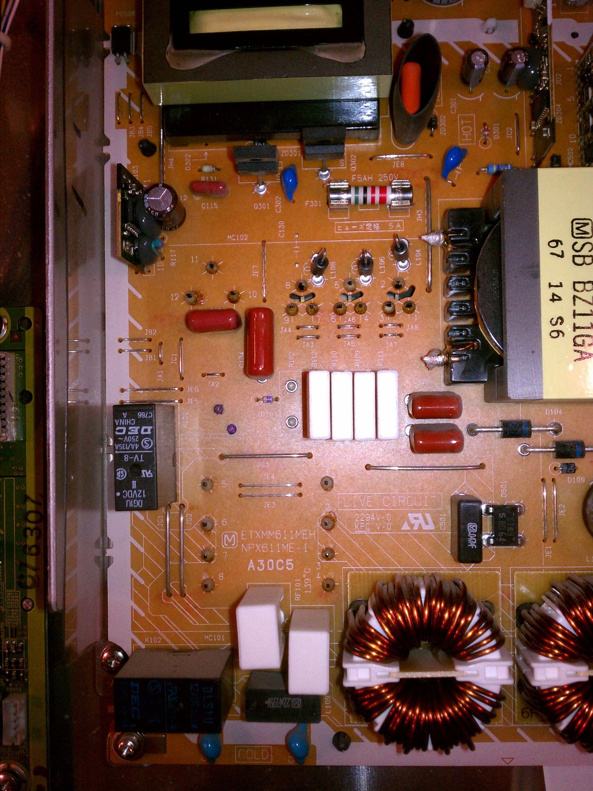

                  Ok i guess i am not clear on what im looking for in the pic. I took a closer one of the area you described. Are you seeing a component/connection that could be bad?
                    I am looking at that stand-up board which may be the cause of your 10 blink code. Try freeze-spraying it to see if it sorts out the problem.
